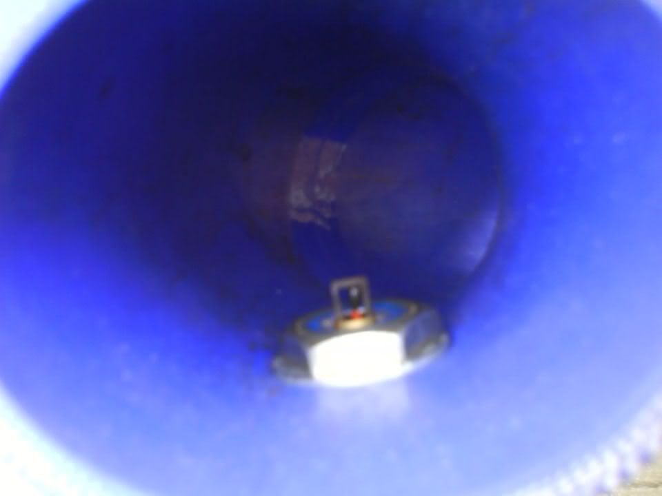

Attached is some data from temps taken before my intercooler.
I have two sensors mounted in my intercooer pipe, one is the bulb type temp sensor, the other a K type thermocouople. These are mounted within an inch of each other so should be exactly the same.
The Red line is the thermcouple, and the black line is the std cossy /rover bulb type.
The sensors do read the same if left together long enough, it's just simply the thermocouple is almost instant while the other has a much slower responce.
doh, attachement didn't work
The one im using is a Rover one. I installed it into the hose to avoid heat soak and works really well.
That is the type I use, and it's still a lot slower than the thermocouple
It would be interesting to compare it to the Cossie one - although they are both open bulb so should be equally responsive.

yes stevie, just a K-type, I went for one with a very small mass, then simple drilled out an m5 bolt and epoxied it in place.
