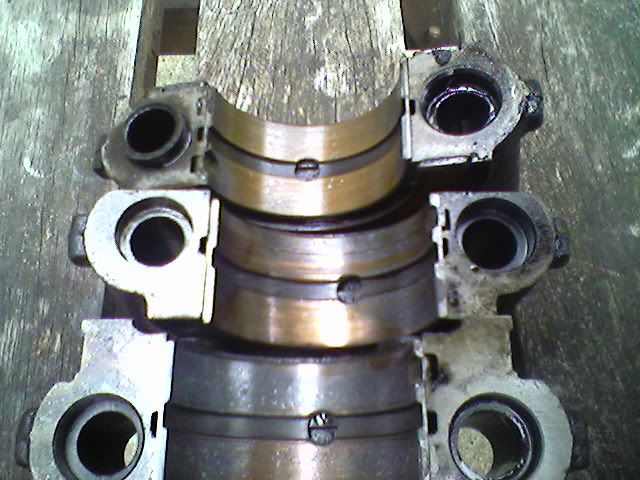

Colin IMHO this looks like classic Oil starvation. I'm not 100% but looking at the pic again are they small scores i see in big end 2 and 3 ?

thats what i was getting at denis , just to support it a bit , here are the bearings i was talking about earlier ..big ends ok ,mains pooped ... notice the different degree of wear across the mains ..middle is definately the worst.
Edited by robert on 28th May, 2009.
On 28th May, 2009 carl talbot said:
did the brgs turn
is the crank cross drilled
Or more importantly, WHERE is the crank crossdrilled. The A+ mains with the plain lower bearing, NON cross-drilled mains and 8000rpm will always be roulette.
So, before you have anythign else done to that crank, i hope you're going to get it checked for straightness and crack-detected. No point throwing good money down the drain.

Roberts picture of the 998 main bearings is not representative of the bearings in this engine, you can clearly see that there has been overheating of all of the mains, but on my engine, the only 'failure' is the center main, all other bearings are good enough to go back in. I am niether convinced that re using perfectly servicable previously used bearings is a problem.

This time when I assembled the crank into the block, everything spun nice and free without the center cap. When the center cap was nipped down the crank still tunrned but took a little more than a finger and thumb to get it going, ones it was going it spun free. Once it stopped it again took a bit to get it going. Sounds similar to the problem you had, but not as bad. Prior to this, I fitted a bearing into the center cap and placed it on number one journal on the crank, and its tight at the edges, it never was before. The bearing housing in the block is not niping the crank, its just the cap. if you sit the cap on the crank without any bolts, it sits proud, if you turn the crank, force of a finger and thumb, the cap moves with it.
You can see some blue'ing of the steel cap at the bearing tang grooves.
Im am very sure the guys I use know how to fix it Carl, and like you said, the DON had a stiff bearing, but that is all it was, it never failed *wink*

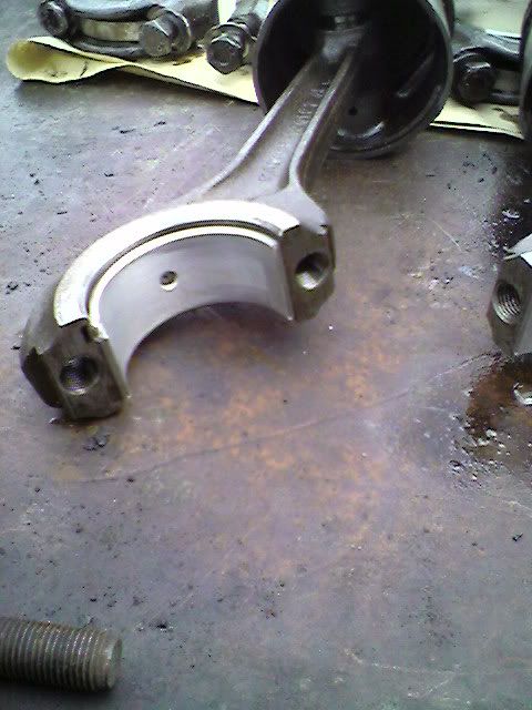

Was slowly losing oil pressure so took the car round to a mates for a second opinion after taking it for a drive he said there was a ver slight bottom end rumble. Turned out all the mains were on the verge of total failure. On removing the caps and extracting the bearings you could see where large sections of bearing material had just come away.
On showing thes to two diferent engine builders they both said the same thing Fuel contamination of the oil and or moisture in the sump.

Ive done 1500 miles since the initia fuel problem, and its been stripped down completely since then and it was fine.
For the last time, this has only happened in the past 300 miles AFTER the rebuild to fix the oil jets *wink*
