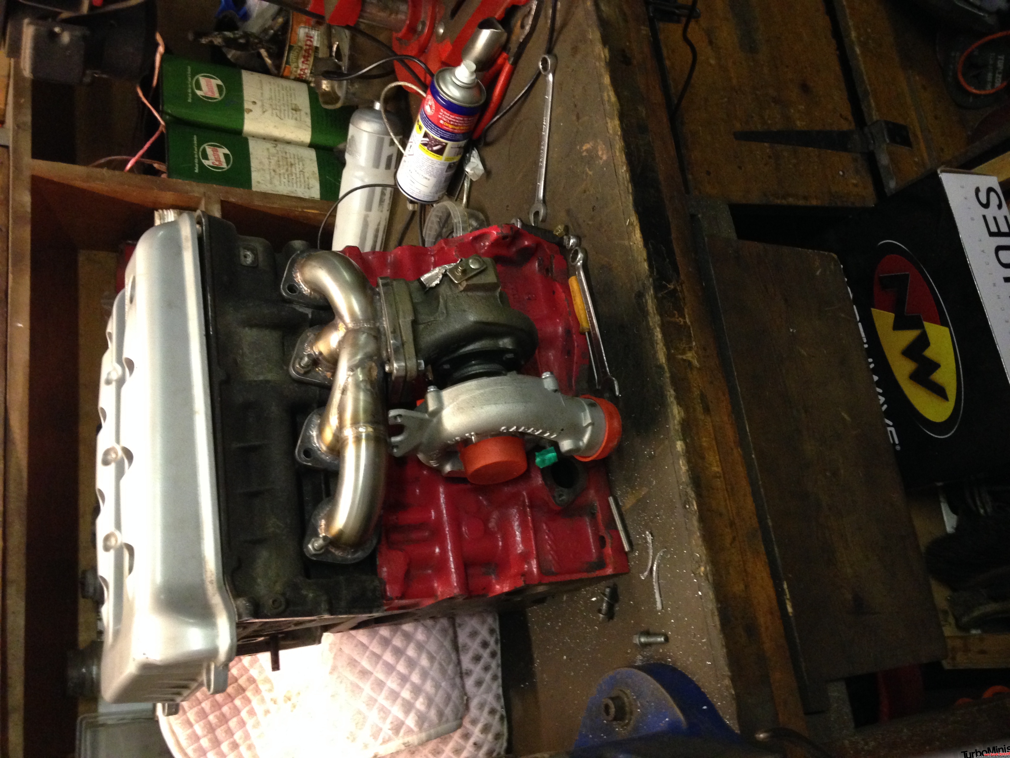

Looks good, forgive my lack of knowledge of k heads but i take it theres no turbo manifolds out there for them? Also out of curiosity how is the turbo supported in a couple of your pics? And lastly is that lipari blue?

Every turbo installation is different so no real off the shelf manifolds given the range of turbos that people might use. (also the fact I did not want to cut the bulkhead and keep it out the way has made life hard)
Found today that with a bit of fettling a gt17 fits if ever there is a desire to tone it down a bit.
It took 4 hours just getting the bracket right, supported from the fuel pump holes. Its just there to support it while tacking the first couple of pipes.
It certainly is lipari blue. Though was fully restored a few years ago.

No new engine for this season, and given all the issues associated with a basic a-series questioning whether I can be arsed to take the unpredictable special 16v turbo over the predictable. (i.e sprint cammed n/a 16v 1380 with known power curve)
Not sure I'm happy with the manifold now either, but does fit down the back now tacked.
