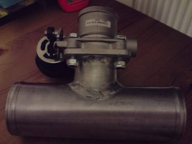

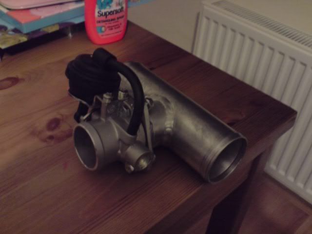

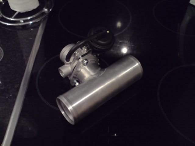

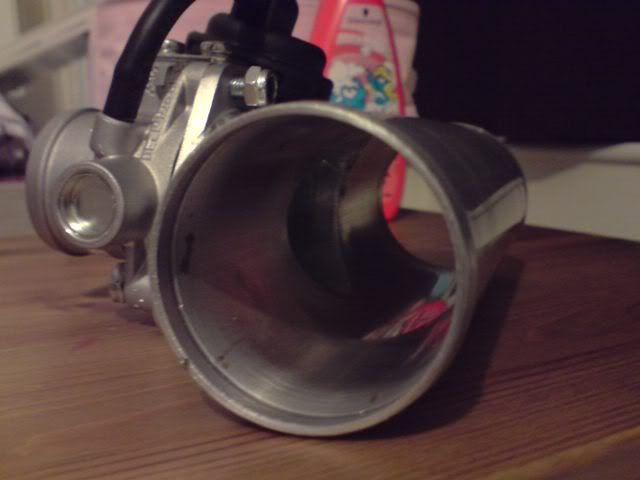

Right. Heres some pics of the valve and welding done

Not great as i took it with my 1968 prototype mobile phone camera!! More to follow once uploaded!!

Prawn
667 Posts
Member #: 5232
basingstoke
that looks very smart Jonny, I take it that's going to go in the same place as the T for your dump valve currently?
johnnysti
301 Posts
Member #: 2480
Yep thats the plan. Straight swap i hope. Dropped it off to Neils last night so im hoping he will get straight on with it today even just to see if it works. I hope so!!!
