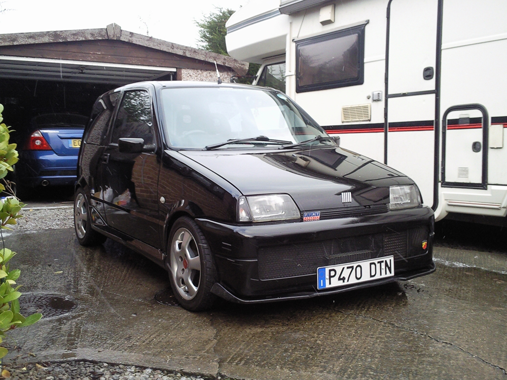

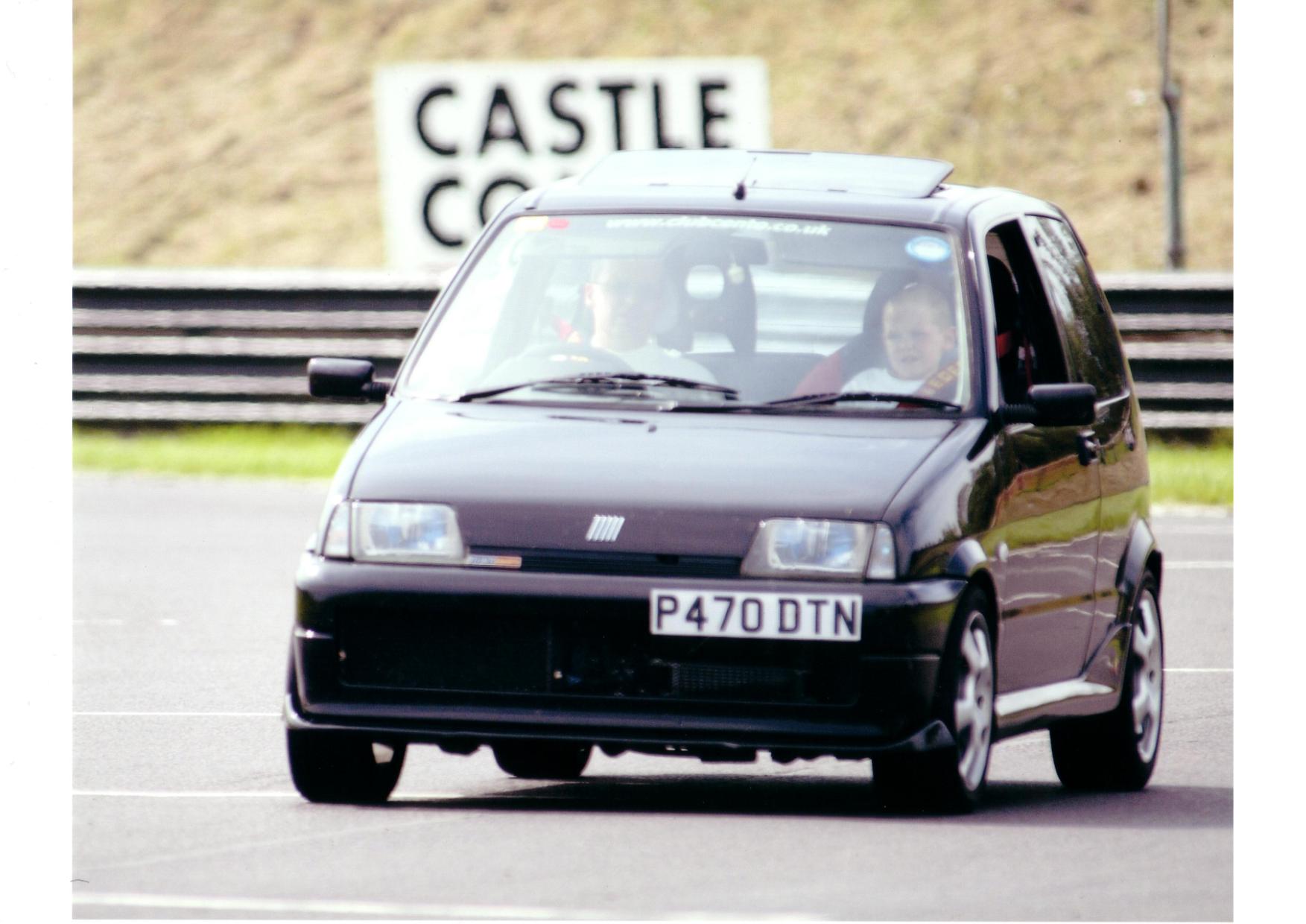

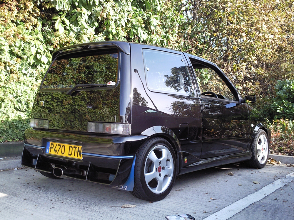

also ive been talking about this car a fair bit and you guys have been a great help so far! so thanks here are a few pics of the car we are talking about, its not a mini but i love it haha and its differnt -

Wow, that is a tight engine bay! I expected you would have a lot more room

slightly o/t but a chap at the garage i used to get my car mot'd at had a cinq turbo with a 6spd box and nitrous, was supposed to crazy.
cool looking little car chap :)
