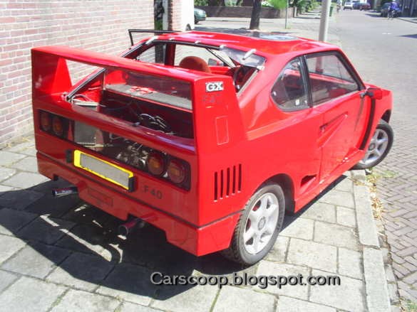

i hear you going for f40 styling *happy*
What the Fook is that/was that?

Suzuki whizzkid by the looks of it .lovely ! ..lol
Haha thats quality!
It looks like that thing that was for sale round the corner of your house matt
