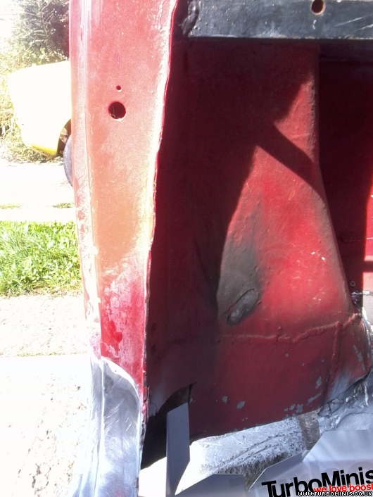

Ive made some progress with the floor. The bulkhead is repaired, all welds ground back, offered it up and all was good until i looked at the last side! :?
Here's the problem!!!!!!!!!!
The step looks original, but at some point the A panel has been repaired (using 12mm worth of filler). Where's the best place to cut to bring the step back in line? The inner and outer A's will be replaced just not to sure where/how they join the step panel?
Ive measure my other shells and they measure 1270mm from lip to lip width ways and this shell measures 1280mm (so 10mm out).
EDIT: it is only 10mm out at the front and taper back in about 12" to the right width.
This looks like a previous repair?

Did it not have replacement step already fitted, using the repair panel that goes right back to the bottom of the quarter panel aswell? Or am i dreaming, this could be why its out of alignment maybe?
Ah bugger, yeah it has! I was looking for the join at the step. *blush*
It is aligned correctly at the back its just the front 12" that tapers away to a 10mm gap at the front. The only way I can see of sorting it is to cut a 10-15mm slot vertically up the inner A panel to allow it be brought in?

Id put a new step in, surely you will have to put full rear quarters in anyway because of the tubbing, then you can just fit it to where the floor is
I had a play around today and tried the door fitment, It was spot on panel gap wise but the bottom front corner stuck out 10mm on the passenger side. Tried the drviers side and it was perfect gap and flush with A panel.
Ive spotted the floor to the step panels now, not too many as I may fit new steps when I do the front end. At least the shell is more rigid now, and I can get the back end sorted out.
You must have an inner wing issue Matty. The A panel cant be 10mm out without the inner wing being wrong, Id look into that first
Paul
Your right Paul, I looked at it again today and you can see that the lower part of the inner wing has been pushed outwards. Should be an easy fix with a new inner wing and A panel. :)

If it has been pushed out, can you not pull it back in?
Maybe a bodge idea but... could you weld up everywhere that is right then use a racthet strap round the floor to pull that corner in to the floor pan then weld it up?

Graemec - It probably would work, but as a new inner wing is going in I'll just wait until I finish the back end.
Here's you can see where it has been pulled out.
