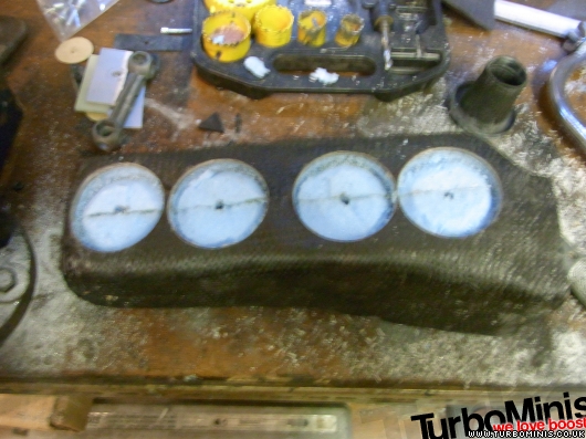

What did you use to make the mould for your plenum? Looks good
If only I knew. It's a high density foam. It was left over from a plenum my mate made that he gave me. It's lots of bits stuck together.

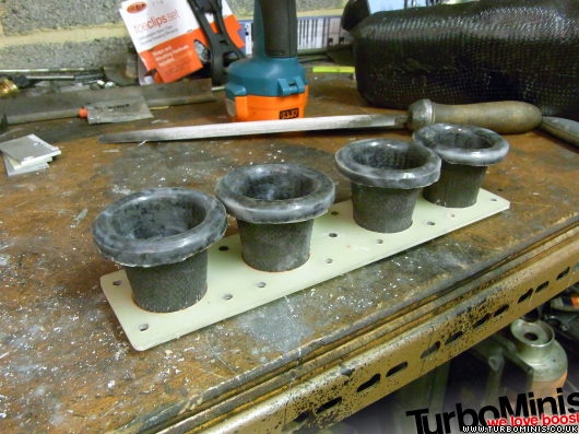

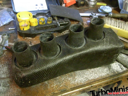

Well the plenum is neary finished
I have now stuck the trumpets on, just no photo. Just the flange to do now.

Nice work!
I keep meaning to have a go at making a few carbon bits,how difficult did you find it?
Well this is the first time I have had a go and I got better as I went along, I also had an expert mentor.
I'm generally happy with the result, but as always I could do better next time.
I think the basics techniques are easier than welding, but knowledge of materials was the tricky thing. Now I know what I know I could build a CF house! (maybe)

Is the air box 2 piece? If not, how did you get the foam mould out?
Always wanted to try my hand at CF moulding
you melt it with celulose thiners.

Ahhh, I see.
It is most likely the same high density foam art/design/model makers use - my son used lots of it when he did his HND in graphic design and I have a large box of offcuts left behind in his old bedroom. He got his from a specialist art/design outlet in Norwich. He only used it with GF, not CF but the principle is the same.
I kept the box of offcuts as I too was thinking about doing it this way after the time it took fabricating a plenum/inlet in aluminium by machining and welding.
You've certainly made it look easy Wil :)
Was your mentor they guy on here a while ago who made one for an injected Imp ??? (it was the pictures of his that first made me think about it).
Yes Eric with the Clan (Imp engined)
