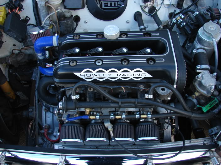

I use a K&N fitted on top of a transfer case breather can. I cut the top off the breather of course. Cam cover breather and head oil drain, both joined up at the breather can, and the two oil drains from the back of the head and the one from the seal plate drain back to holes drilled and tapped into the tappet chest. I now have another hole lower down for the turbo drain *happy*
You can see the breather filter just in this picture
