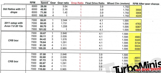

Using the above ratios I have made the following. It is a comparison between std ratios and the SC set (yes I know you all use the clubman set, but I don't). It seems that using a 3.9 instead of the 4.1 makes sense for my setup.
Basically, if someone made a kit and it could be done for reasonable money, I'd give it a go.
