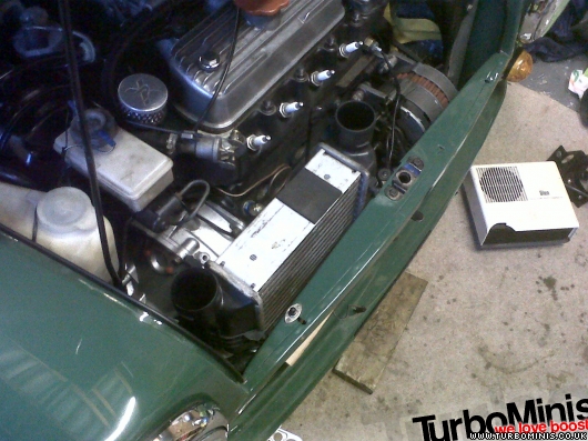

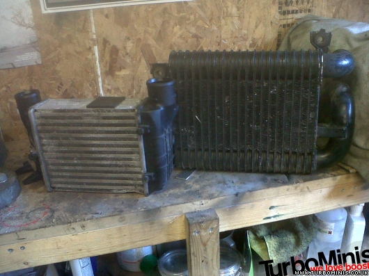

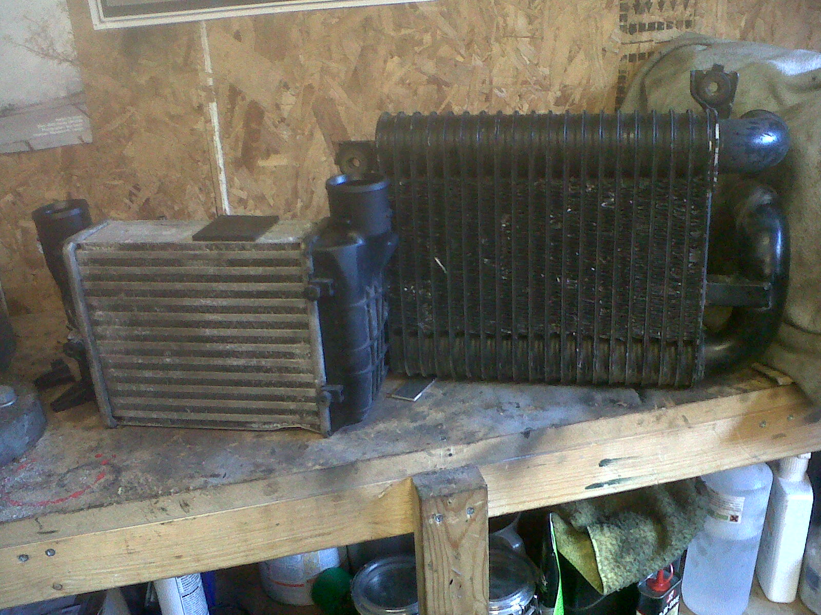

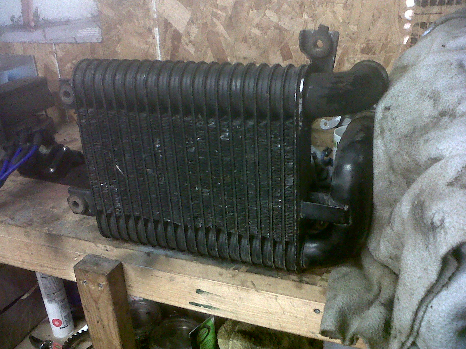

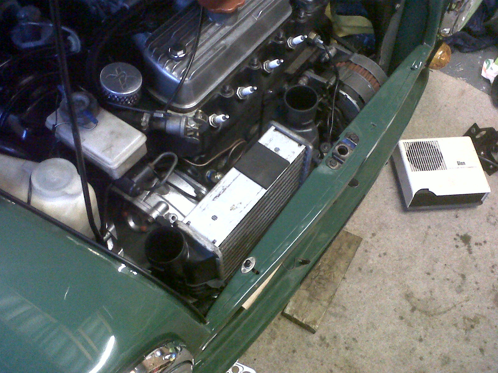

more toys arrived last week *happy*
one being the intercooler, with is bigger than the guy said when i as the question about it *angry*
he only measured the core which would of fit perfectly if it was just that size.
lucky enough another member of NWMC came to the rescue with an Audi TT on that is much smaller *happy*
tried some test fitting and looks like the TT one will fit without much hassle apart from having to remove the air scoop and make a new coilpack bracket, bonnet stay will have to be put in the car as it will foul a hose :roll: just need to order a couple of 90 degree silicone hoses to check clearance.
also received another carb which looks like the turbo / engine it came off had a slight KABOOM issue (oil everywhere) sure i can make a decent turbo carb out of the two n/a then one can go back on ebay *happy*
thanks again to Brett for the plenum and intake manifold that also arrived.
mini getting MOT's next saturday then off the road from end of october until april, when hopefully the turbo engine will be completed and running.
Edited by lee.pb on 28th Oct, 2013.

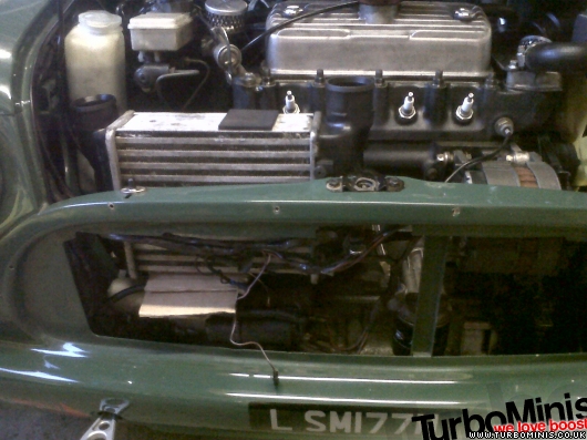

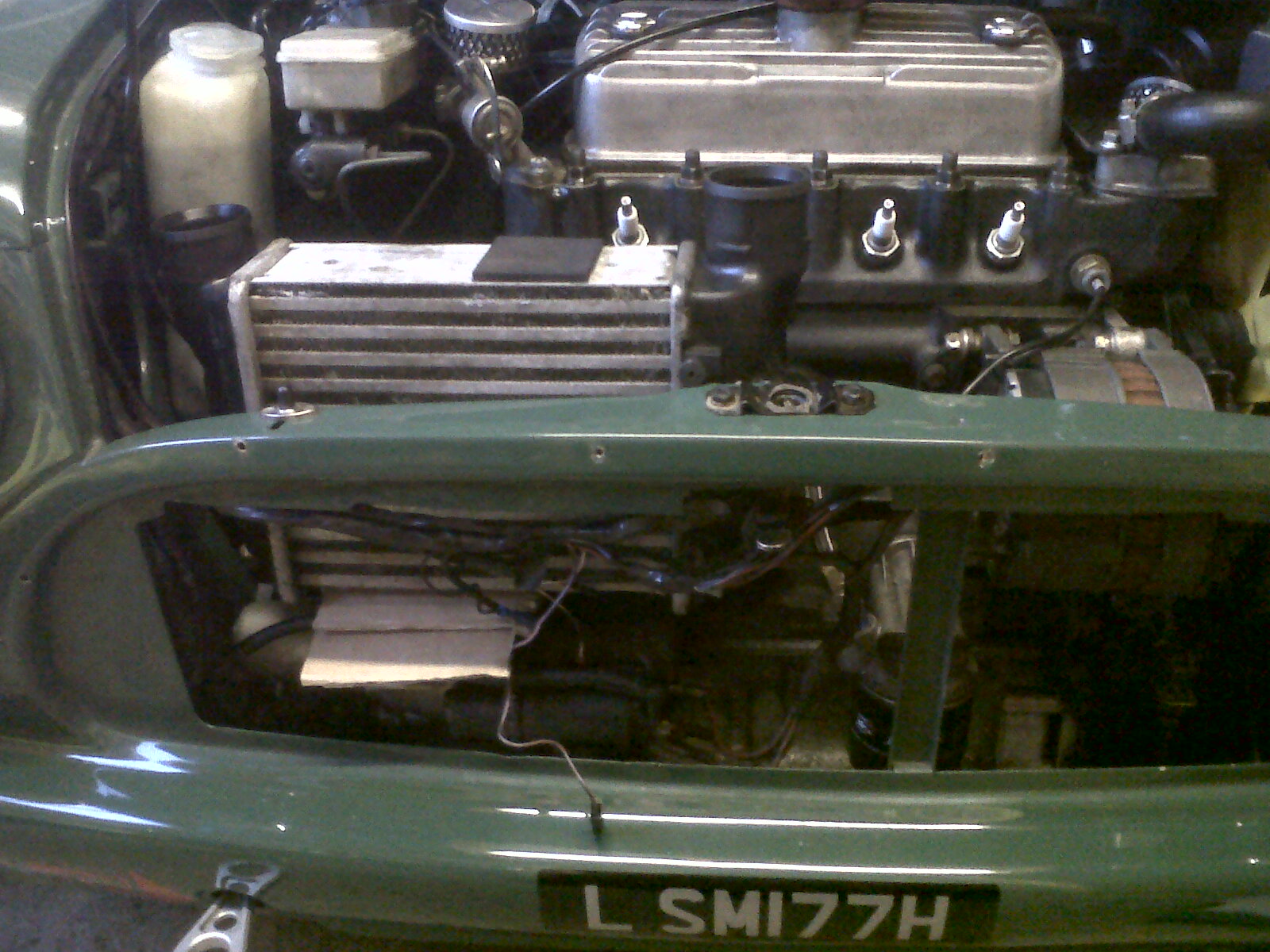

Are you going to duct or cut holes in the bonnet for the cooler? The reason i ask is i tried the tt cooler in mine but didn't want to cut holes on the bonnet. I ended up changing it for a seat ibiza unit which i got sitting behind the grille.
lee.pb
1425 Posts
Member #: 9199
Lancashire
its a work in progress at the moment rob, dont really want holes in the bonnet if possible as looking for that sleeper look *happy* more than likely create a scoop to force air through the cooler than around it.
may have a look at the seat intercooler too *happy*
I'm after the same sleeper look. Don't me wrong, the tt cooler is supposed to be good, just didn't suit my install.
lee.pb
1425 Posts
Member #: 9199
Lancashire
been looking through your build gav and my engine bay will be very similar to yours when completed *surprised*
was looking at removing the brake servo but see you manager to route the cooler pipe around it, is that pipe off the seat too?
the only issue is it may foul my coilpack bracket thats fitted to my bell housing *angry*
A couple of the hoses i used came with the cooler so i'm assuming they are off the same car. It was pretty tight working around the servo and the breathers but it all just fits.
Let me know if you want any more specific shots
