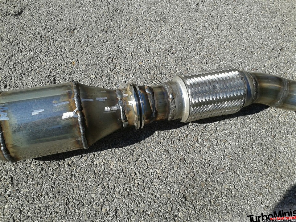

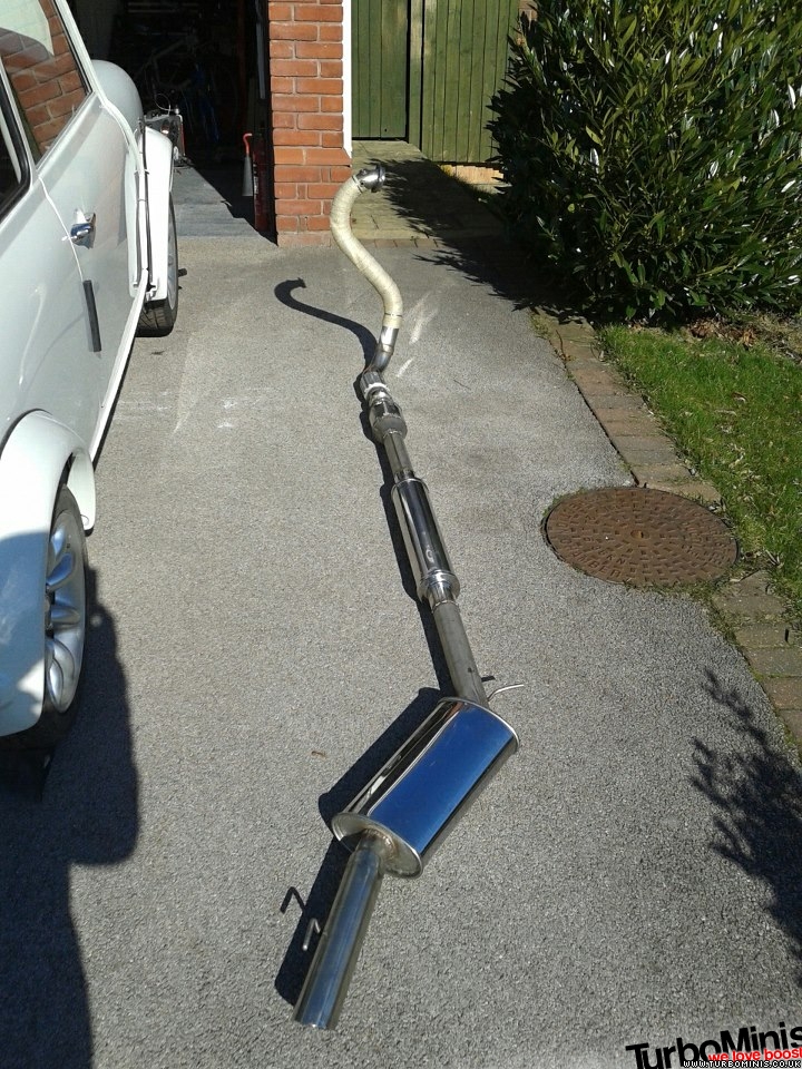

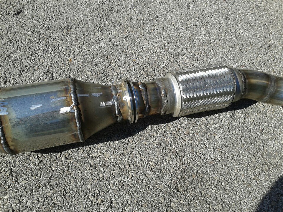

Today I removed the entire exhaust for the last time and welded up the exhaust joints completely, and refitted it back on the car for the last time *happy* I used a Vee Band joint for ease and simplicity of assembly/ disassembly. The cat is a cheapo metalic core item that came in three pieces. It might be a load of shit, but its got the right size holes in it at the very least *happy*
Finished off a few other bits including fitting the wiper motor and wipers. Not much left to do, the list is getting shorter.

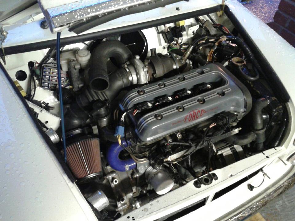

Have you got some plans in mind for IC ducting?
No plan for ducting at the moment. Going to see how I get on with it first and worry about it later.

Looks great. I like the IC position :)

Still a long way to go. The plenum is still not ready :( I'll need to get down to the workshop and get this sorted, as it is a hurdle at the moment.
If there ever was a 16v turbo mini from the factory, this is what it'd look like.
