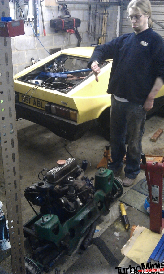

What's up with it?
Was it fook driver error you cheeky twat.
I was driving with spirit down a country road when I went over a bump. The gear selector wahcked on the floor and broke some part of the internal gearbox gubbins in the box. Engine out to get it fixed.
Problem is stopping it happening again. Plan is:
1) modify the selector to raise it
2) add bumpstops as none are fitted
3) ad sacrificial skids to protect the selector.
There is no chance of fitting a sump guard, it's too low already.
oops. I've got a spare frame thingy for the gearbox end if you want it to modify.

Oh no, saw this parked round the other day looked good, I suppose at least its happened now at home and not on the ferry ramp/ rural France
On 5th Oct, 2014 Shauna said:
The Morris Ital assassin!
This is the bit that has bust
http://www.minispares.com/product/Classic/...k%20to%20search
Anyone got one knocking around they'd like to donate? MS price is a bit steep.
I've got a good few chucking round.

Fancy bobbing a doda in the post. I'm happy to pay for it, just not £40.
Wil
I'll dig one out after work tomorrow and send it up to you.
Bummer wil, ud think the handsome guy in the picture would have a few spare. lol
