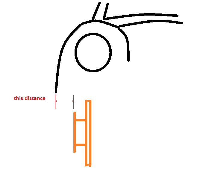

hey guys, anyone who reads this, do you have a measurement from the hub face (which your wheel mounts) to the edge of the guard?
actually, maybe just those with 7.5" 's' disc setup, i assume the 8.4/7.9" could be different
