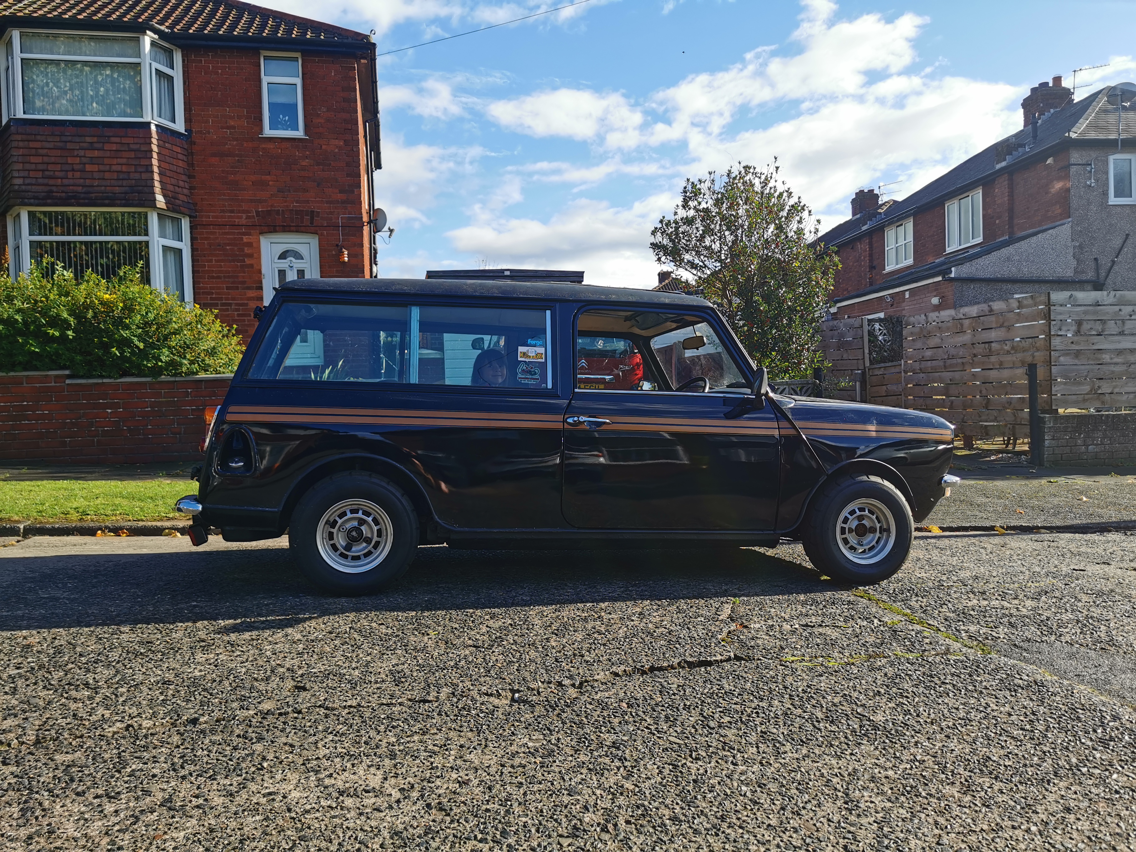

Monumental day today! First MOT in 8 years and it passed! Took the mini for a little rip and its awesome! It's running rich at the moment. I've got a BCA needle in the carb.
I was just want to say thanks to this forum, because without it I don't think I'd be where I am now with the car. Hoping to get a few road miles on the car as a shakedown then get to the rollers. I was planning to use Mike's rev shed (brown cow racing) as he is local and knows turbominis.

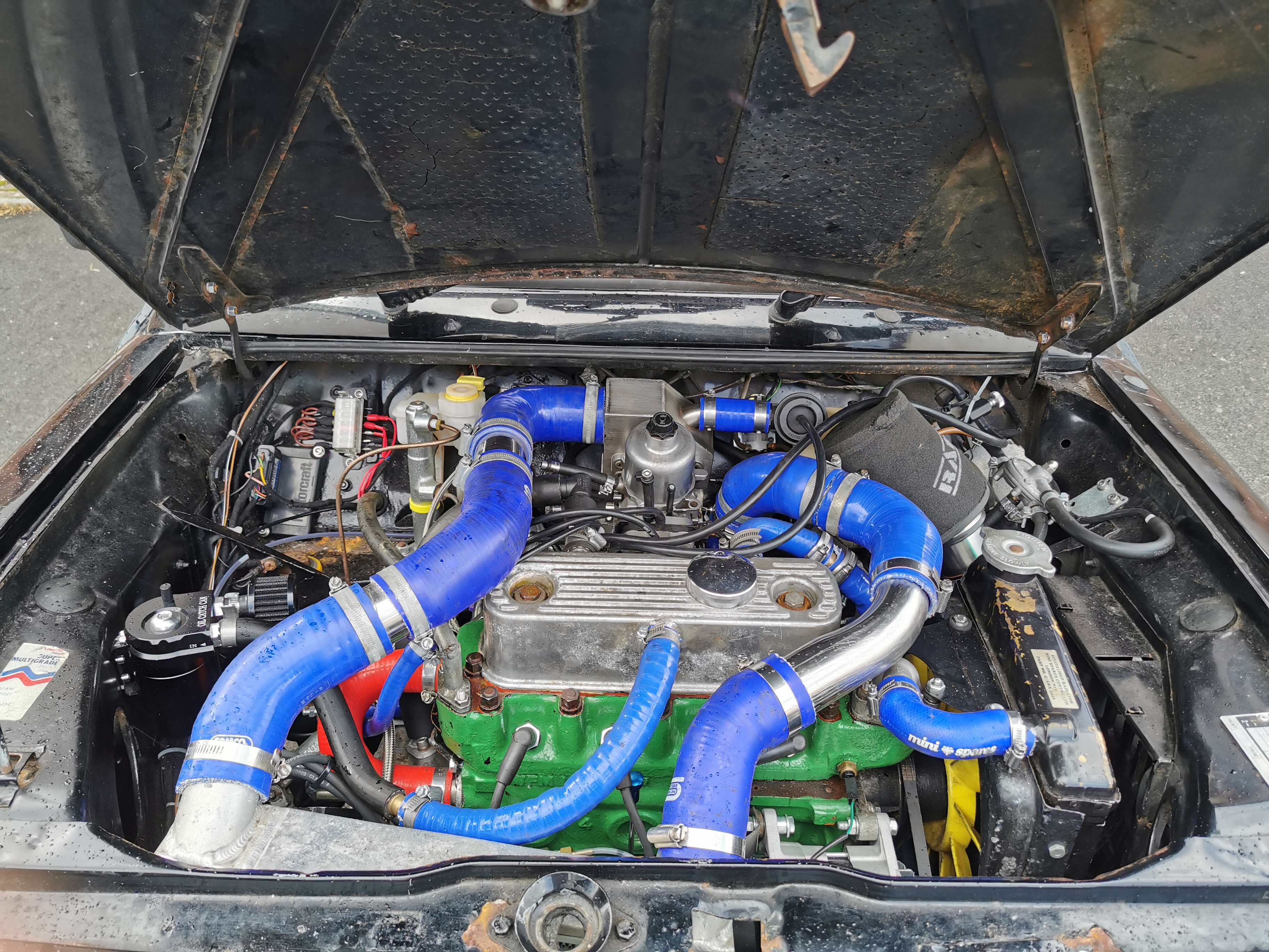

The rolling road with Mike is booked for next Saturday. I'm busy this weekend sadly. I drove the mini yesterday to pick my daughter up from school. It seems lean at low revs, think I need to richen the idle up a little.
Currently boosting on actuator pressure which is around 0.5 bar. AFRs on boost seem good. Before next Saturday I'm going to re torque the head studs. Gap some fresh plugs, change the HT leads for new, and swap the current oil for CTV.
I hope to run around 1 bar if boost. Anyone want to guess HP?
Engine is
1310 with omega 10cc pistons
Avonbar phase 2 cam
6581 crank with ARP rod bolts (standard a+ rods)
Benross cylinder head (can't remember exact spec came off oli79s car)
Minispares clubman S/C C/R box
Jack Knight straight cut drops
RTS clutch and minispares lightened flywheel
Fusion fabs manifold and downpipe
Chinese GT1752 turbo
Bosch BOV valve
Ram Air filter
Playmini 2" exhaust
Forge bleed valve
AH fabrications intercooler (same as Nic before he went side mount)
Megajolt
X pin diff
Minispares super cool 2 core rad

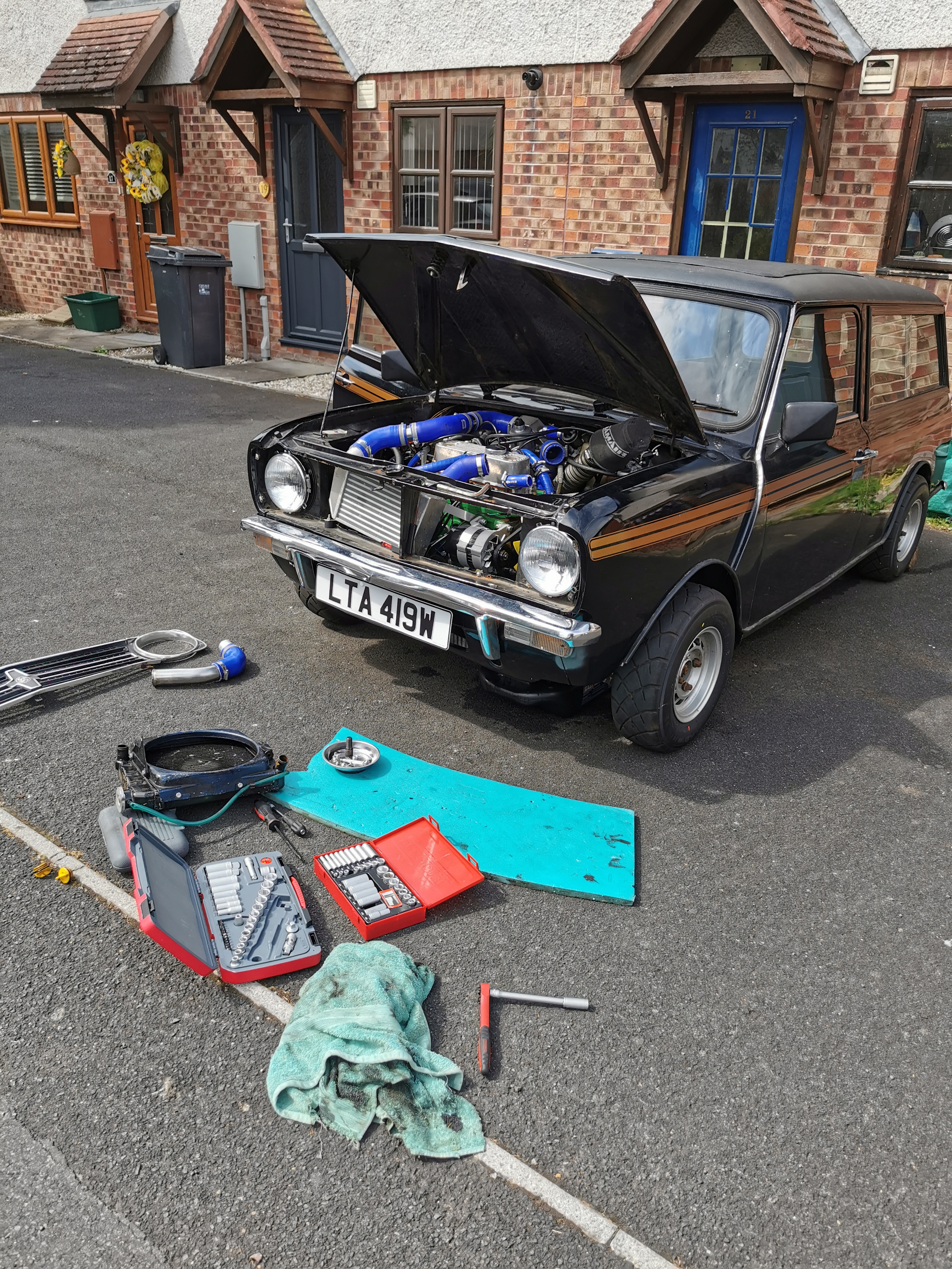

Took the mini to work yesterday, I richened the mixture screw before I left. That made the low rpm a little smoother. I re torqued the head while I was there, its drilled for 11 studs.
On the way home I pulled over as the engine was warm, and richened it a touch more. Low 13s/high 12s Afr at idle the engine seemed a lot happier pulling from low rpm now.
At home I swapped the wiper arms and blades over. I had some cheap chrome ones that were useless, also one of the blades was a defect on the MOT. I've fitted the black hook type used on the later minis with bosch blades. I checked the manifold studs and tightened those up. I also ordered a forge dump valve to replace the plastic bosch copy I have currently, just for peace of mind.

You've a very good chance of those numbers and upward. I'm very interested to see what this engine spec does with mine in bits currently... Tyres may be your limiting factor on the rollers.
BCA (if standard) will lean out at towards the top end and will need polishing to buy you some fueling for the boost.

BCA is a lot richer top end then the BDD. I've got both so I might swap them about this week and see what the AFRs are like.
