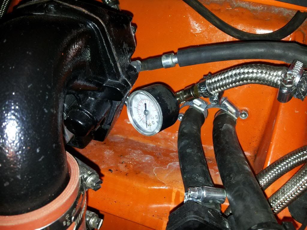

I have a pressure gauge in linr between the reg and carb. With the pump running it shows 4psi.
While running you can blow hard down the tube to the top of the reg and the pressure will increse.

As the car drives along, and I ask for more power (put my foot down) I can look at the air/fuel ratio gauge (lambda) and see it go slowly into the lean end, until it finally goes full lean (into red zone) and then the engine will cut out for a moment or two. I stop, look under the bonnet and note that the gauge in the reg to carb line has dropped to vitually nothing. With the engine ticking over, the guage will then rise slowly back to the 4 psi as set.
This is how I know it`s about to pack up.
I can then run at no more than 45mph, watching the lambda gauge flutter between normal position (about 12 on the gauge) to going into lean(about 15,red zone) if I ask for a bit more power. Get back home, leave it for a bit, check whats coming from the pump (flow, not pressure as we have worked out) stick it back together and we go back to square one.

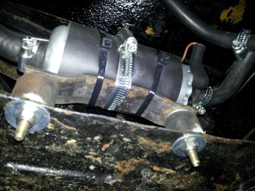

If it runs ok on the rollers and not on the road. It may well be fuel in the tank sloshing around, making pump go on air, and pump unlabeled to prime again? Baffels may be required. Fitting in the tank.
Is the pump in front of the tank?
Also,you need to extend the pipe work out of the bonnet so you can see the fuel pressure whilst driving.

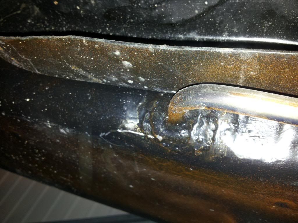

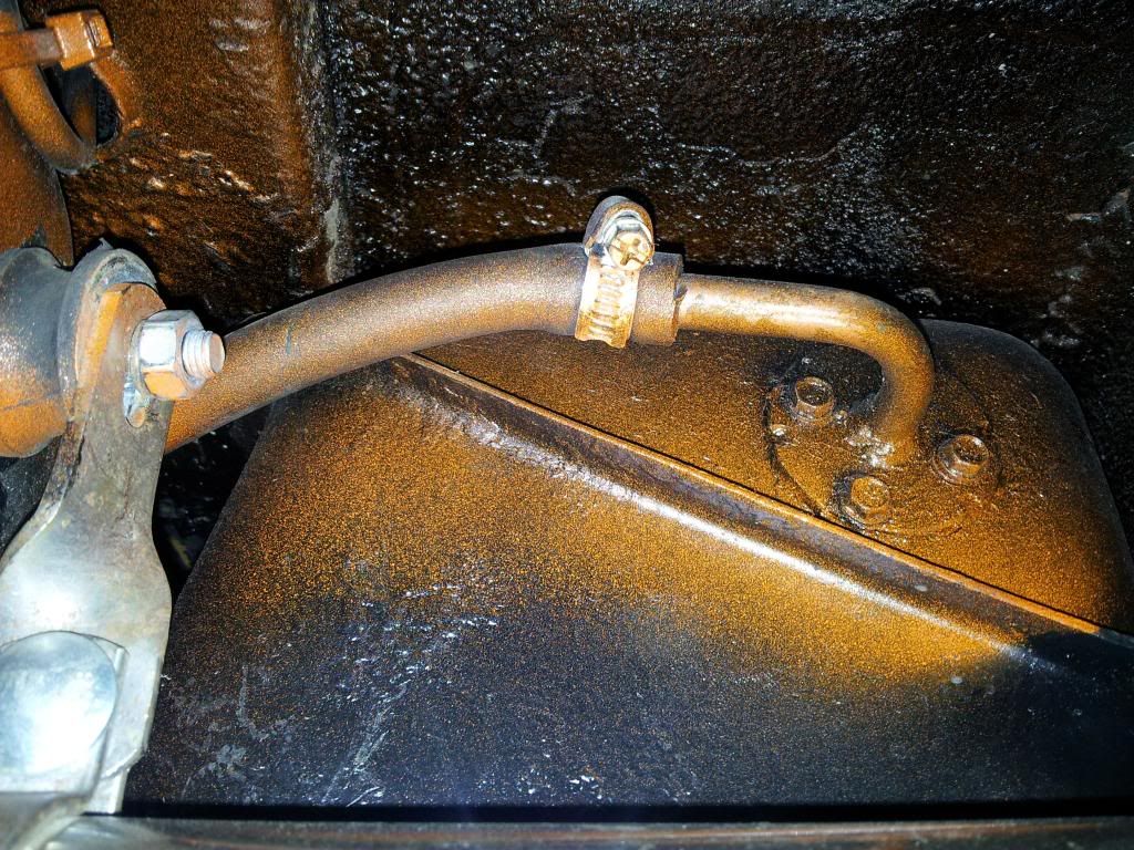

The long wheelbase tank's fuel outlet has a dip tube that extends in and down to the centr of the tank. There is usually a circular recess in the botom of the tnk that can be seen from the outside.
The fuel supply you have welded onto the bottom may be an issue with fuel surging in the tank?

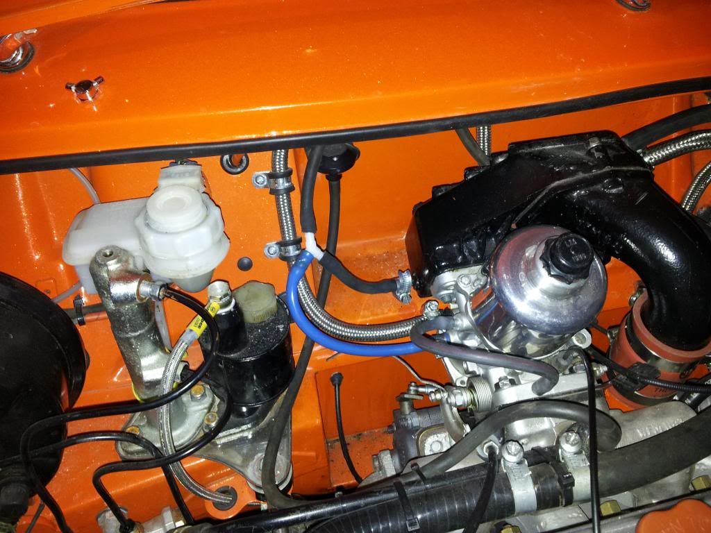

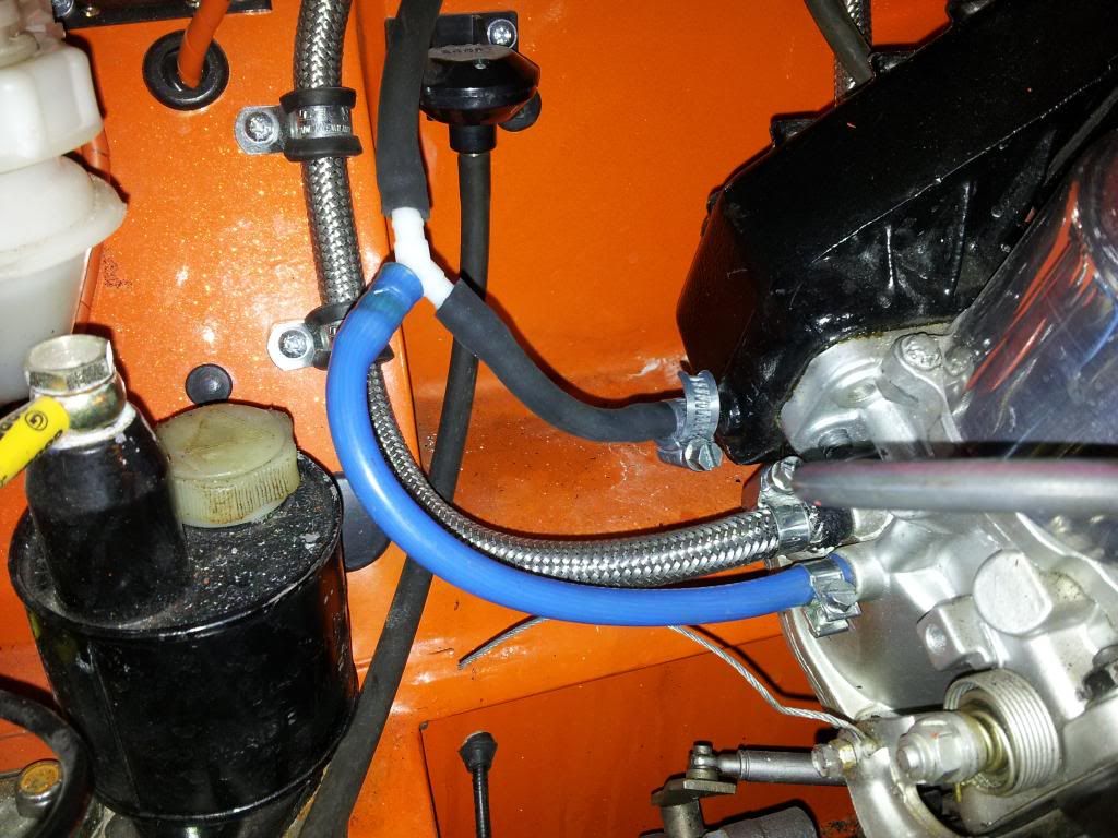

What's going off here with the blue hose? Shouldn't that be blocked of rather than t'd into the boost sense line? In my mind that would equalize the pressure in the carb body and plebnum, negating the restrictor ring in the plebnum and making sure it runs out of fuel on a run.
Carl S
1927 Posts
Member #: 1761
Stalker
As above. To test it, put a clamp on the blue hose and try again. From memory, the anti-run on port should be blocked off.

You've got the balance pipe connected? Could that not be causing it to run lean under load, stalling the car. With the engine off the fuel pressure will naturally fall back to zero (mine does anyway) so I think what you're thinking is a loss of pressure is just due to the engine cutting out. When you switch the engine back on again the pump will bring the pressure back up.
Try disconnecting and blocking the pipe that goes from the side of the carb to the front of it on the top
Edit: and that blue hose looks to me like the tee piece trick?

Two things from your pictures. Is that a turbo carb? I ask as the dash pot does not resemble that of a turbo cacarburettor. If it has a new dash pot or has been properly modified all good.
Second the blue pipe you have connected to the float chamer vent should be blanked and not 'T'd into the sense line for the fuel pressure regulator.
Third, check the balance pipe for cracks or holes as even a pin hole will cause the exact symptoms you describe even down to the speed at which it occurs.
Fourth and this is a common oversight that I will try to keep simple, the feed pipe from the tank to the pump has got to be of a larger internal bore than the inlet of the pump. Many may say this is not necessary but what you will here Is the tone of the pump change from a low hum to a higher level pitched whine, that pitch change has signalled cavitation in your pump which will cause it to stall. When this happens your fuel pressures will fall to zero and you can disconnected the outlet with the pump still running and no fuel will come out.

On 2nd May, 2013 Mr Joshua said:
Two things from your pictures. Is that a turbo carb? I ask as the dash pot does not resemble that of a turbo cacarburettor. If it has a new dash pot or has been properly modified all good. [color=red]Yes it's a turbo carb. the dashpot has a cover on it by the looks. also, any dashpot will be fine it is the same internally turbo or non[/color]
Second the blue pipe you have connected to the float chamer vent should be blanked and not 'T'd into the sense line for the fuel pressure regulator.[color=red]this is commonly referred to as the 'T-piece trick' and will not cause a problem[/color]
Third, check the balance pipe for cracks or holes as even a pin hole will cause the exact symptoms you describe even down to the speed at which it occurs.[color=red] When mine was split it wouldn't make boost or drive at all[/color]
Fourth and this is a common oversight that I will try to keep simple, the feed pipe from the tank to the pump has got to be of a larger internal bore than the inlet of the pump. Many may say this is not necessary but what you will here Is the tone of the pump change from a low hum to a higher level pitched whine, that pitch change has signalled cavitation in your pump which will cause it to stall. When this happens your fuel pressures will fall to zero and you can disconnected the outlet with the pump still running and no fuel will come out. [color=red]true, but he has the return 'teed' into the pump feed, this help stop this happening[/color]
I have come up against everything you have posted so you need to verify what I have posted.
