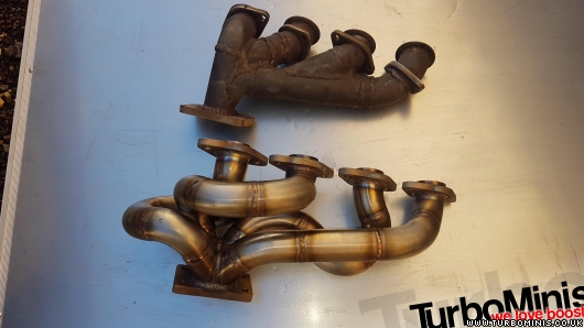

The problem we have is the power. We changed from a really bodged up 'log' type manifold to a nice equal length jobbie. Like below

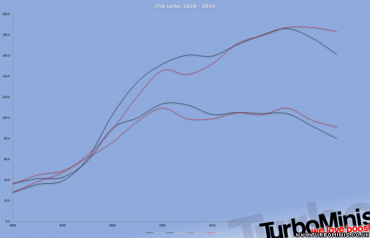

and the power changed like this - Black is with the new manifold, Red with the old (note this is transposed from a print-out, so not no comments on some odd bits)
What I'm after is thoughts on why the power seems to suddenly drop off at 9500 rpm. It's clearly spooling the turbo up earlier and making more low down torque, but not sure why it suddenly falls away. Thinking about manifold header lengths having a similar effect to a cam change????
For information, following this session at a test day the engine lunched itsself. The failure was cased by a sticking exhaust valve. Could a sticky/leaky exhaust valve cause such a drop?
Feel free to think out loud........
