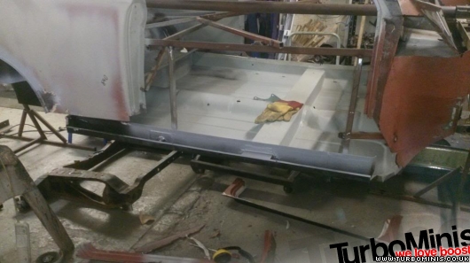

Finished welding the boot floor, nearly 100 spot welds so I'm glad I bought a spot welder. Did
them a bit close where the bulkhead joins the floor but I would rather have too many than not enough
Next I have got to seam seal inside the sills and then the floor will be ready to go in.

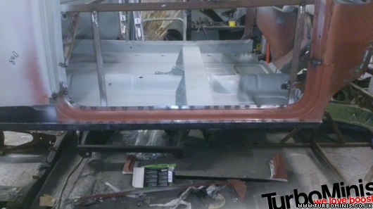

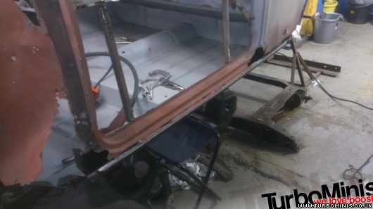

Bad news! Trial fitted the floor tonight and it doesn't fit! Looks like its been crashed into at some point on the drivers side B pillar so its been pushed in towards the passenger side. You can see it with a straight edge from the rear arch to the A pillar...on the p/s the B pillar pushed the straight edge out so it can't touch the A pillar, but on the d/s the B pillar sits about half an inch off the straight edge. Not sure if that makes sense so took some pictures to show it...
How do I go about repairing this? If I cut the bracing out the B pillars will move independently so I could just pull the pillar out until it sits over the floor? Or is that not the right thing to do?
Any thoughts?

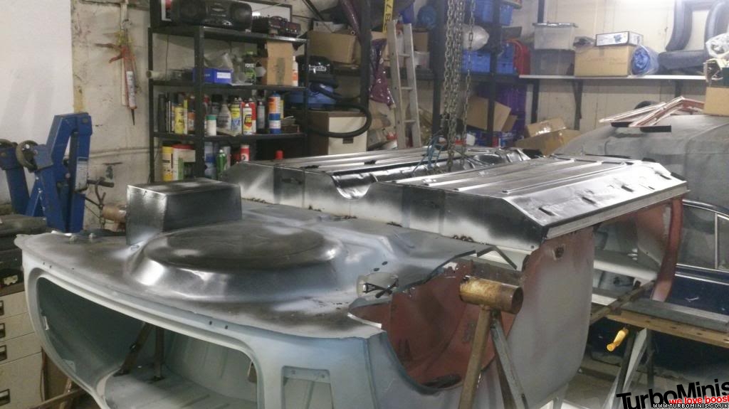

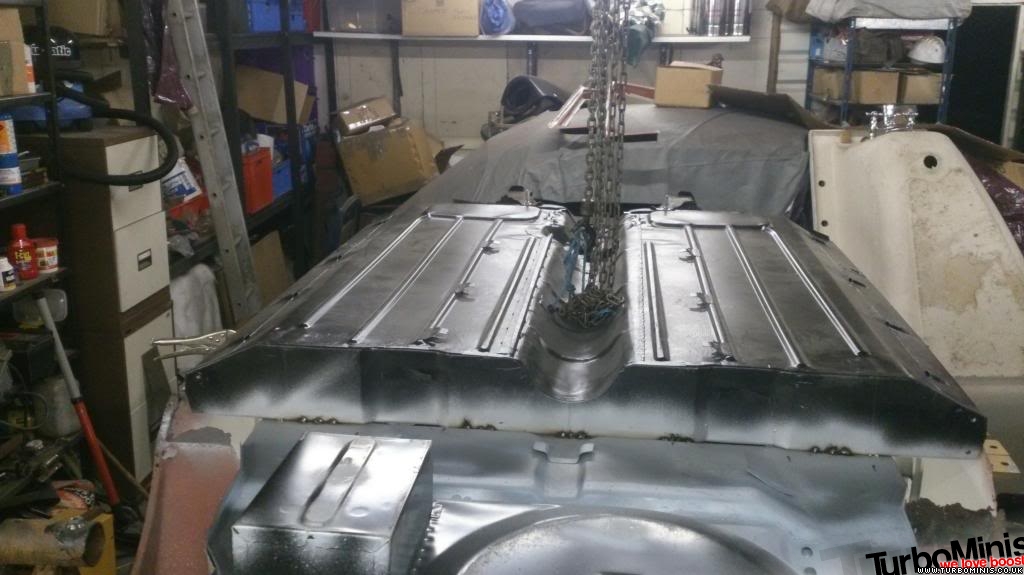

Been working on getting the floor in for the past couple of weeks. Took longer than expected because of the damage to the B pillar but everything lines up now so tonight I put a few welds to hold it, will do all of the spot welding when its the right way up
Will do the arches next so welded a bolt where the damper sits as a reference

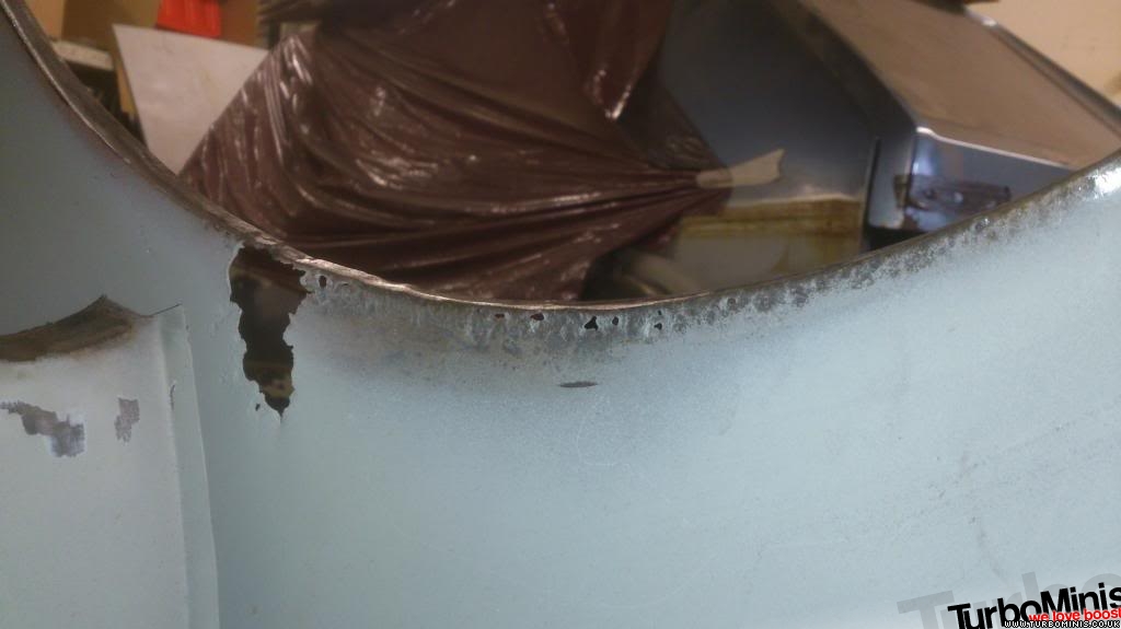

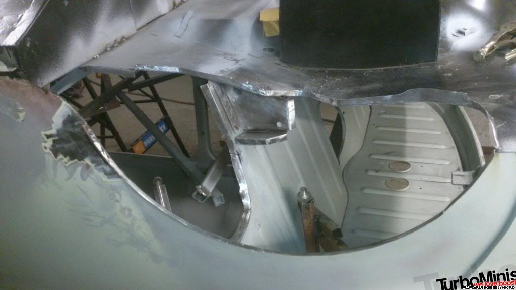

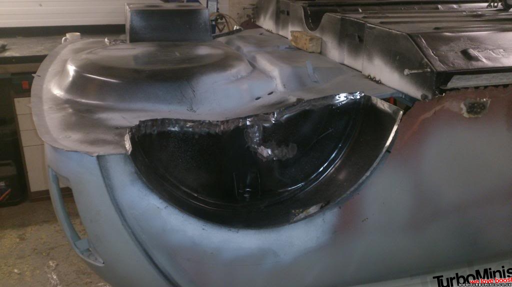

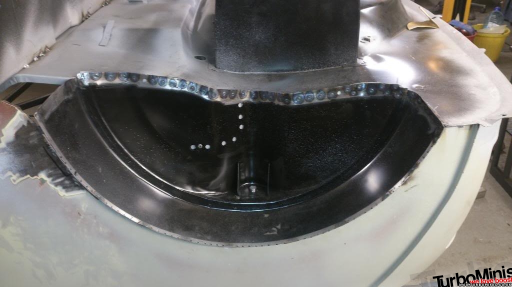

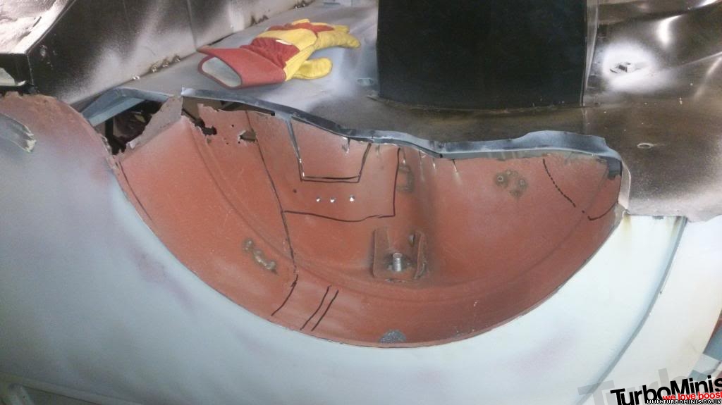

Been working on the arch all week, just got it spot welded in tonight. More welding still to do where it meets the quarter then on to the other side. Some pictures...

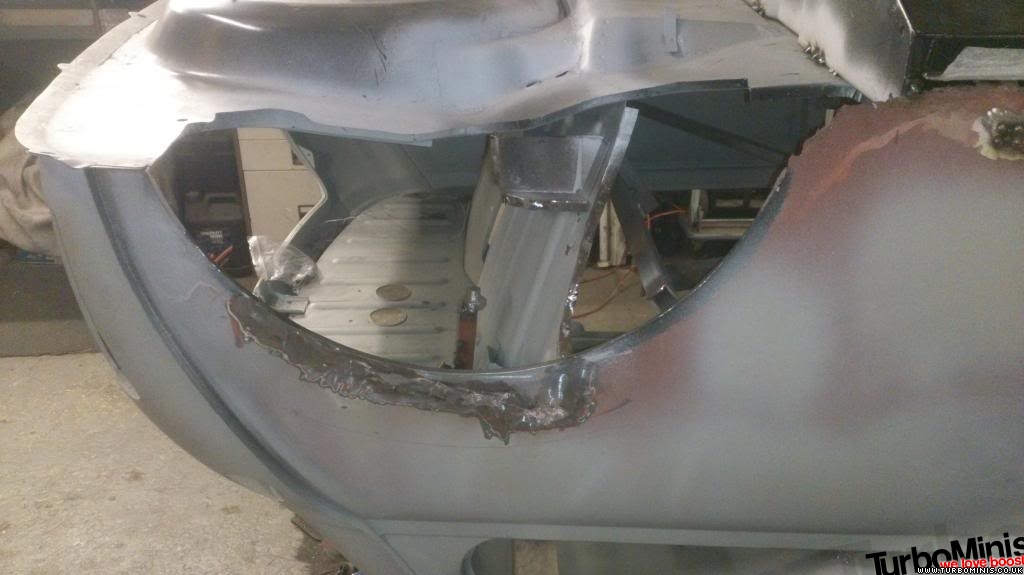

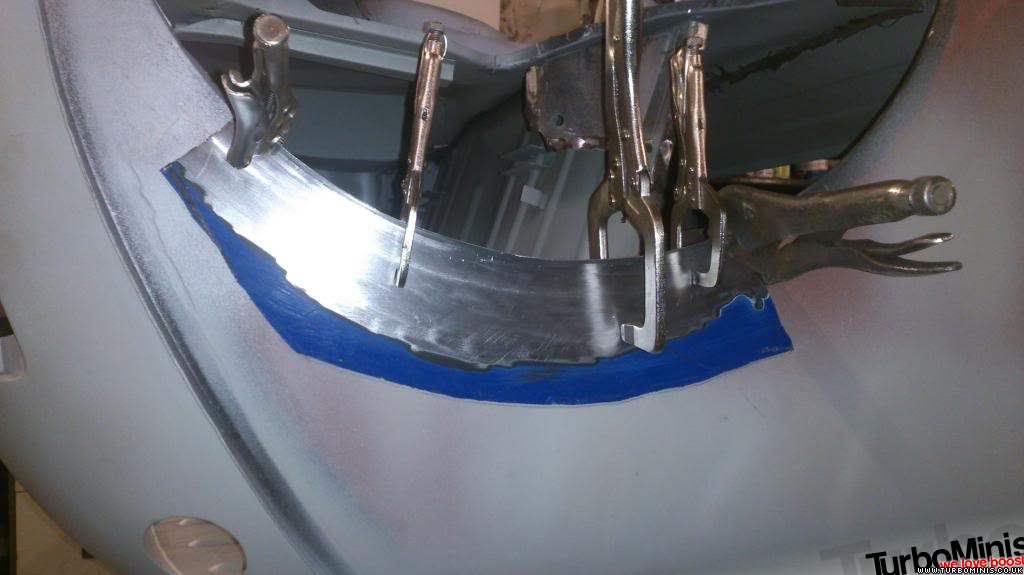

Been working on the passenger arch and rear quater over christmas
When the arch was out I could see how bad the rust was on the quarter, repaired it using a piece from an old front wing as the profile was pretty much the same.
When that was done the arch could be spot welded in

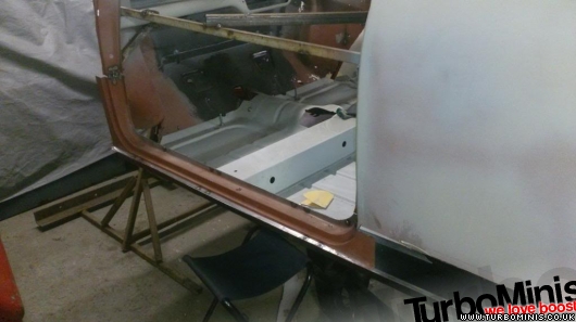

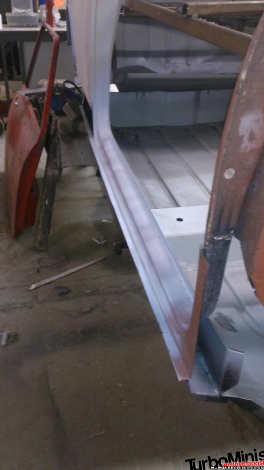

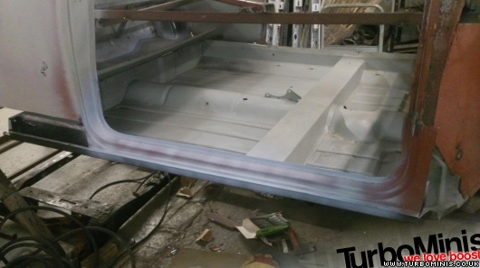

Got the drivers side door step in tonight, still needs some more spot welds to finish it.

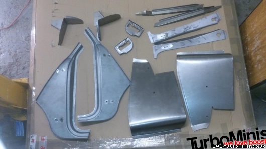

Got the door step finished tonight and some more panels got delivered today, will keep me busy for a while longer

Got the passenger side step tacked in tonight. Took a bit longer to do this side, don't think the pressing was quite as good as the drivers side, it was a bit too narrow.
