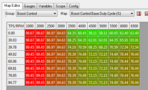

This would depend on the specific settings of the device controlling it. On mine, the ECU has a setting for 'boost valve off below this pressure'. I set this to 110kpa.
I think the Specialist components ECU has something similar

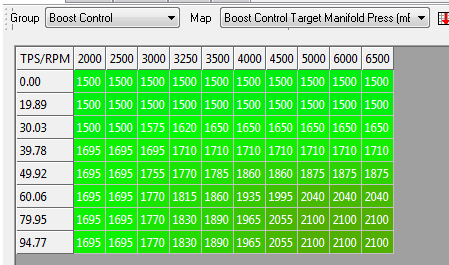

this is the target boost base map, (i'm running much lower boost than this just now):
This is the duty cycle of the valve:
I dont really understand why its operating at idle based on these two tables, i also dont understand why the table only goes to 6500rpm.

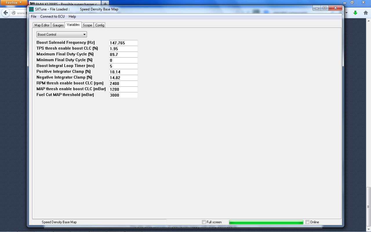

Third and second items from the bottom...... What have you got in there?
nky_84
218 Posts
Member #: 9213
Scotland
ahhhhh. i need to have a familiarise myself with the stuff in that menu too!
Its got 2700rpm and 1200mBar
what does the MAP read at idle?

Just under 1000 I think. 980 from memory

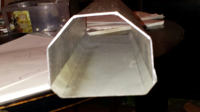

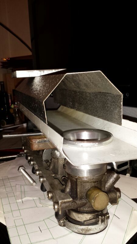

I tend to try and build rather than buy, so the majority of things on the car are made from crap that is lying around the garage. The plenum is very much a diy effort and has held up so far... yes, it uses the original throttle bodies as I had them already

Its not necessarily a great design to copy from, but it should get you up and running at least....

Nice One, I really appreciate the pics. I'll save them if you dont mind and use them for reference when I make mine. :)

it stuck out the front of the round nose i had, but it has miles of room under the new clubman front that im fitting a the moment. No problem saving the pics!
