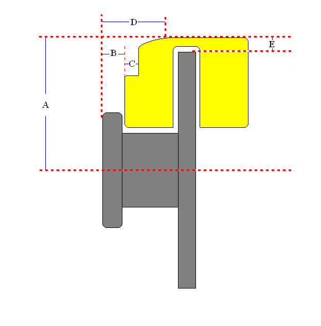

The complete assembled hubs are off my car atm so I could grab some measurements
Any luck what min inside dia of a wheel has to be to fit over 7.9's? Thanks dude

Not yet mate been fixing my brother inlaws disastra ill have a look tonight

No rush dude, Props have to phone/email mini spares or ask simon on TMF what there inside Dia is and JBW email aswell find out what there is and I can ask on mk1 forum for Oringal rose petals aswell

I don't think the 6 pots are designed for a road car as they don't have very good seals on the pistons. Taken from KAD...
The 6 pots are a competition orientated brake upgrade as the calipers are not fitted with dust seals. They are not recommended for the road unless constant maintenance is taken place.
A 111.12mm ( 4 3/8 inch )
B 14.5mm
C 20mm
D
E 18mm
hope this helps, ill grab D when the rain stops
measurements are near as dammit, obviously the callipers are designed im mm *happy*

Nice one Brett Thanks alot dude! ill drop a few emails about find out

Brett did you find out measurement "D" ?
