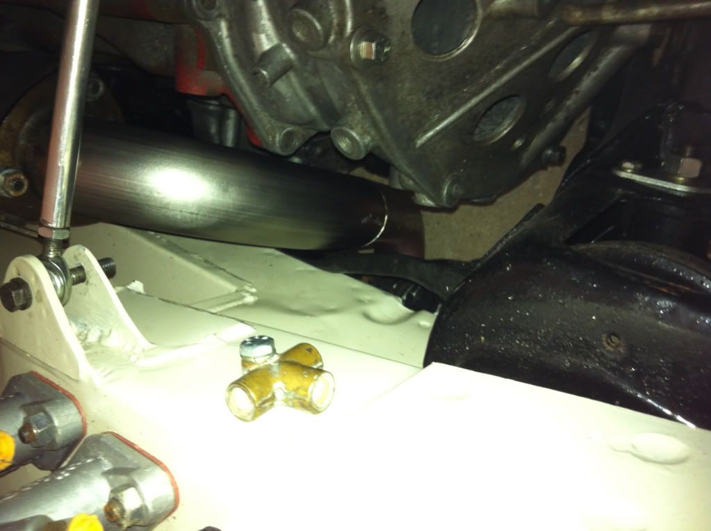

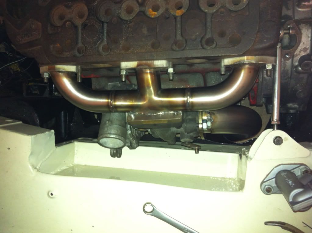

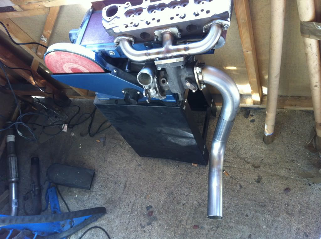

Righty I think I've got the final design sorted. *happy* I did some more tweaking today and I am now happy with clearances and fitment. Just a couple of pics to see if anyone can see any issues with it. What are people's thoughts on the tunnel position? Without going further across toward the gear selector it's about as high as I can get it?
Please keep in mind It's is only a rough mockup that has been tacked together for positioning and not the finished article. and I am using my old clamp until the new ones arrive (should be tomorrow) the new clamps are 8mm thick instead of 5/6mm which mine is. The downpipe should hopefully be all one piece if my supplier can form the bends that close together.
This downpipe is about as large as you can or really need to go to get good power as its made out of 57mm OD stainless, and should fit nicely over a 2" centre section.

Looks spot on to me :).
Where will the 02 sensor boss be?

Anywhere you want, I'll weld them on to order.

Now that's a service!
Can't believe how much room there is down the back of yours, with the log manifold.
