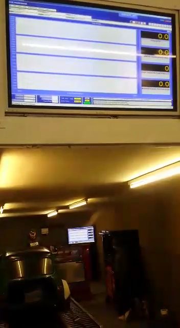

what were the AFr's you were seeing on the dyno at full chat, and other than the power runs, were there any sustained load runs at a different RPMs?
nky_84
218 Posts
Member #: 9213
Scotland
about 12, 12.5 from memory. will see if i can dig out a video.
it did quite a few part load runs where it was held by the rollers at various rpms and the afrs tweaked etc if thats what you mean. Full power runs were short and spaced out, with the massive fan runnning all the time

Early power run - it had old slicks on that quickly overheated, which meant it spun the wheels and hit the limiter as it came on boost. AFR's are pretty rock solid until then though....
The numbers on the screen are HP, Torque @ fly, AFR, manifold pressure.
