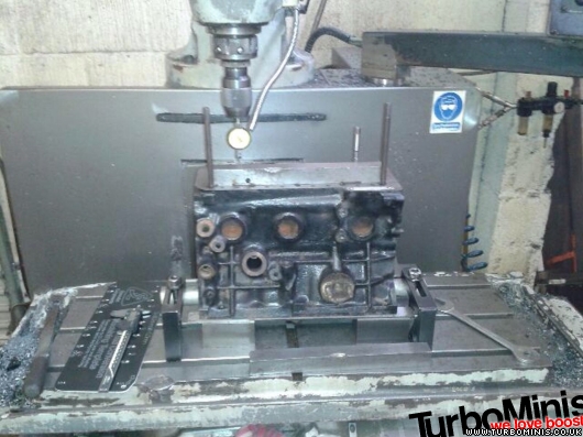

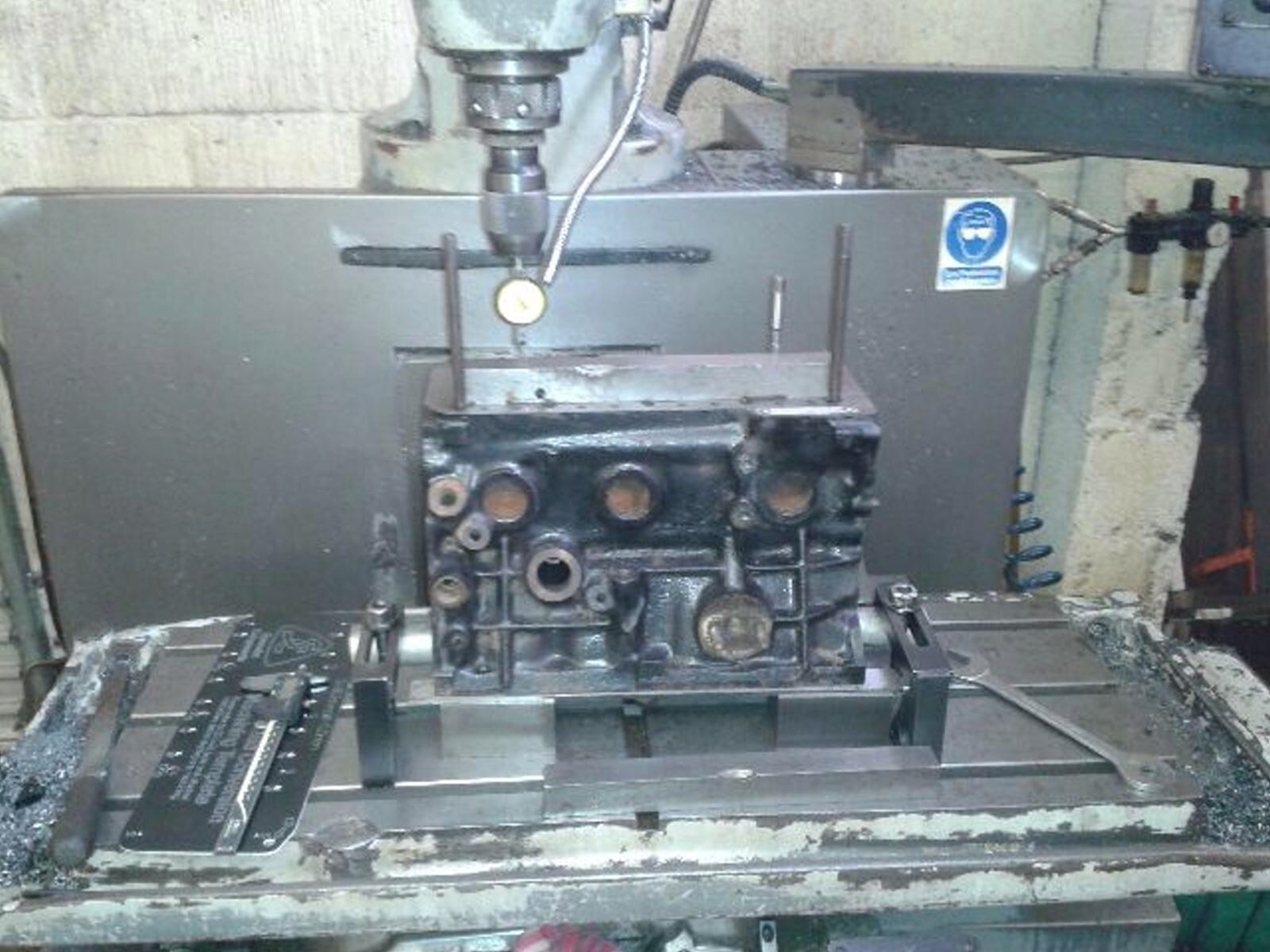

Finally a pic from a pal doing the machining on my block. Wont be long until its home :)

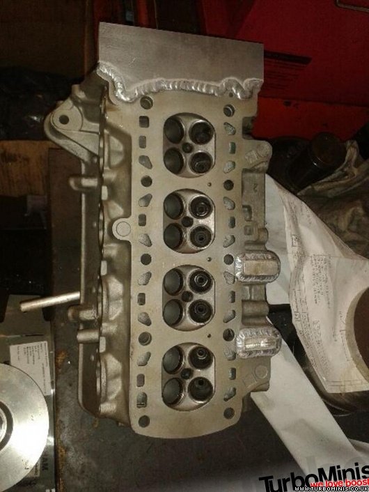

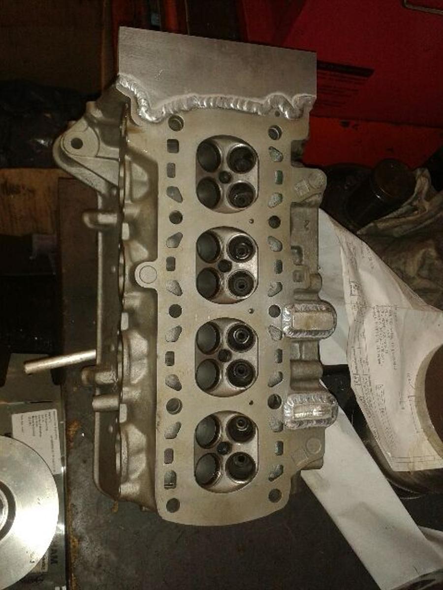

The heads back from the welders. Wont be long now
