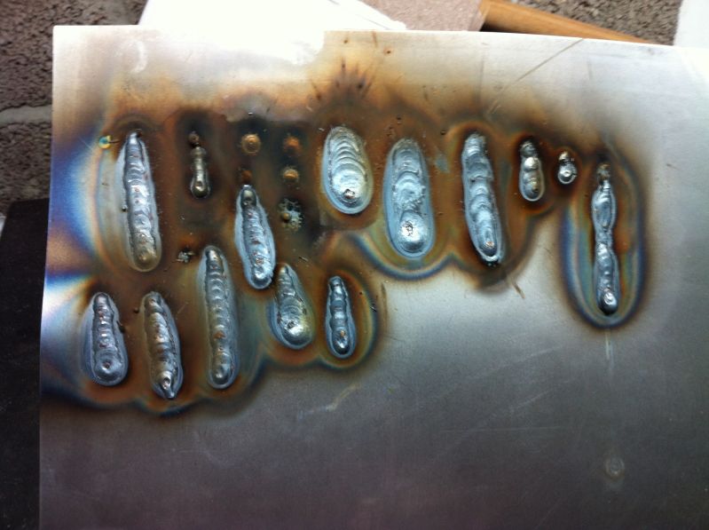

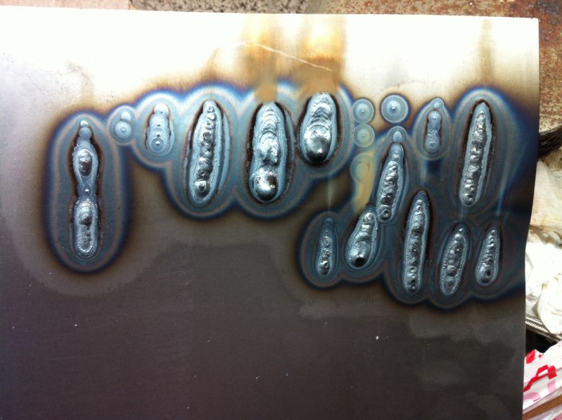

Hi guys, hope Chalkie doesn't mind me posting this but it saves me starting another tbread that's exactly the same!
Finally bit the bullet and thought I better learn to weld, got myself a clarke 110, using 1.2mm steel as it's not a mini, co2/argon mix
I've used a welder before but never done any proper welding, just had a go on my mates to see what's like, I'm just going on the theory of 'make it sounds like sizzling bacon' *tongue*
1st ones are on the left, then just started playing around with the settings, any tips?
Other side:
Cheers!
D4VE
2975 Posts
Member #: 10749
lowestoft suffolk
Looks good and definitely good penetration but you would never just plonk a bead down, try some over laps, butts and plug welding.. least that way your practicing what you would actually be doing when it comes too it
