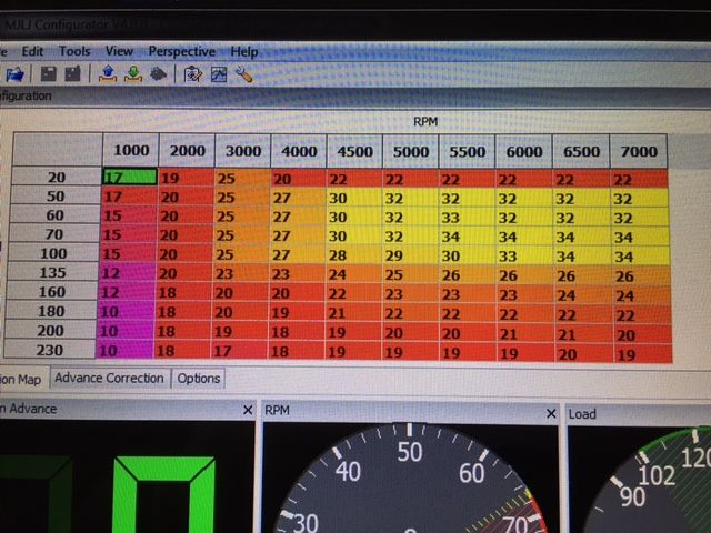

do you think this base map is ok....?
yeah looks ok as a starting point
