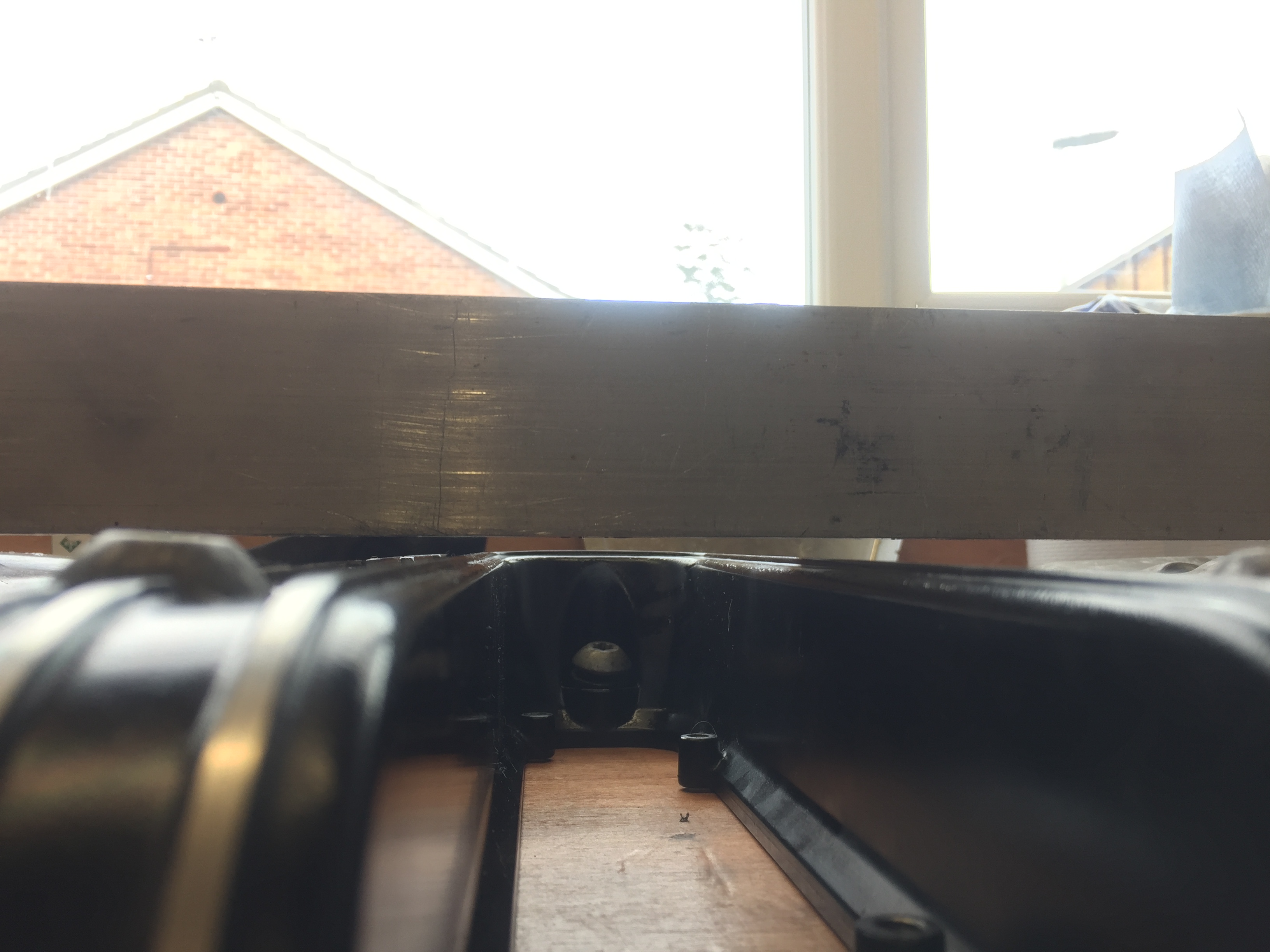

Hi did you modify the hood for the cylinder head?

Surprisingly after some thinner engine mounts I got the engine to sit a bit lower in the frame, with the sub frame mounted miglia style the fg bonnet closes with mm to spare.

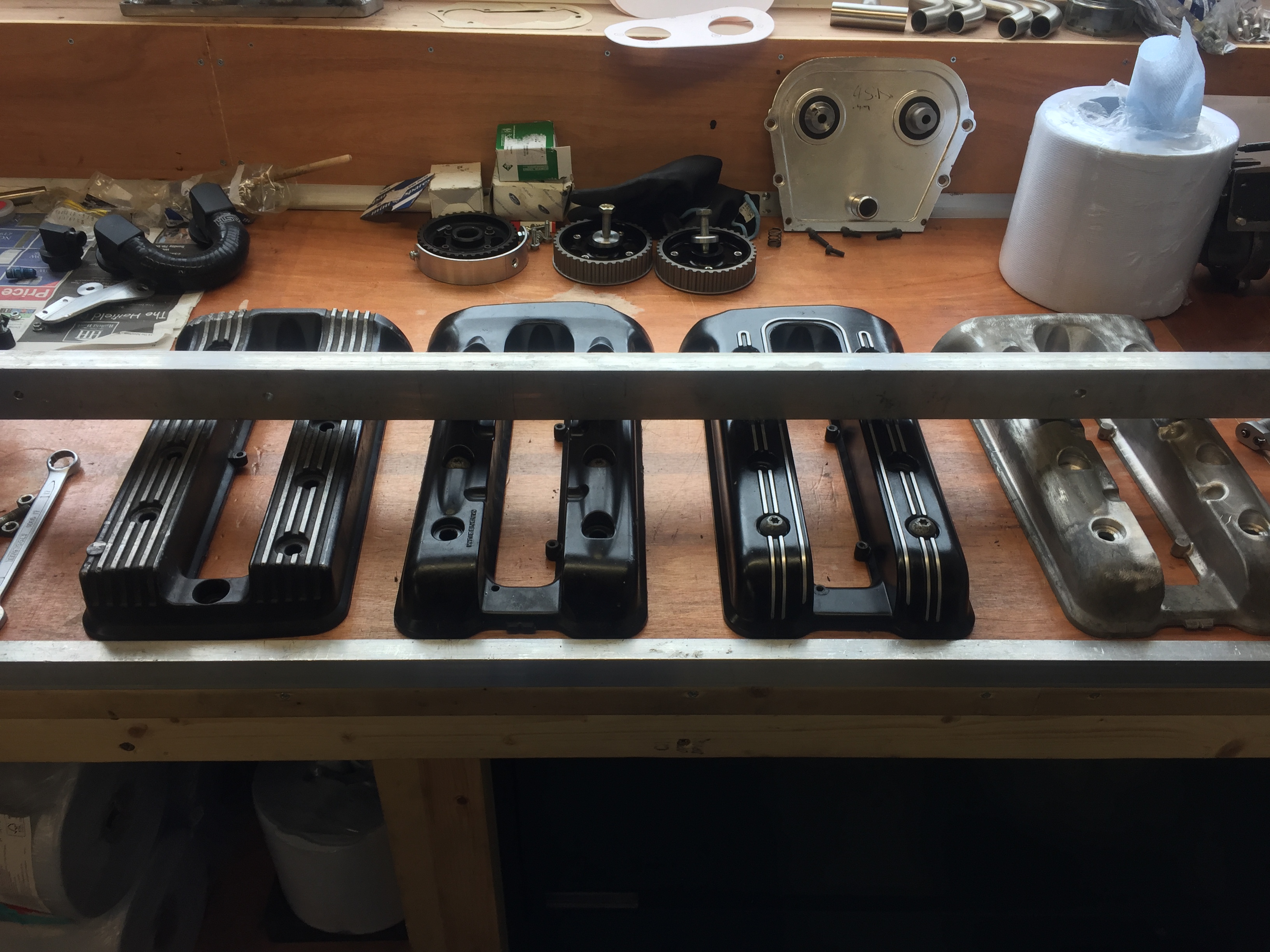

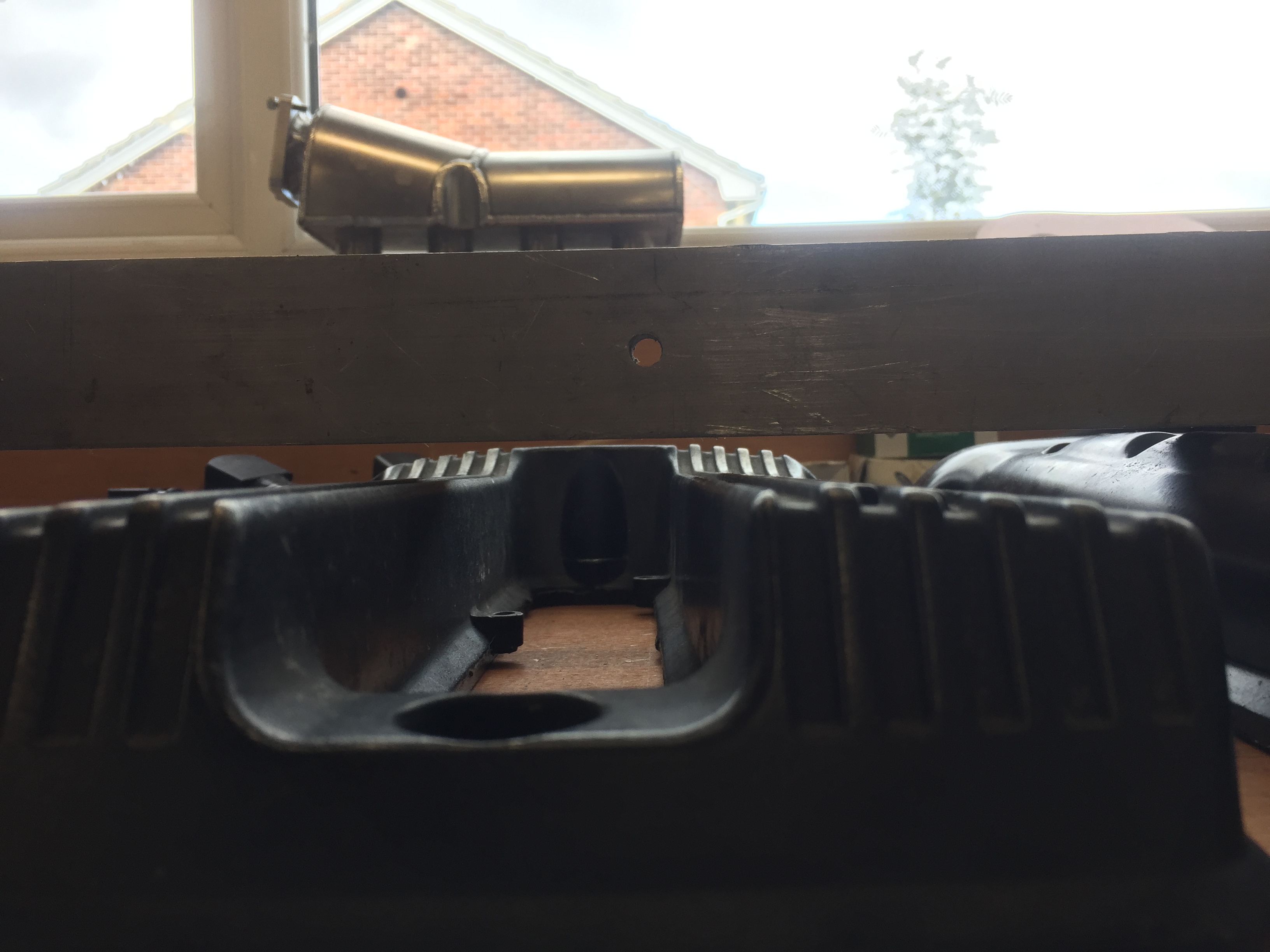

The rocker cover Jayme has used is also the lowest of the 16v ones I’ve had/seen.
The K100 I’ve got is lower still and gave no clearance issues.
Pic’s for reference
Shane
