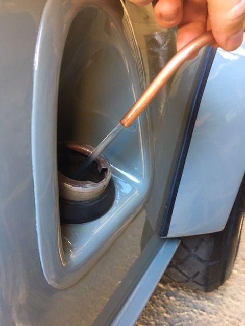

So I thought I'd run a test on the fuel supply before I drop out the tank and start messing with it.. I disconnected the fuel supply to the carb and ran a copper pipe connected to that back to the tank filler.. Like so..
I then ran the fuel pump on the battery for 15 mins, was going to do 10 but kept it going to be certain. The pump ran continuously without any change in tone and without slowing down and seemed to be fine. The fuel pissed out uniformly for the whole 15 mins and didn't splutter, gargle or anything like that... just like this..
So would you agree... the tank pickup, pump and filter all seem to be fine?
To me, I would say so, they seem to be eliminated... the pump never faltered, the filter seemed to be able to take the continuous flow and the pickup.. picked it up lol!
Disconnected the temporary pipe and reconnected the fuel pipe to the carb, pressurised the pipe and then turned the key. She started on the button.
Would you agree? Fuel supply eliminated??

Not 100%... the cap is actually a vented cap and there is a small pin hole drilled that you may be able to see if you zoom in on the filler neck in the last pic.. maybe if I drove it with the fuel cap off to see what happens?
