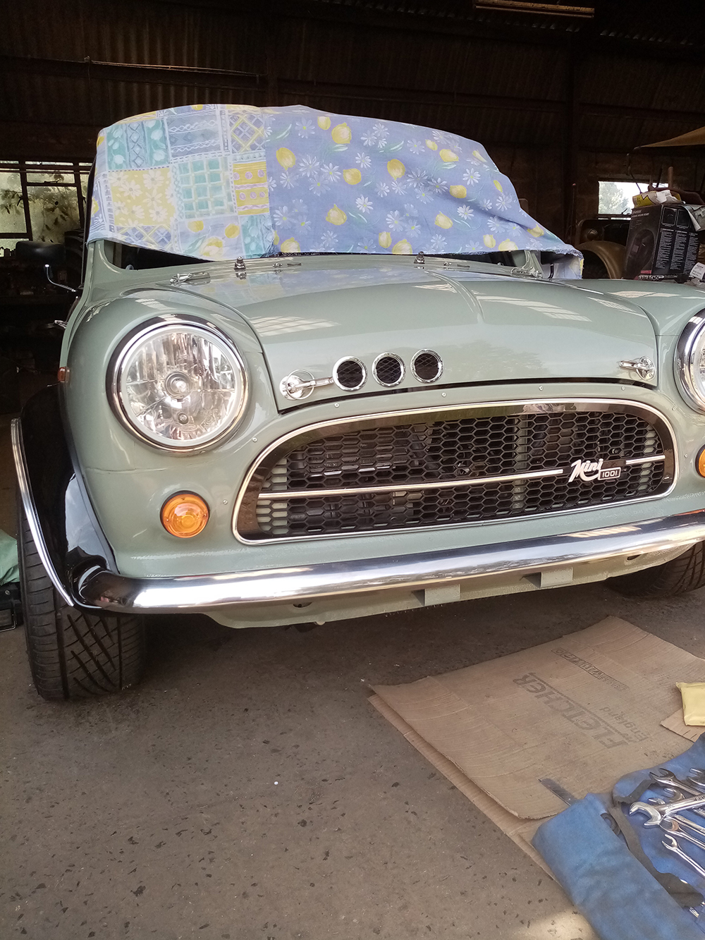

That grill looks good. Nice change from the norm. John

Thanks for the comment on the grille john

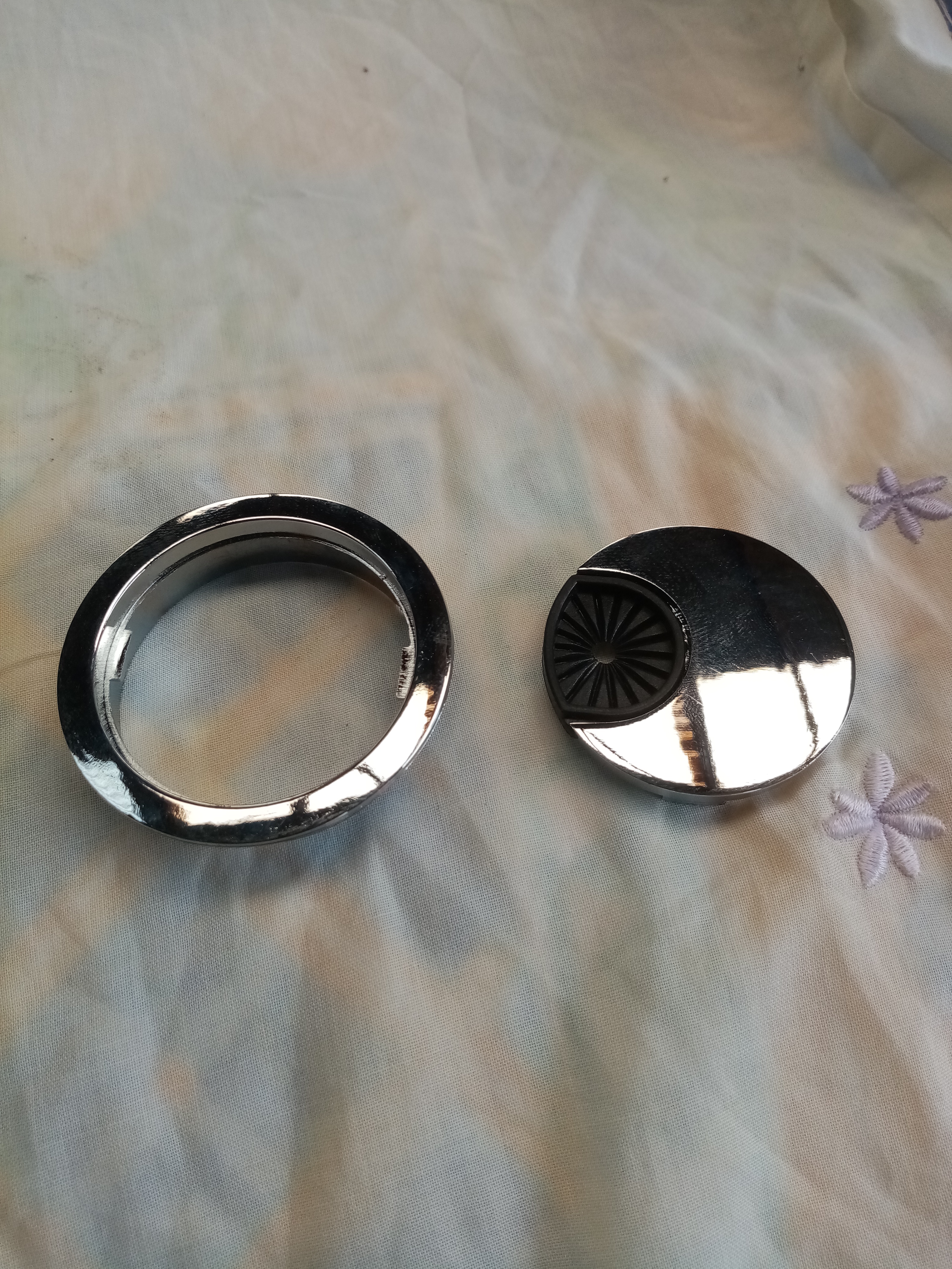

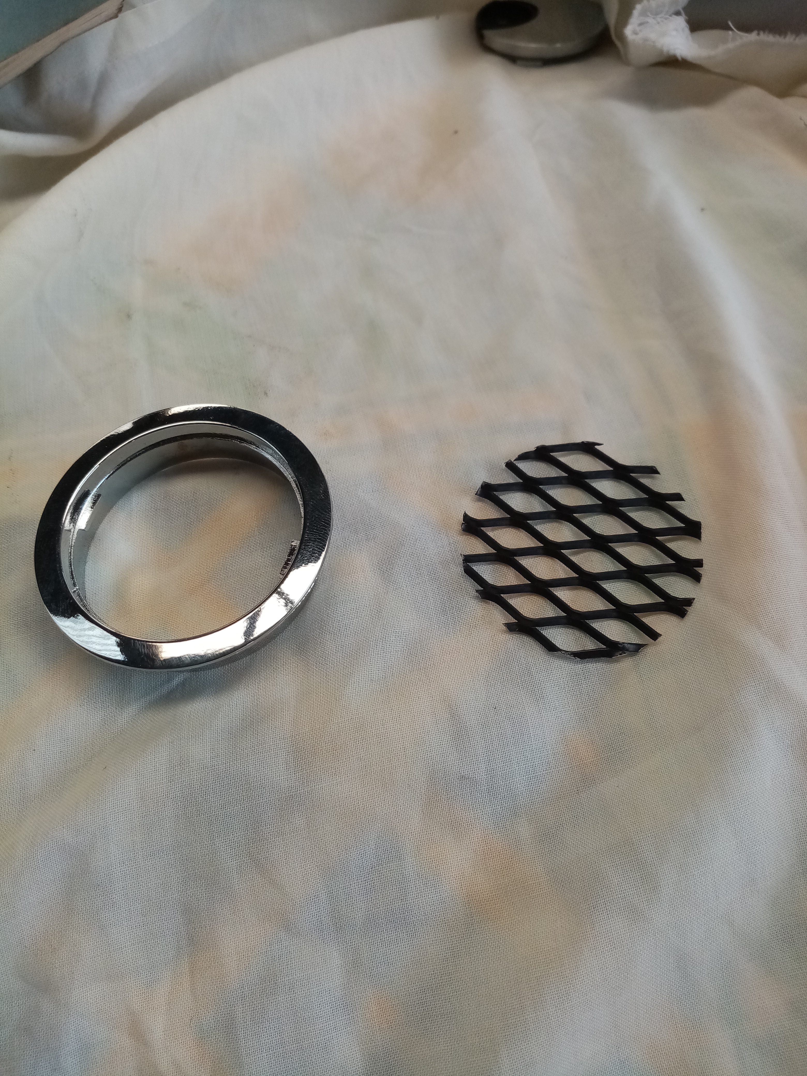

I was looking for some round bonnet vents and came across desk grommets that are cheap to buy so ordered some up cut some holes and added some mesh think they look ok just hope the chrome finish doesn't wear off.

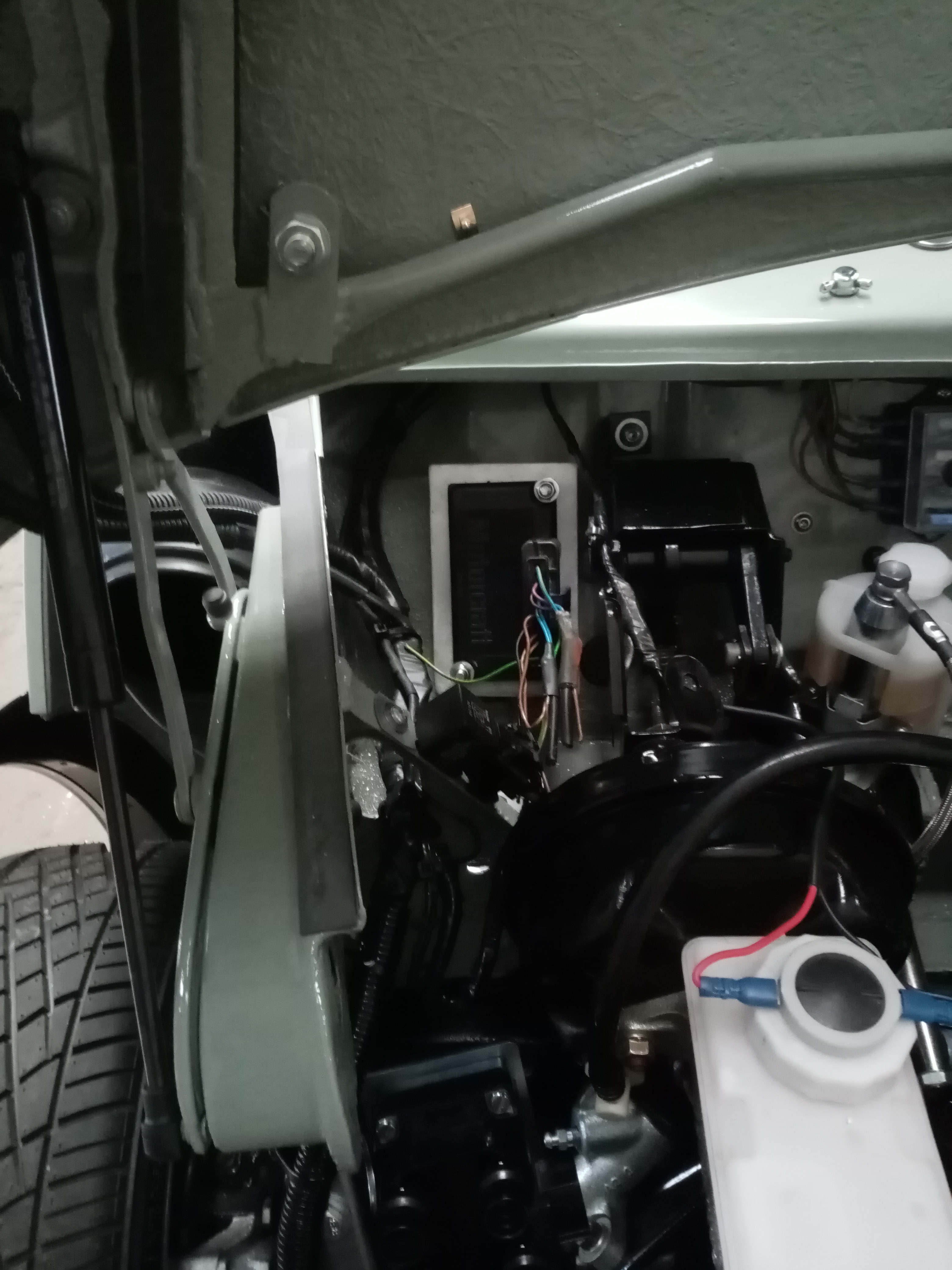

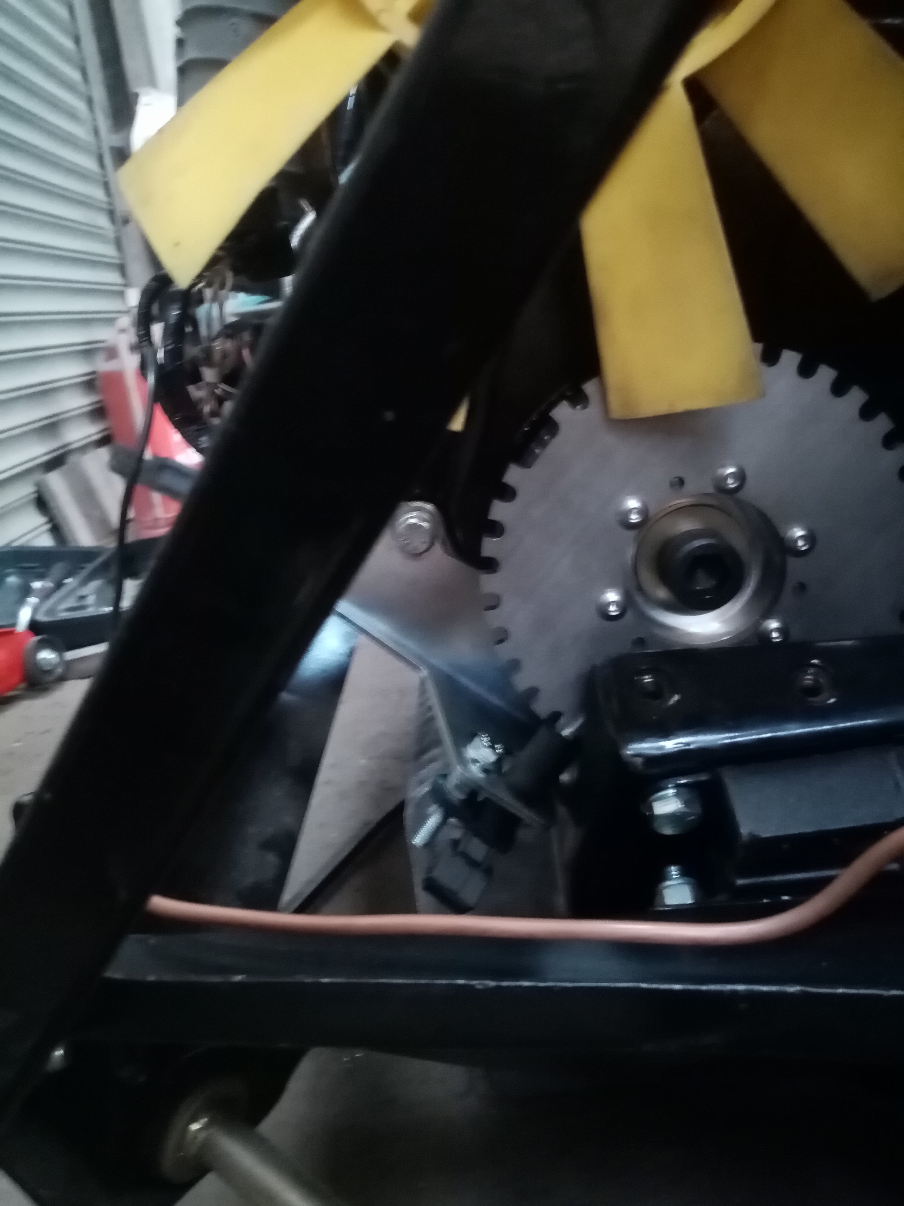

Also bought a megajolt kit from trigger wheels which I've started to fit used a digital dti gauge to find tdc on cylinder 1 and fitted trigger wheel and sensor. Fitted the coil mount to the brace bar and mounted the edis to bulkhead mounted on 5mm ally plate.

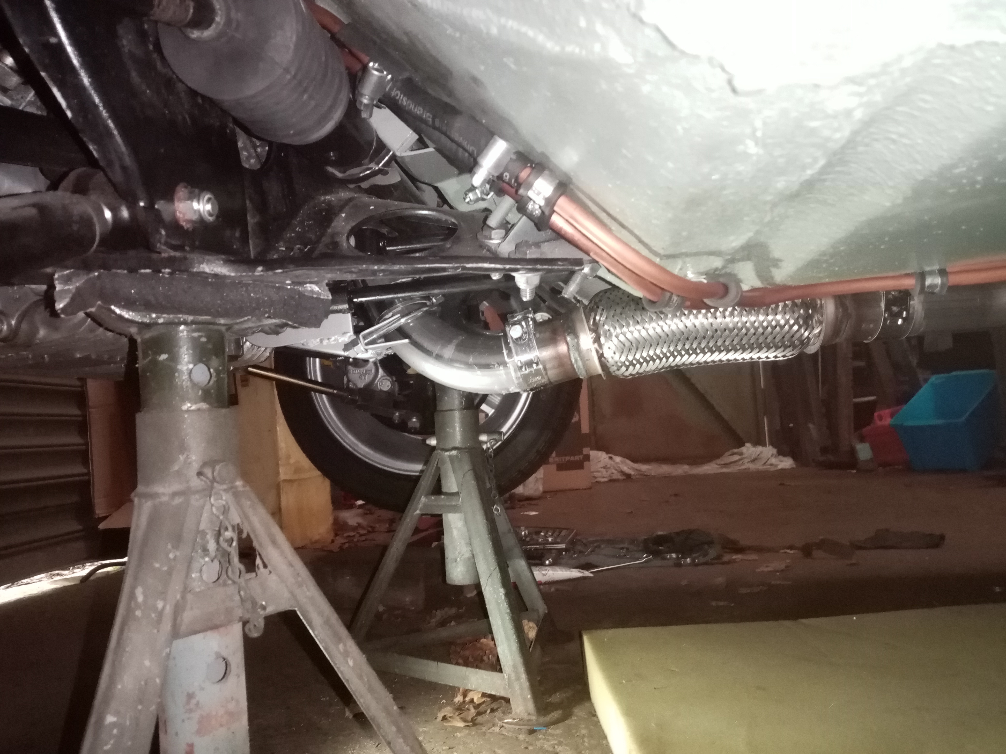

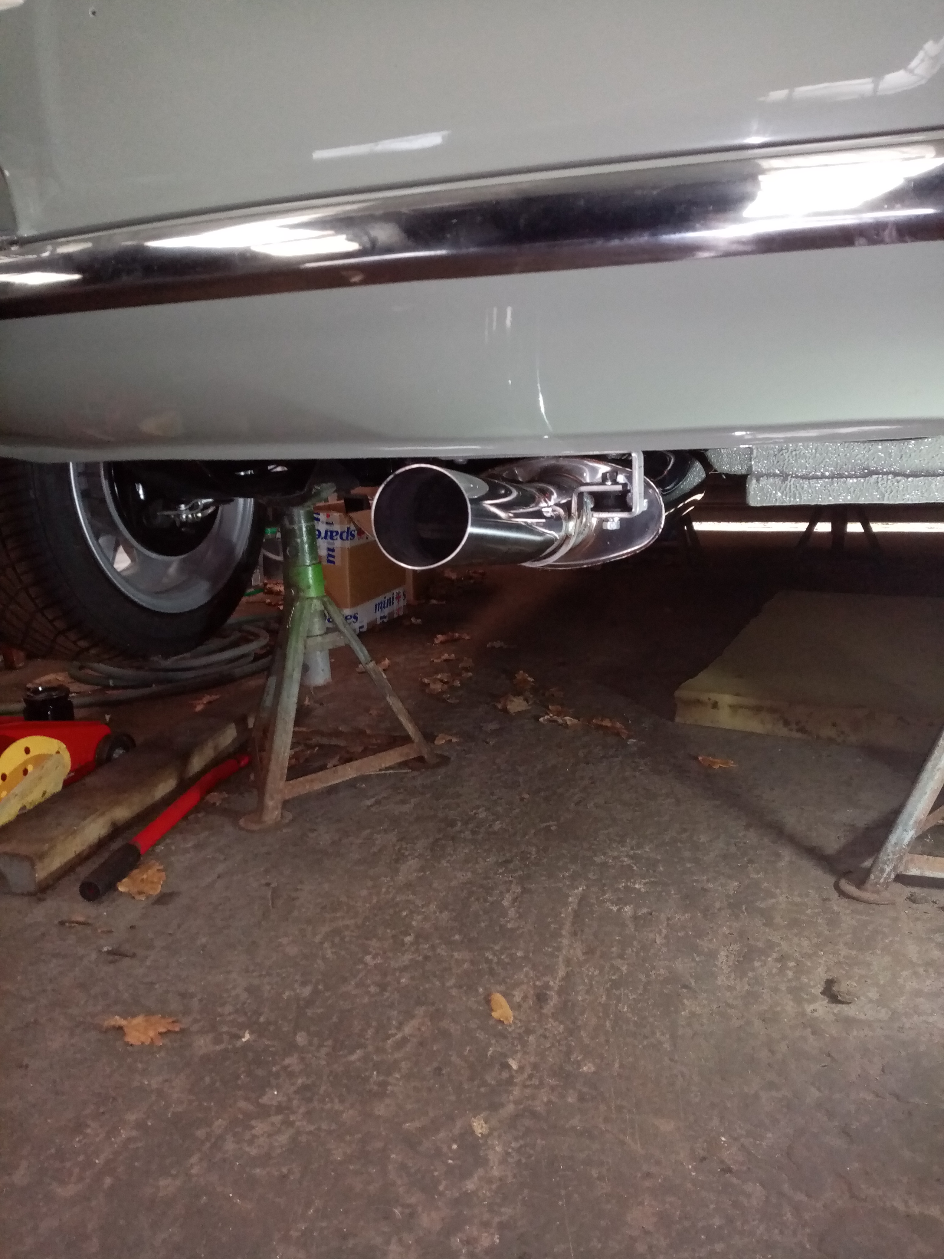

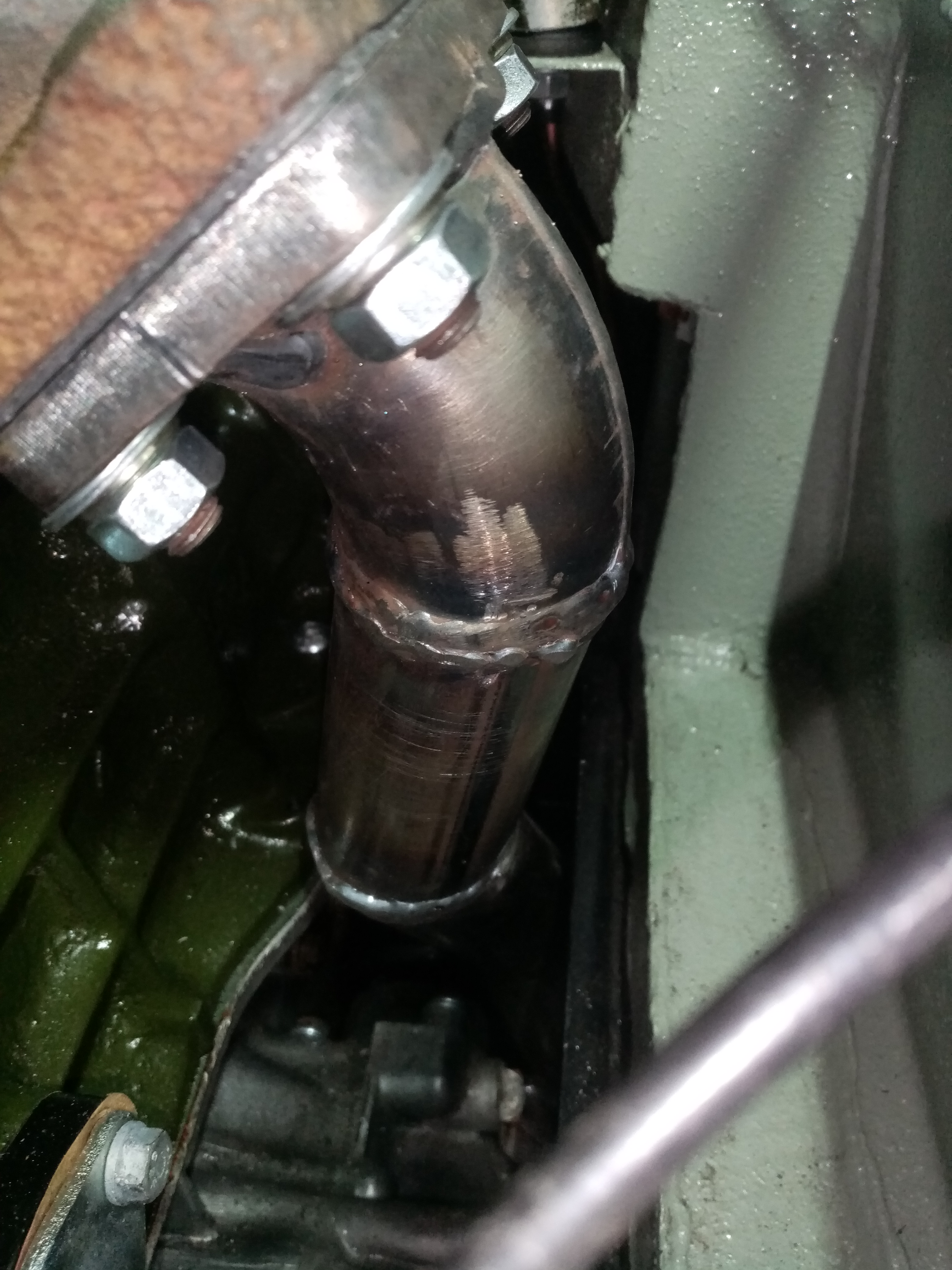

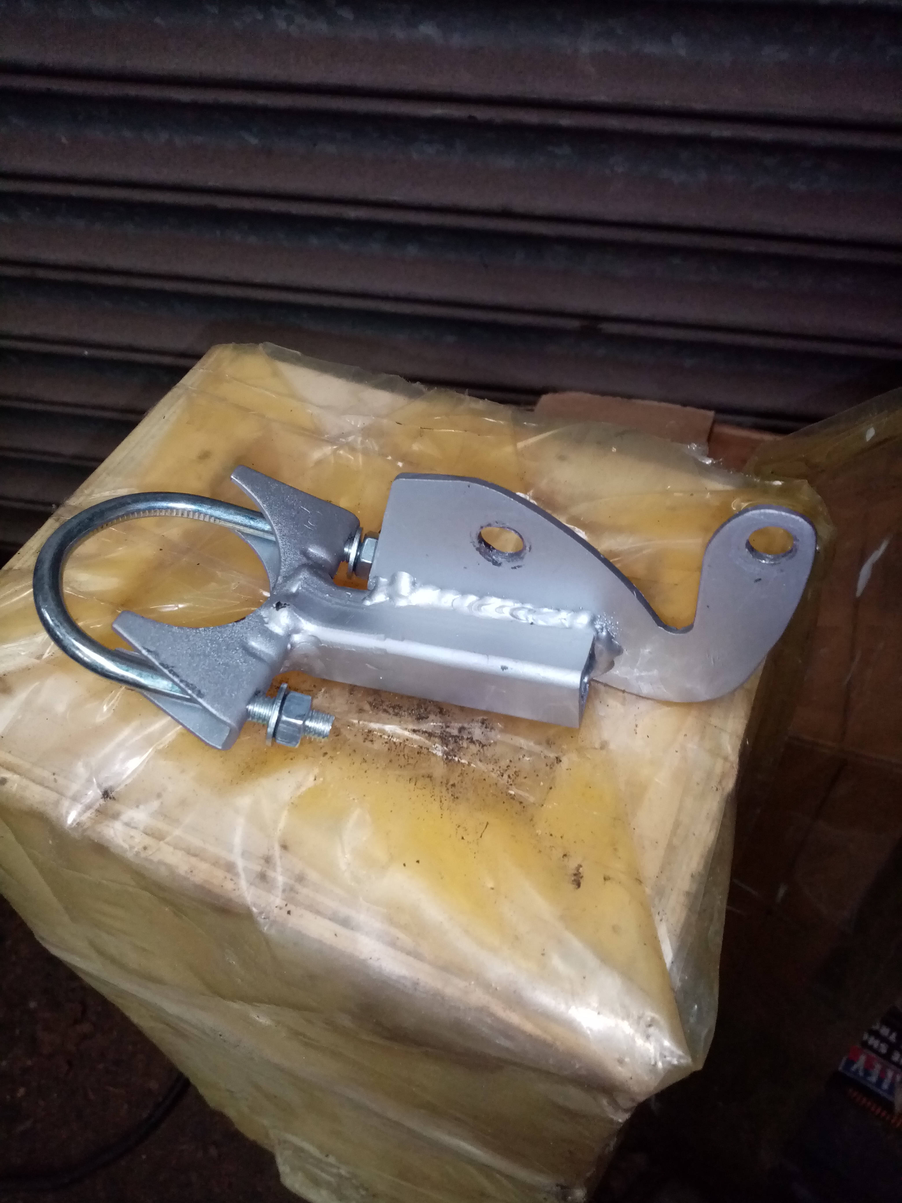

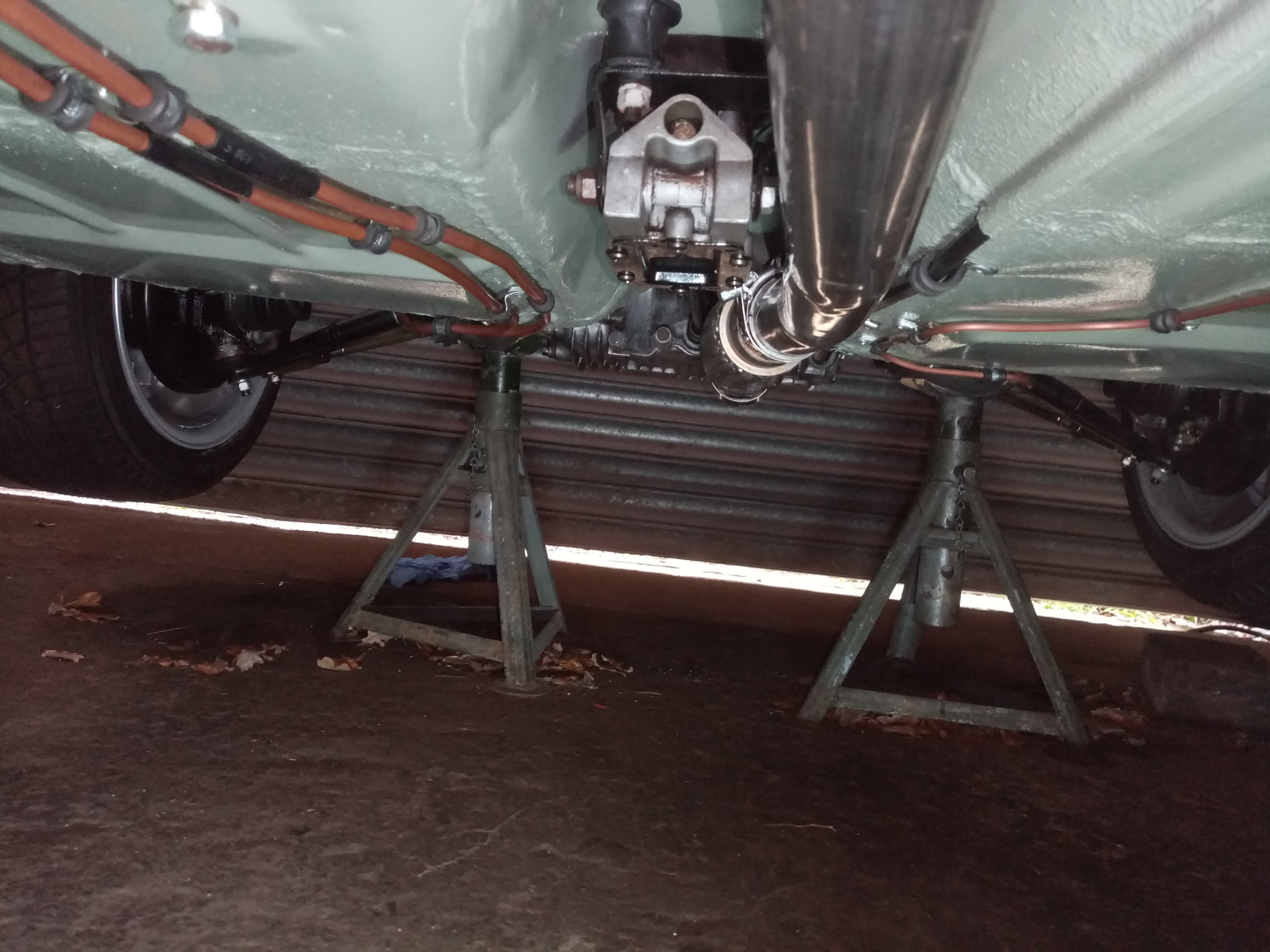

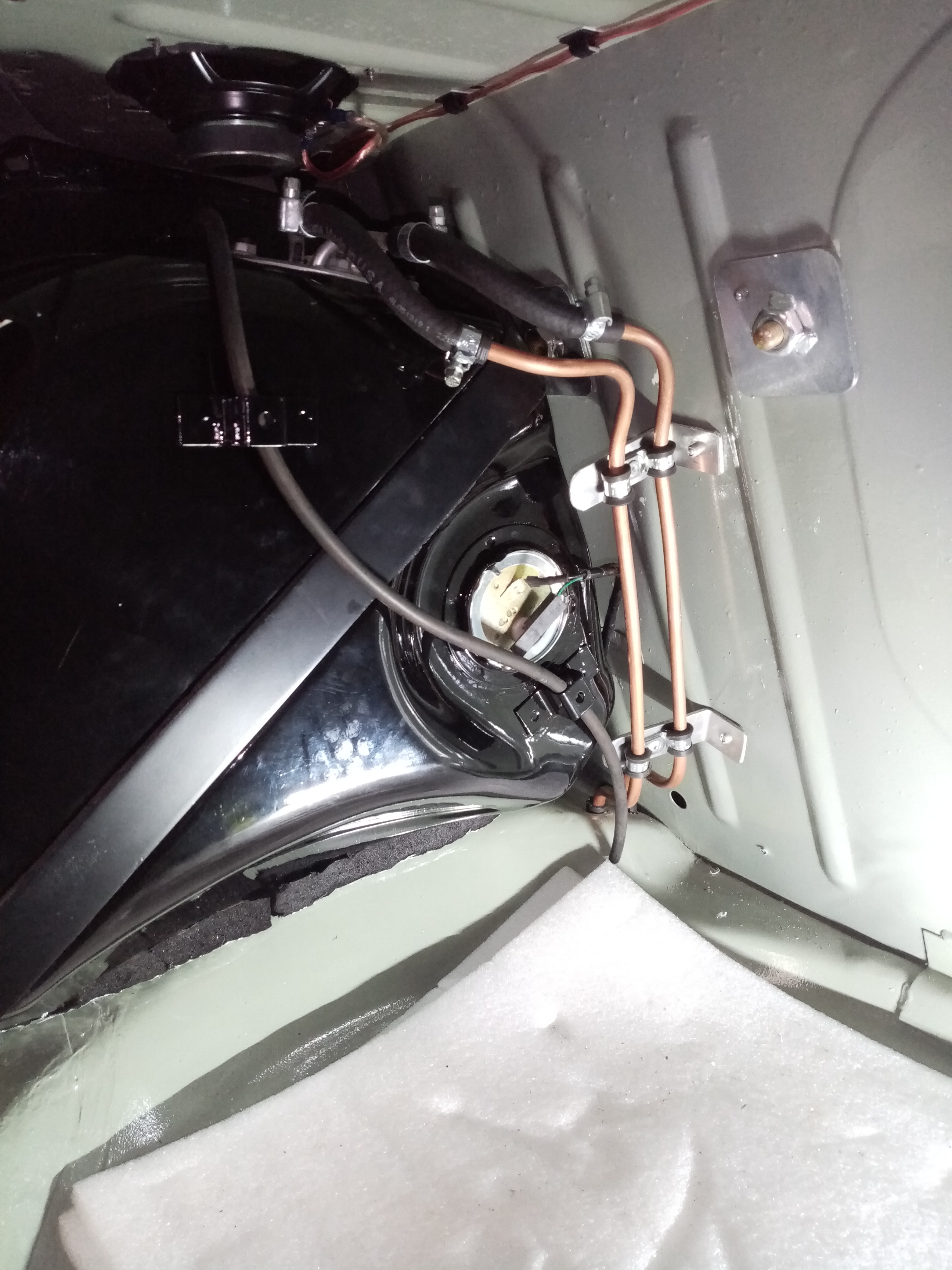

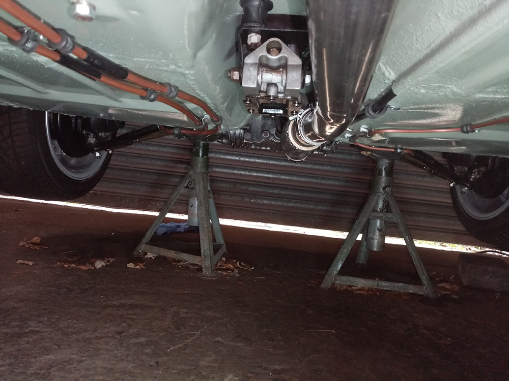

Finished off door cards and interior handles. Spent a few weekends playing about with clutch arms making the pedal lighter. Fitted fuel lines fuel pressure regulator and gauge. Still need to sort out fuel pump wiring. Last thing I've been doing is making an exhaust down pipe and fitted a playmini 2 inch centre exit system.

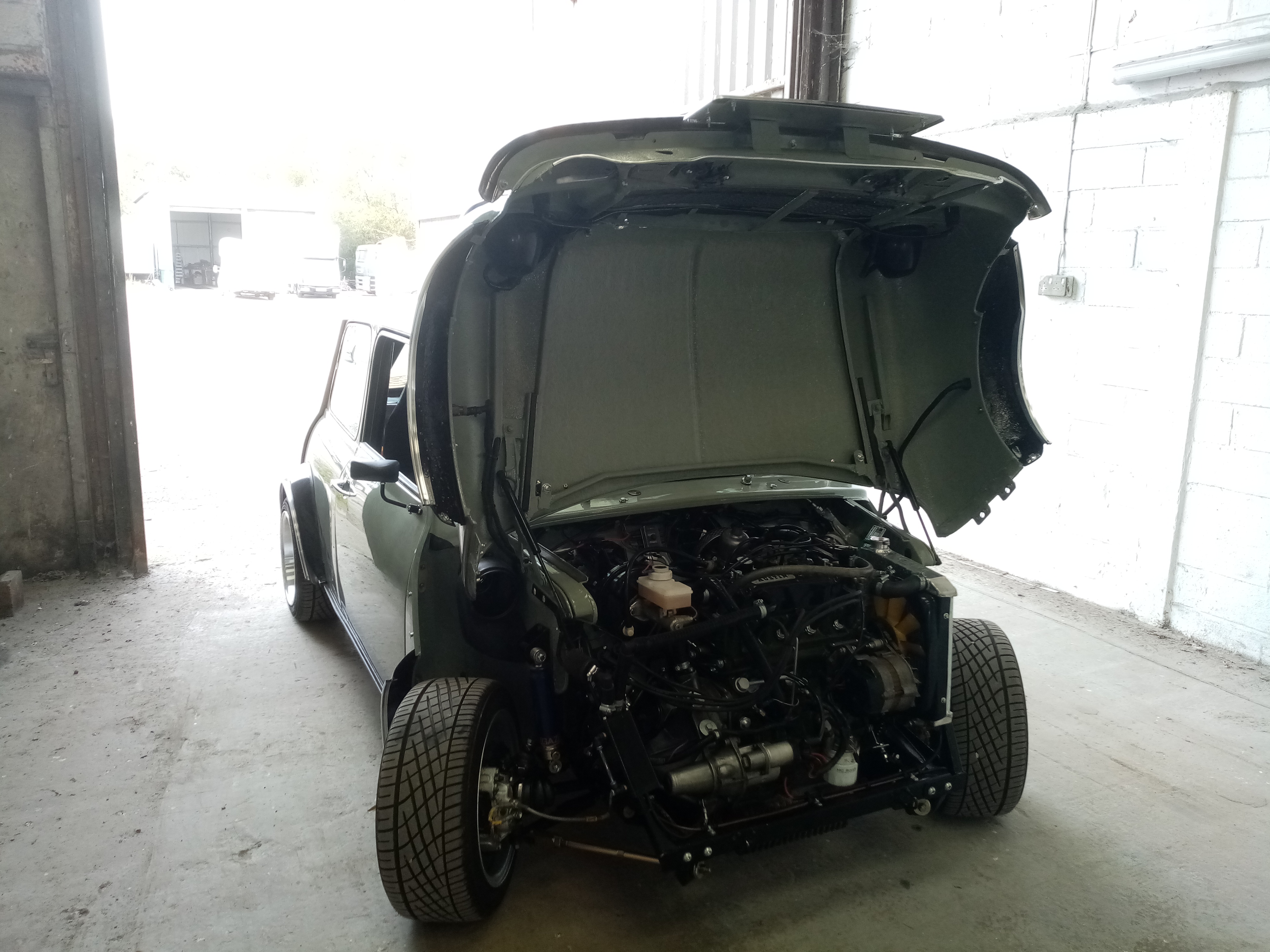

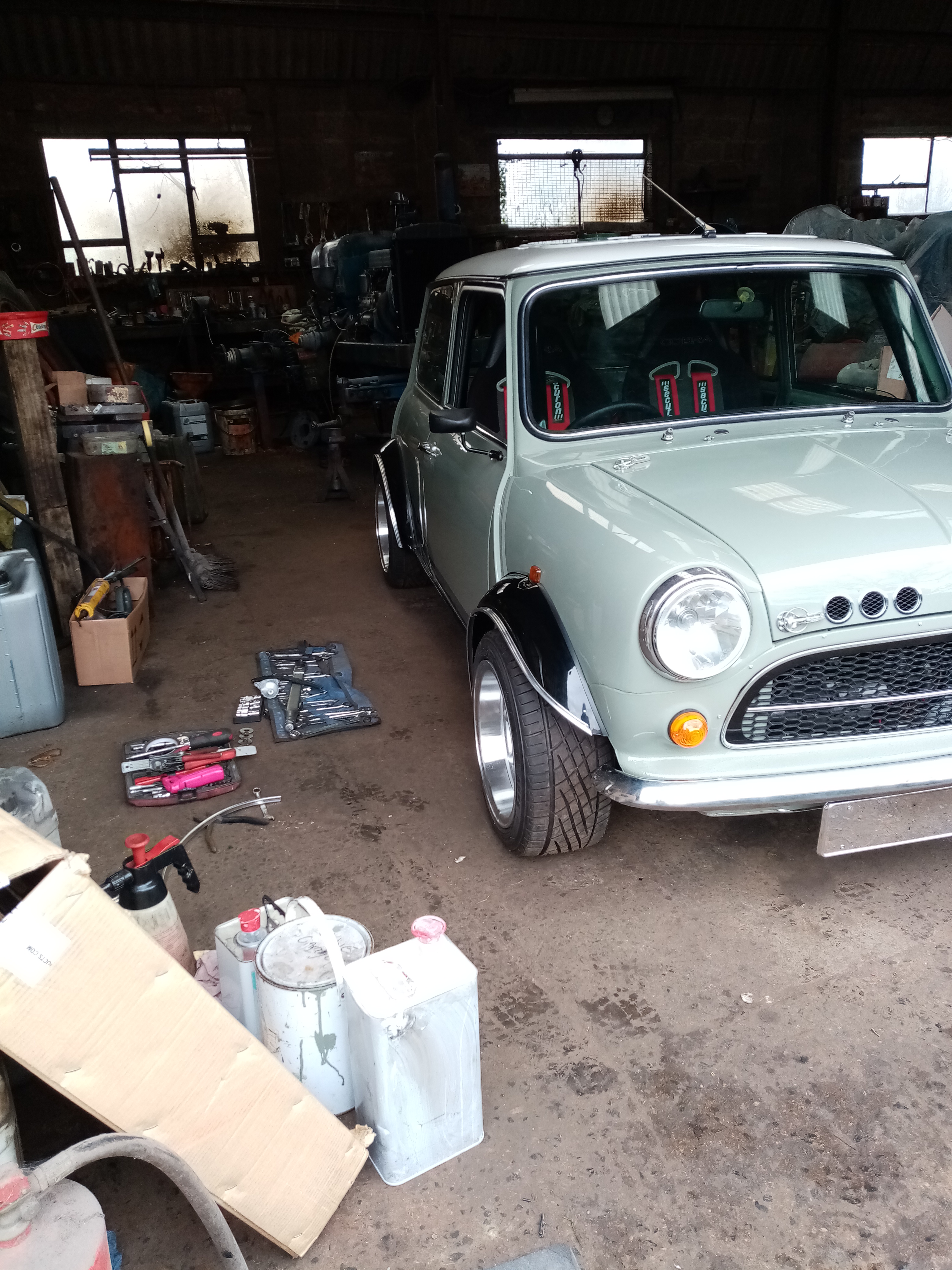

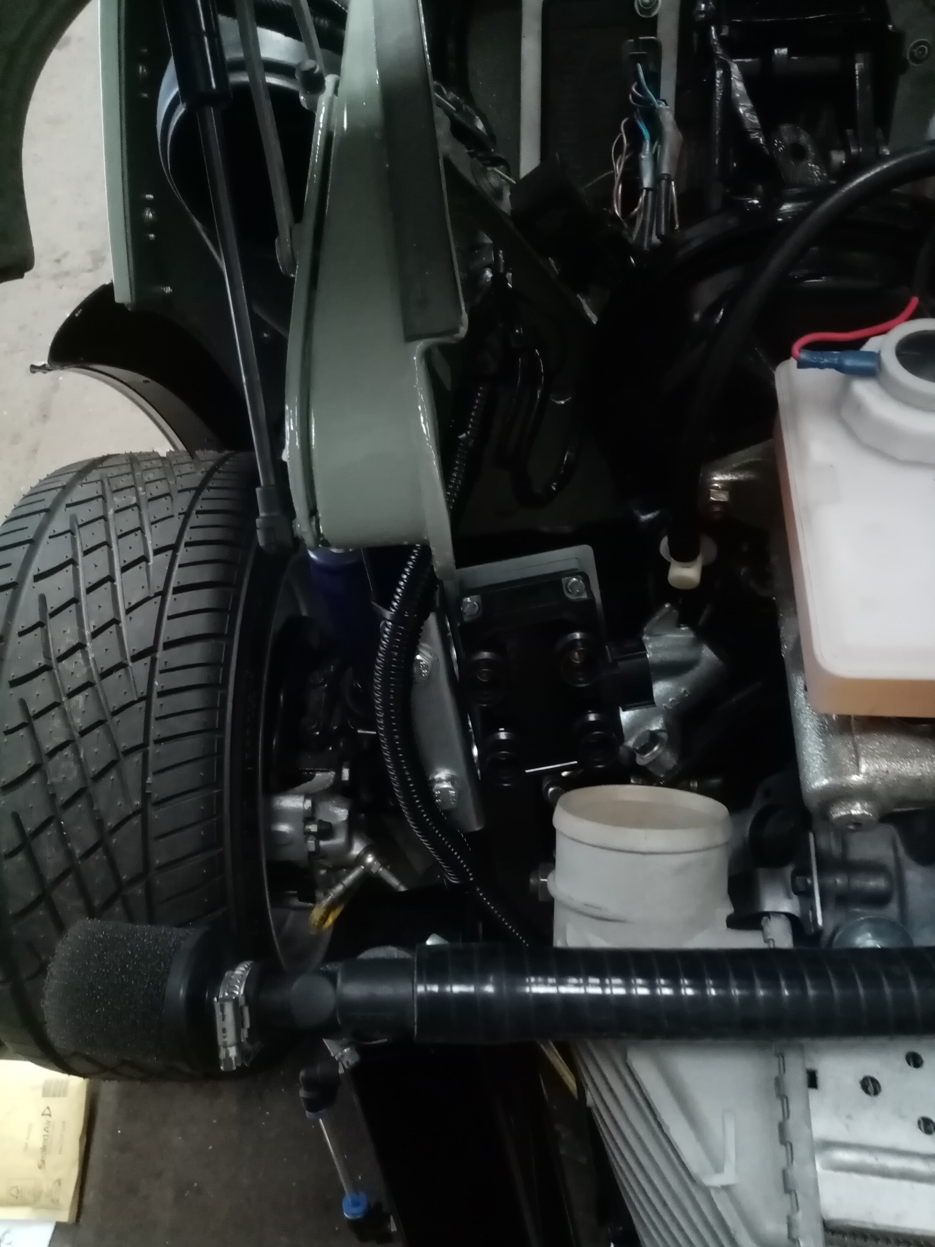

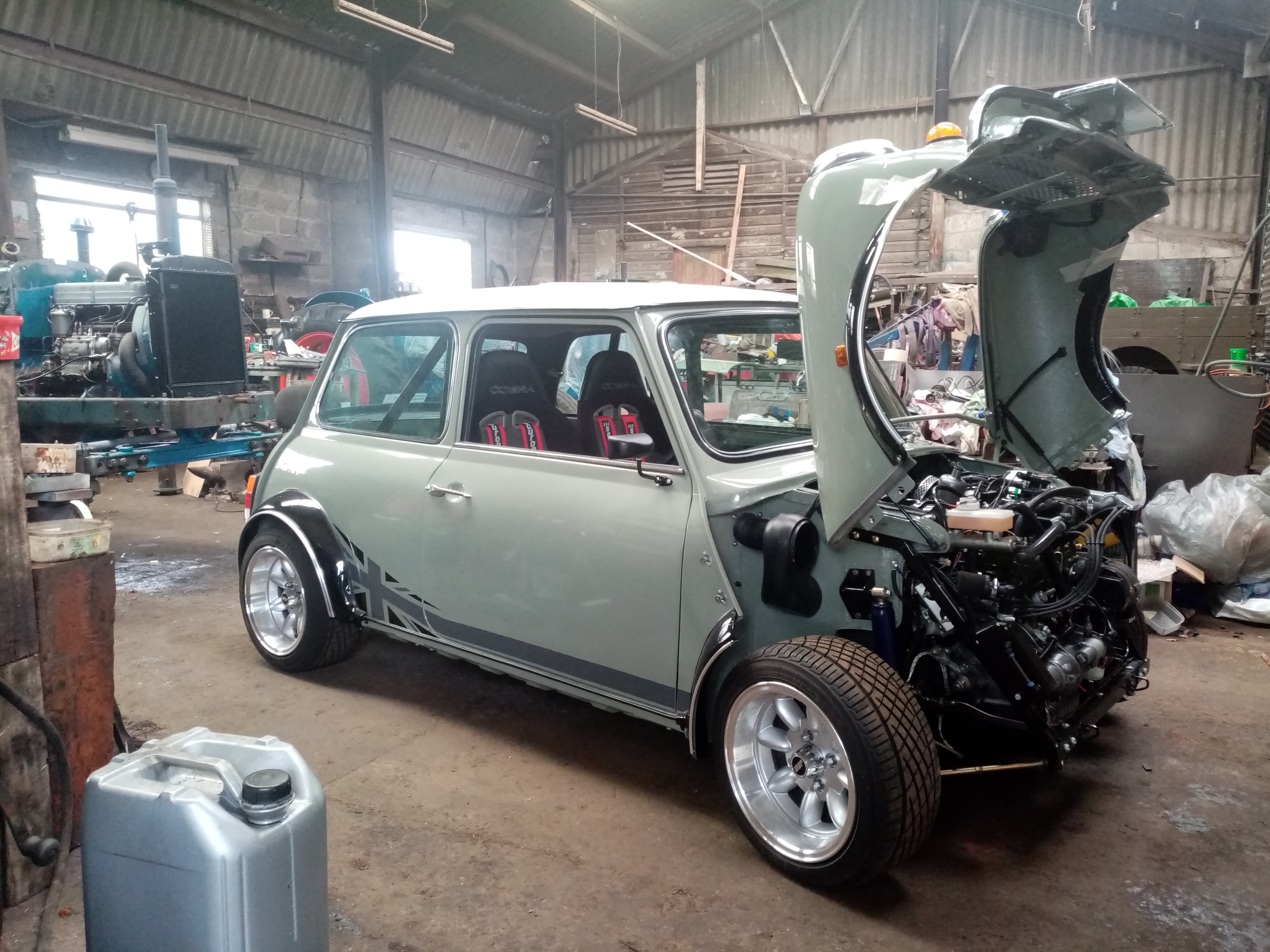

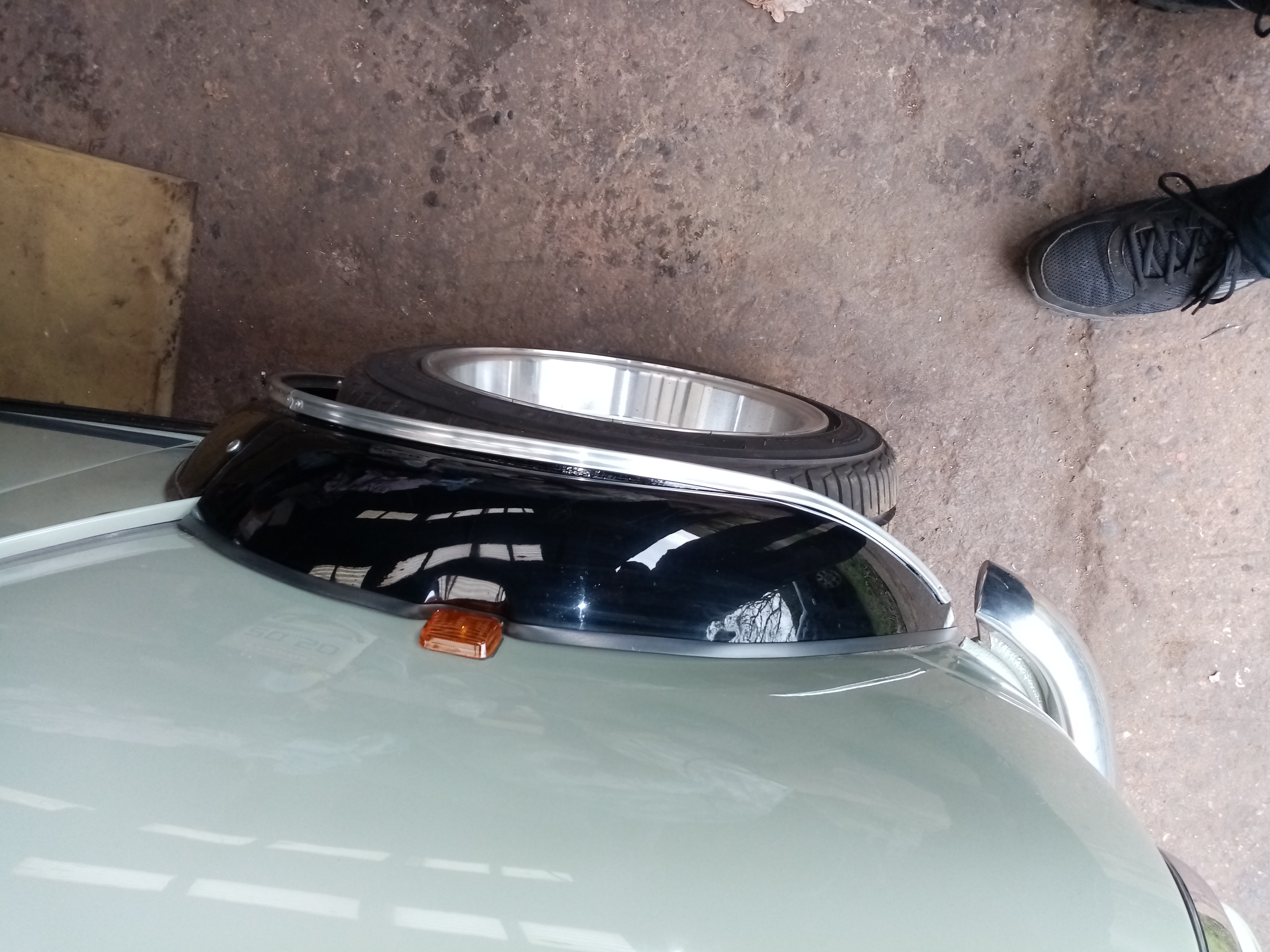

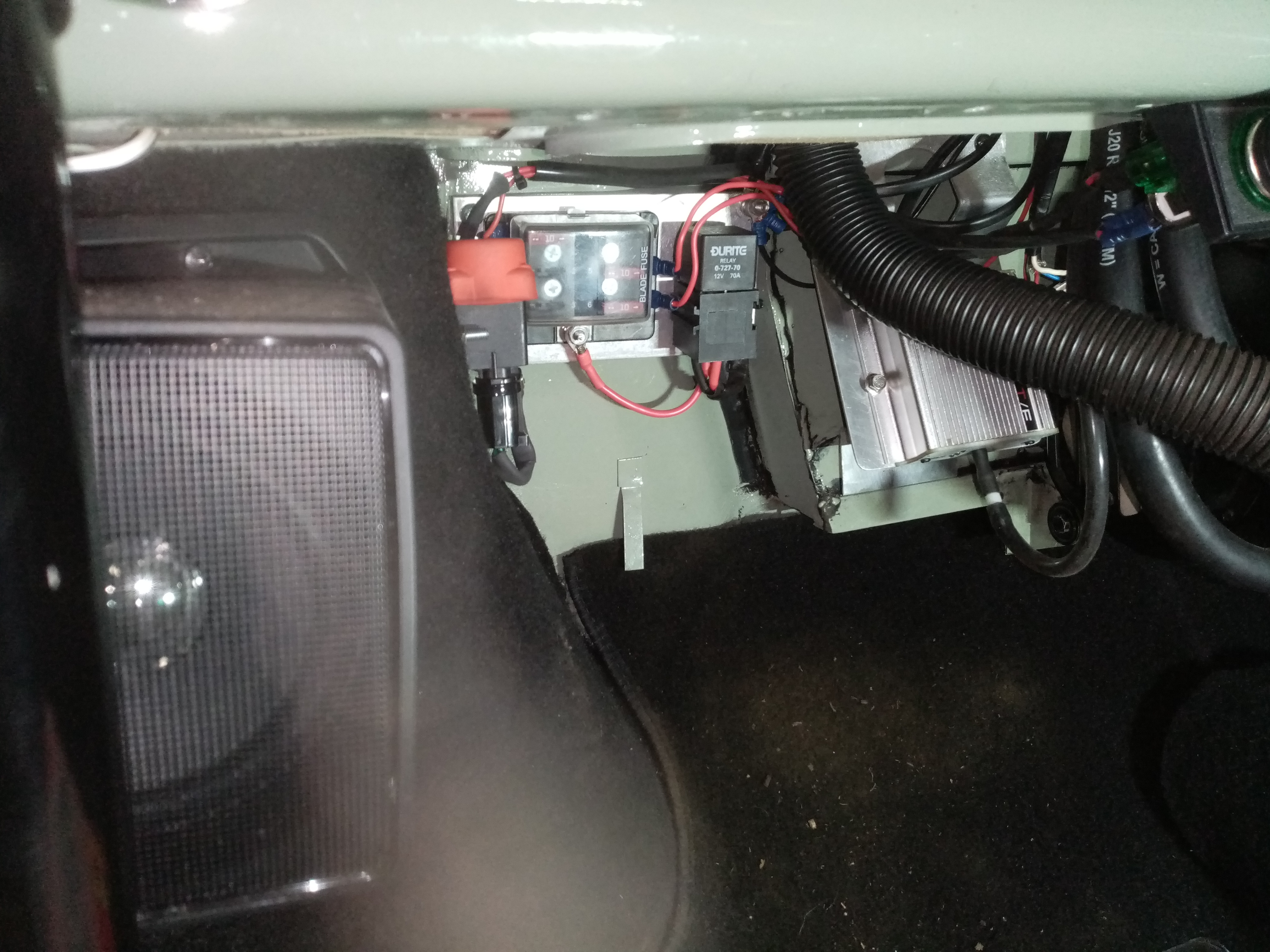

Bit of a update added a fuse box controlled by a relay for the fuel pump radio and cigarette lighter socket was going to run the edis and megajolt from there as well but it wouldn't spark so moved it back to the original fuse box. I've had the engine running off of the edis good oil pressure and sounded good and the clutch is working. Decided to cut down the front wheel arches as didn't think there was enough clearance on the front edges. Feel like the end is in sight for getting on the road.

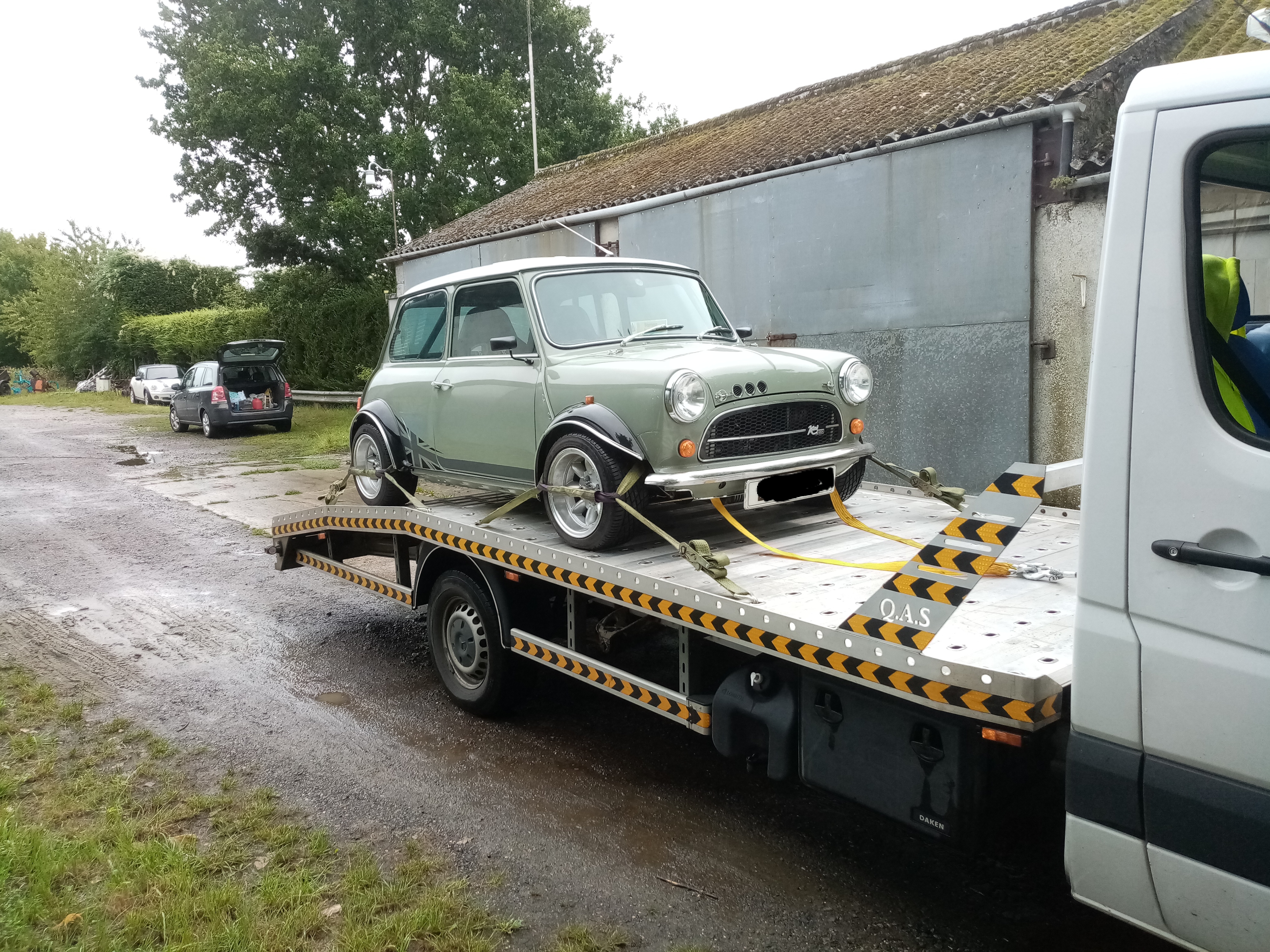

So after being booked into slarks for suspension set up engine tune and mot back in March when the world went mad and put a stop to play. No fault to Neil at slarks I must say got it booked back in about 3 weeks ago for Neil to play about with when he had the time. So collected it yesterday evening and got it home without any dramas. But have got a few teething problems being the original temp gauge reading high fuel gauge not great the odometer has jammed and I've got a oil leak on the timing cover seal. All in all the amount of things that could go wrong don't think it's too bad at least it runs and gearbox and clutch is smooth. Think I was grinning all the way home until I saw a small puddle of oil on the drive way looking forward to turbocharging next.
