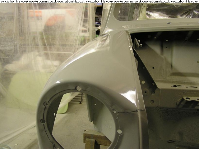

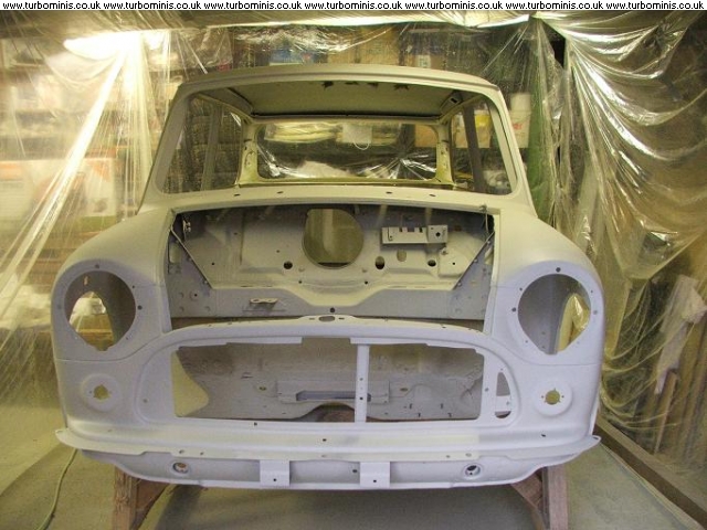

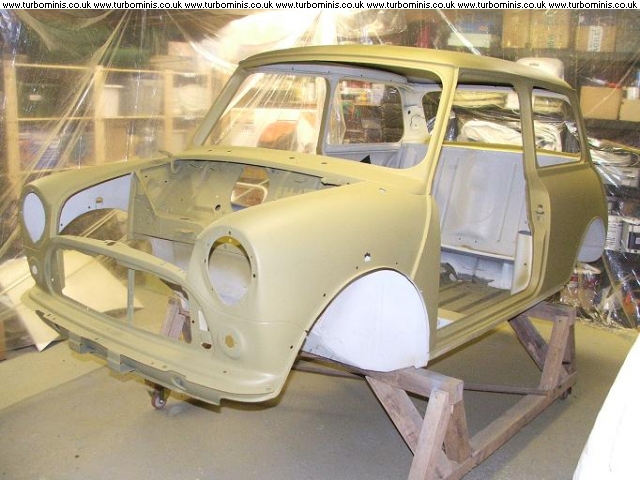

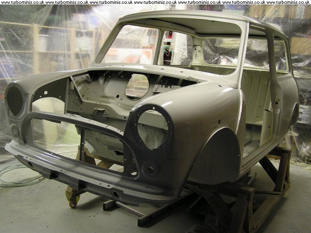

Primer on today
Flat, and base colour on tomorrow
Flat, and shiney colour on Monday
Starting to feel like I'm getting somewhere *wink*

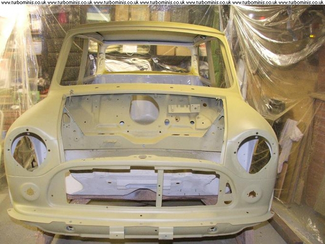

My painter phoned in sick today, Typical
Still he is a mate and doing it for nowt.

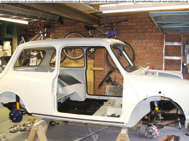

so i broke open the paint and did the underside.
Oh and thanks for all the comments so far
cant wait till i start putting it back together

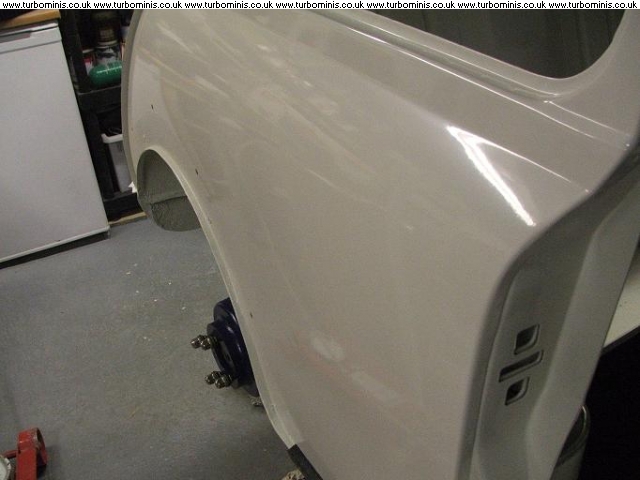

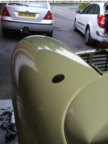

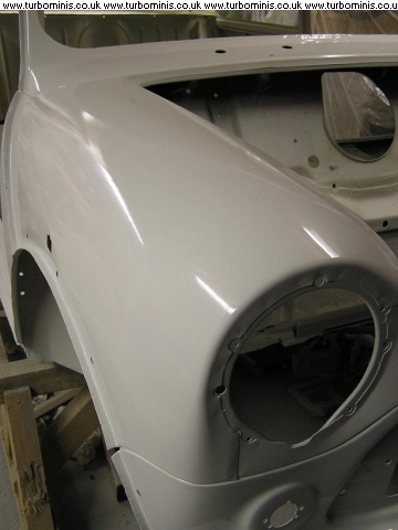

Firts coat of colour
The picture does not show the colour well what with the flourecent lighting and the harshness of the flash, but trust me, it is exactly the same white as what was on it, it is a blindingly good match to the original paint

That was the first coat of 50/50 and settled nicely with very few particles of shit sitting in it either. The shine was realy good for this first thick coat too. And yes, another three coats to go. Bit panicy about solvent entrapment, so letting this harden well befor the next coat and so on.
I could never have done anywhere near as good a job in the lightning speed that he moved at. I was his paint bitch *laughing* do this, move this hold that, mix this.
I will paint the trailer I will build now i have seen it first hand
oh and the gravity fed paint gun is one of those nasty cheap ones, but does seam to give good results by playing with air pressures and paint
Oh and another thing, we're using Oxygen free Nitrogen from the cylinder. I can get this stuff at work without a problem. this means no noisey compressor :cool: and he supplied some 3M paint and vapour masks. You deffo need those. But the smell of cellulose thinners is fab, rhubarb and custard boiled sweets, mmmmm, nice.

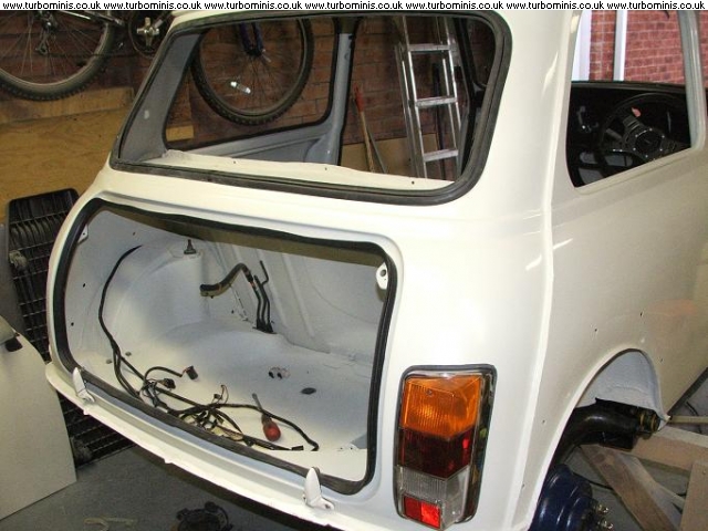

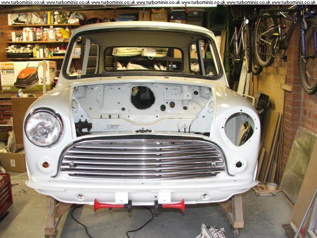

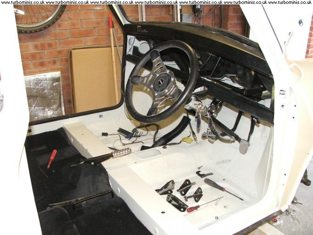

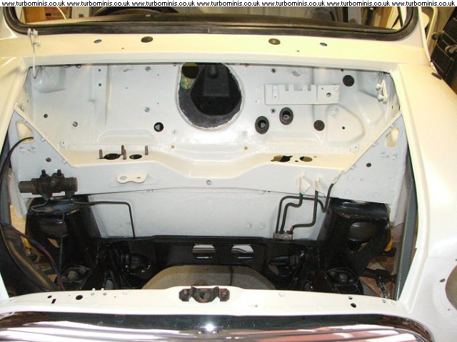

Progress so far
Well the paint is done though we made the decission to miss the 70/30, reason being the 60/40 in this heat had gone off in no time, leaving some overspray on the roof and a few other areas. There is deffo plenty of paint on the car and has a realy good shine as it is. Leaving it for a week or two then cutting it back for the real shine.
Assembly now in progress*happy*
