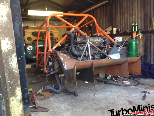

Engine

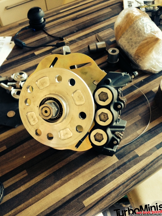

Wow check those brakes out

Did you check the bores on the engine? These are well known to increase in size after 100k miles. I saw on that was revved up to 2.6 liters once *happy*

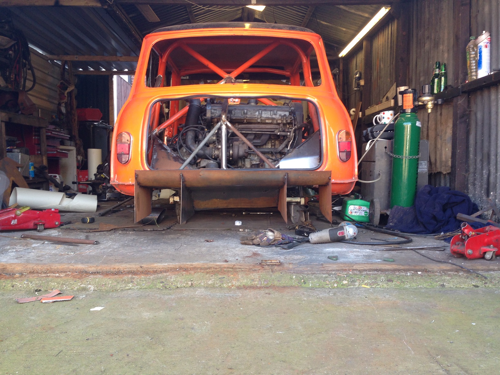

Drove the actual car V. It hadnt turned a wheel for 3 years and ran bob on.
Sold my t5 at about 180k it never used a single drop of oil between services and was sweet as a nut
I wouldnt worry at all

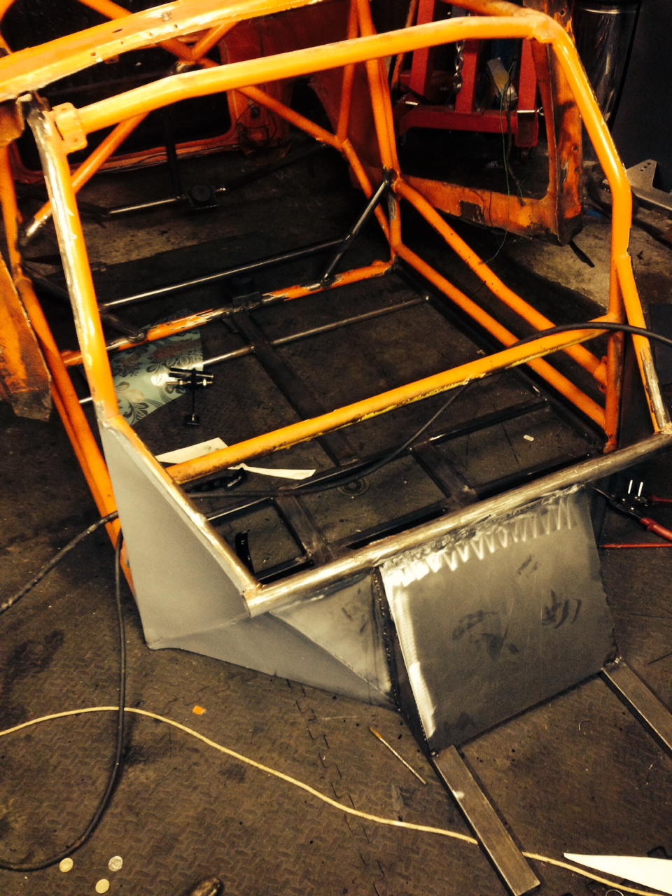

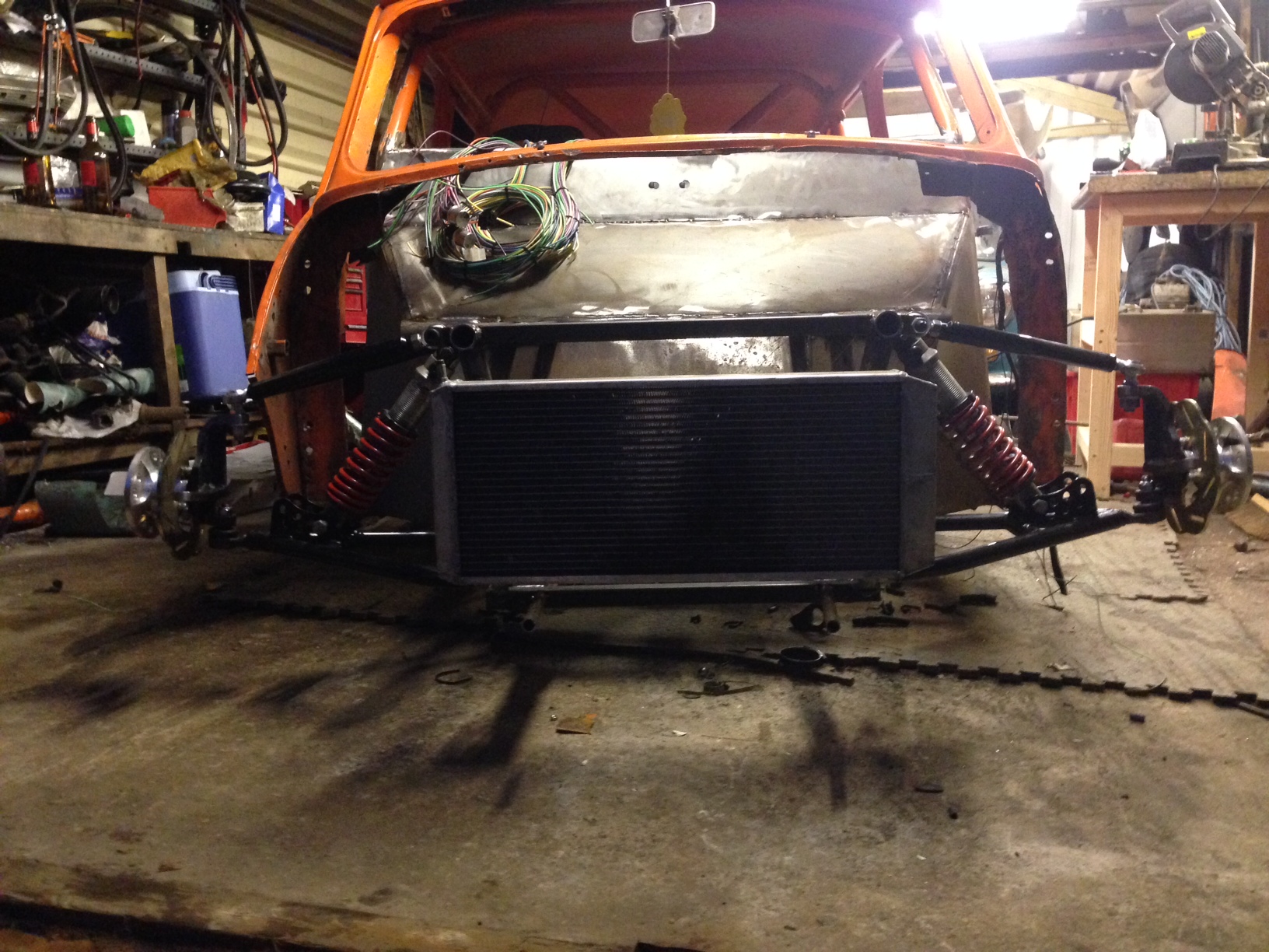

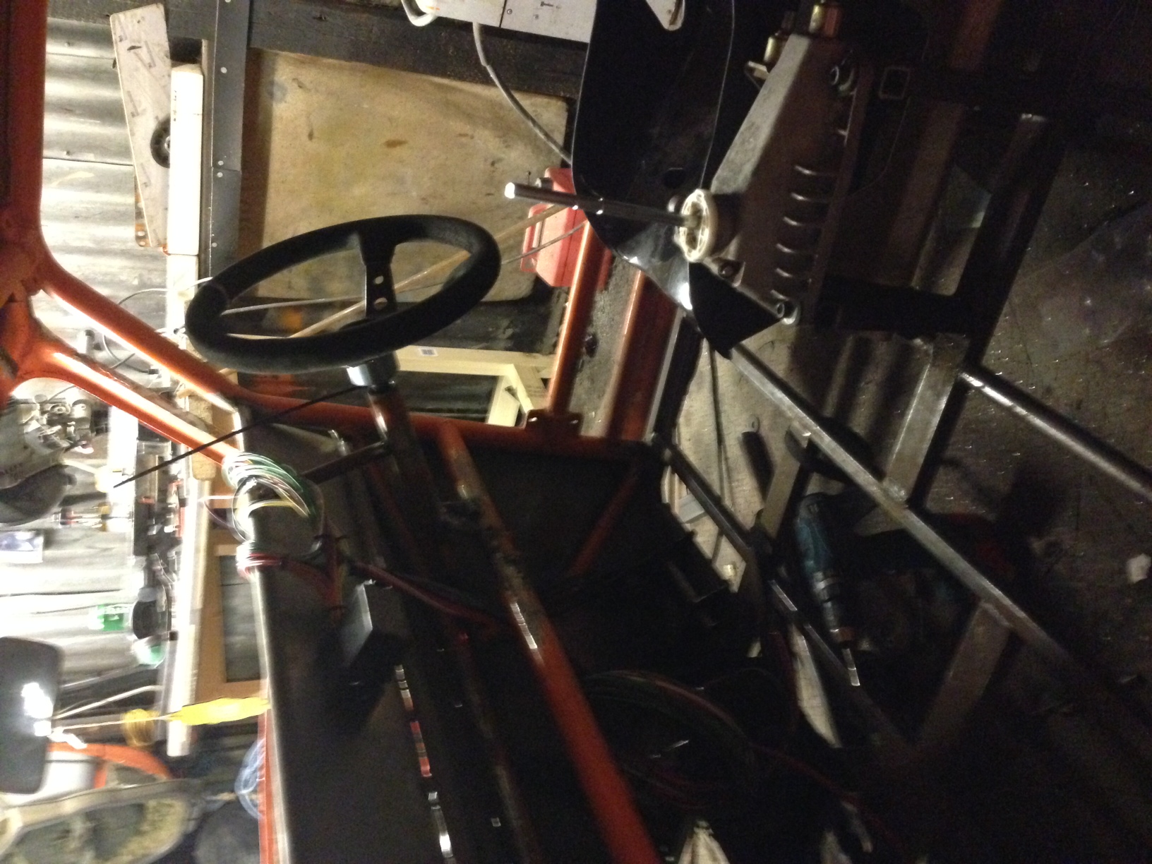

Bit More Progress,

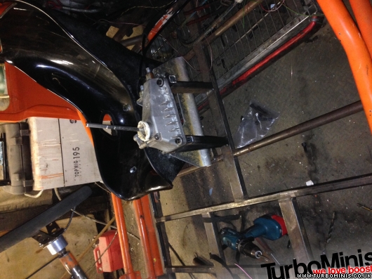

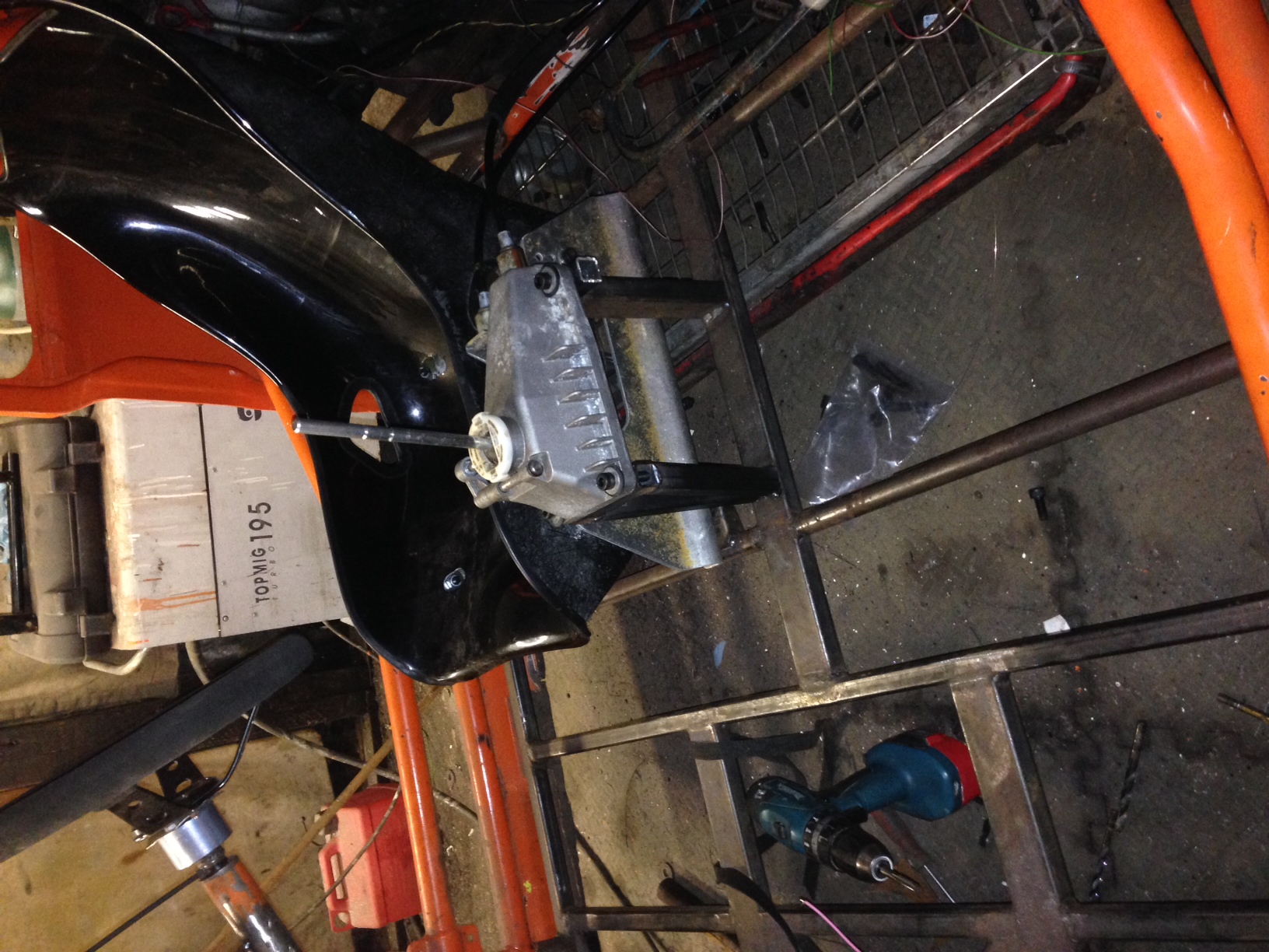

Managed to fabricate my Gear Shifter mounting points and got it selecting gears. Battery box and Fuse box mounted.
Next jobs are to fit the drivers side wishbones, weld on the windscreen wiper bottle holder and start cutting out some holes the bulk head connectors.
Ill post up some Piccies later.

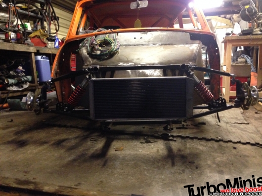

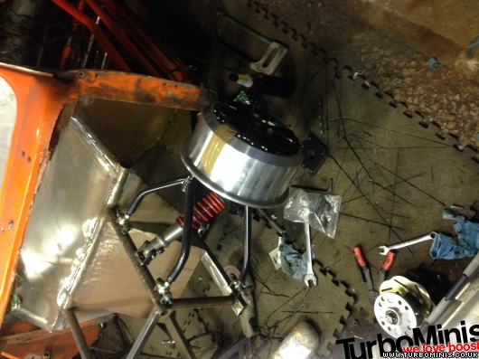

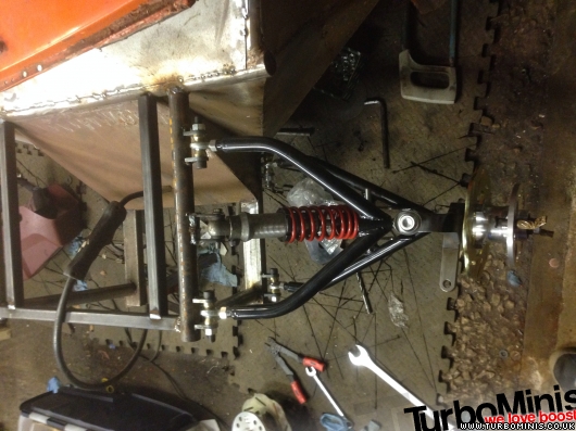

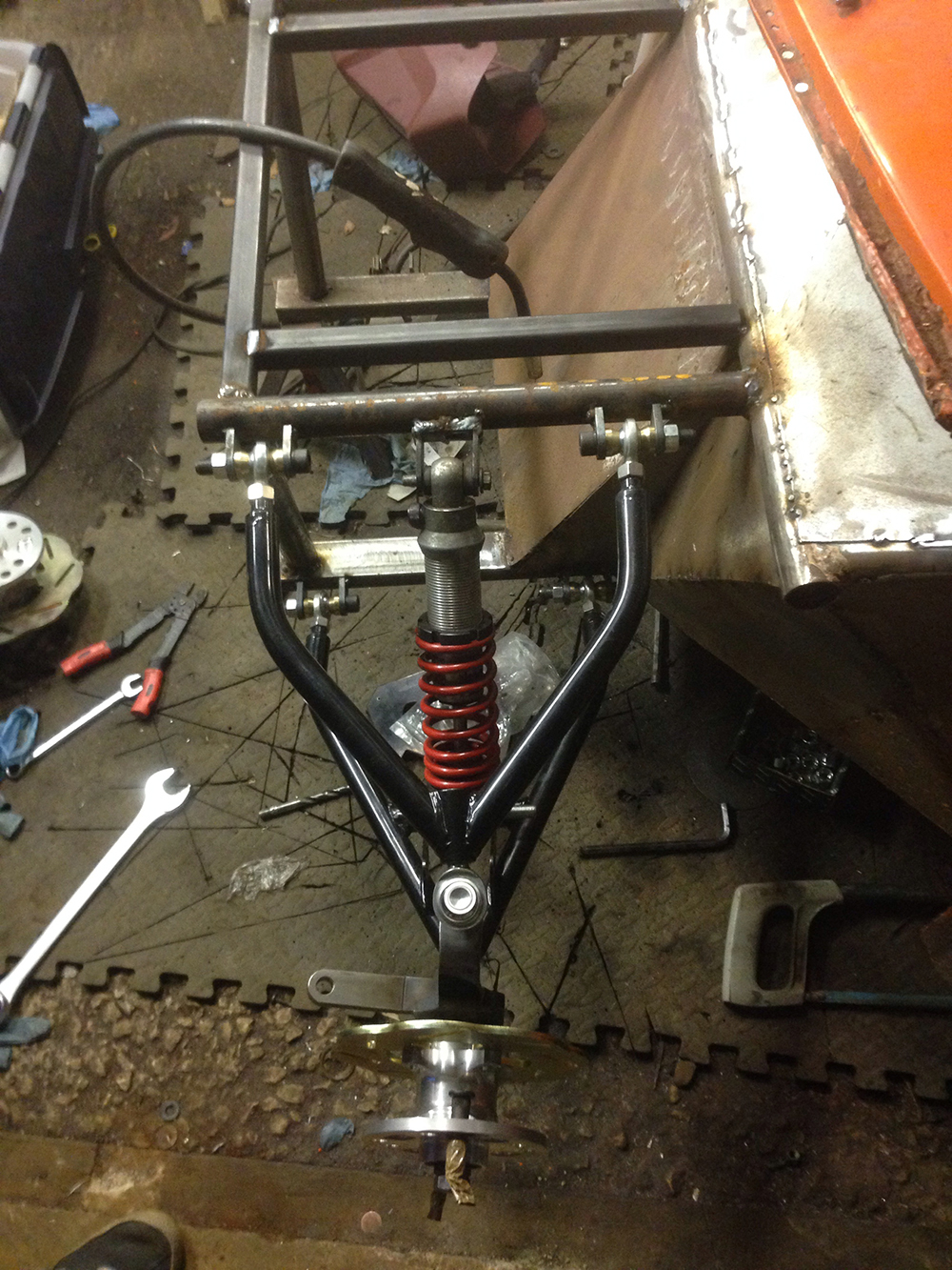

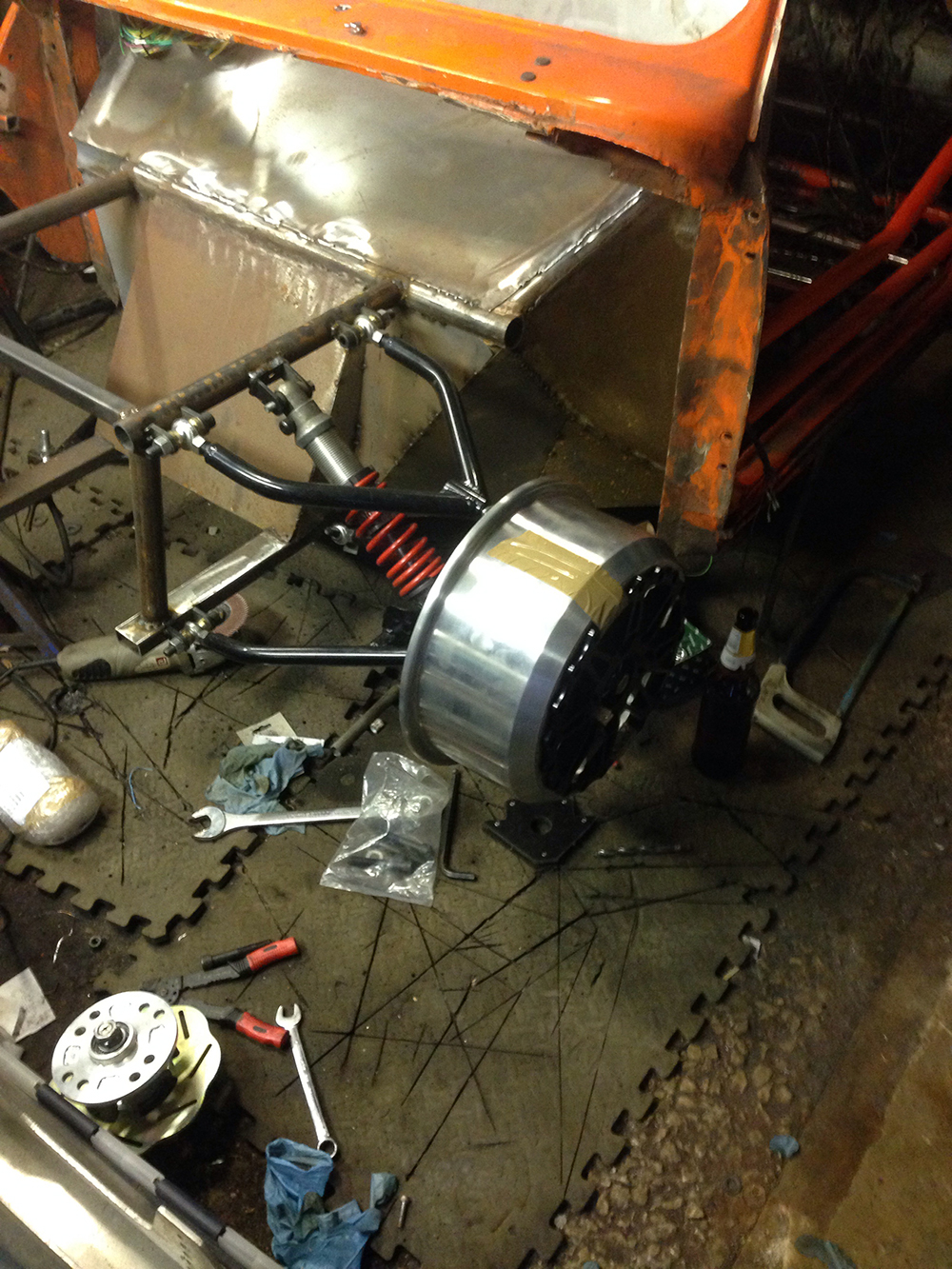

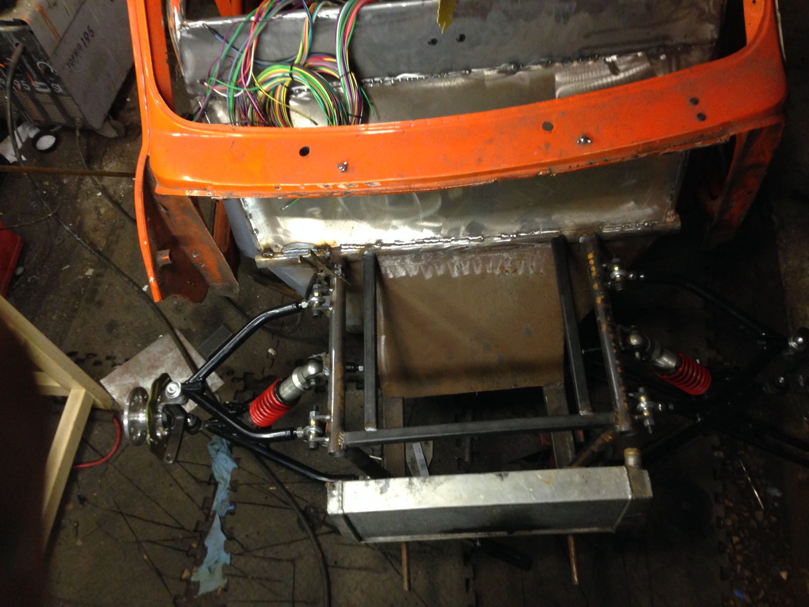

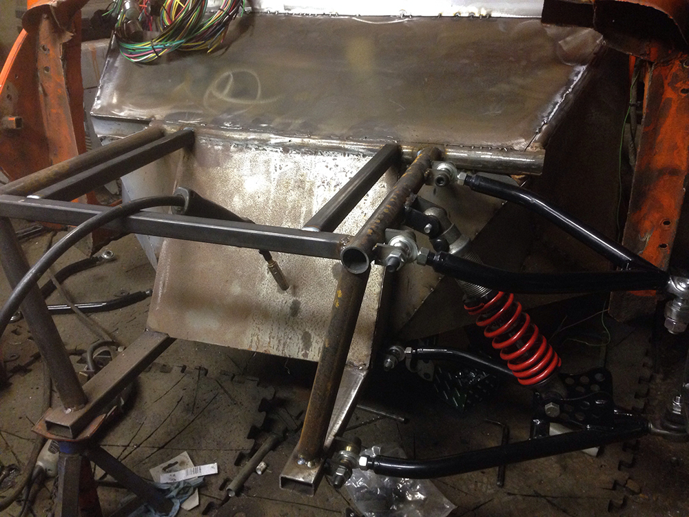

Plenty of good progress tonight. Got the drivers side suspension all lined up and attached. Finished off some bits of welding. Wiper bottle mounted. Rad Mounted.

Actually a serious question mike what spring rates are you going to use front and rear?
My rear coilies are currently the std gaz mini rear end spring rates, the actuall weight in the rear is a good few kg less than standard settup BUT im expecting it to squat down alot
I want to prevent it from squatting too much but not be over sprung
How much squat is too much? I assume its beneficial for grip
Then again i bet you will have the opposite problem and struggle to keep the front end down

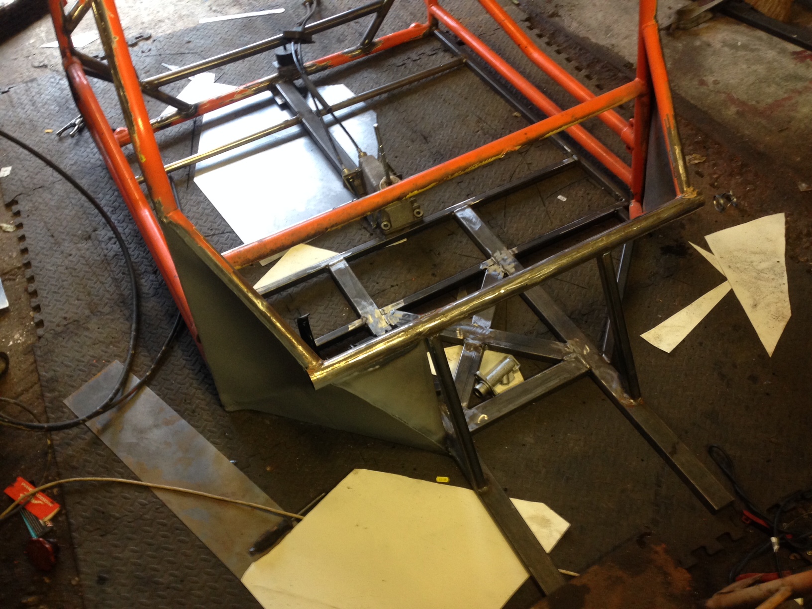

Yeah, thats why im loading the front end with loads of Box section etc to get some weight. As it sits at present with the trolley roughly in the middle of the car in balances nicely.
However theres still the rear running gear to be installed, and the steering rack etc at the front. So Im hoping it will be 50/50 ish.
As for shocks im going to use the Red Pro Tech race shocks/springs on the back and play with road/race on the front to see which is better. The Pro Tech Road Springs are Black. I think most of the issues with keeping the front from lifiting will be preventing that car from squatting really.

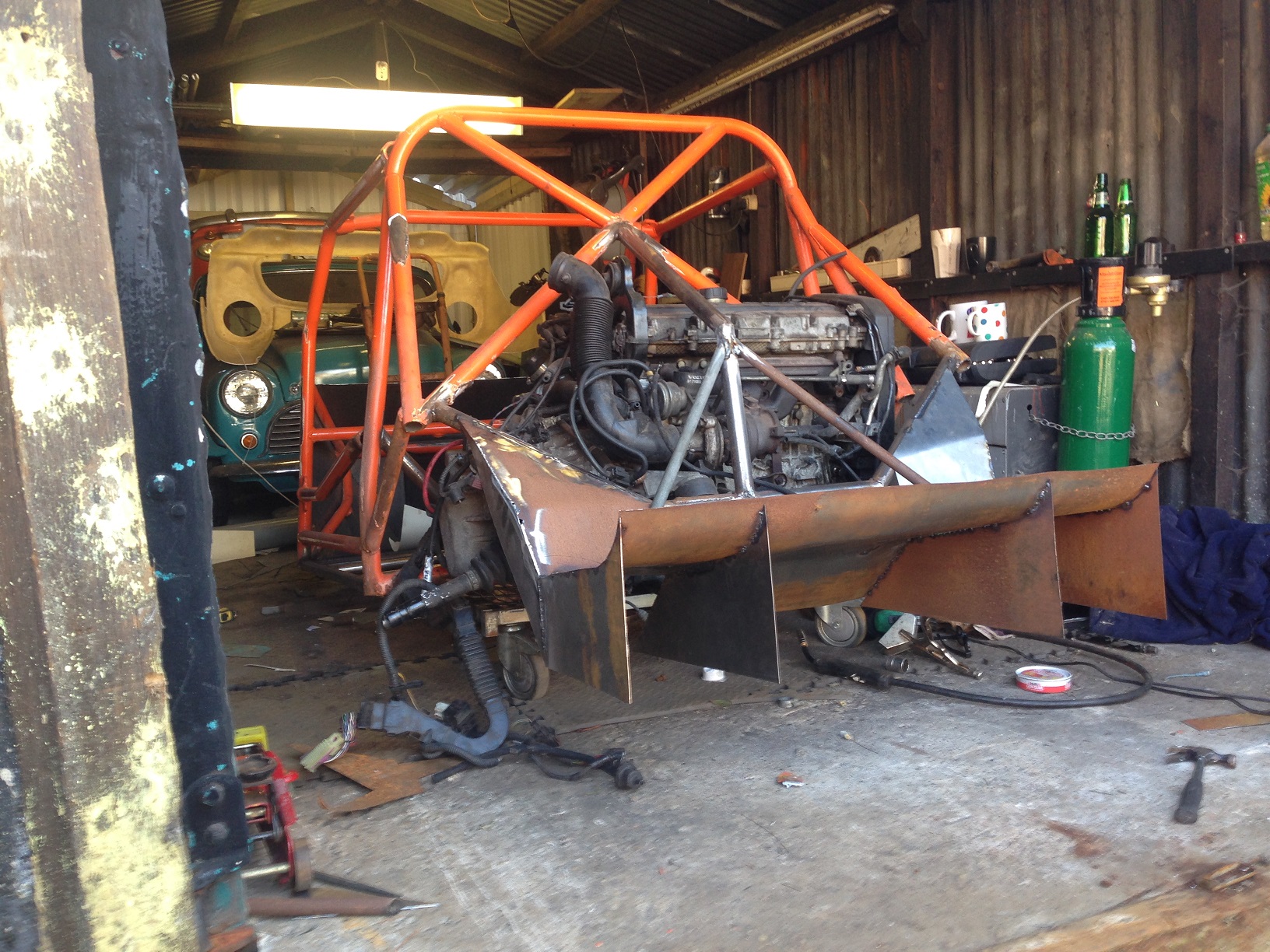

You may also notice Ive slid the shell foward about 6 inches to bring the weight foward too.
