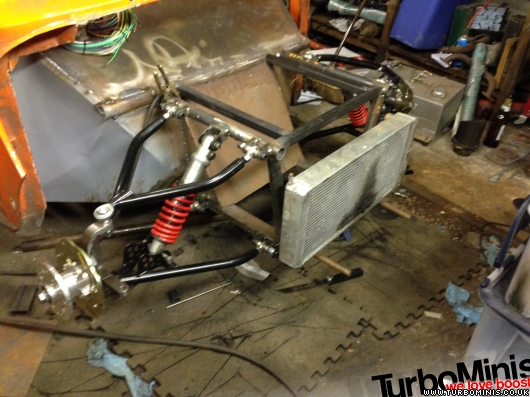

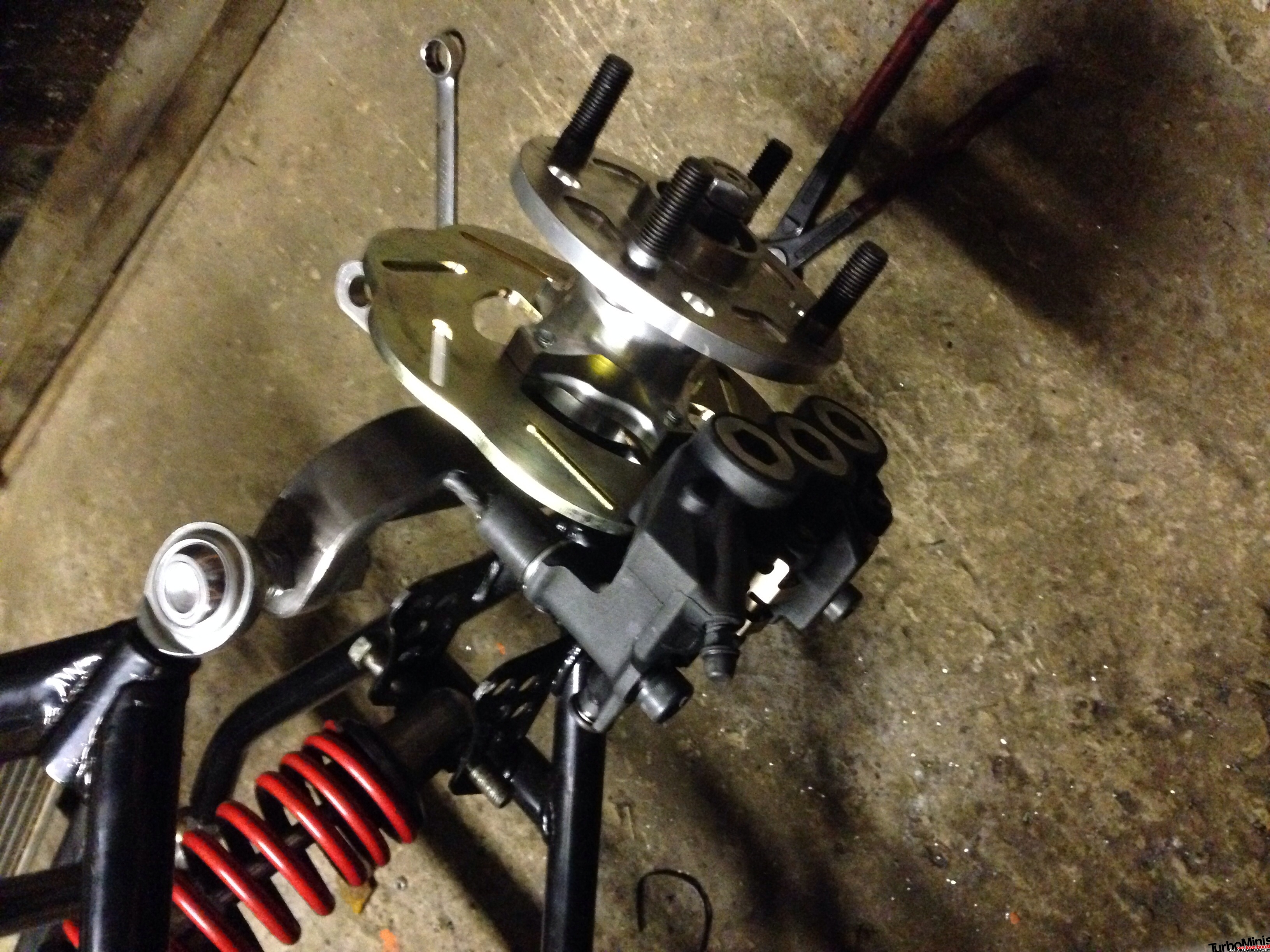

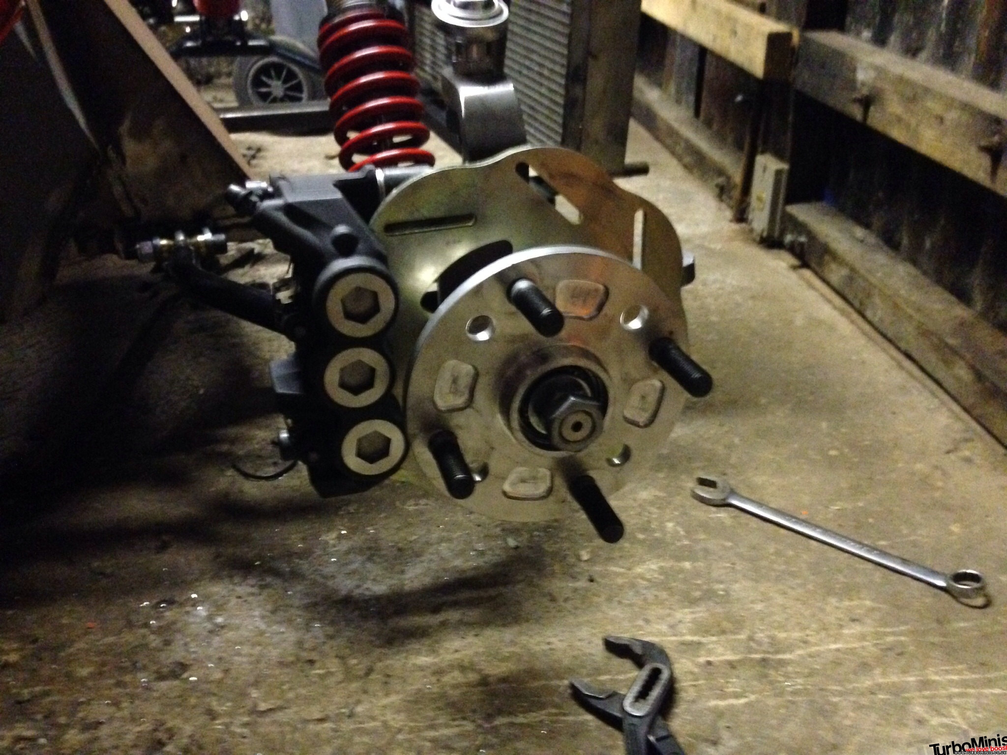

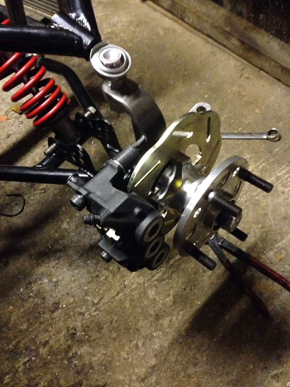

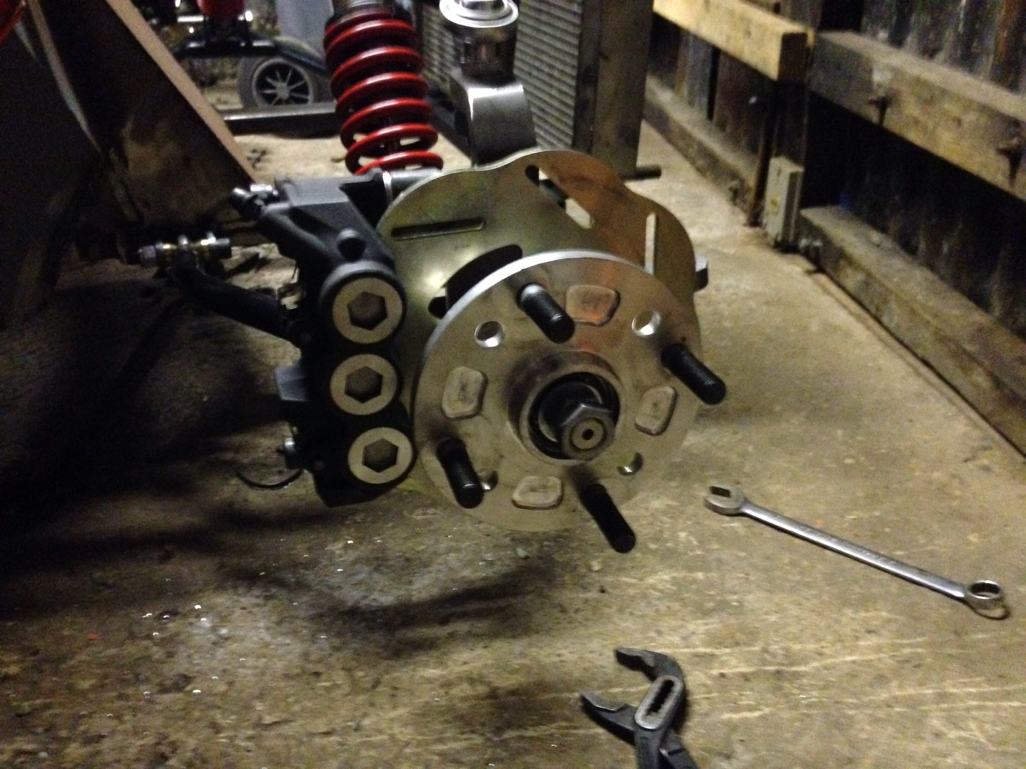

Calipers mounted. Fanks uncle Carl!
6966 Posts
Chavtastic mate
Thanks pal, you were a cog in this chavtastic wheel haha
any idea how much that brake settup weights?
Ill weigh them at Dinner time for you Brett.
Are those front brakes up to repeatedly stopping a 250bhp monster?
I know all the grasstrack boys use stuff like that, but they only use them very briefly twice on the oval for 6 laps max, top speed maybe 80mph.
I hope so. If they begin to struggle ill have to get Carlos to make me some bigger discs and just space the caliper out a tad.
Brett about 5.1kg
thats quite light lol,
mine came in at almost 12.5kg for a fully built hub
Wow that's pretty heavy.

It's not going on the road that often really so it shouldn't be too bad. I've got some four pots for the rear too. With a biast valve. But we shall see what happens
it is mate, my discs are solid 21mm thick, and my calipers are absolutely huge
its about 3kg up from the 7.9 vented settup i had, 25% gain in weight but it must be over double the stopping power, maybe more
I was trying to calculate how much better my brakes will be the other day actually. Overall they have to be way better than the drums and mini sport turd I had on before.

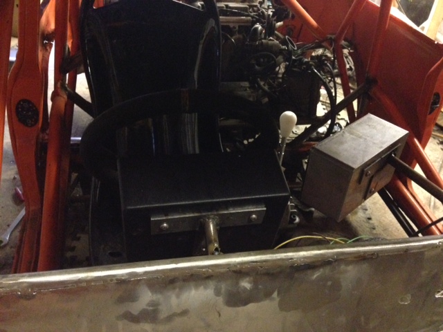

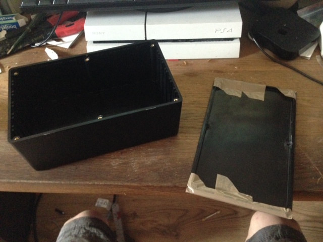

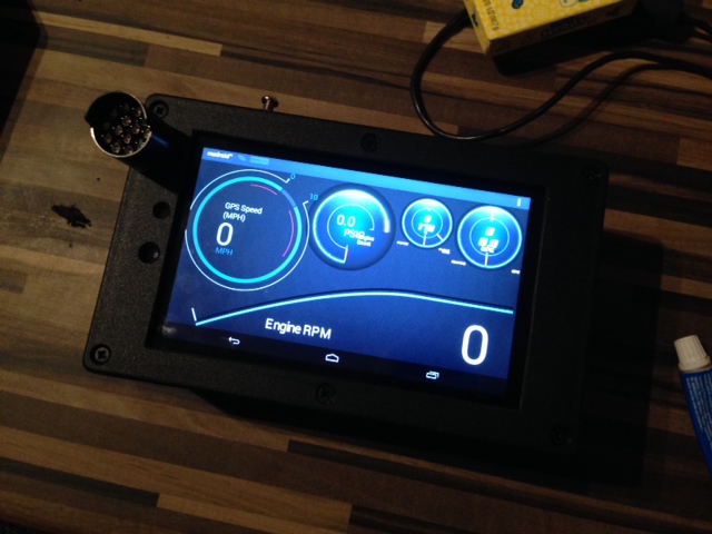

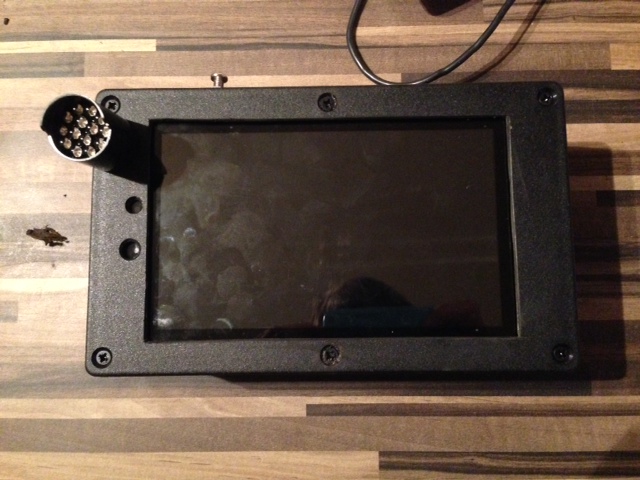

Quick Update

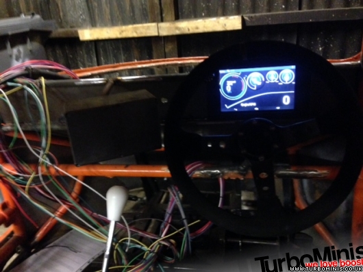

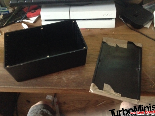

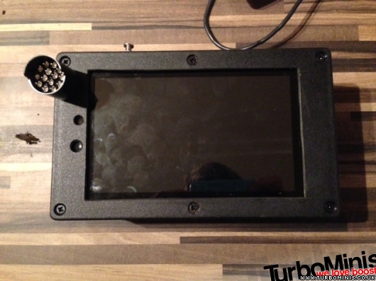

Dash is now made, connects to ECU Lovely VIA Bluetooth on the bench.
Hopefully its the same case in the car.
Flash git!
Video of it Just before I stripped it for the Volvo Engine
https://youtu.be/l8YWYhvFWKk

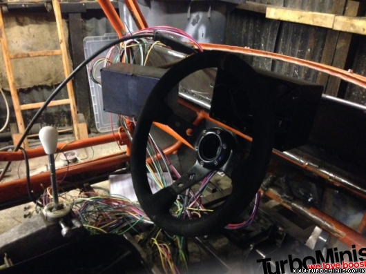

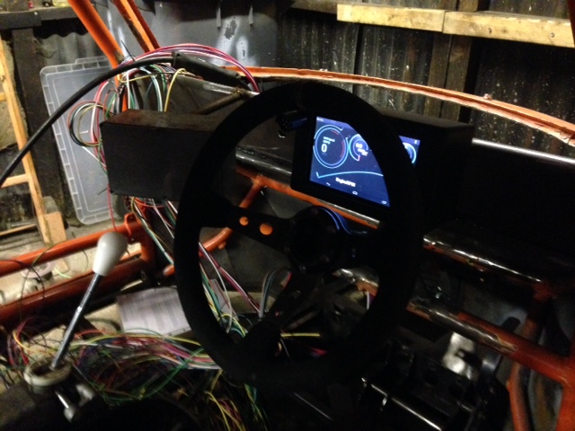

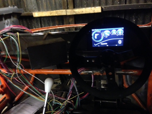

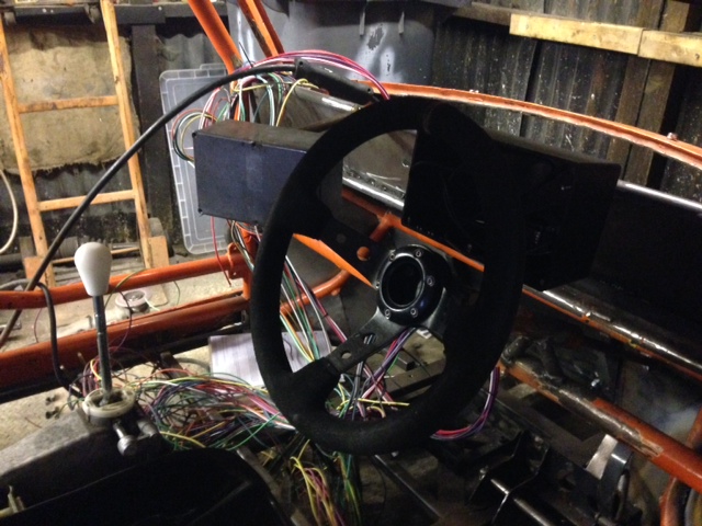

Instruments tacked it place.
Mike Race, the only thing I have found its without a shroud they can be hard to see in the sun. Plus if your wearing shades the polaroid effect on the shades can blank them out.
just as an FYI
Already thought of this bud, im making a plastic shroud to hand over the top of the box.

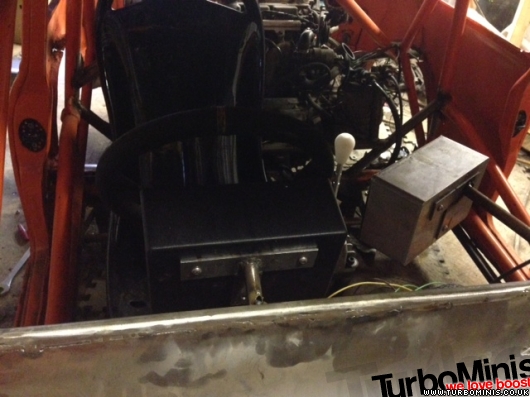

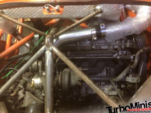

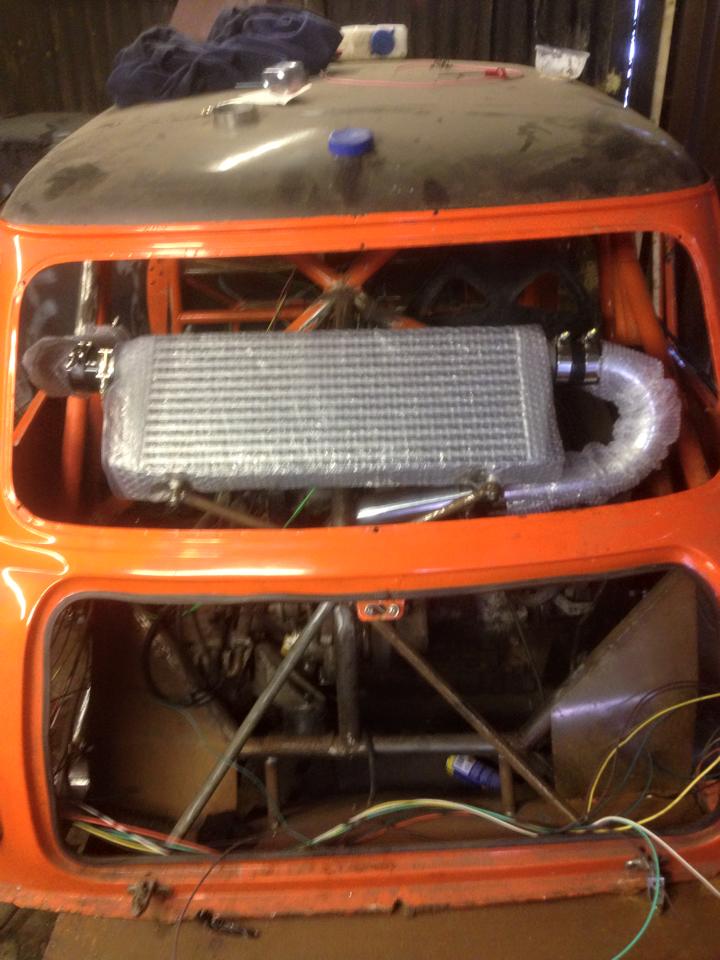

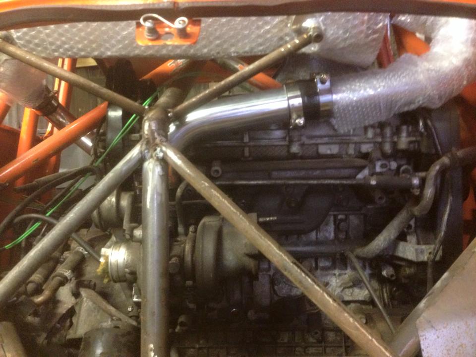

A bit more Progress, got a fair chunk of the wiring completed. Intercooler mounted.
Just awaiting arrival of a set of Stainless 3" 90 degree bends and a 3 Bolt Flange to make the down pipe. My plan is to route it straight into the diffuser, making an F1 Styleee Blow Diffuser *tongue* wether itll make any affect will be seen haha.
For anyone building a car from scratch I can highly recommend the Looms from EZ-Wiring in the states. There really high quality and all the wires are printed there entire length making wiring much less of a head ache.
My main thing to do next is wire up the ECU to the engine harness, then install an oil cooler, plumb the fuel lines, bung some oil and fuel and turn the key!!!
