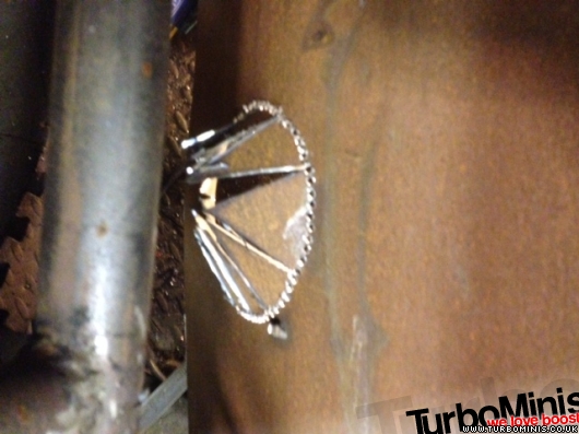

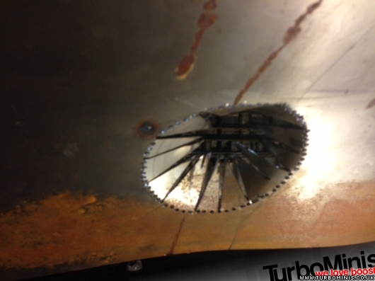

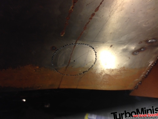

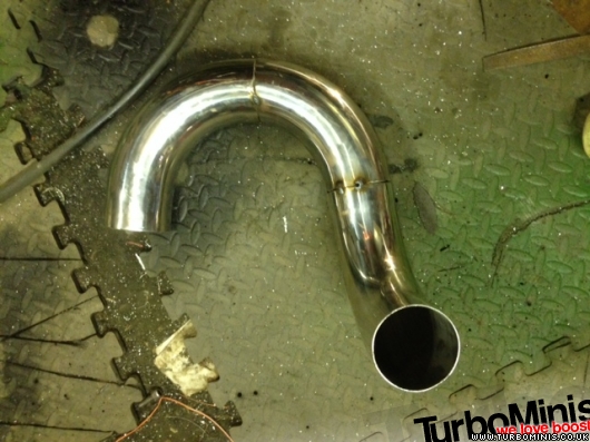

Started on my Exhaust last night, I bought some 3" Stainless Mandrel bends off he bay and 3 bolt flange which still waiting to come. Anyhoo, the exhaust it basically straight out the turbo, down, backing up on itself the going straight into the diffuser.
Had to stitch drill a hole out as I didnt have a hole cutter that large.

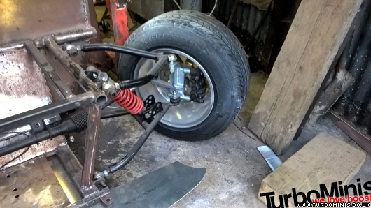

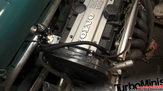

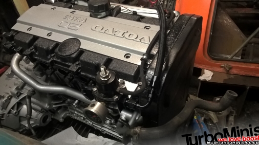

Ive just finished the Fuel Rail and Fuel Pressure Reg off tonight, also go the front end kind of fitted. Attached the A Panels to the FG front end and will attach to the inner arches with dzus pins.
Running immensely rich on a very basic map. But it runs all the same.

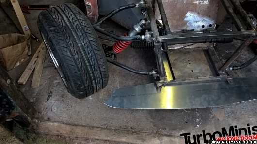

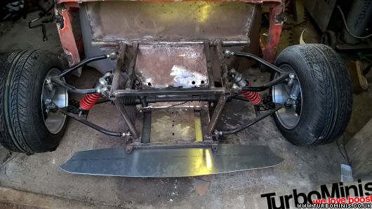

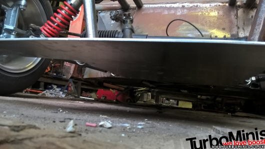

Made a front splitter and attached with counter sunk allen heads.

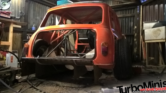

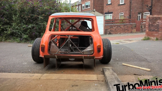

Also fettled the rear diffuser and set the body down where it should go, just need my arches now so I can finally get the body off and down the spray shop.
