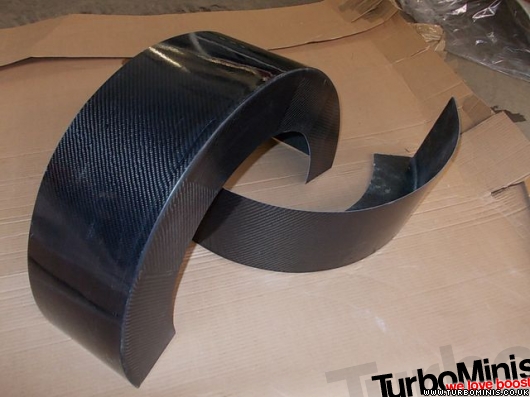

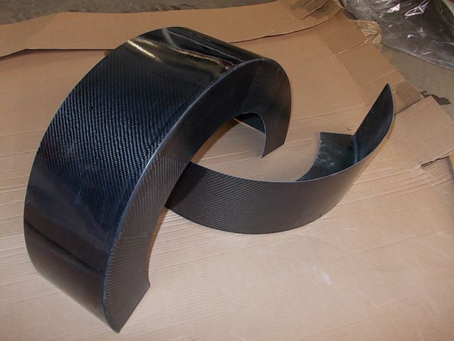

well to cut a long story short the boot floor has had to come out, and i think the seat back will follow while im at it, sort of semi spaceframing the rear end, then ill put some ally panels back in
saw these and thought mmm genuine carbon,

Gen-u-ine though, mega weight saving

In all seriousness they'll do the job- are they z cars inner arches?
On 5th Oct, 2014 Shauna said:
The Morris Ital assassin!
they are, and at £105 a set i believe they are rather cheap, no place on my car though i only do full fat fresh air

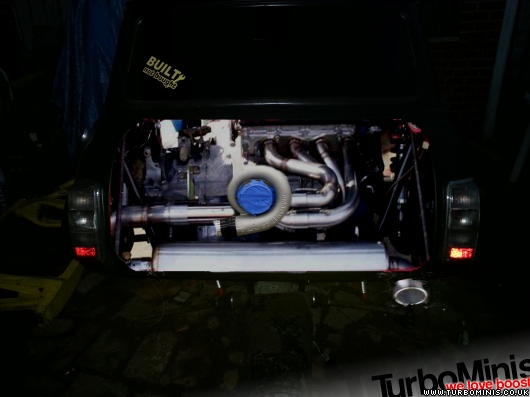

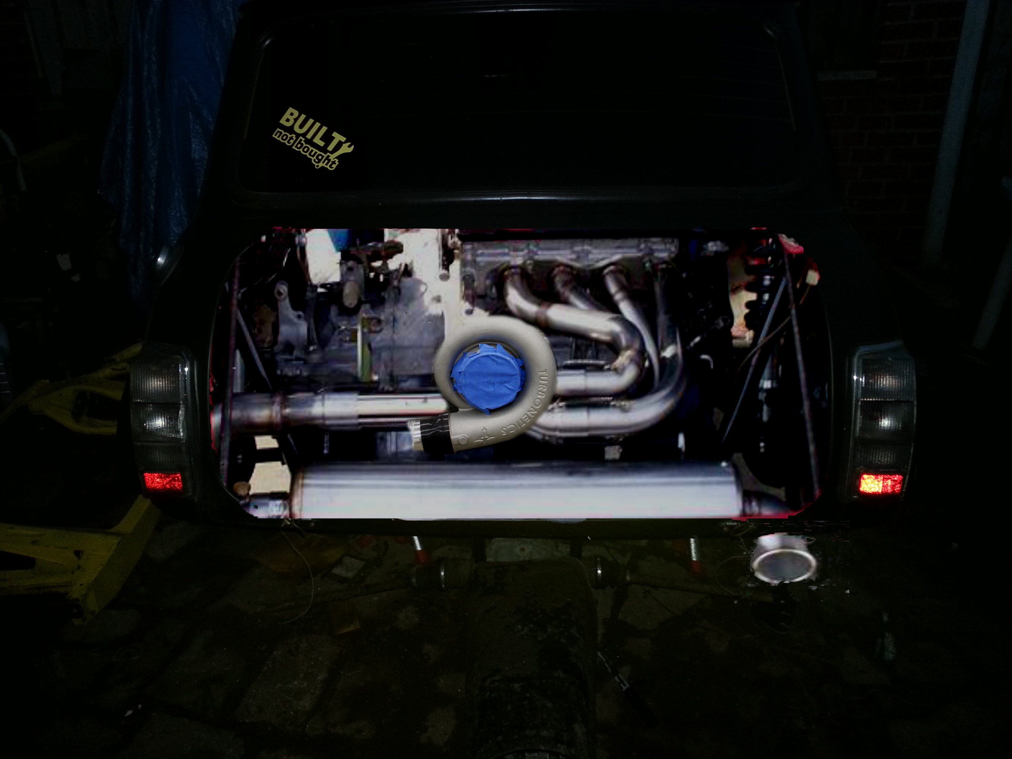

This is all a bit fishy. Presumably force rear hubs, with the rear arms positioned in such a way that you can't see the back of them. And now this mysterious reason that the boot floor is coming out and rear arches need replacing with genuine carbon...
Please tell me that this is going to be twin vtec turbo.

cloaks and daggers and a little bit of smoke and mirrors *Clapping*
I do love a good mystery *surprised*
seems legit *happy*
Edited by Brett on 14th Jan, 2014.
That was quick *wink*
That'l never work with gaffa tape over the compressor inlet
Colin, It's blue. That bit of tape is cooling the charge by 100deg.

Done now needs redoing lol
the blue tap is to stop the turbo from sucking in the dog, it does come off for driving *happy*
