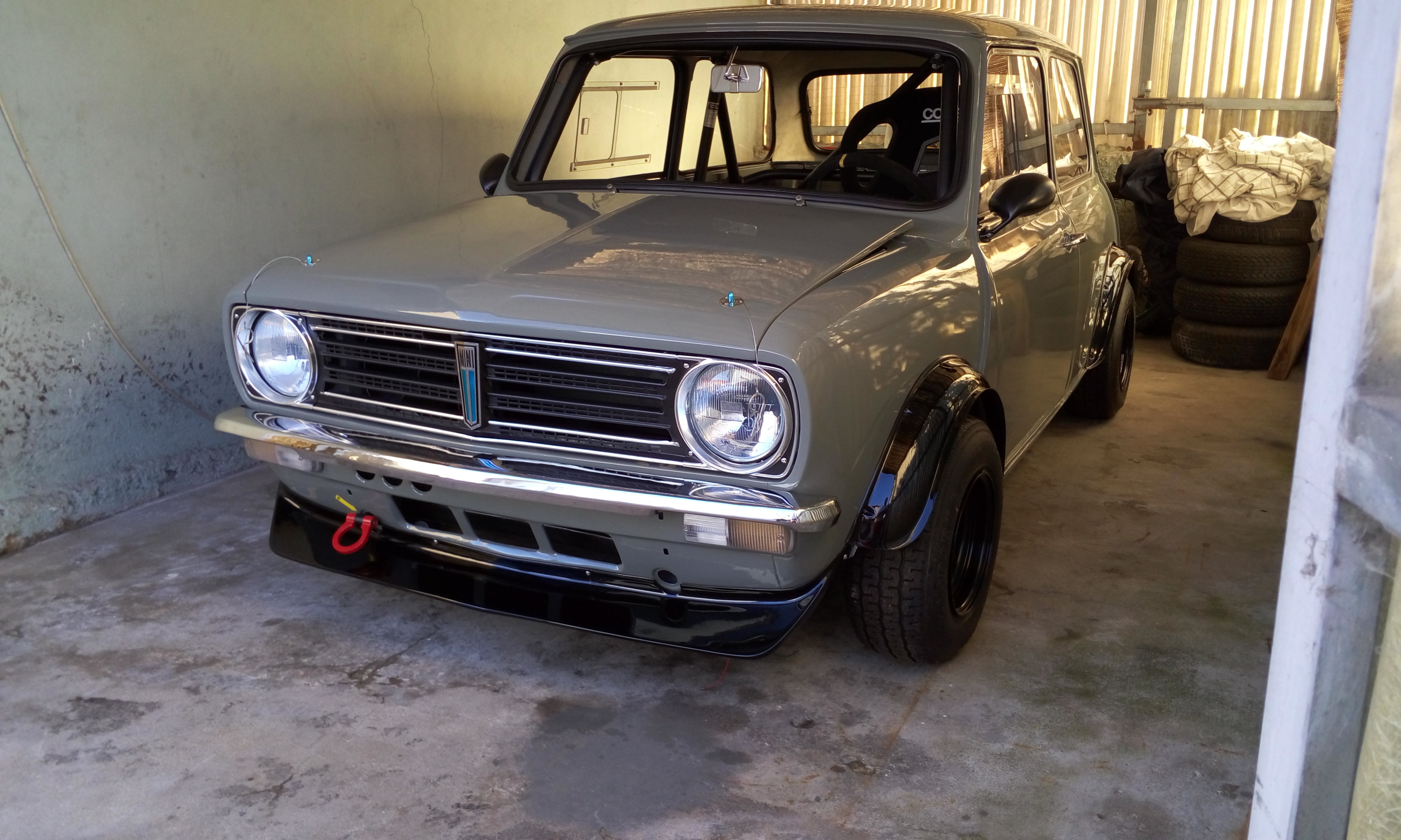

Diogo Lima
46 Posts
Member #: 8869
Porto, Portugal
Hi Nick,
Look at the spoiler, it fit better close to the air entrances on the front, you may need to form the metal to a perfect fitment, if you put the spoiler to low, it may drag to much down force and when lowering the car it could be a mess.
Really liking your rebuild, keep it on...
Regards,
Diogo
Yo-Han
976 Posts
Member #: 3228
North of the Netherlands
I like that spoiler, what's it from?
