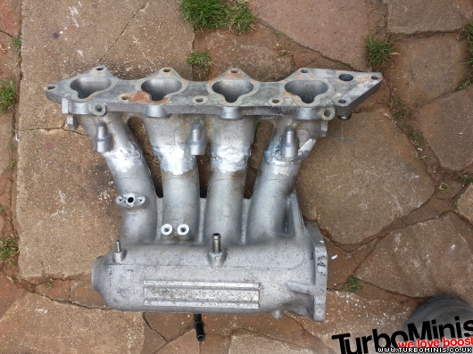

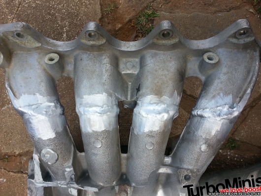

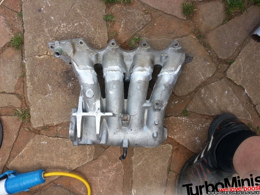

well as you can tell, that manifold was originally 2 separate ones and now there welded together as one, internally there was a slight miss match, nothing a couple hours of gentle porting cant fix
it would have been a 5 minute job except my flexi broke and the only bur i had that could reach was 10 inch long
wielding that beast in a mains drill was interesting *happy*

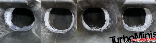

Before

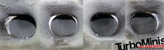

After
pictures dont make it that clear but now there is a smoootheee transition from one to the other

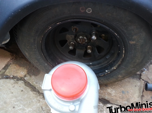

the turbo lol it looks really big next to the wheel hahaha

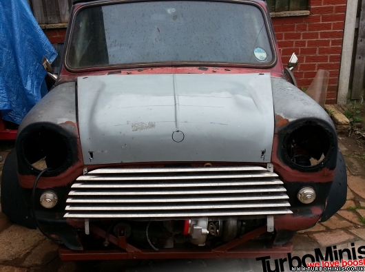

i put it slightly lower but this is roughly where it sits, it kicks the grill out a little ( well alot) but the splitter and air dam thats to follow will hide all this *tongue*
wng691s clubby
2057 Posts
Member #: 9252
Cleethorpes
you should put the grille behind the turbo
