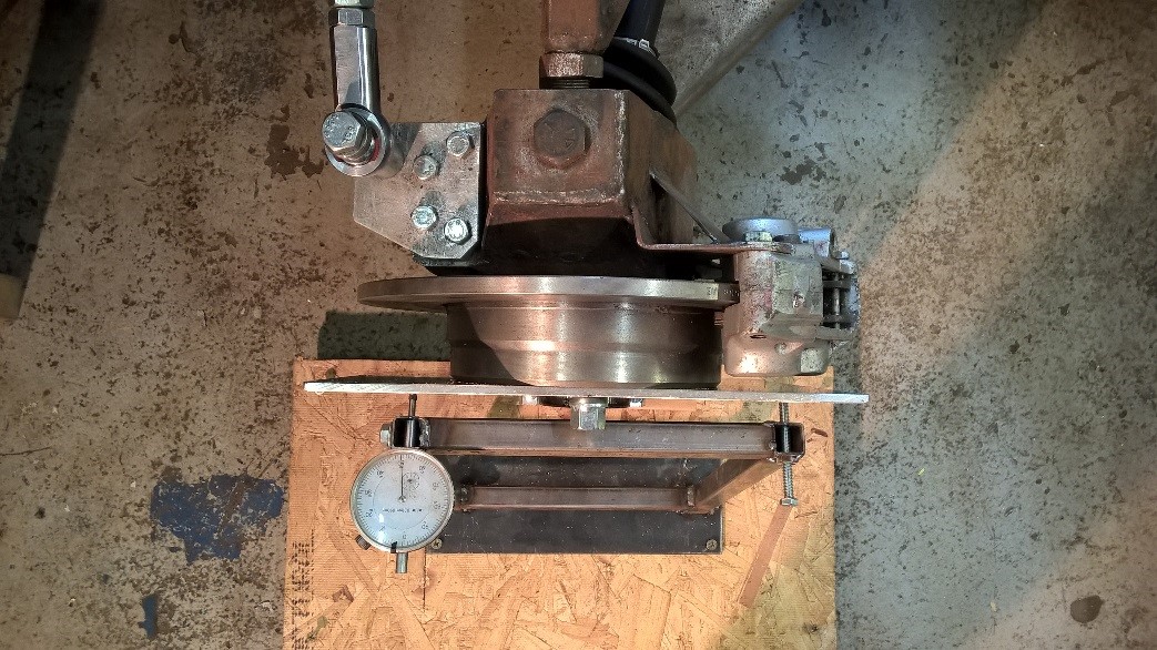

samforsey12345
18 Posts
Member #: 10987
Bromsgrove, DY9 0BB
takes a bit of time to make but useful tool from alan staniforths books
