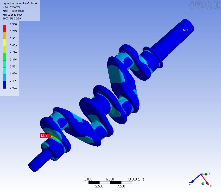

i have been thinking about putting three holes through the big web between 1 and 2 etc, and 3and 4. laying the crank on its side as in the pics and drill vertically,it would increase the surface area to heat treatment quite a lot, not monsters, maybe 14mm in the middle and 10mm out near the backdrilling,
thoughts,
carl

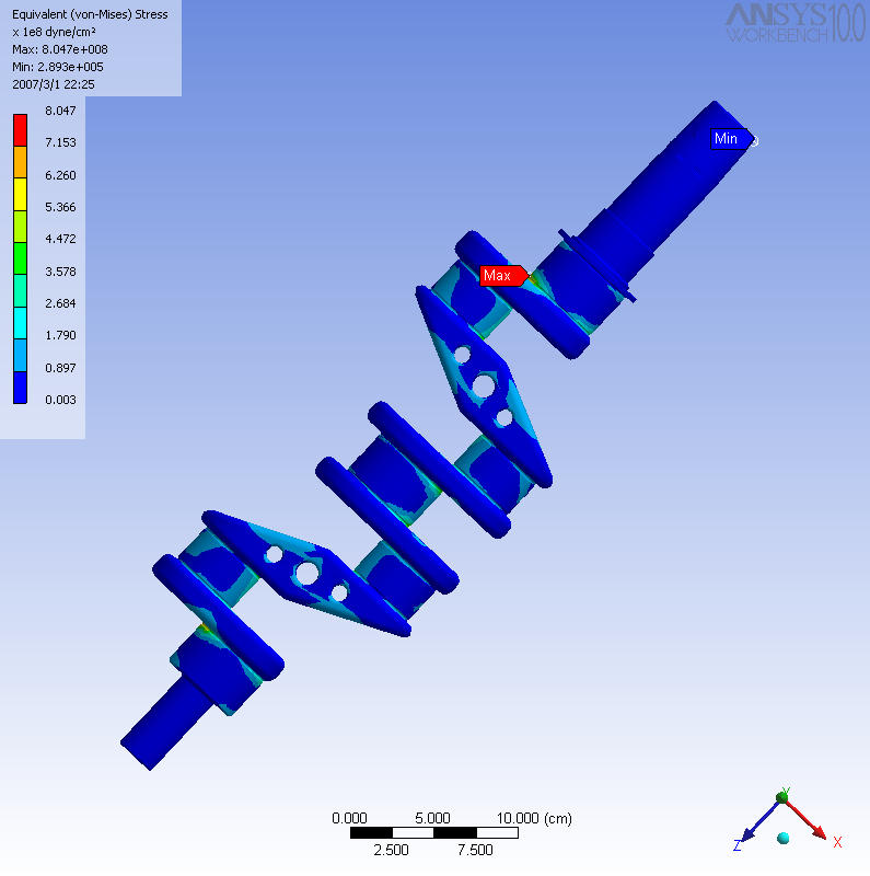

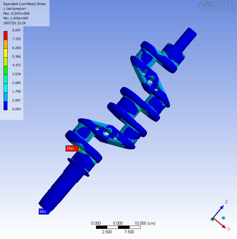

now put 3 holes in the main webs as i described earlier,
carl

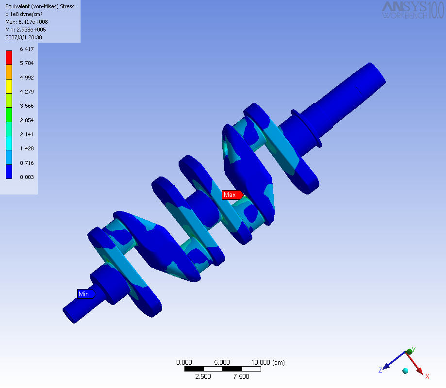

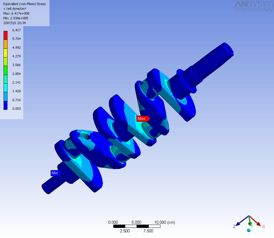

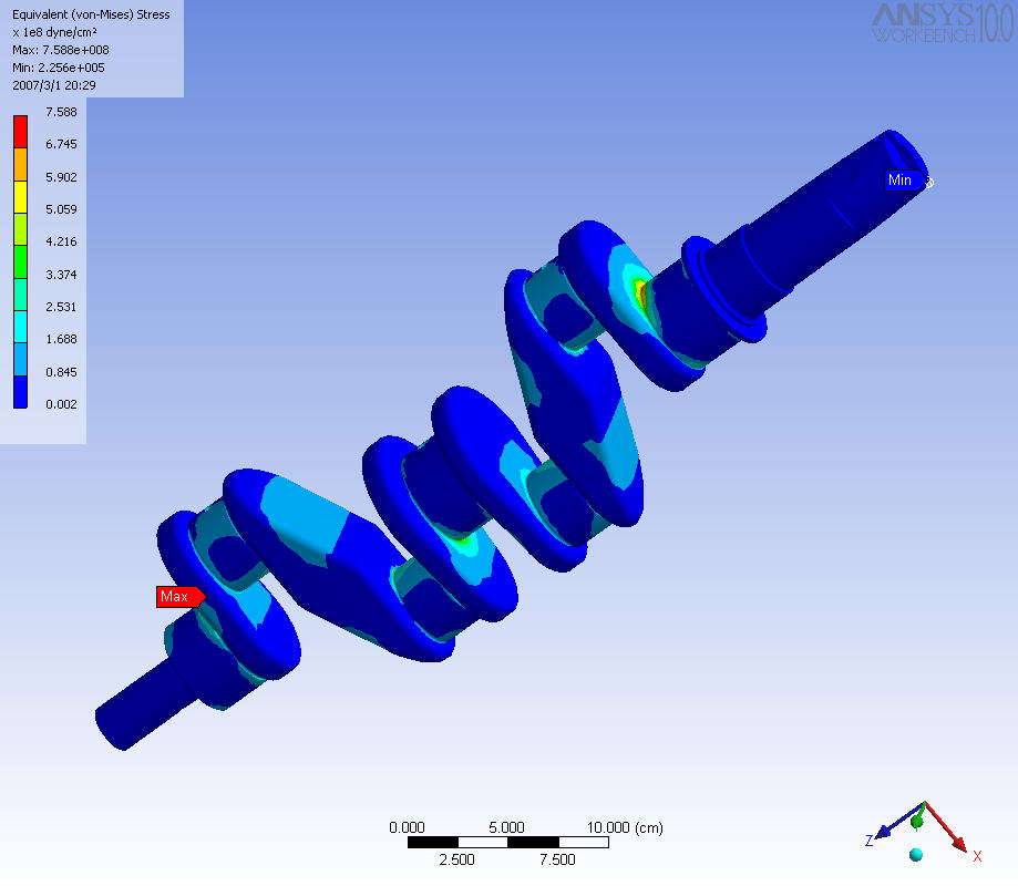

These Studies are only for comparison between designs and shouldn't be taken as gospel.
They also assume the surface of ALL the models are 100% smooth and the material used is Cast Iron.
Two things are infinite: the universe and human stupidity; and I'm not sure about the the universe.
Are the results of these stress analysis for a loaded up crank? IE does it take into consideration the reciprocating mass, two pistons and rods up and two down?
Varl. I get your point in reducing weight, but drilling those three holes won't do fuck all. It's so close to the centreline of the crank.

as carl says, it will increase the heat threated are quite much though...So may not be a stupid idea, but as a rotating assembly lightening, it wont mean much.

The study only looks at the crank and it's rotating mass. I'd need a CRAY computer to start adding the rods and pistons but i'll have a look and see whats involved.
This current study runs for about 2.5hrs on a DualCore 3Ghz PC with 4Gig of ram.

done it lol, just need to clean the bores up over the w/end. a fooking pain in the arse setting the crank up dead level in both planes so the holes pass through the web in a uniform manor. i think iv'e kept the holes out of the stress area, but hey ho,!! lol.
that FE stuff is bloody good,
