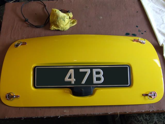

bit cold to be in the garage today, so have set about doing me bootlid, put the plate lamp and surround on, the surround and lamp are original 64 items *wink* i quite fancy the scroll type writing on the boot summit like Austin Mini, ala mk1 stylee.

Rich what are you gunna do with the wires for the lamp when the boot lid is removeable, im in a similair situation at the mo!
iain
8506 Posts
Member #: 16
Near Lincoln
I've got a relatively long wire so the boot can be easy put to one side (passengar side as thats where the wiring is in the corner of) and then if i need to remove it just a couple of spade connectors. you could put a plug, a RC car battery one would do the trick.

richie, if you havent already worked out the boot wiring, i can get you some connectors from work *wink*

chers, i am using the white tamya type RC battery connector as Iain mentions. on the removable front iam using a DIN plug from a stage Mic.

richie, will a din plug take the amps??
I wouldnt have thought there were many amps goin through the no plate light?
sorry I should have quoted, I was refering to the din plug for the front lights, I know they can draw quite a bit of current

yes it 8nt the thin commoner gardner stuff this shizzle is for massive rigs, i say Din plug, it will porbably be summit like a speakon or summit like that., i will see, if not just go massive and use a caravan type socket.

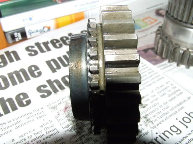

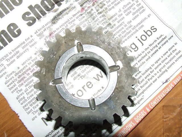

Well Big thanks to Kevin Dempsey at JKD the new gear arrived today, can anyone advise if this is correct, it looks totally different to the first one i had. it is 27 teeth though.

thats def a syncro gear if thats what you mean?

aye, fingers crossed it will be the end of the challenge gearset heartache !!! the one that is in is clearly fooked wish i had known what i was looking at when i got em psml. but its done now and they are fitted so hopefully the taller ratios and the taller diff will help with top speed. like i say just need an idler gear and first motion gear, i have a SC primary but not sure who its made by ? its 24 tooth and has 5 oil gallery ways but it 8nt stamped anywhere with any make etc etc. iam so tempted to borrow Stevies drop gears and flywheel but theyare A not A plus, and he would tear me a new one if i did :)
