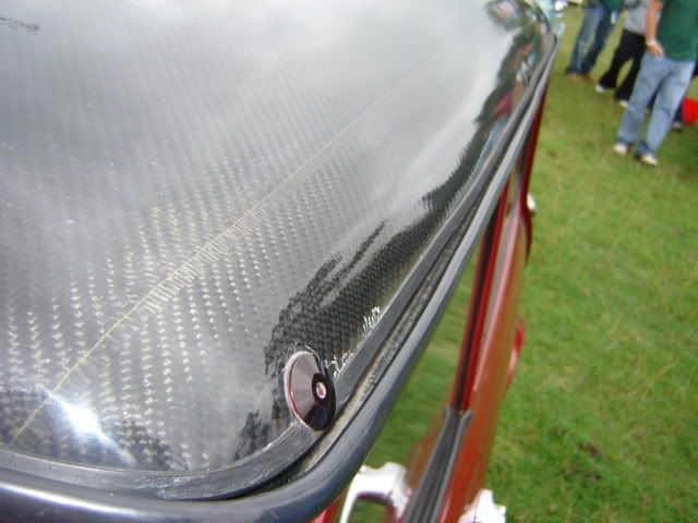

Got any close ups of the roof? I'd like to see how well the weave shows through and also what the joint looks like with the metal (both inside and out).
I've never seen one showing the weave and from the grp / non visable weave ones I've seen in the past I am unsure how well it'll work if you can't blend the edges after fitting extra.
You seem to be taking a lot of pride in your work so your car is probably a good one to judge from.

thats a good idea about the mirrors!
the roofs not actually one there yet, its just the origional was painted black!
the weave shows through well in it, the resin is a bit cloudy in places though! it looks worse in this picture than it actually is.
fitment wise all that will be visable from the outside with be a bead of black mastic in the gutter, inside should be mostly hidden by the cage!

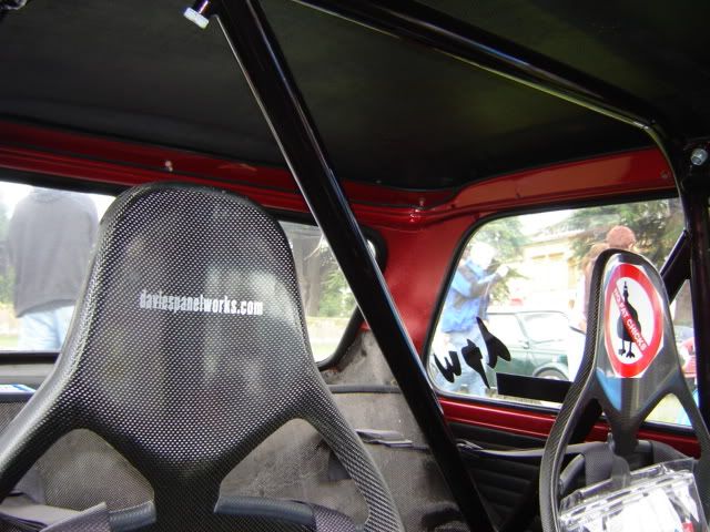

the other way i ahve sen it done was like this, its not actually bonded into place and has rubber trim around it.

Thanks for those pics ..... not sure the roof has been fitted square on that red car, wouldn't be happy with that personally.
Be great to see how yours turns out.

yeah now i have looked at that it does look a bit wonky!
im sure its going to be a nightmare to get right, like a carbon/grp stuff is, im itching all over from cutting my front end about!
