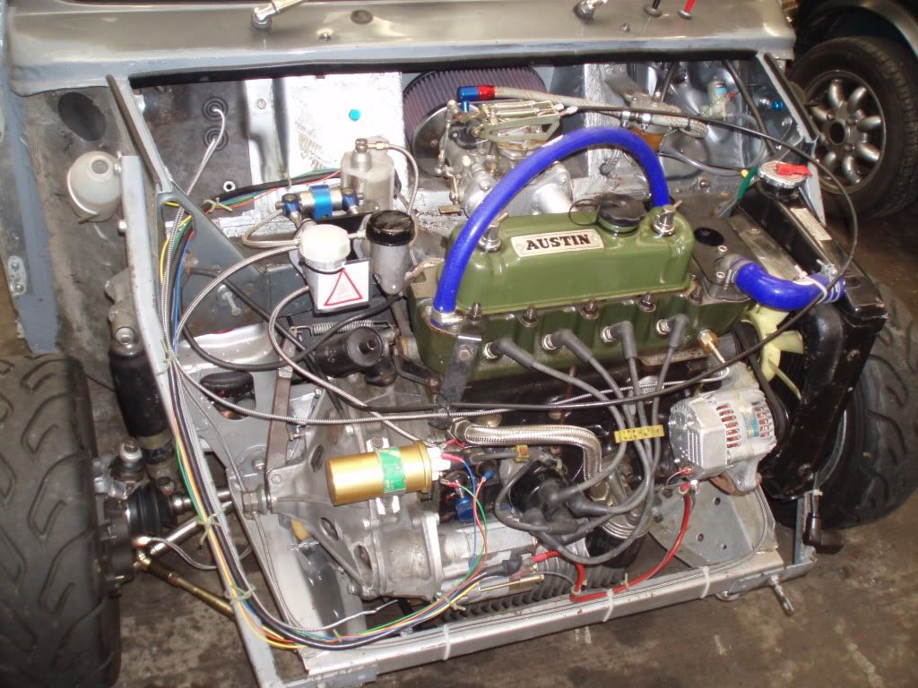

well, did a bit of refining today, didnt get chance put it on the ramp and tickle the suspension, but its not a millionmiles off where it is, so went for a lap of the tt course to put some miles on the engine
it was not getting up to temp only about 60 really, and spitting water out left right and centre, whipped out the blanking plate and stuck an 82 stat in this morning and problem seemingly solved
id plumbed in the hydraullic hammy backwards, so swapped the unions around and viola, instant russ swift satisfaction

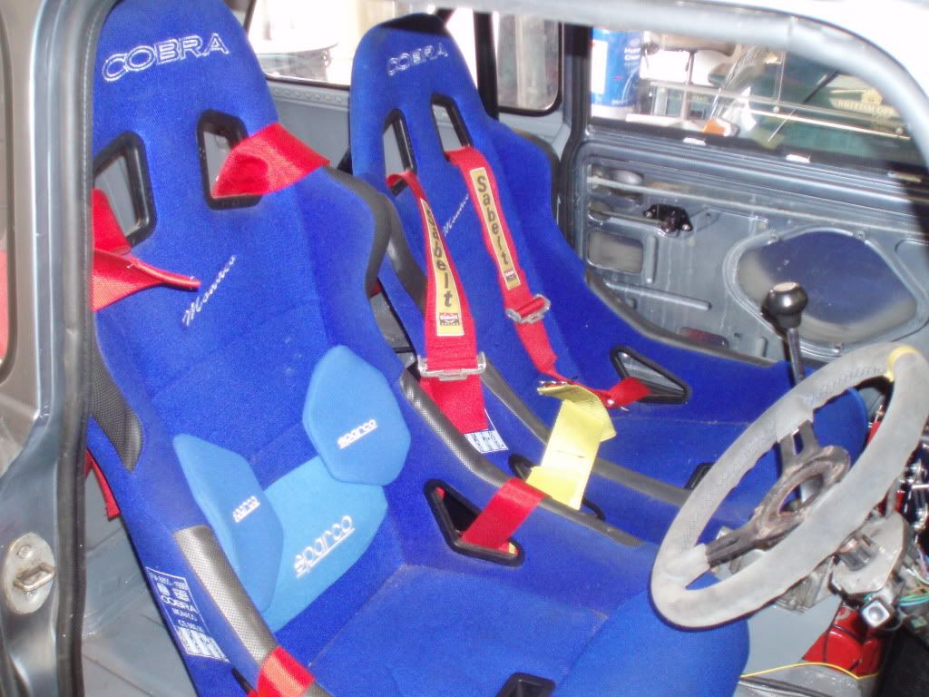

fitted passenger seat/harness

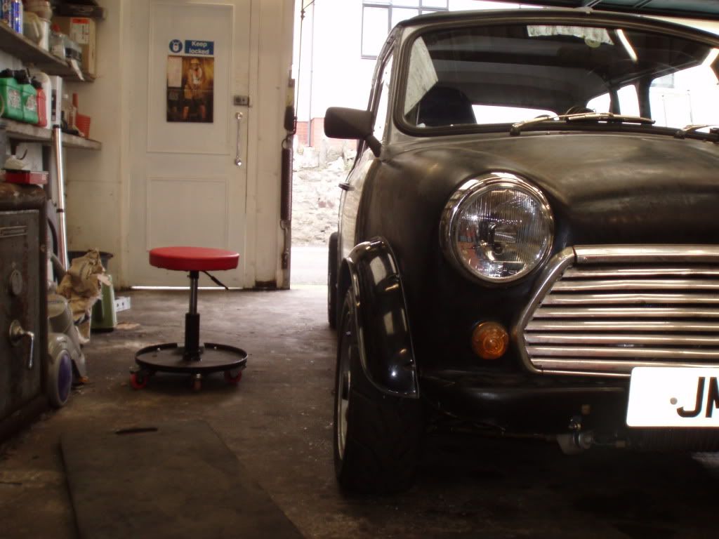

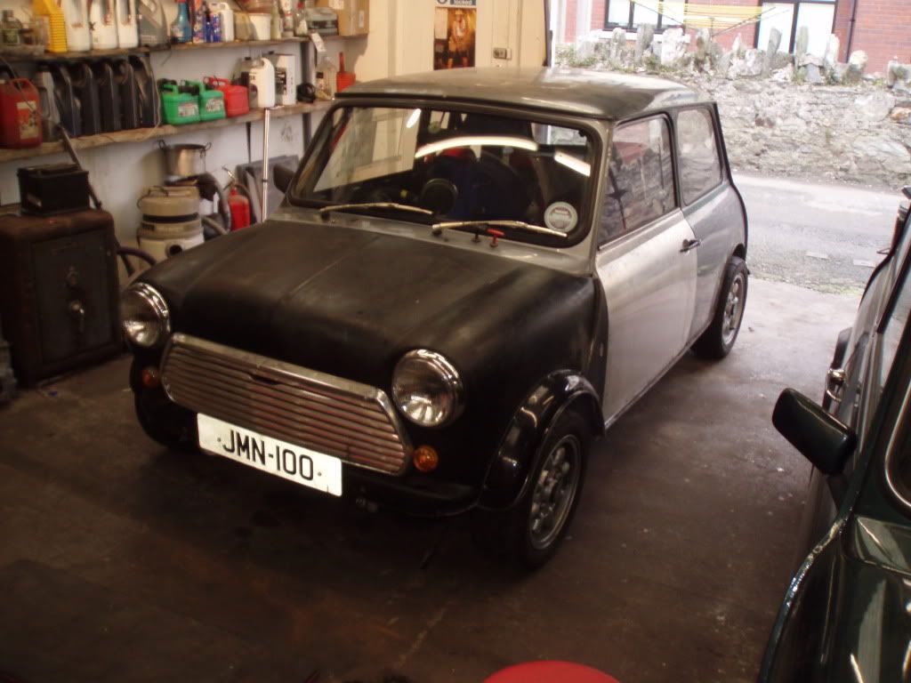

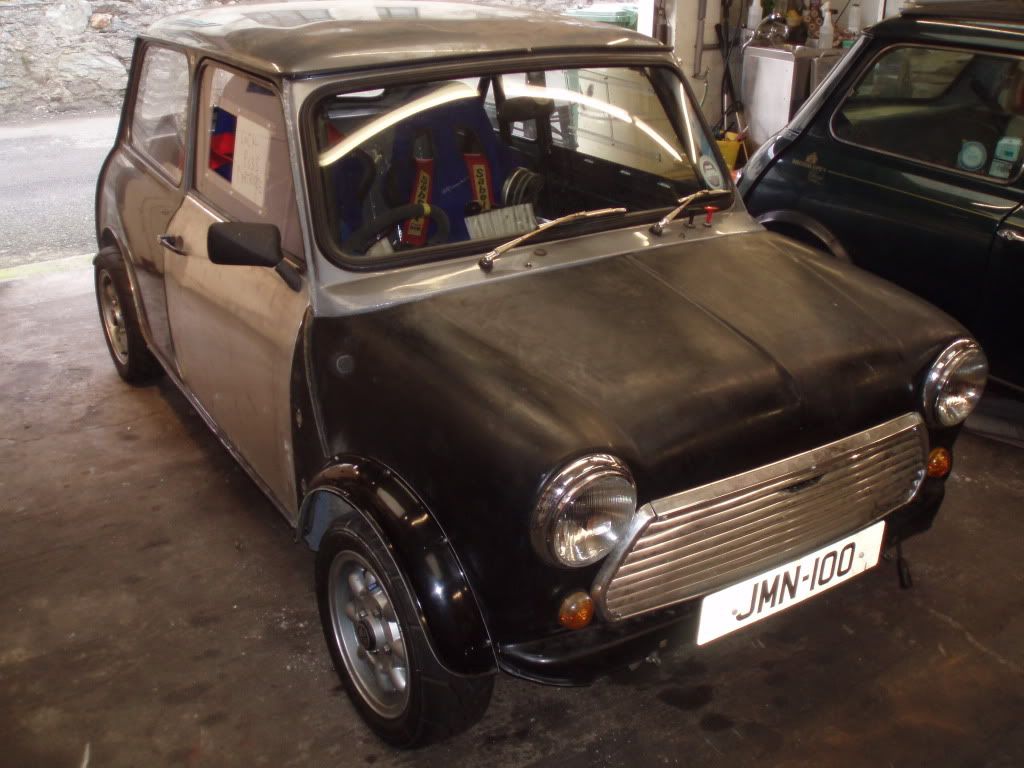

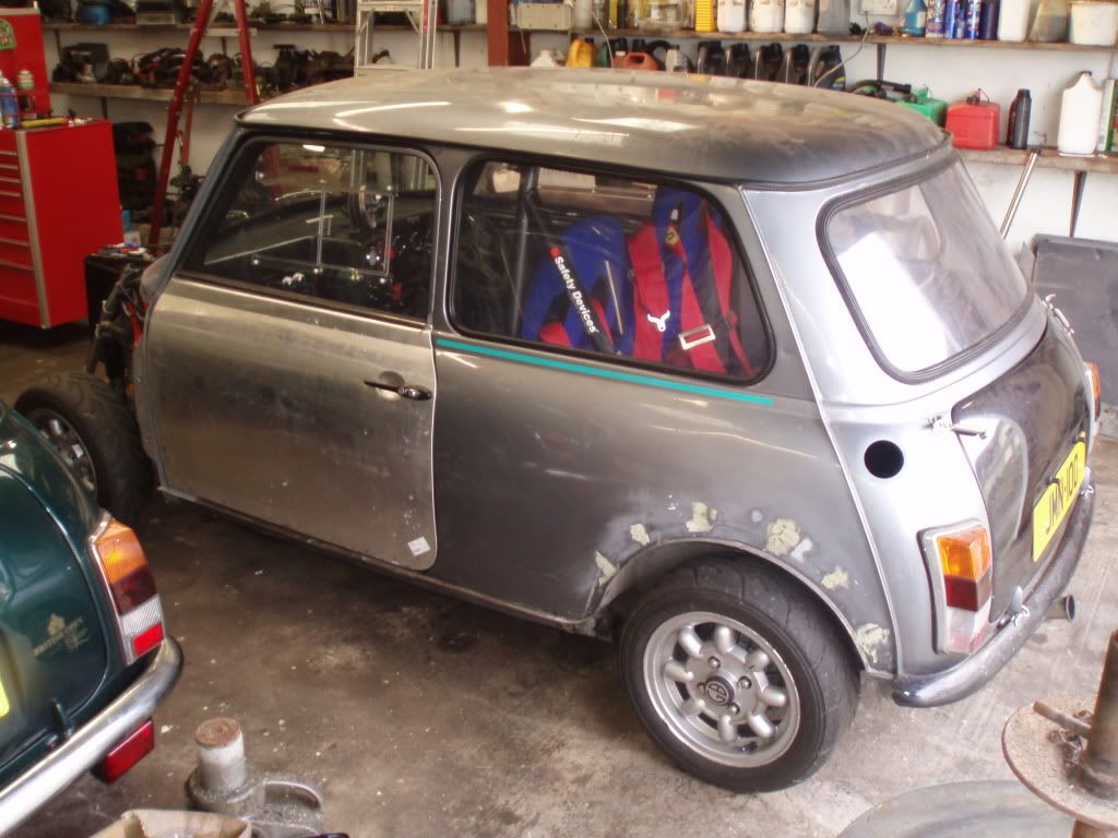

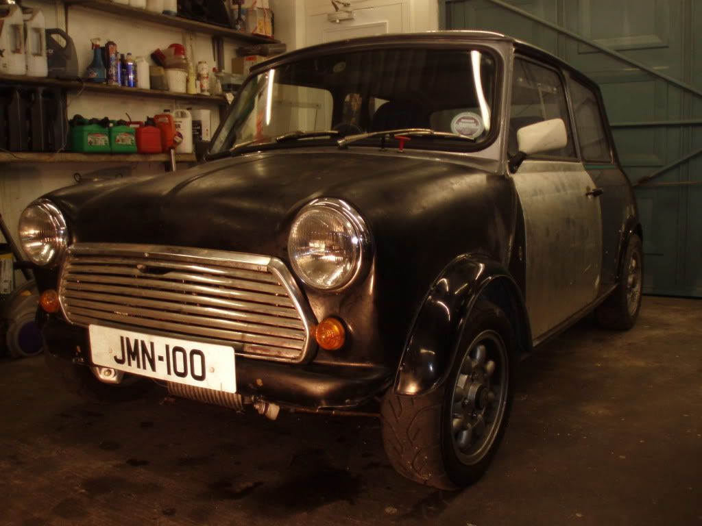

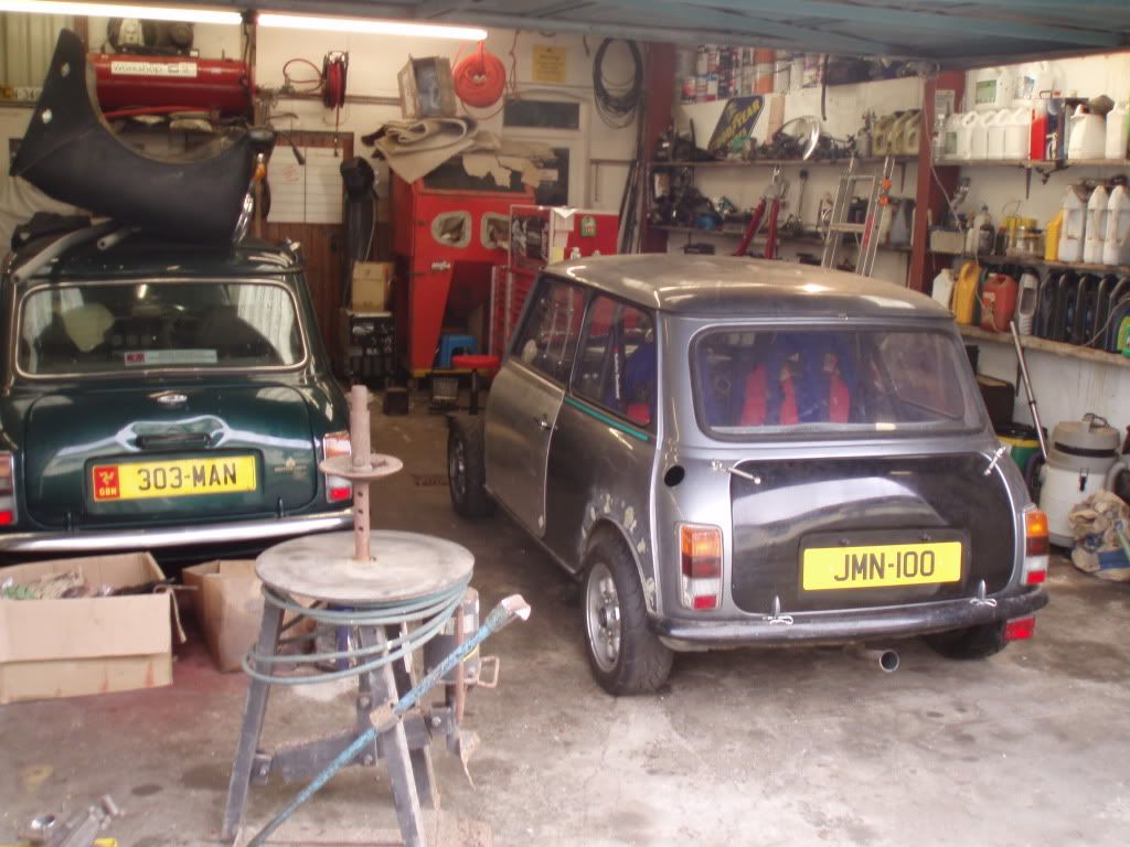

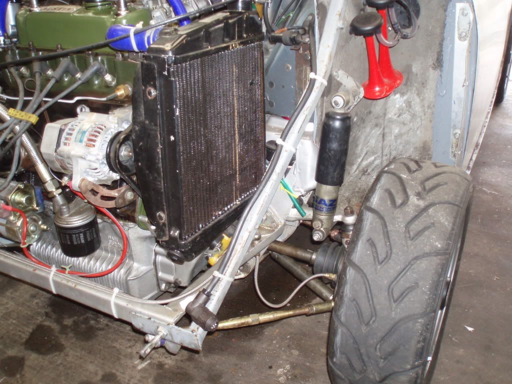

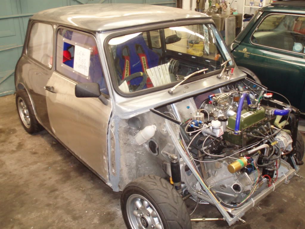

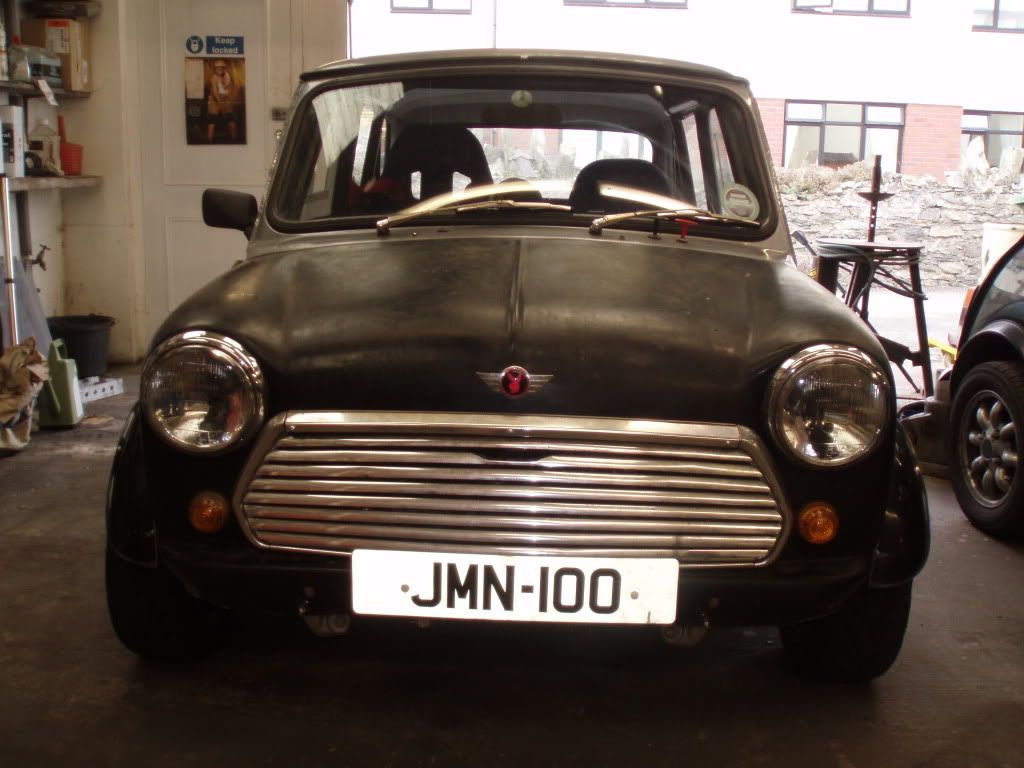

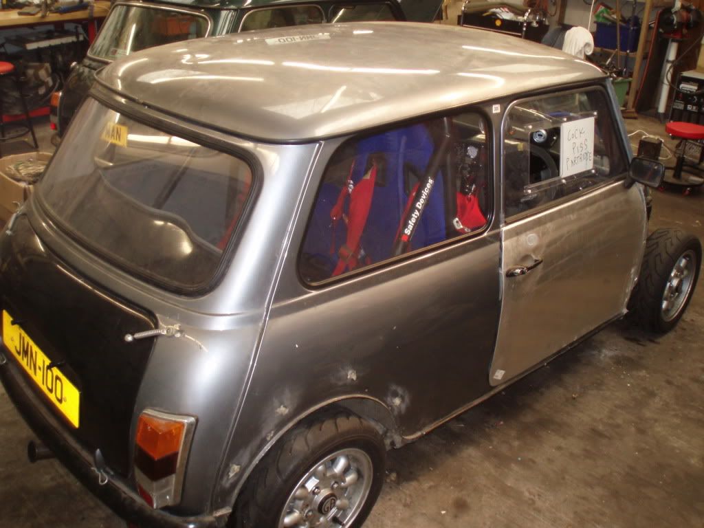

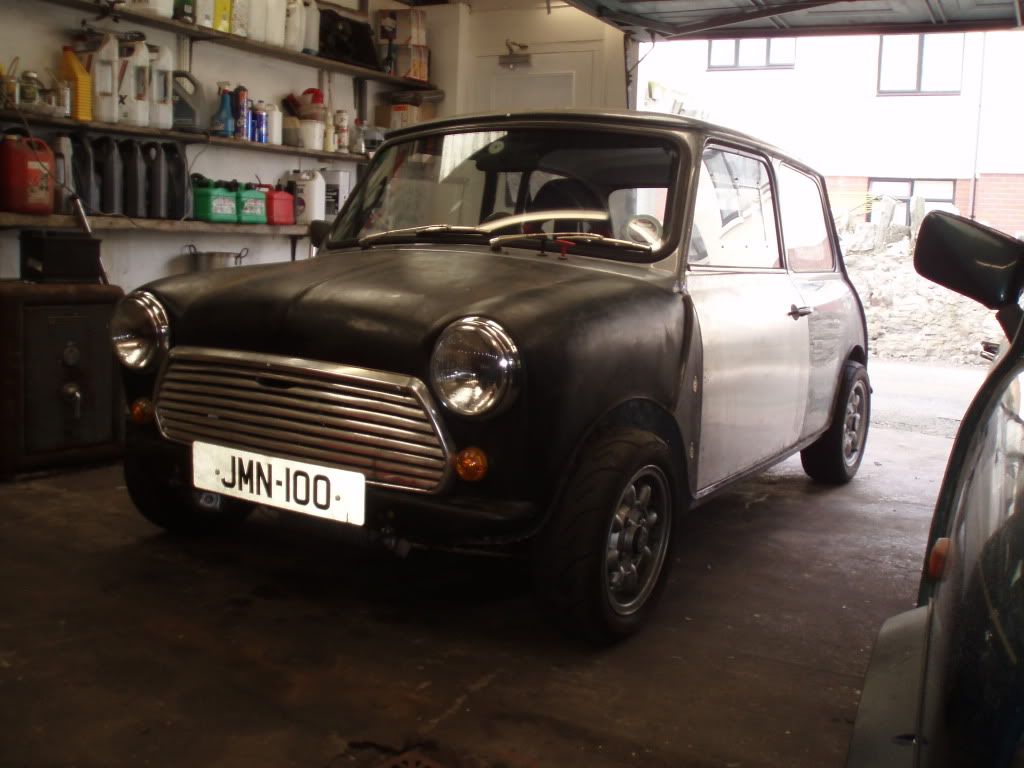

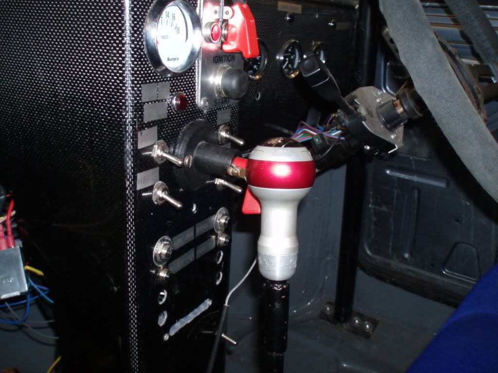

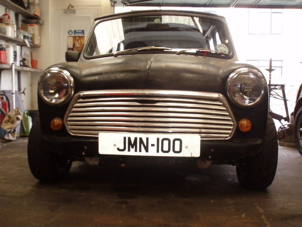

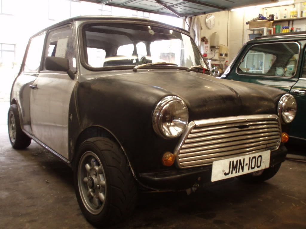

got some up to date pics at last:

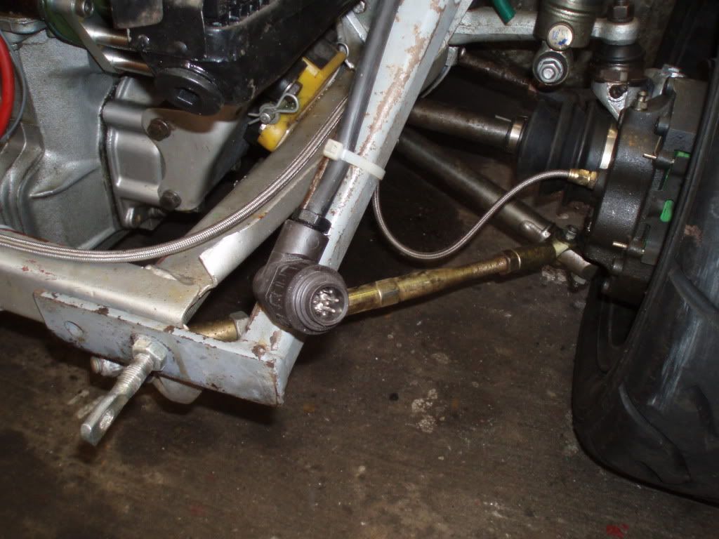

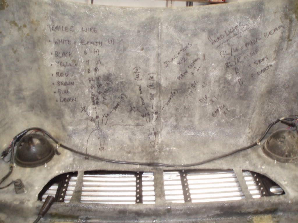

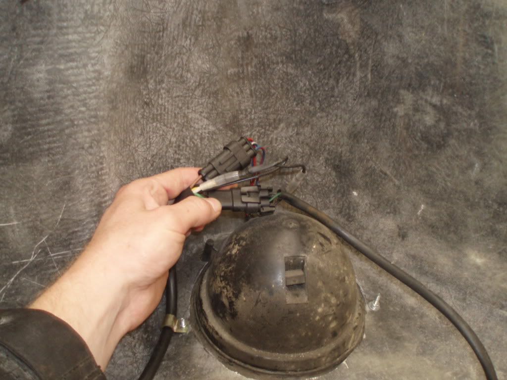

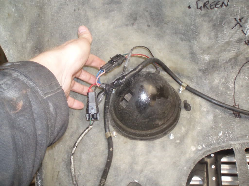

Also some pics of how i wired the flip front up:

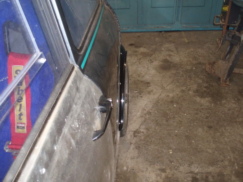

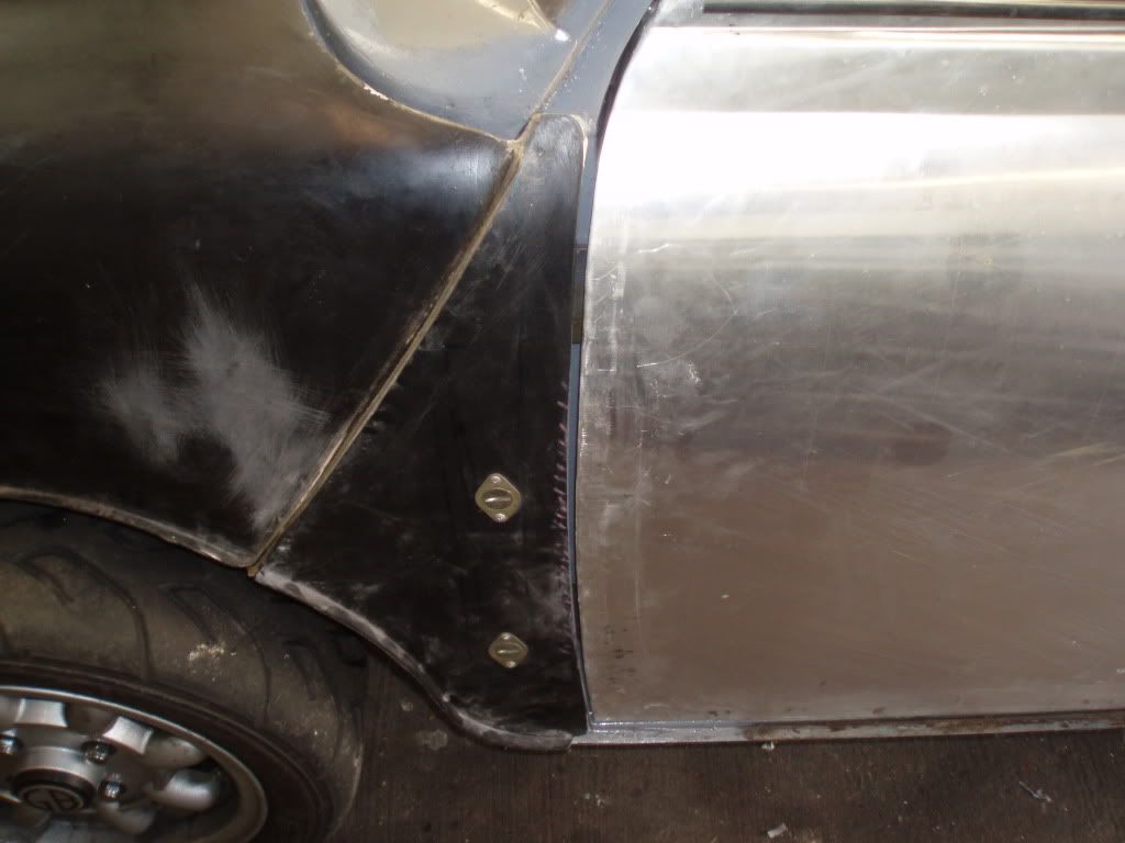

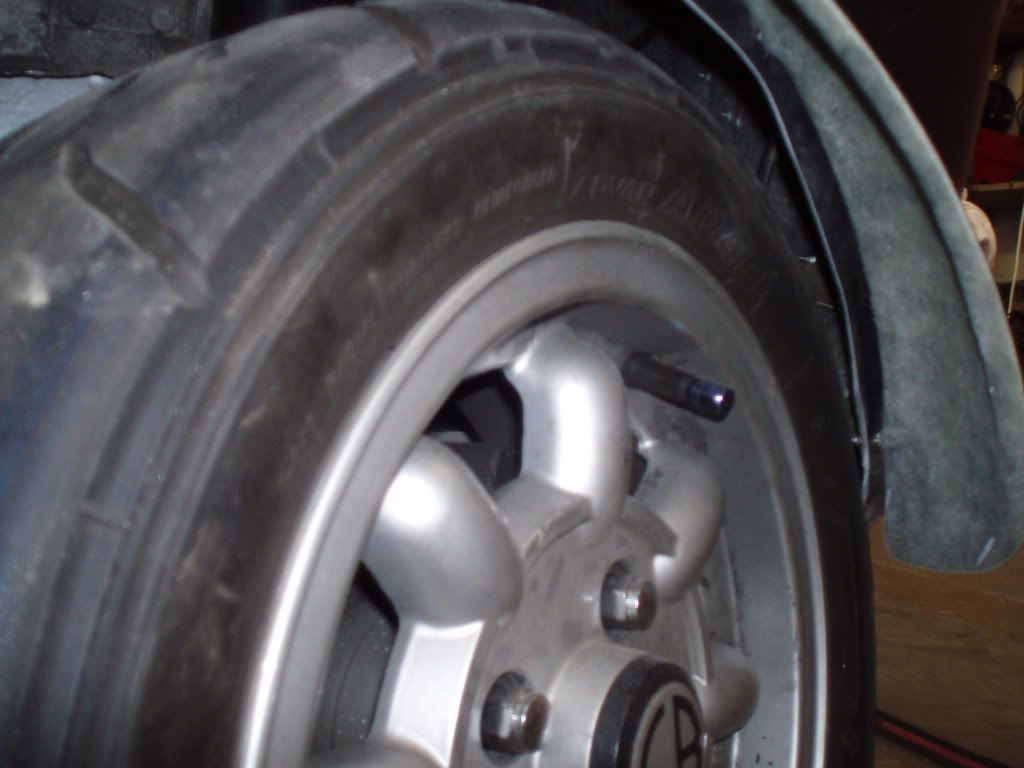

ive got some std grp2 arches, but i dont think they will cut it at the front and the flip front seems to have shrunk in the wash a bi and left the tyres really exposed. So whilst noseying around ABS last week, i spotted some lovely wide gr2 front arches being prized from their moulds, they looked like they would cover my tyres, so bagsied them and got them on the car today:
still need a bit of trimming so they clear on full lock, but im gonna leave that until ive had chance to finalise the suspension settings (waiting on corner weight gauges and grease plates off a friend) as its running about 8/9 degrees castor at the mo and ill be changing that to about 5 which will hopefully move the wheel back into the arch a shade

Can we see some more pics of your calendar please?
Why does it say Cock, Piss, Partridge on your window?
nic, i should have guessed you would like it, ill snap some shots tomorrow, just for you!
john, its from an episode of alan partridge

where was that connector you've used for the flip front wiring from mate? i have a caravan connector and its not the tidiest solution

yeah, its neat plug, i was umming and
arring over a trailer plug, but i dont like the look of them
but what a complete bastard to solder up though as theres no space and the 7 core im using is the hd stuff so had to trim the wires down a few strands to get them to fit, could have done with a pair of baby hands
saying that, i took about 2 hours to do one, so palmed the other one off on my old man who took about 10 mins, lol
it was off ebay, but he only seems to have the male in stock right now though?

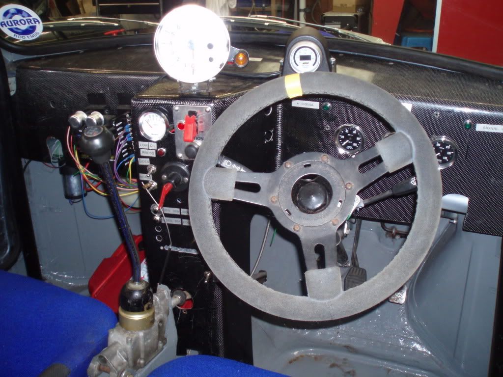

thats a nice busy dash :)

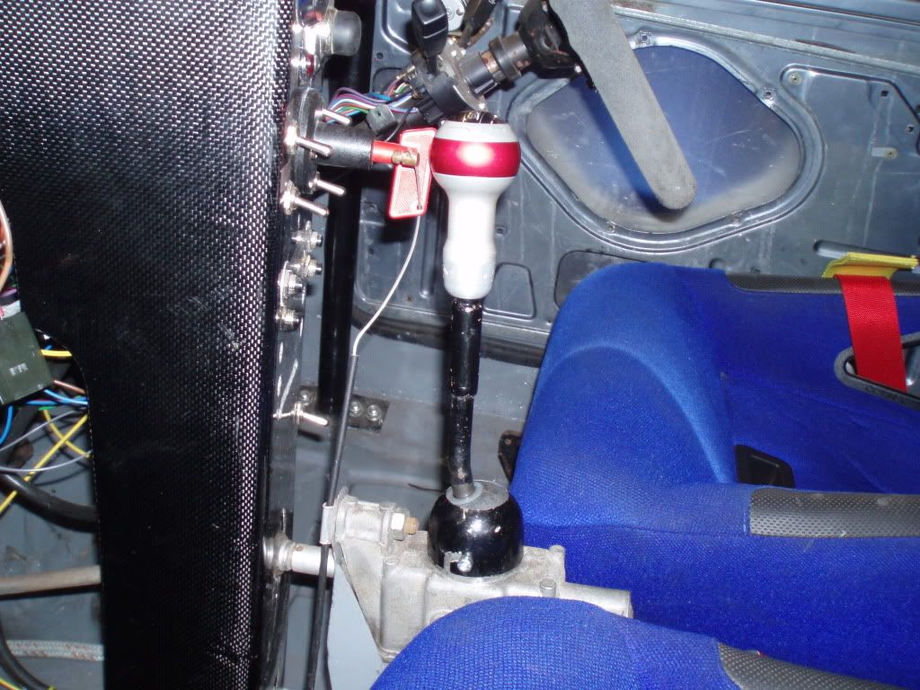

Also tried a cut down std gear stick instead of the tall KAD one, and hit a problem, it fouls the cut off switch in 1st and 3rd:
so looks like im gonna have to relocate the cut off switch :( will be a crunt to get behind the dash now the screen is in too! hope the wires can stretch a bit!

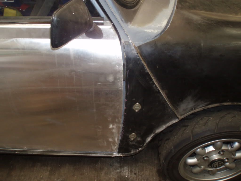

fitted the passenger wing mirror (cheers R1_Manx), using riv nuts, love those bad boys, and also rear arches, and they just cover the rubber:

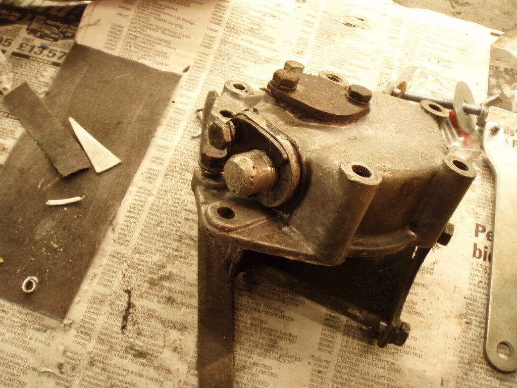

ive tracked down where the oil leak is coming from too (well most of it anyway!), when i was fitting the speedo magnet to the cv joint today, i realised i never blanked off the speedo drive, and oil has been pissing out everywhere haha
luckily i have an blanking plate off an old challenge gearbox
so will fit that tomorrow, or maybe wait till i have the rad off to fit the trigger wheel back on, yer, will probably do that!

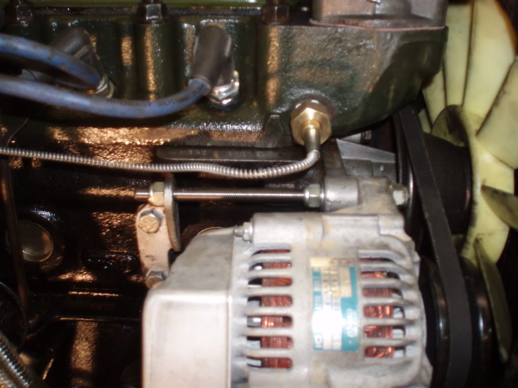

also fitted a bit of stainless threaded bar across the extra alternator mount to support the waterpump housing, a few people have mentioned that the boss on the water pump can snap off if left unsupported, so this should give it a hand i hope:

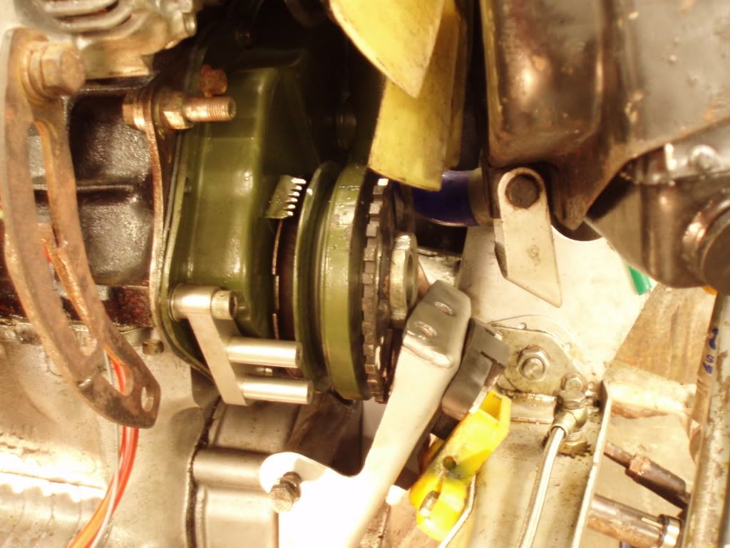

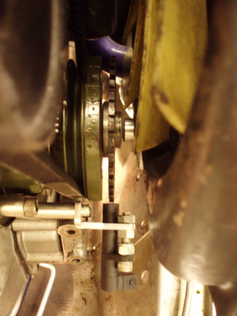

Well, got a fair bit done today too, lots of 1 step forward, 2 back though

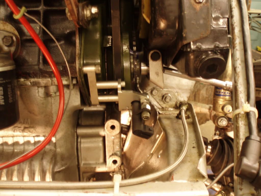

Mocked up the crank sensor bracket, needed a fair few washers to space it to the correct position, and had to drill and tap the sensor holder and space it back a bit as i think there designed for a different type of sensor?
so got that bit sorted, also set the missing tooth sees the crank sensor approx 90 btdc, can alter the bracket by about 10 degrees in each direction, so ill get it dead on once the edis is installed by using the limp home mode and getting the spark dead on 10 degrees btdc on the crank damper.

The SC trigger wheel kit uses a Magneti Marelli SEN8D sensor
http://www.specialist-components.co.uk/cnb...odCategoryID=17

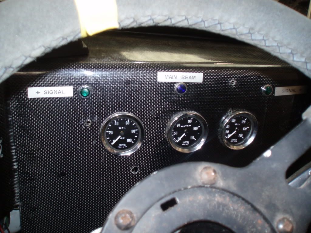

your dash looks like the starship enterprise
