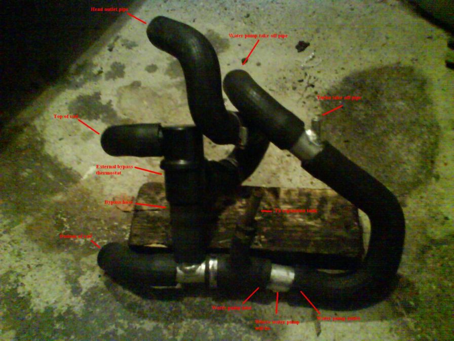

I could be talking bollox but....If you were to use an external bypass thermostat the restriction in the cooling system should be less than that of a standard thermostat due to the orifice of the hoses and passage way remaing a constant size instead of being reduced down to a single hole like a 'regular' thermostat.
I know my thermostat works by being feed in the centre and has a shuttle type valve that simply switches from left to right directing the water directly back to pump via the bypass hose then then the other way redirects flow to the rad.
The water will then always have a constant flow of water whether it is hot or cold but it only goes through the rad when its up to temp...*oh well*
This is my setup...should work well for a 5 port head aswell as K head with limited restriction.
Matty,
The only potential down side to your setup is that you do not create the extra pressure in the cylinder head to prevent boiling.
It may not be a problem with your setup if you have an efficient radiator.
And this is the next problem - different radiator setups need different flow rates.
Wouldn't the increased flow of water help to illiminate boiling as the water is passing through at a faster rate?
No, if the water is not in the radiator long enough to lose the heat then it would be worse. We all know that you should not leave the thermostat out altogether on a standard mini for this reason.
If you get a problem once you've got it on the road, I would fit a restriction between the thermostat and rad. This would create the higher pressure and slow the flow.
Edited by Paul S on 20th Mar, 2008.
