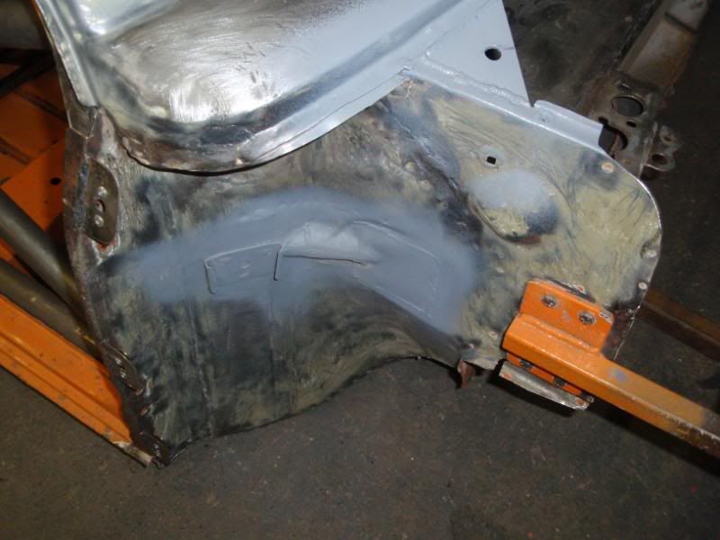

Made up the wheel arch brackets:

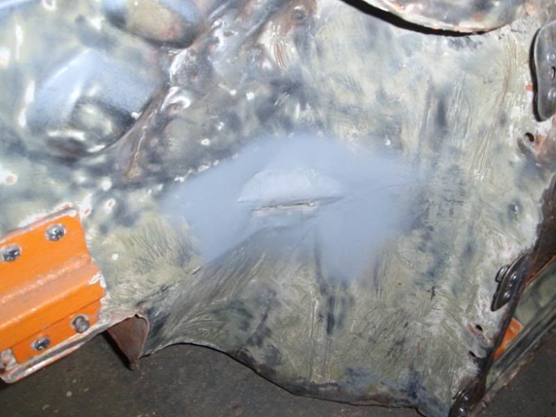

Welded up excess holes in scuttle:

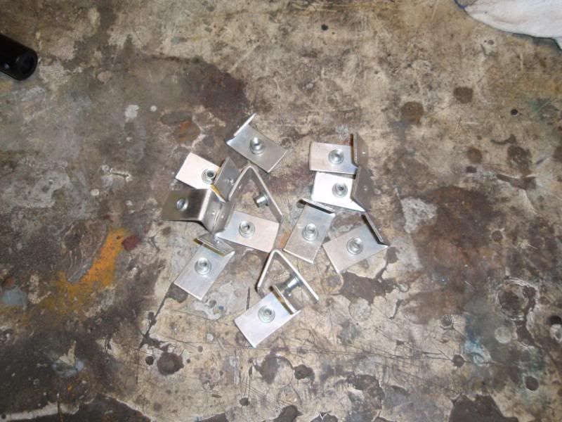

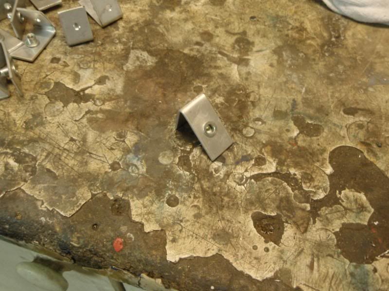

Welded on some triangles for bonnet/boot pins:

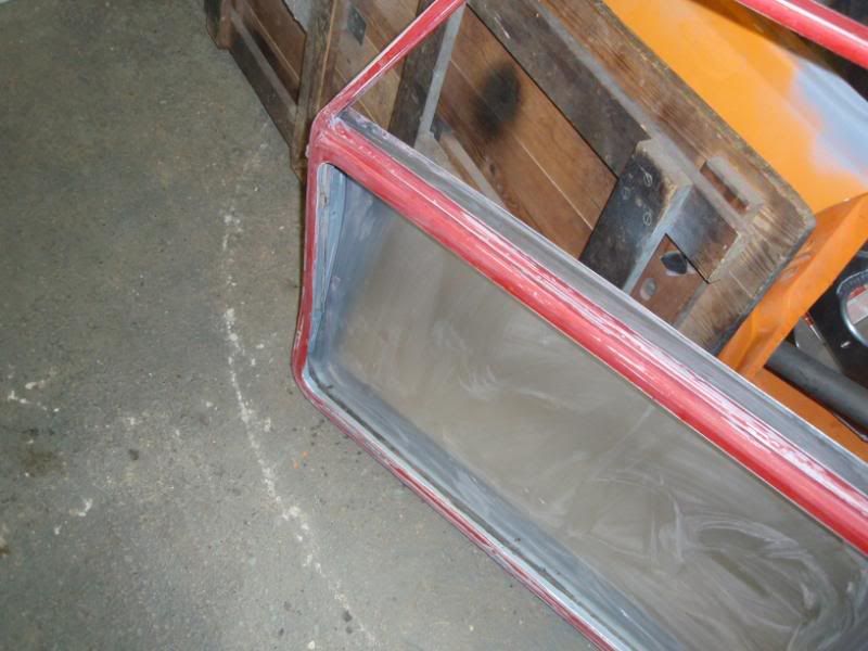

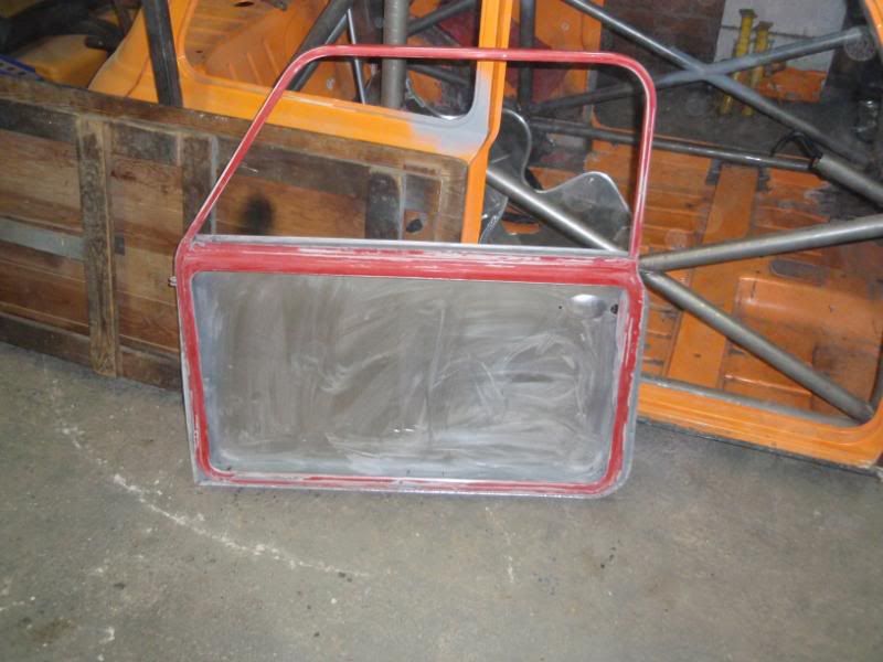

Saved a bit more weight off the doors:

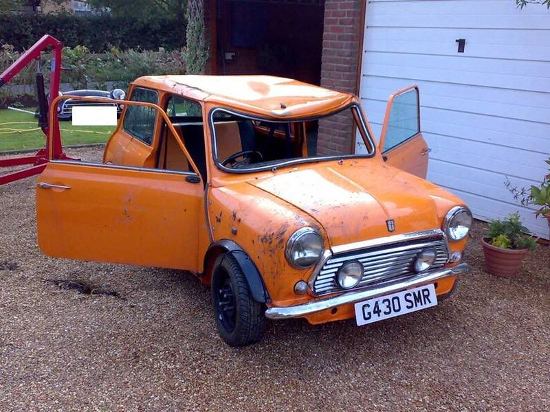

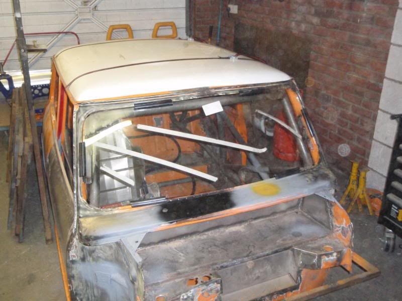

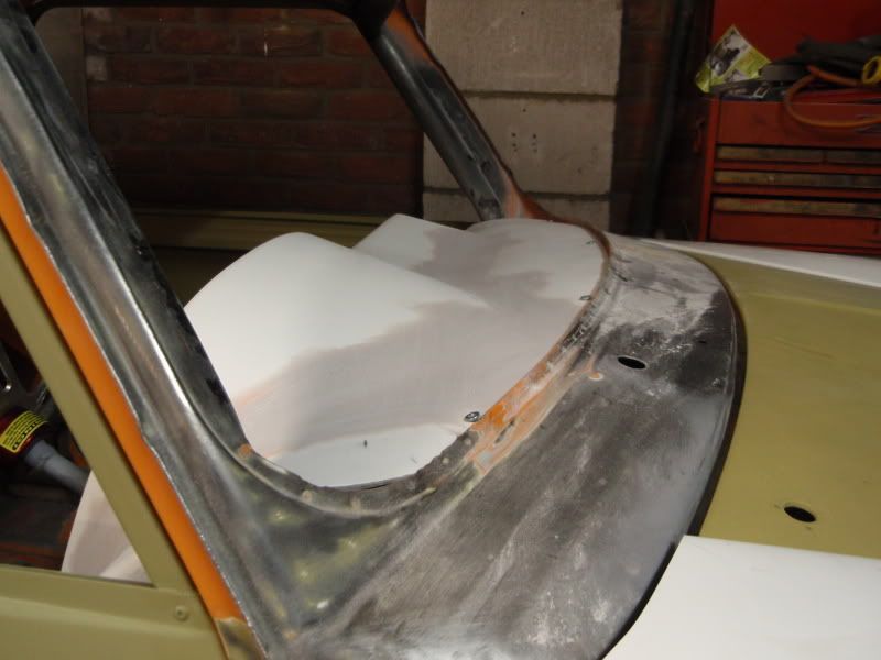

Due to the extent of the roof being caved in i had a hell of a time straightening it out, but it still wasn't 100% so i've been at it again to reshape it:
From this ...
To this ...
And now finaly a screen fits again ...

Well done, it looks like youve made a good job of the roof.

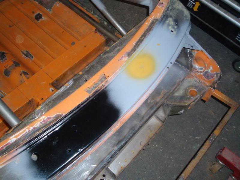

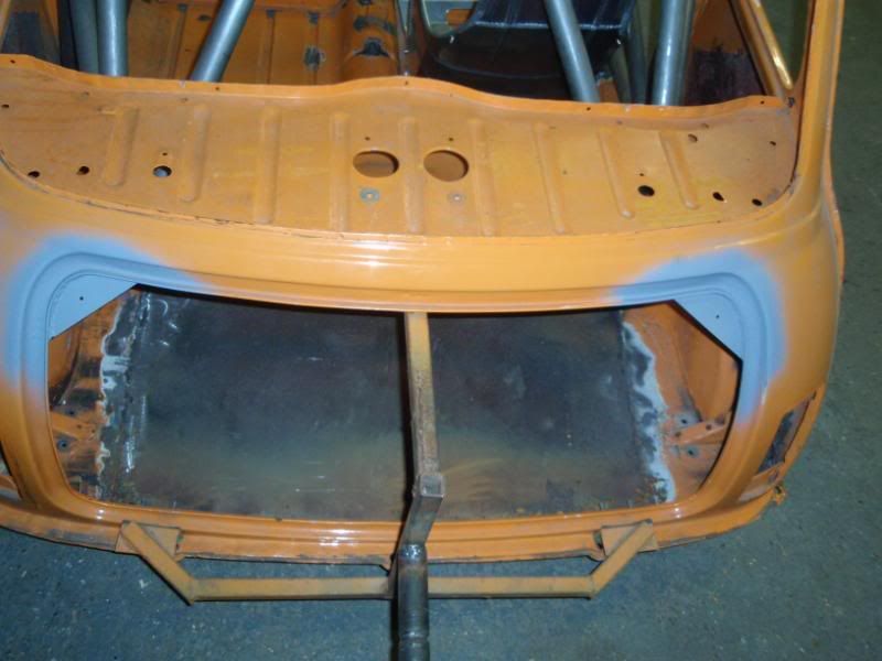

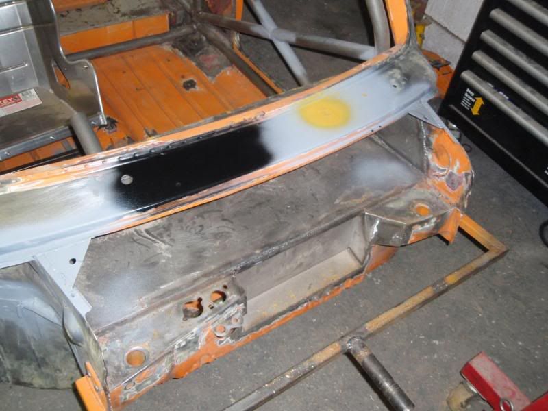

Finaly got the rear bulkhead welded up, never want that job again:

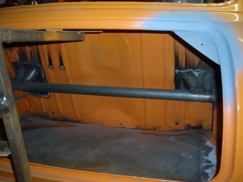

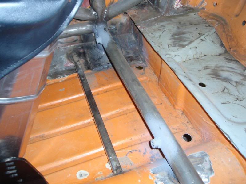

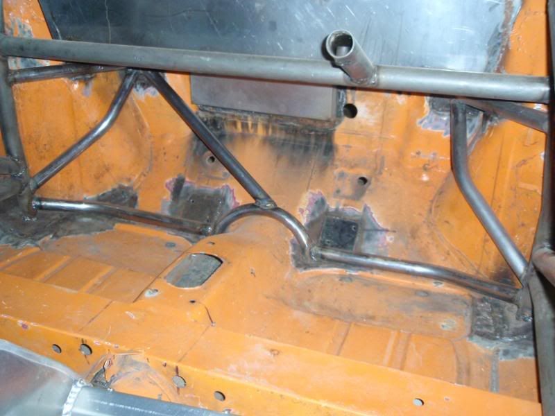

Got the harness mounts welded into the cage, shoulder belts in pic above and lower monts in pic below:

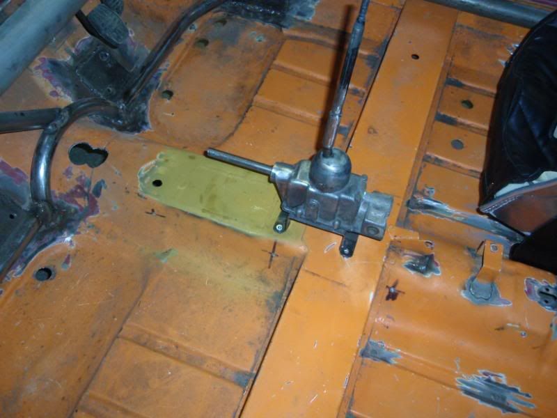

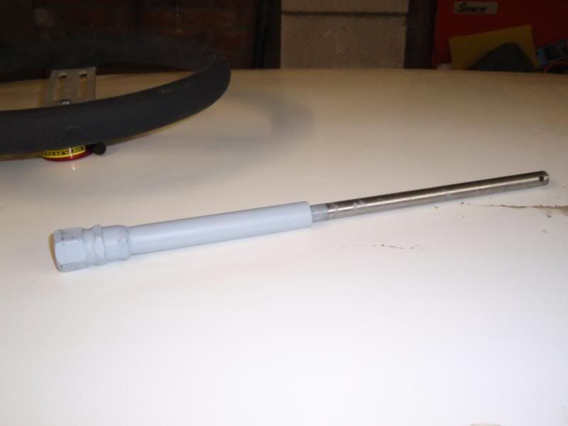

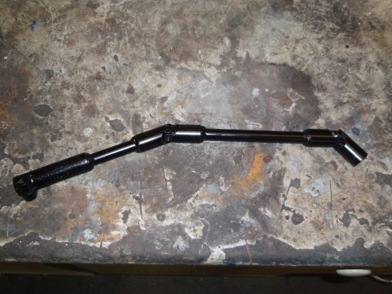

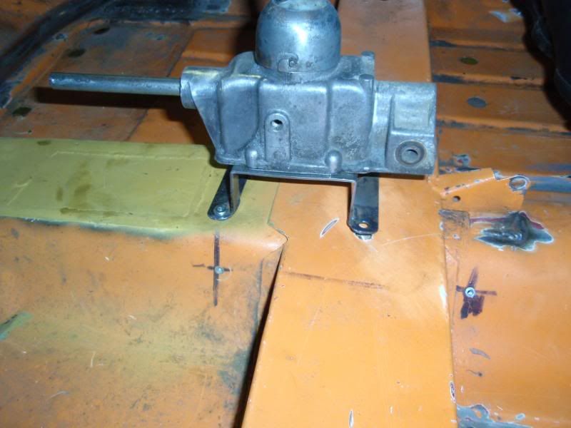

Made a start on the gear linkage, bracket made up to hold it to the shell and lever shortened. Just need to get another couple of universal joints:
Finally got the upper steering column machined and the steering wheel hub boss welded on:

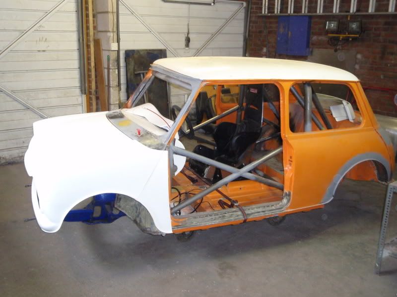

Bit of progress this weekend.
Got a bit of etch on the doors and some f/g bits:

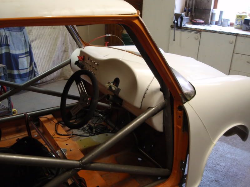

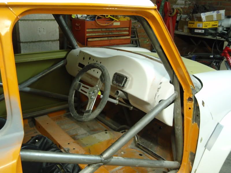

Got the dashboard glassed up smoothed ready to be flocked:

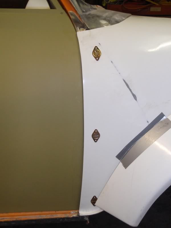

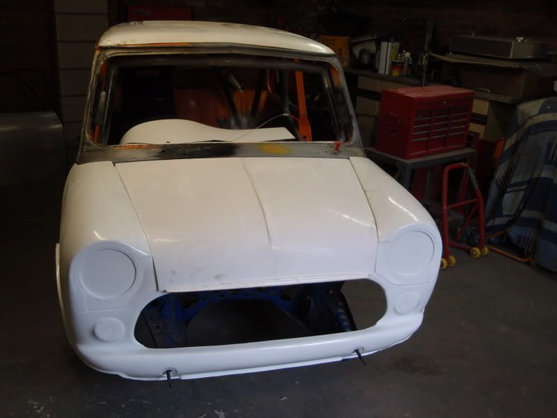

Front end drilled for fastening, and bonnet drilled for pins:

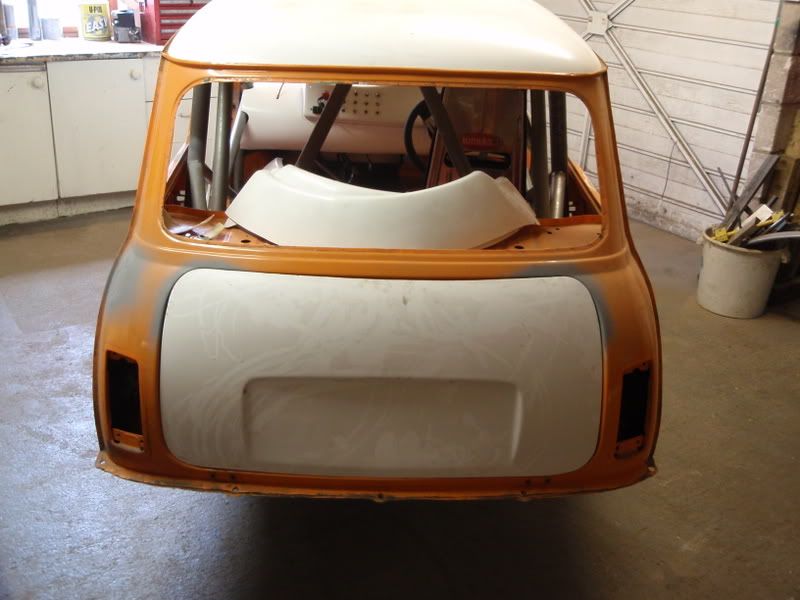

Boot trimmed to size and holes drilled for pins:

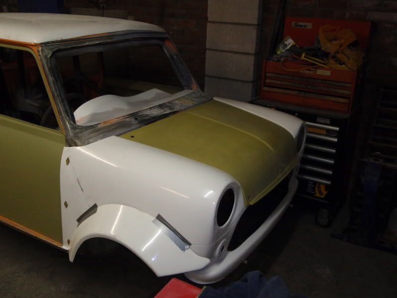

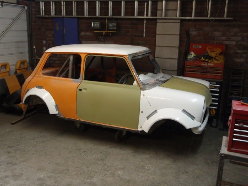

Another mock up to keep me motivated:

Thats the nicest internal gear linkage bracket Ive seen
