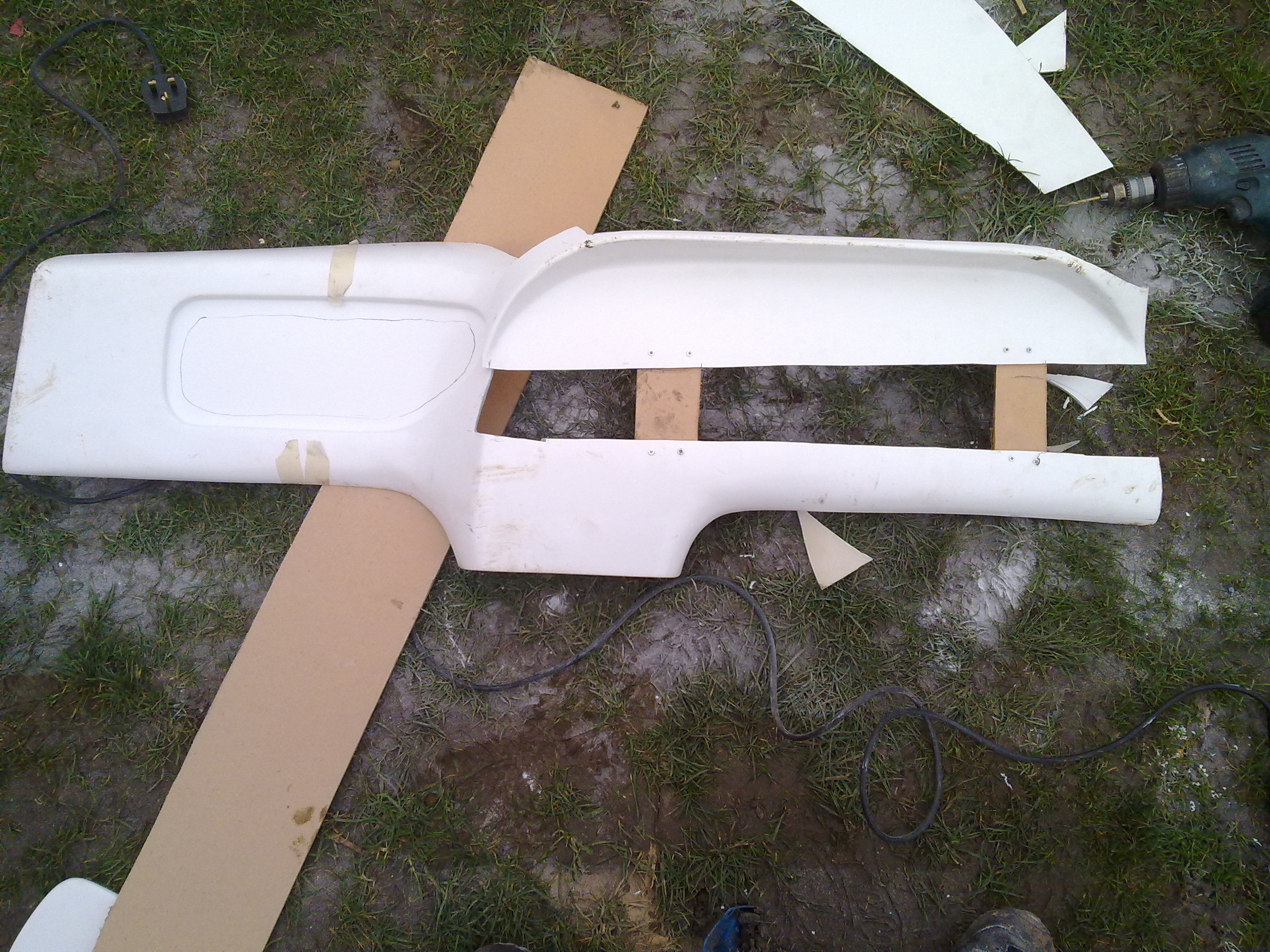

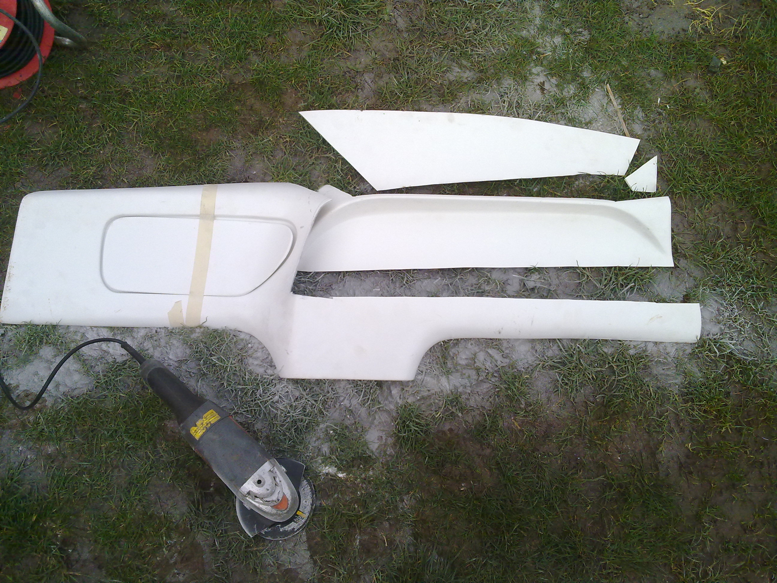

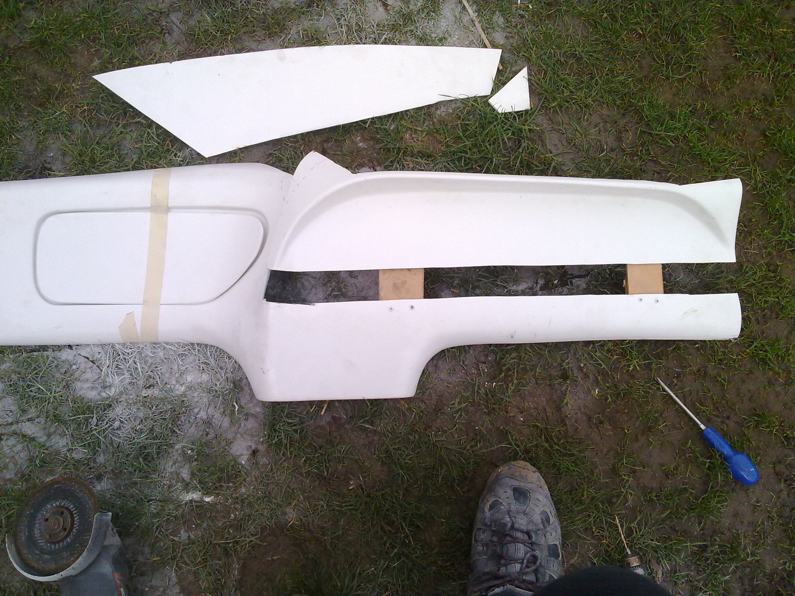

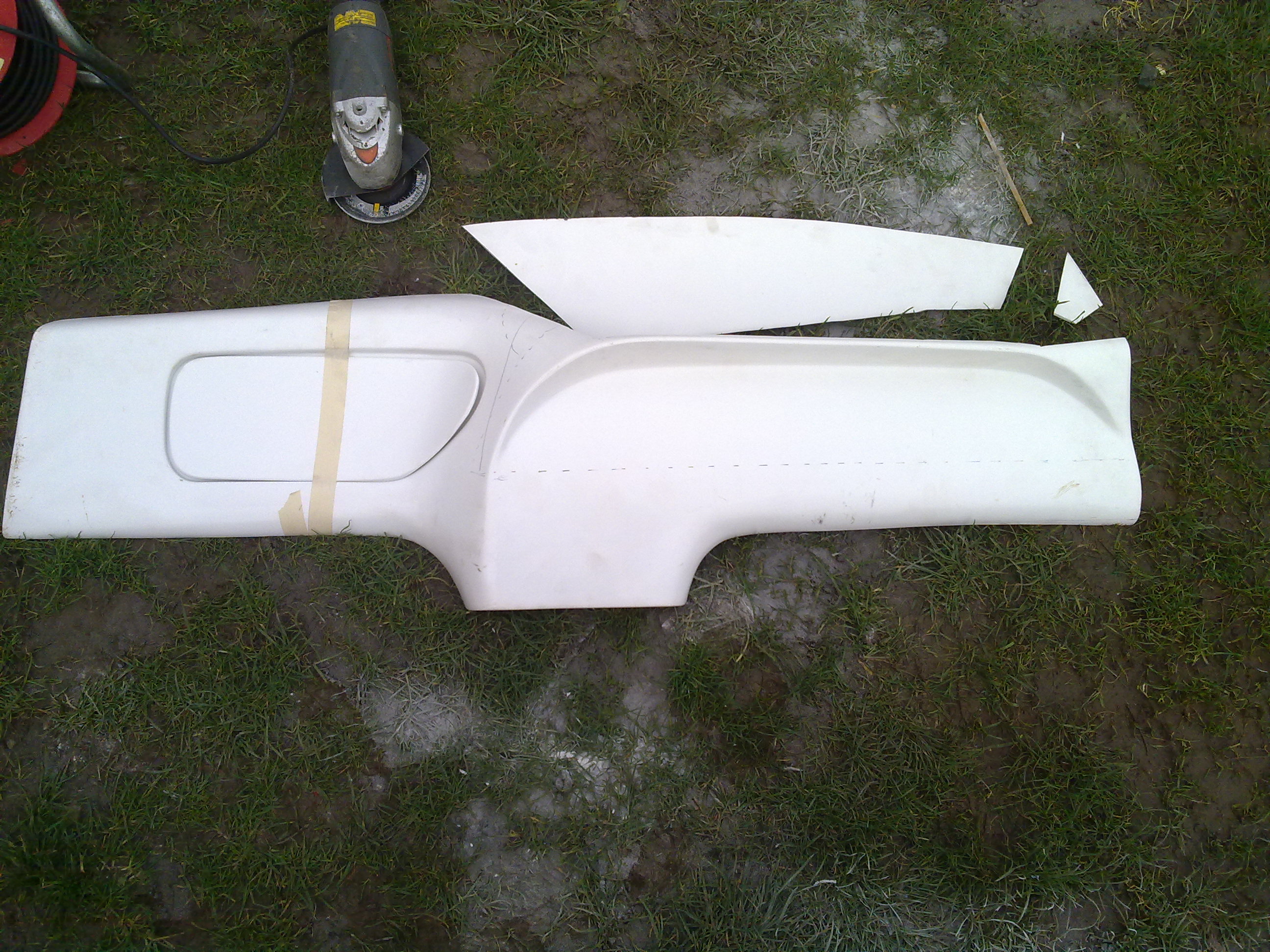

had ago at fitting the dash today, the initial lo it in i did last week wasnt too bad but as i started trimming it to get a better fit, it just highlighted all the imperfections in the dash (such as the top rail being 2 inches too low) and the flat spot for the gauges being directly behind the steering wheel where i cant see it*happy* so anyway here is what im on with

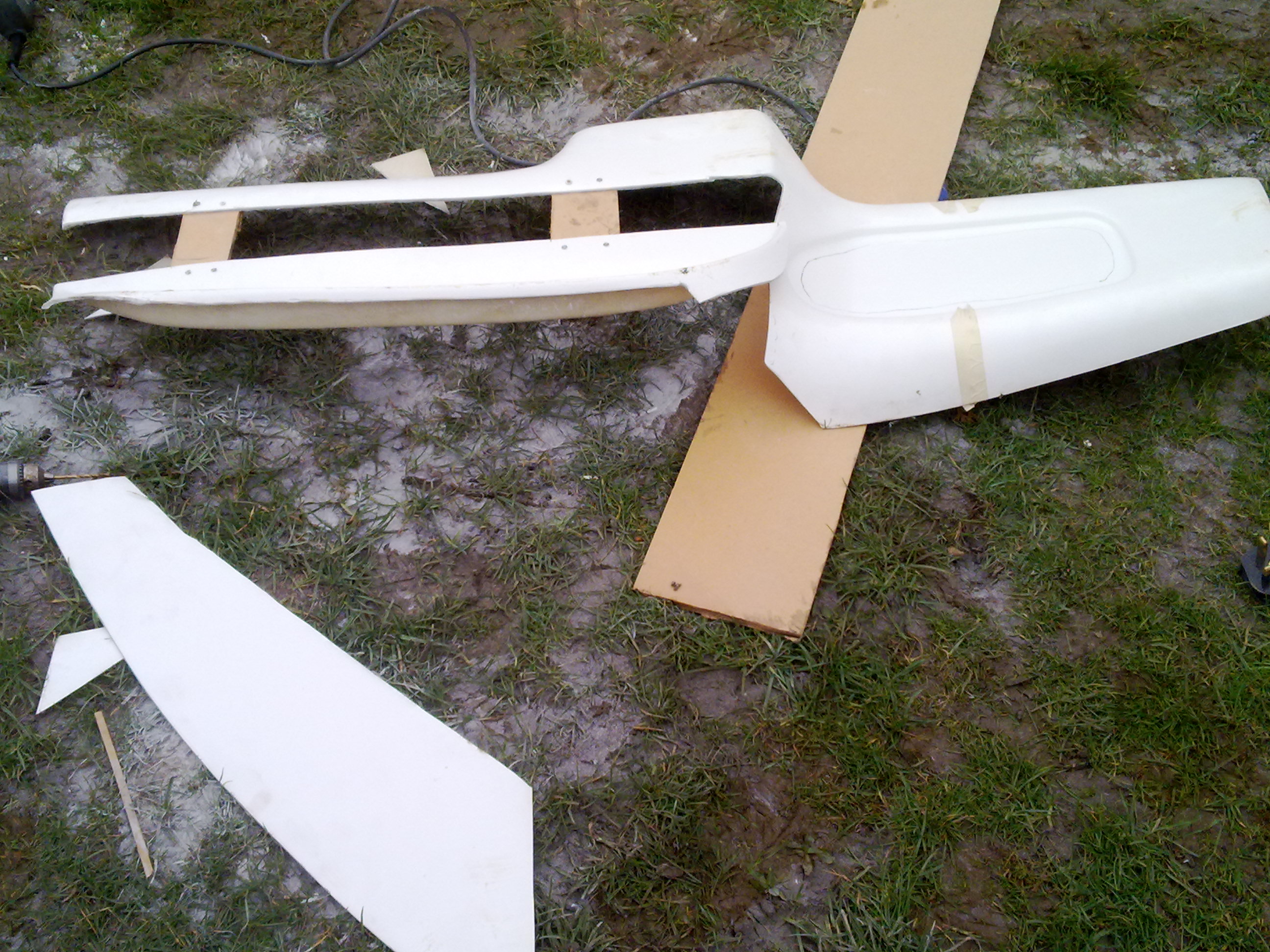

this is what i had to cut out to get the dash to fit
as you can see it bend compleetle the wrong way :(

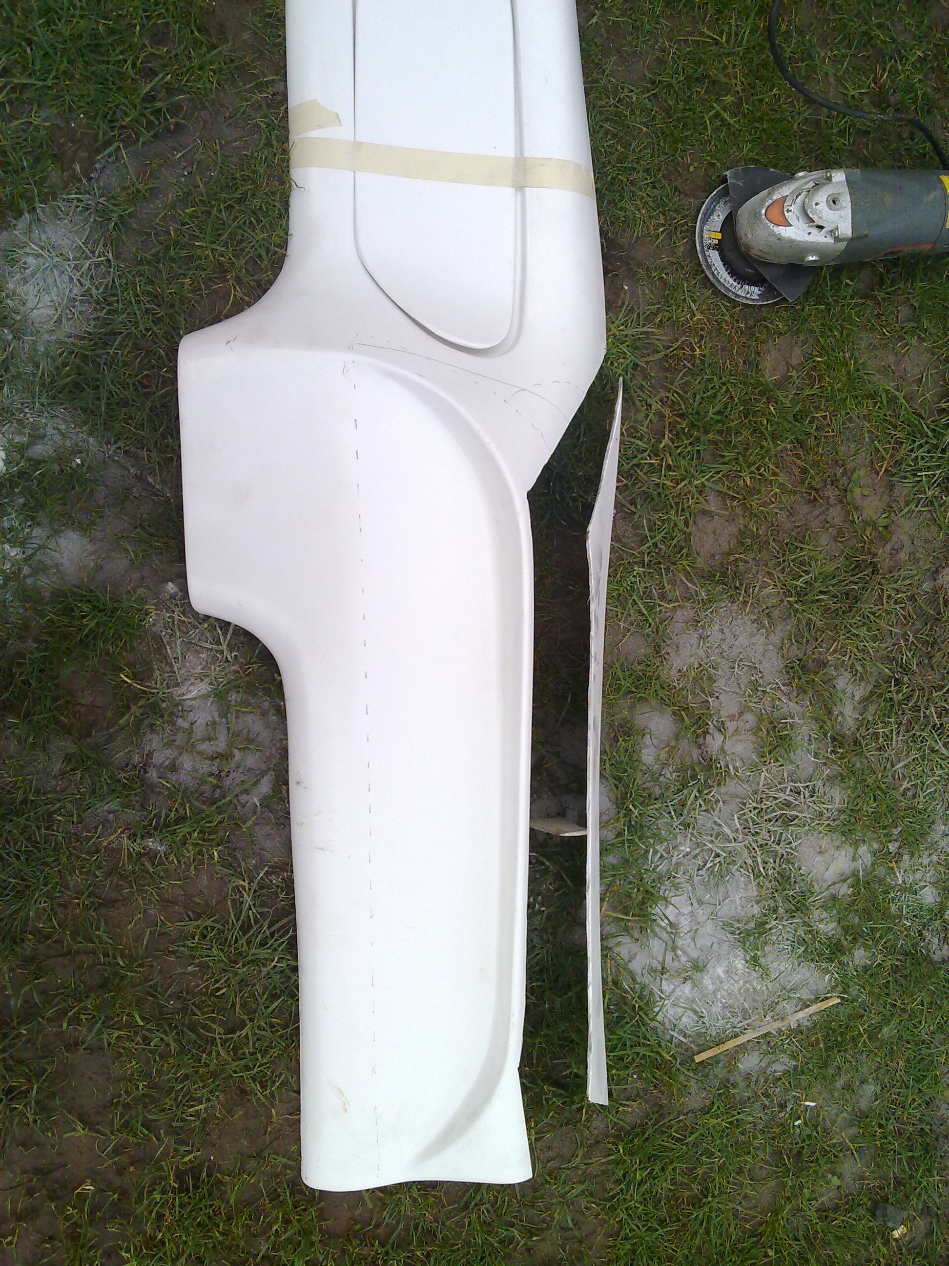

i decided it sat too low in the car so i also cut here
too move it up a little

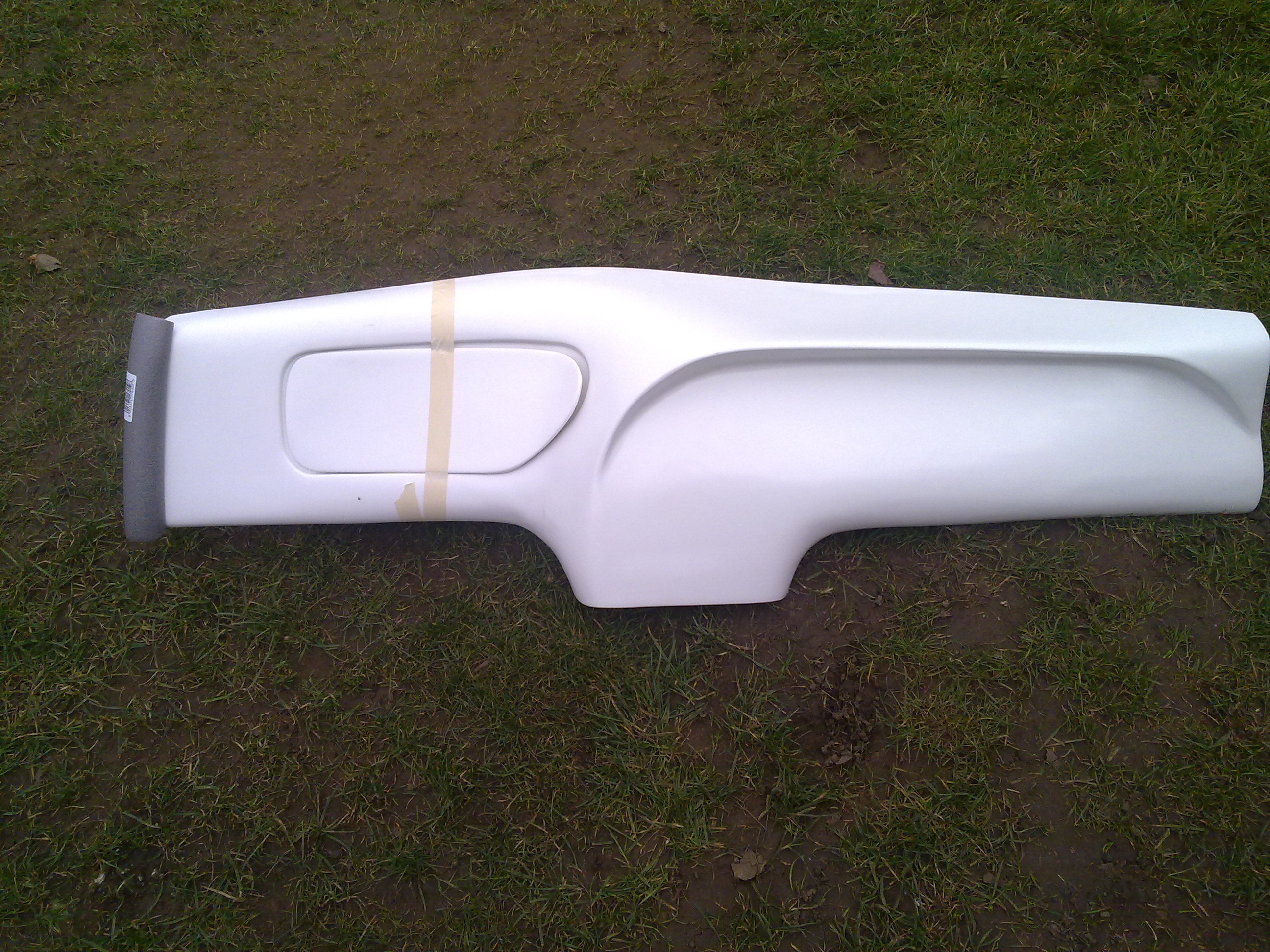

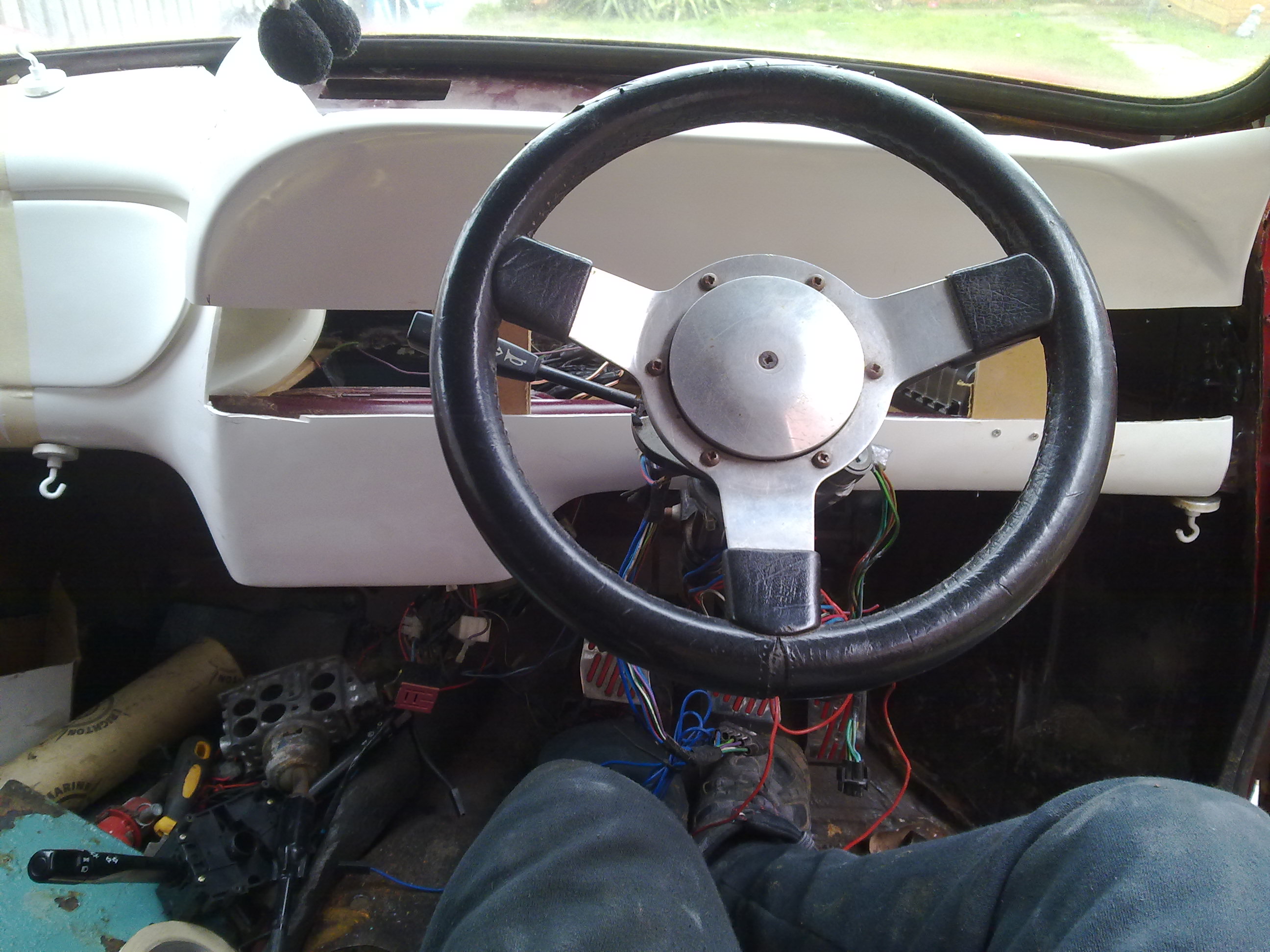

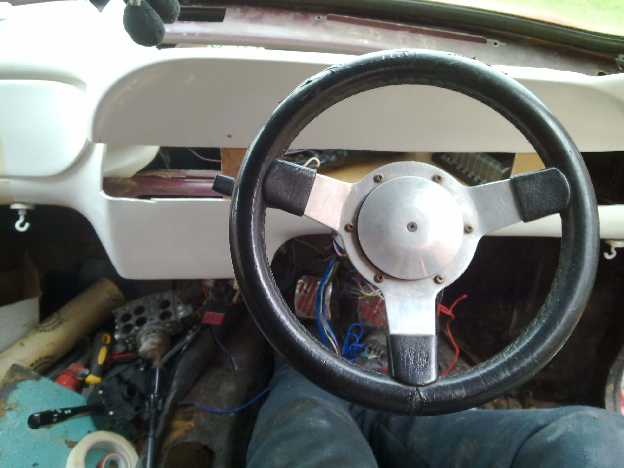

a test fit, much better,
a little un level so i moved the right hand side up an inch or so
Edited by Brett on 24th Mar, 2010.
excuse the crap in the car lol, going too fibreglass the front tomorrow and take more pics so you all can have a laugh at my lack of skills :)

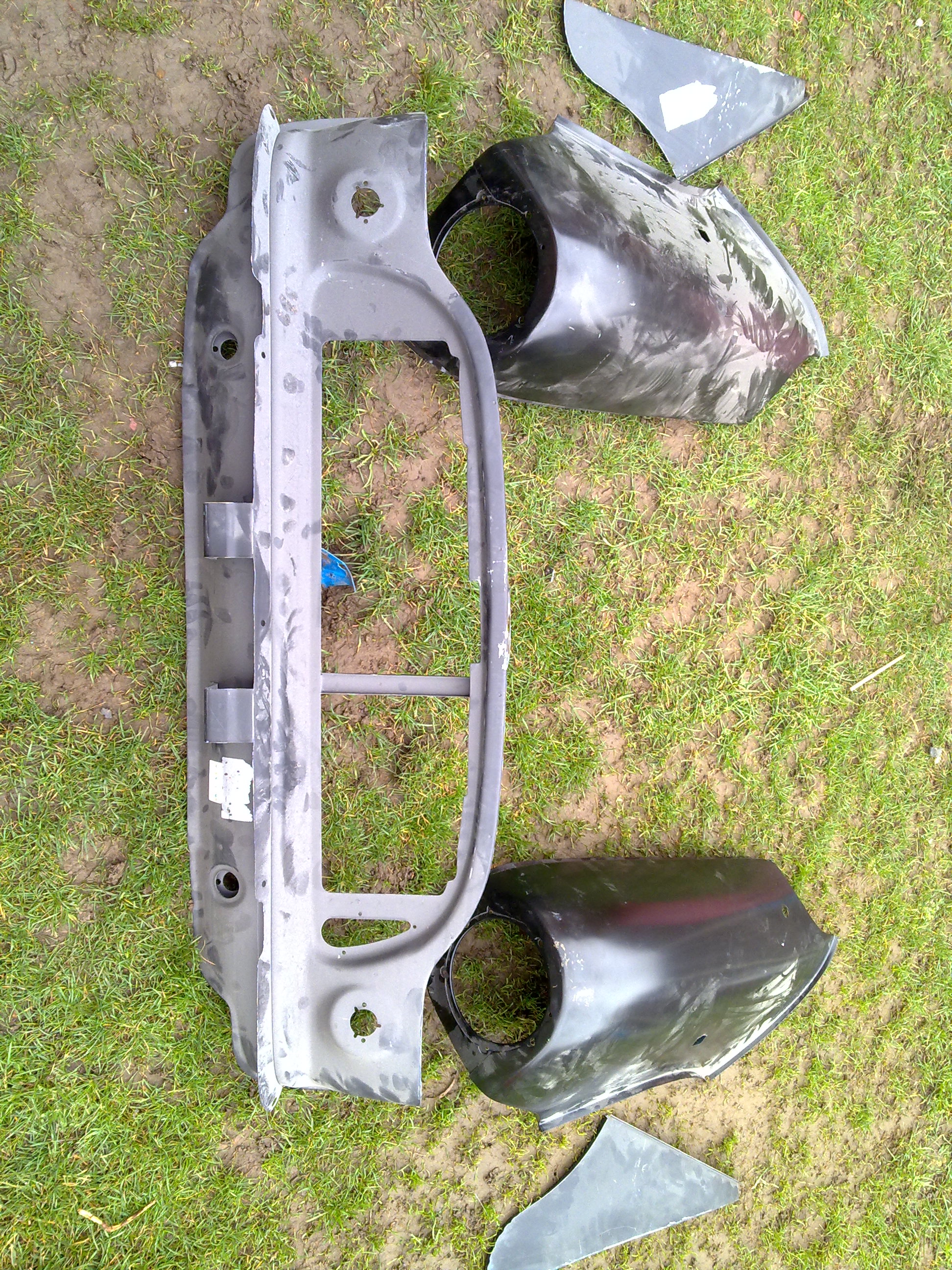

also picked up a front end yesterday on my rounds
wings spot on, a panels are just a panels, and the front aint bad, for 80quid not arguing and yes they are steel *wink*

I had to plonk my instrument up on top of the dash, the steering wheel, cut nicely across the 5-8k band of the rev guage when mounted in the dash
The megajolt in now mounted on the dash to occupy some space.

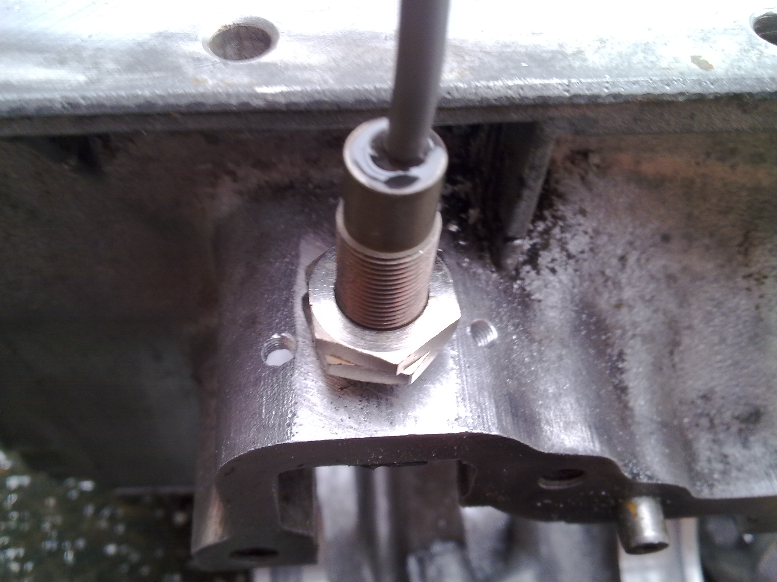

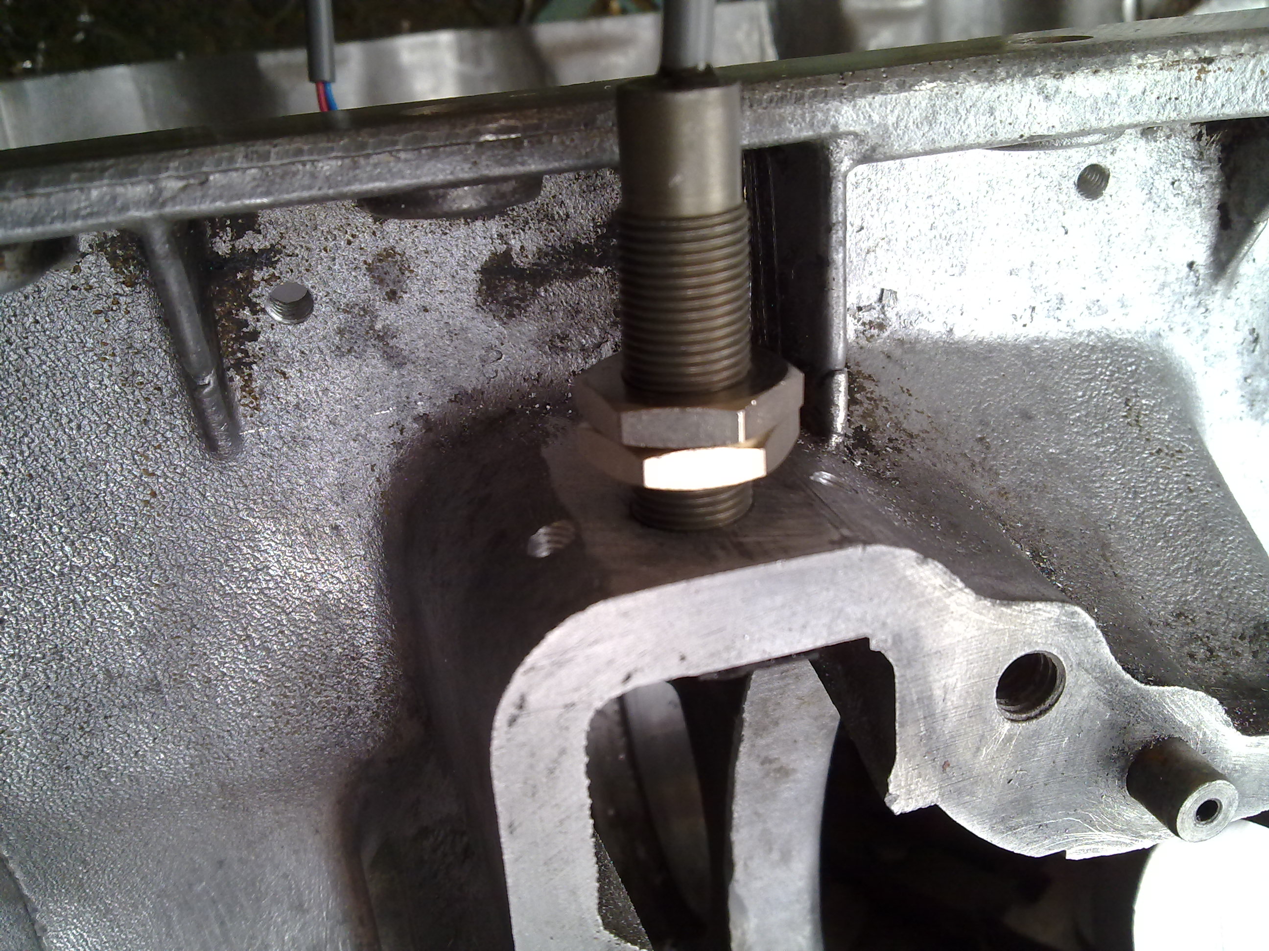

fitted the hall effect sensor or rather test fitted, im going to block this off initial but drilled and tapped it now ready

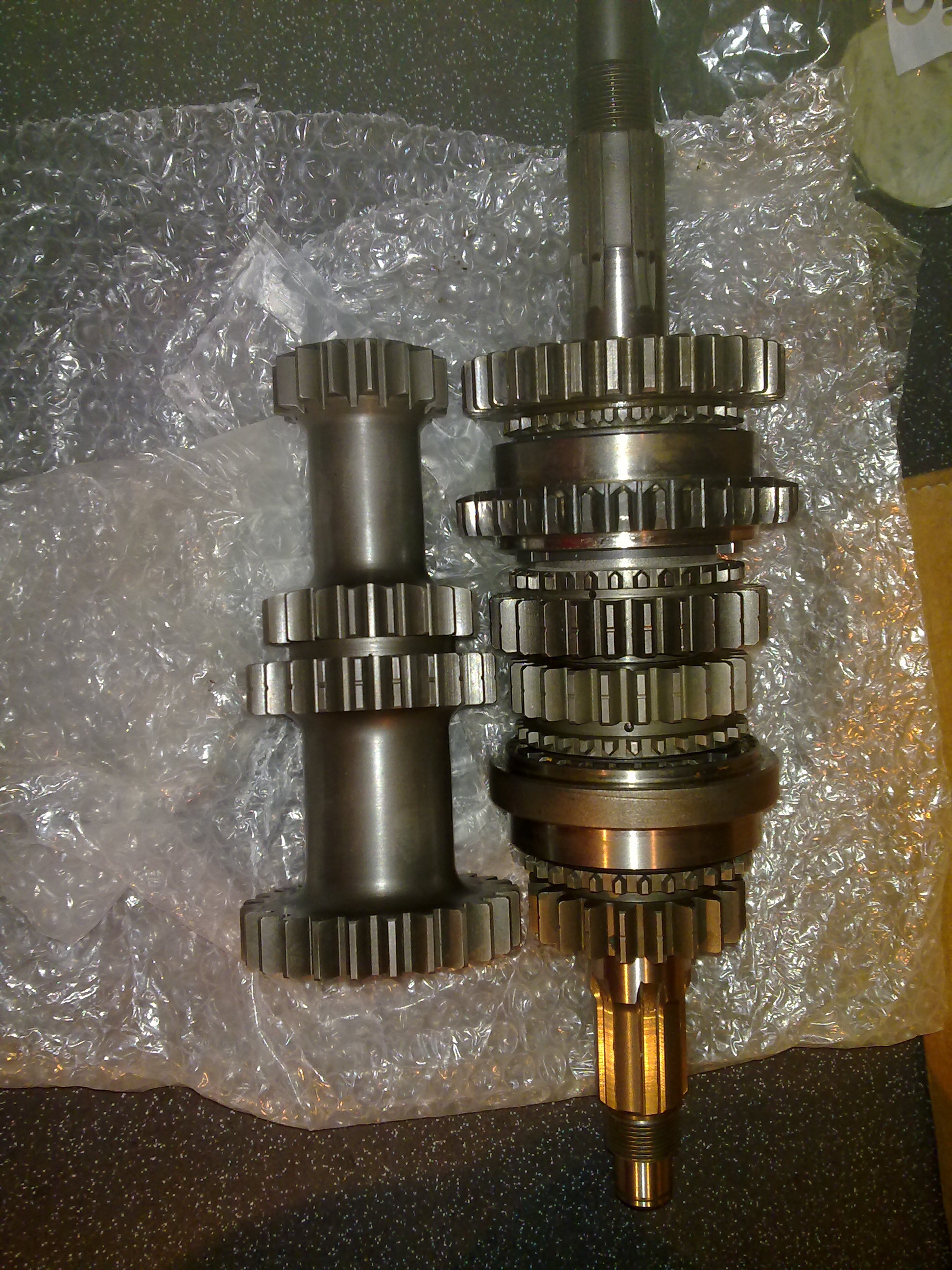

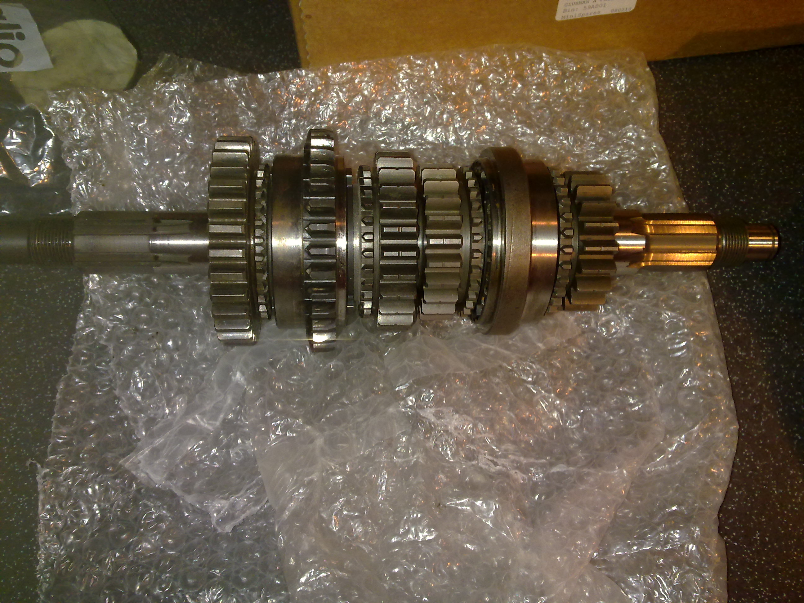

and built the gear bit thing *happy*
from memory i think the gears are built up in order, we will see *happy*

whats the sensor for? speedo pick up or summit? how do those ones work, do you still need a magnet of some sort or can they count the teeth etc?
a couple of days and the dash shall be pictured *hehe!*
the sensor is for traction control and launch control, this one is hall effect and can count the gear teeth in theory,
there is a thread in the efi section i believe Rod has tested his circuits also, i havent yet as i have no mega-squirt
will it work with helical gears too? are are you going sc?
looks a trick bit of kit, so hows this traction control work, it can tell how fast your going from a rear wheel, and limits the engine rpm, and thus the CW until they sync again?
im going to go to sleep thinking about this now, how sad.
sorry joey didnt mean to ignore you basically thats how it works, ill figure it out more when i finally buy my megasquirt*happy*

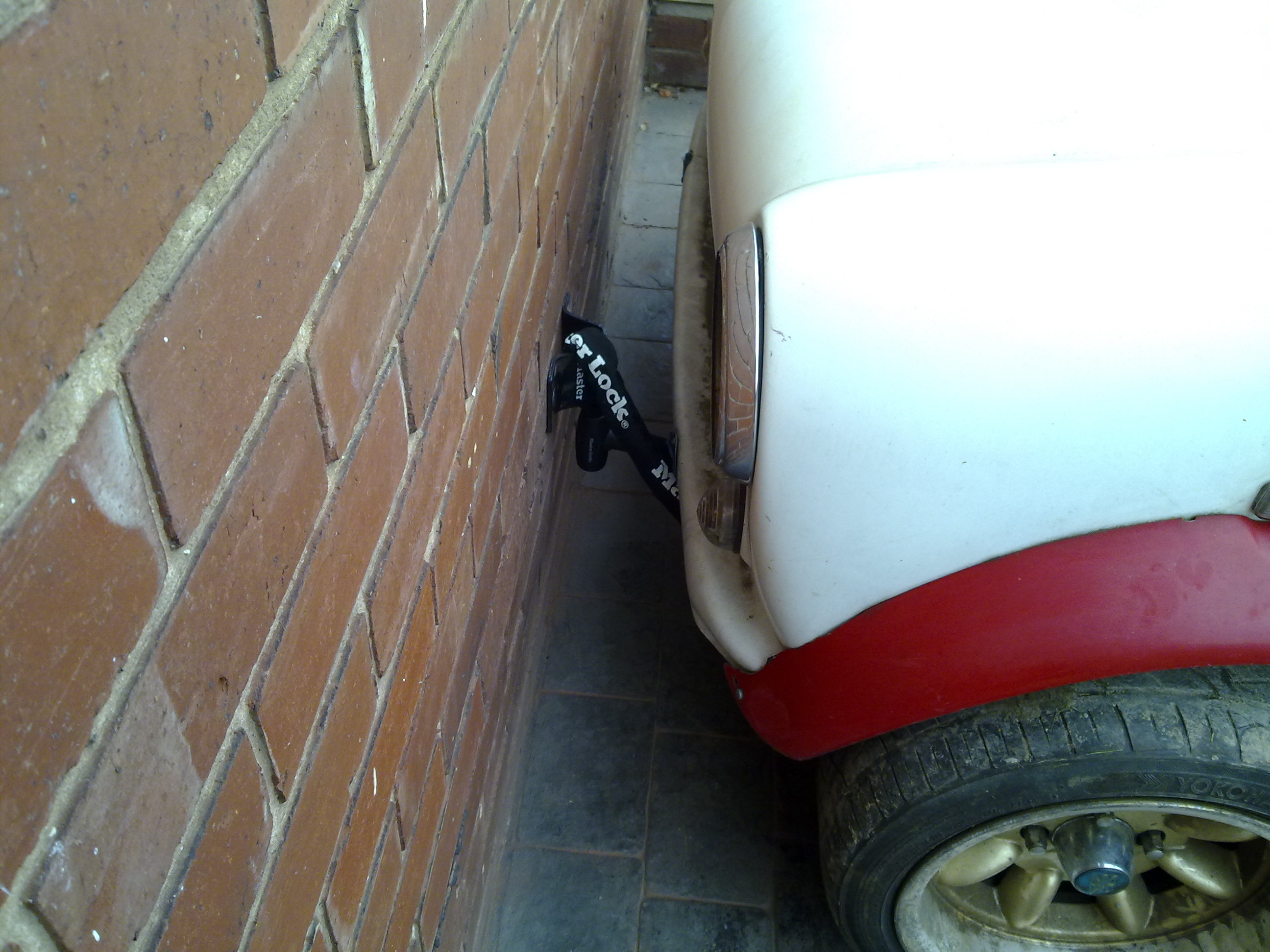

How have you anchored that bracket to the house? Is it worth putting some weld onto the fasteners?
it came as a kit for motorbikes, there are ball bearings belted into the counter sunk hex bolts, there not coming out without the bricks attached *happy*

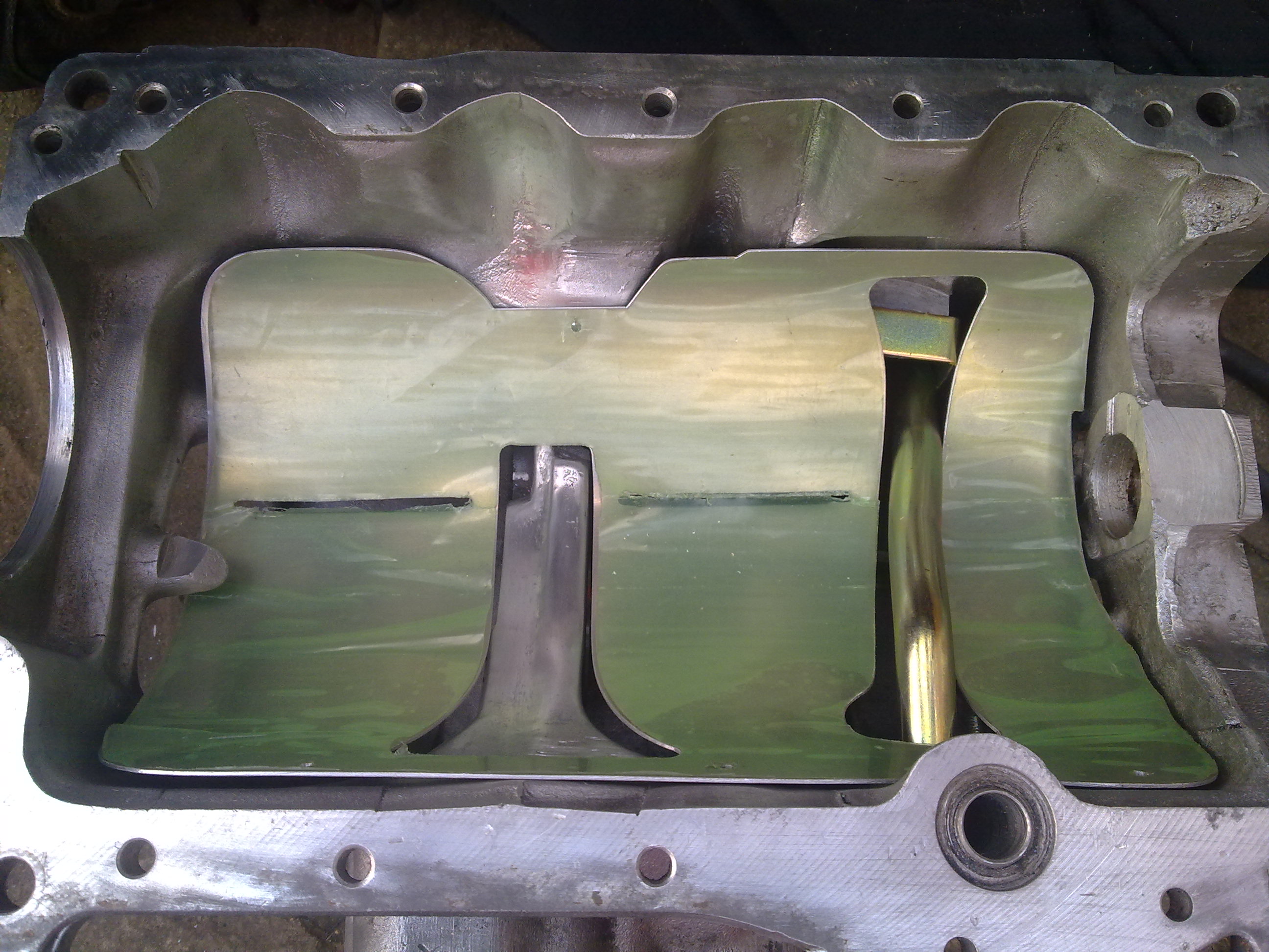

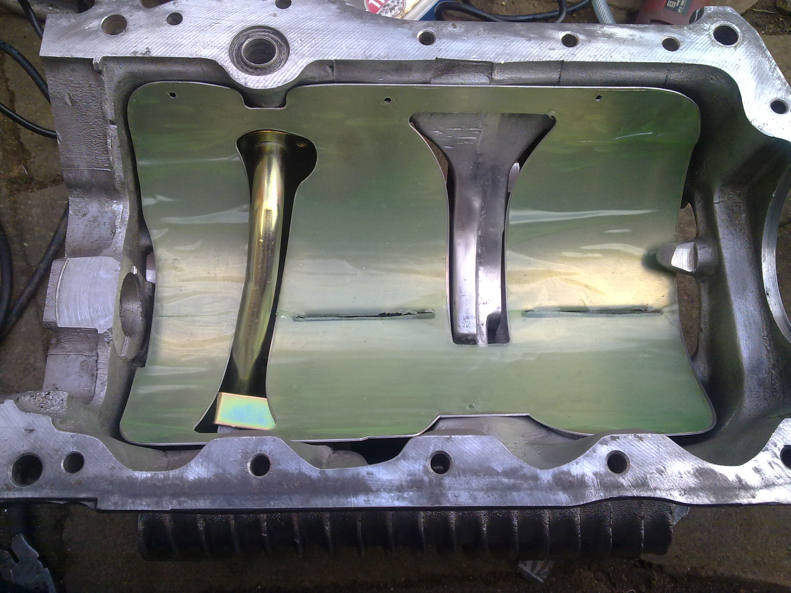

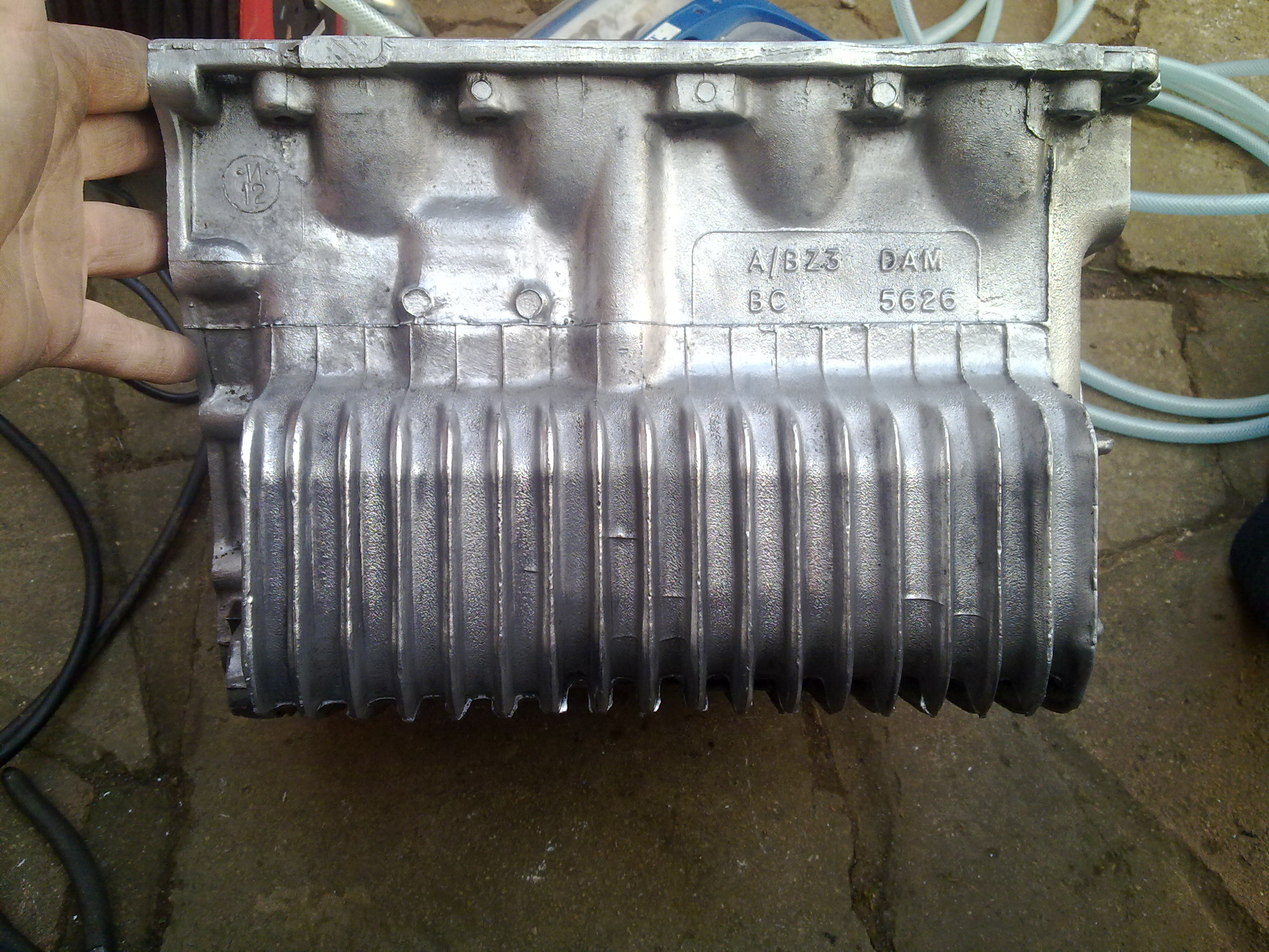

for got to mention, the gearbox is now built torqued and loctited i had to trim the baffle plate, then re bend it as it hit the gears, then re trim it it now looks quite untidy, next time i will fit the gears first*oh well* hope to god it doesnt get clipped by the rods now :(

Looking good Brett, are you going to run under crown oil cooling? i had a baffle fitted then decided no to run it as i thought all the splashing oil will benefit cooling more than reducing lag.
dash will be worth the hassle i hate not being able to see my dials!
i was fully set out for undercrown cooling but im going to pass this time round, its not a big job imo at a later stage during a strip down or so,
