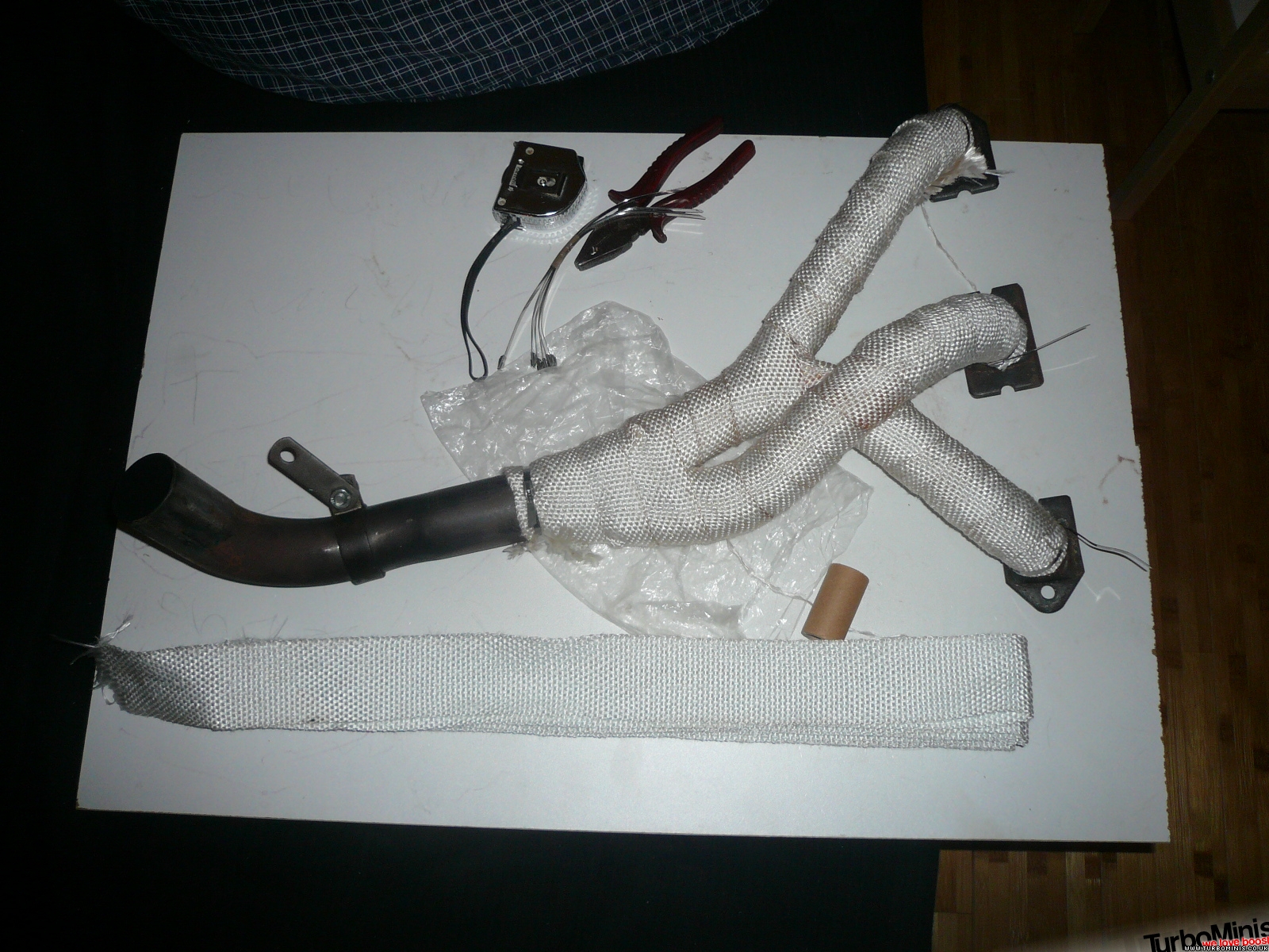

Did not bother fitting the X-Pin diff for this engine.
I found out my inlet wich was standart iron cut off, spaced and angled was cracked !
Actually weak to the point I can pop it in or out with my thumb ...
Better find out early anyway ...
What is more, it didn't fit my bare freeflow wich I insulated as seen right here :
I used about 4 meters of insulating wrap to do that.
And it just about stopped itching ...

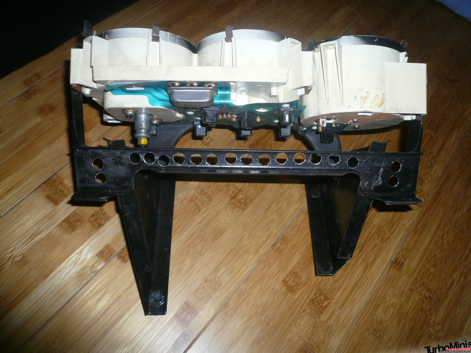

Stuff happened on the car, mostly setting up but one tiny pic to show :
from two clocks dial to 3 clocks dial with a little bit of lightening on the way.
I was happy until I found out the rpm clock is not working properly (probably due to 5 years storage ...).

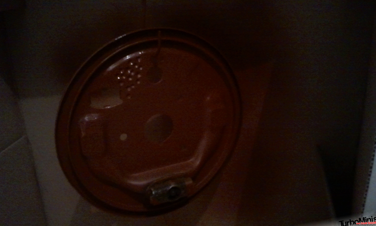

I have been working on the car on and off for a few months and found out at some point the rear brake cylinder on the LHS was shot.
It had put a lot of corrosion on the plate too so I cleaned it and got some weight off it too.
I only drilled holes in a place I thought was not to see any load.
I also cleaned upt the other side but it must look standard for MOT guys.
I would have liked to put it in a lathe to have the sides slimmed down too but that has not been possible in the time frame and for a price.
Below is a pic of my paint cabin and the other side :
It has not been wheighed, I assume the gain is low (cut off the bolts too) but it is basically free.
