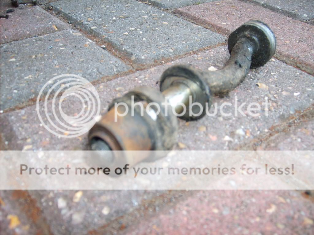

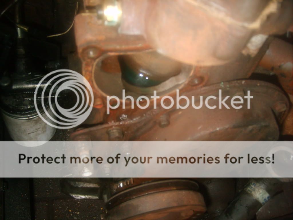

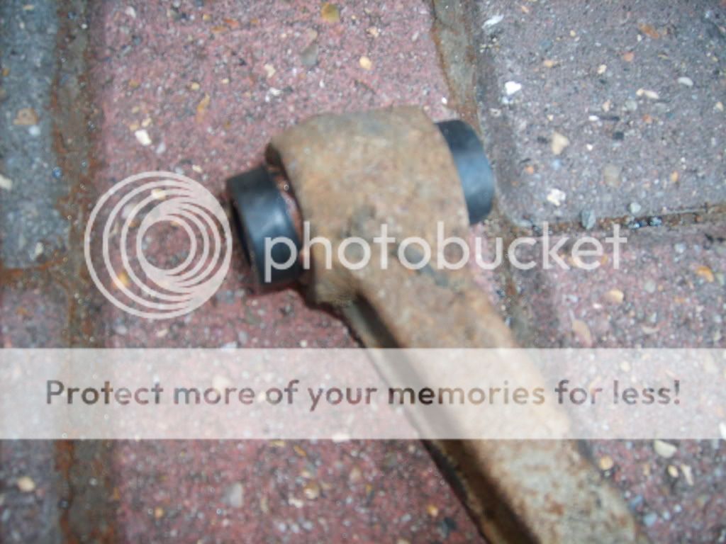

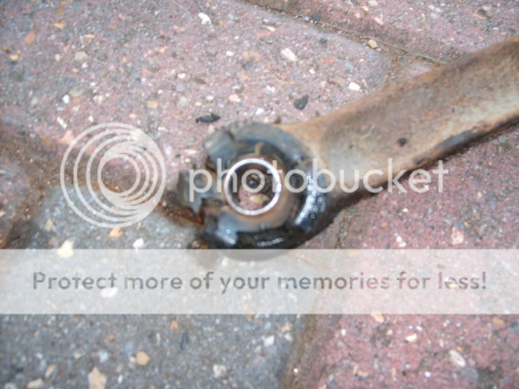

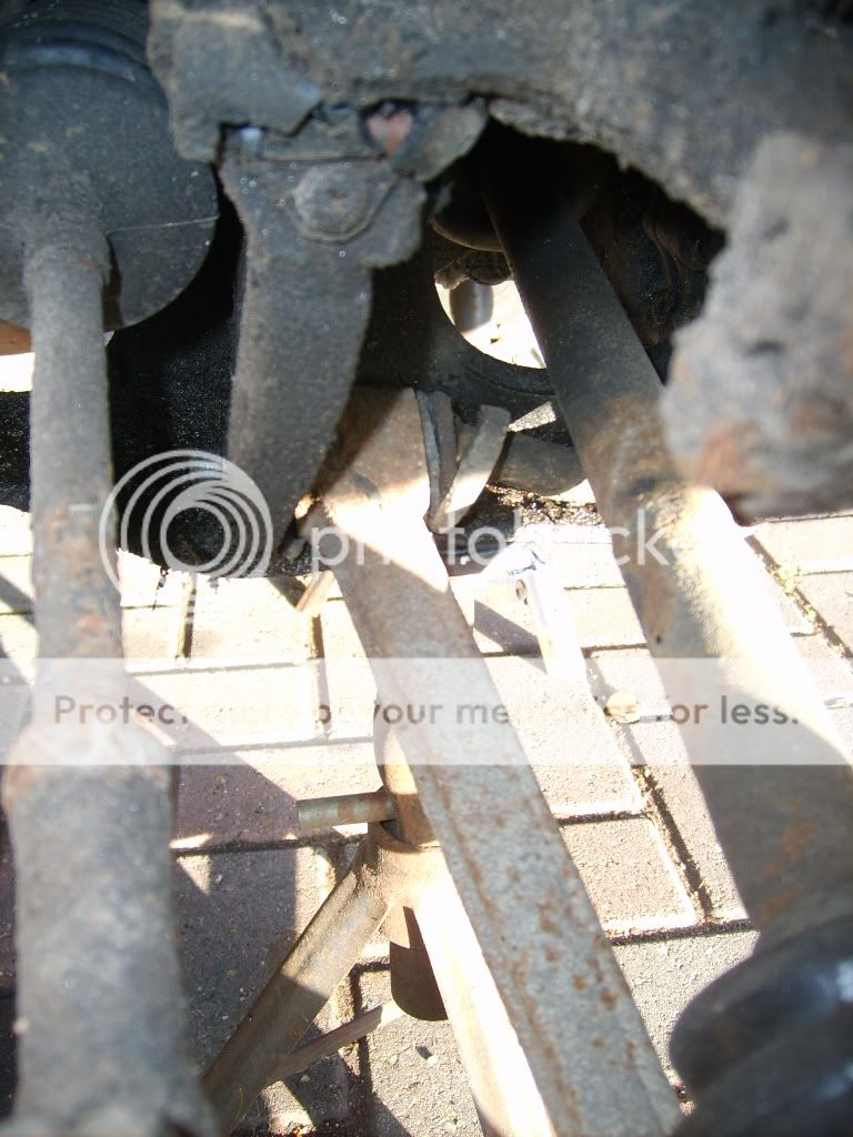

Well a little time was taken off, from welding and cutting, and the bottom arm bushes were replaced.
As you can see, they were a mess. Both sides were done.

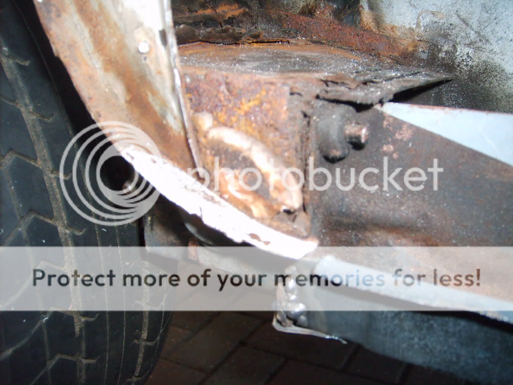

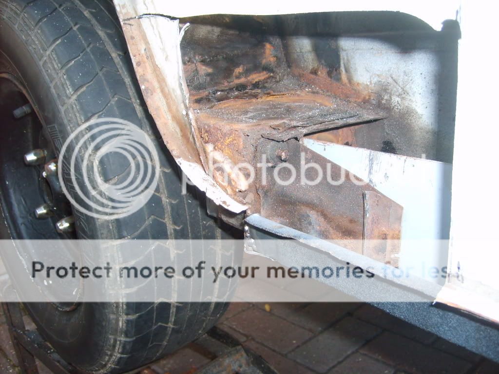

Then back to the cutting and welding.
All that mess was cleaned up.

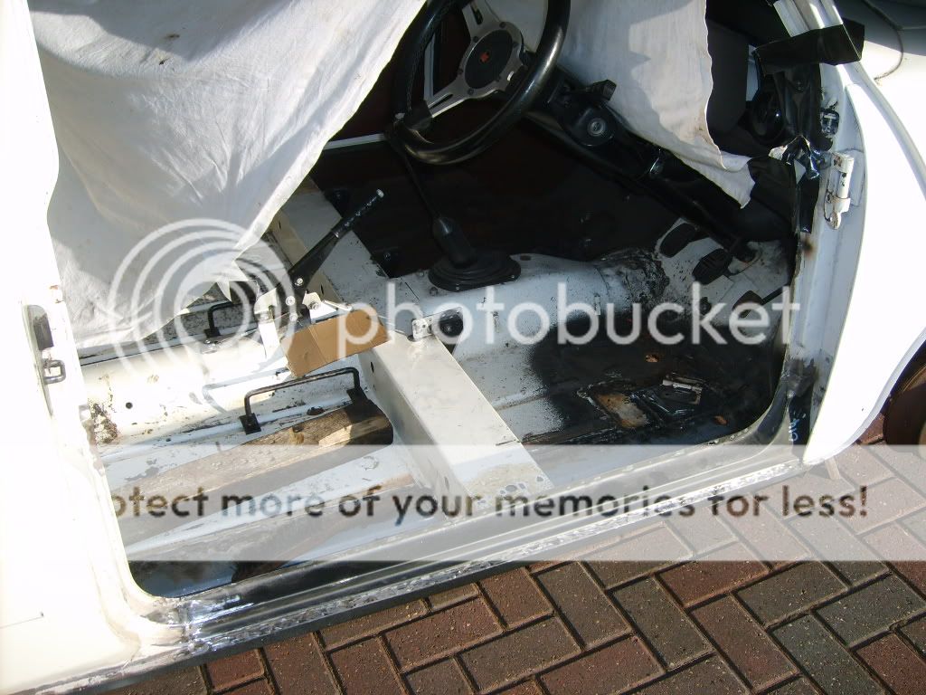

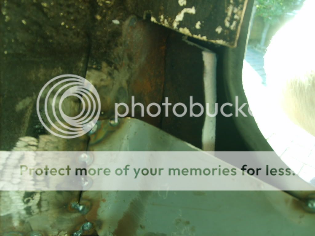

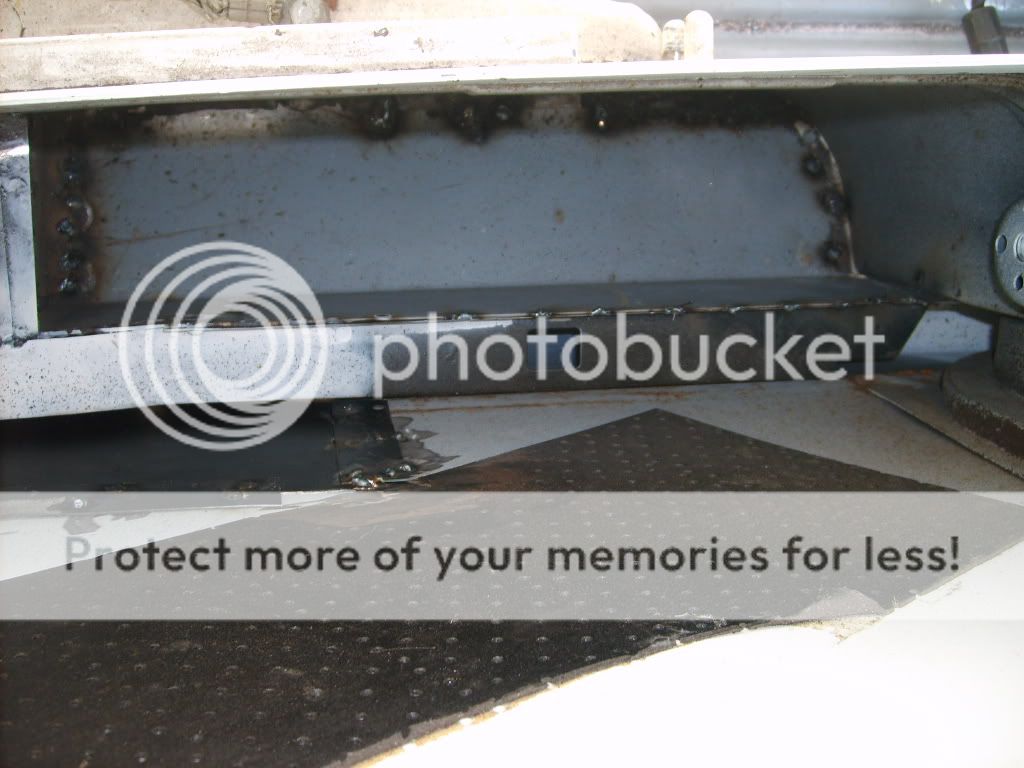

The strengthener was welded in, and the pocket welded to the floor.
An extra plate was welded over the rear of the sill.
brace bar was removed.
Rear lower quater plate tack in.
But had a little trouble with the welder. So stopped for today, before i had a hissy fit lol.

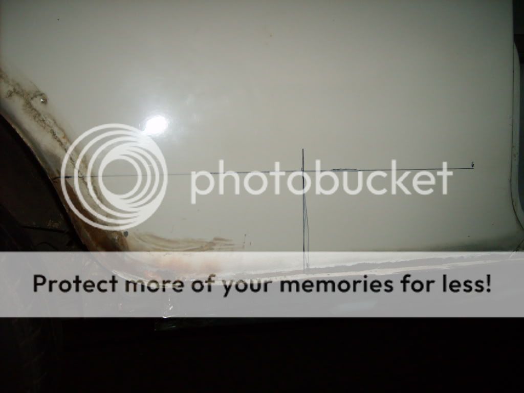

Oh, and a plate was made and welded back in place to fill this area. (All surface rust removed)

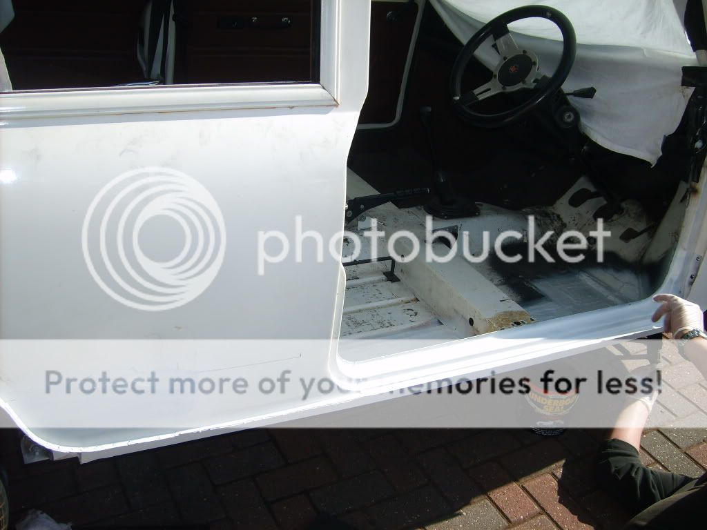

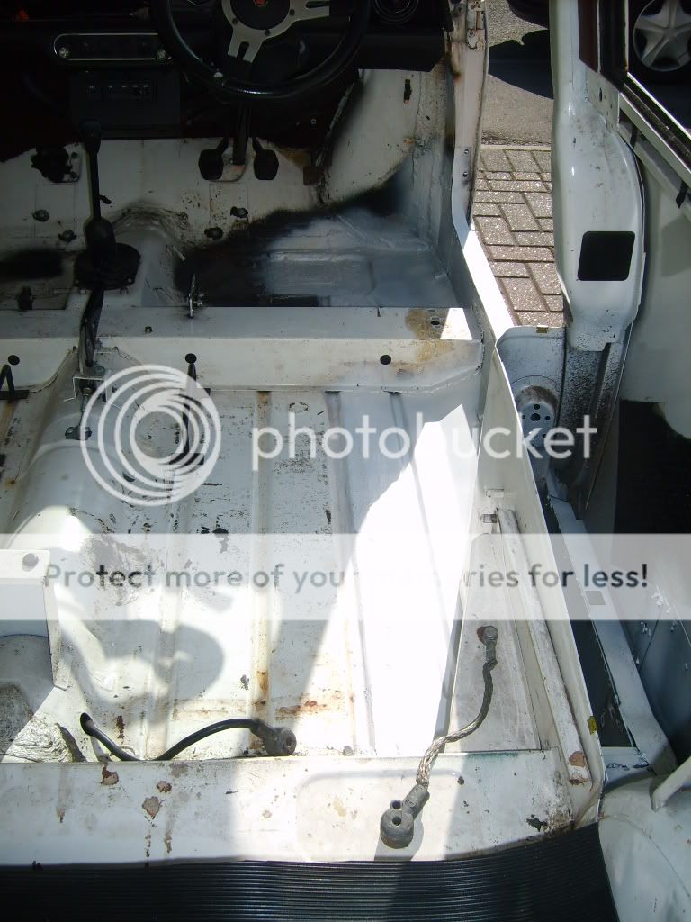

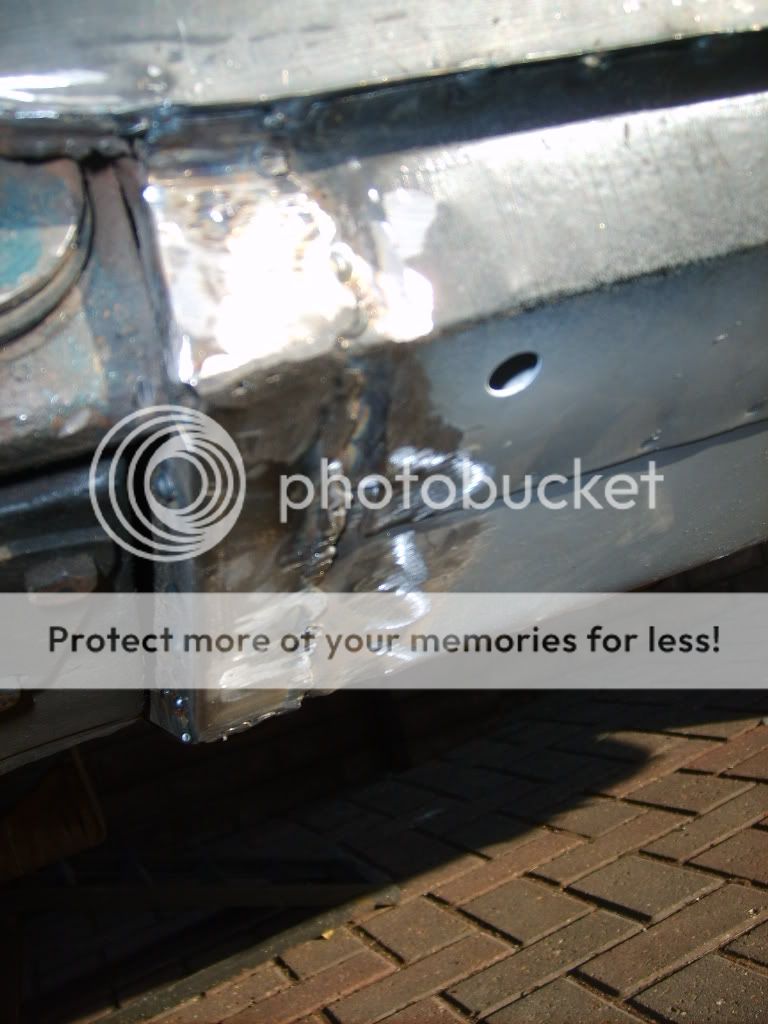

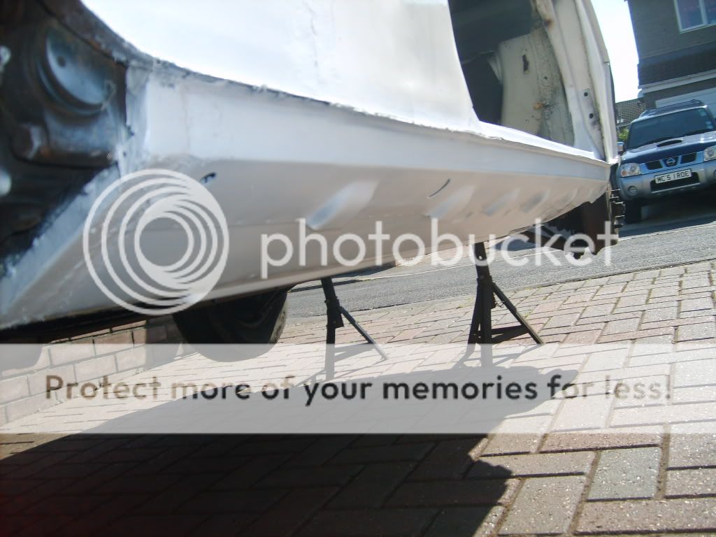

Well its all finished. The inside and outside have just been seem sealed. Once thats dry, i'll paint it.
The doorsteep and rear lower quater have just had their welds ground down, and primered over the top, as i cant filler to save my life.
Oh and the rear quater warped whilst putting in that panel....joyus.
Got to sort out the blowing exhaust manifold, and the handbrake, fit the interior back in. Then its read for an mot....
After I'll have to save up for a body shop, to filler, and paint the estate for me..... unless anyone here wants to do it? *happy*

Some snaps for everyone.

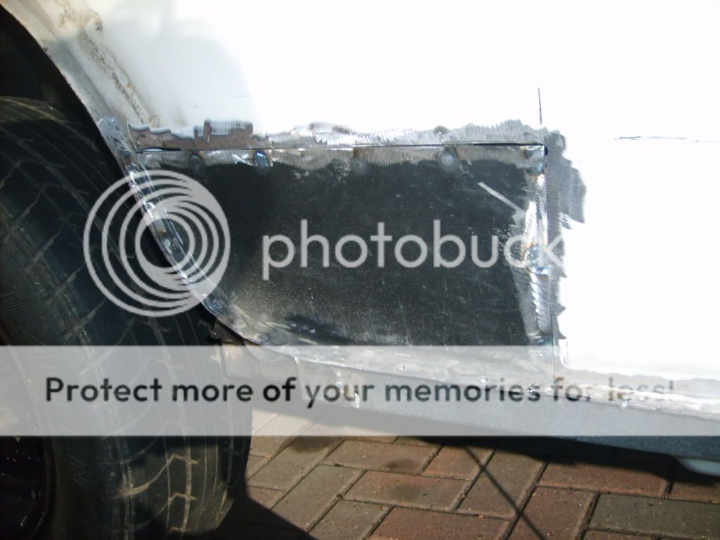

Had to pop out early this morning for supplies.

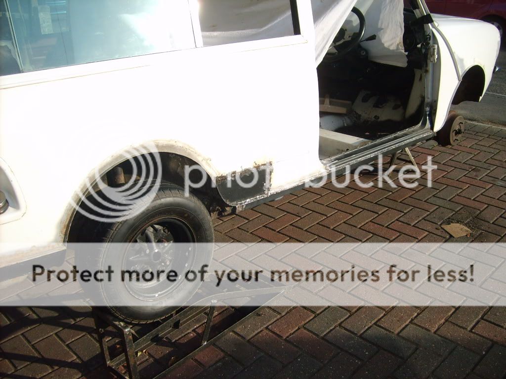

Lower quater repair welded in, ground back and primered.

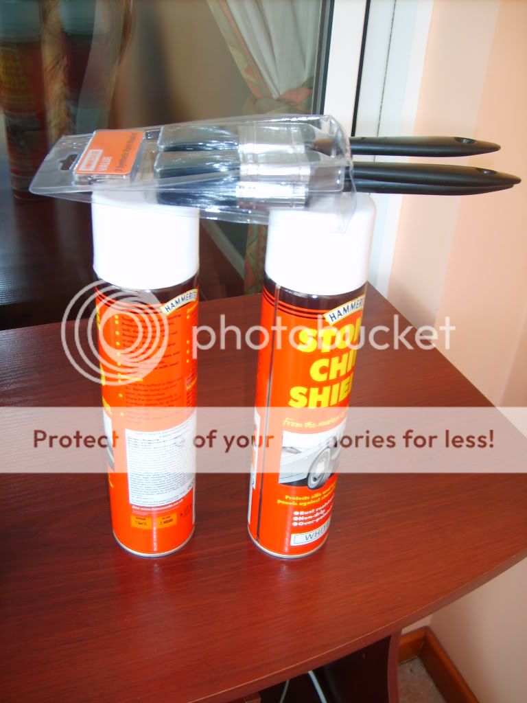

Inside seam sealed and painted in white stone chip.
Sills (both sides) painted in white stone chip.

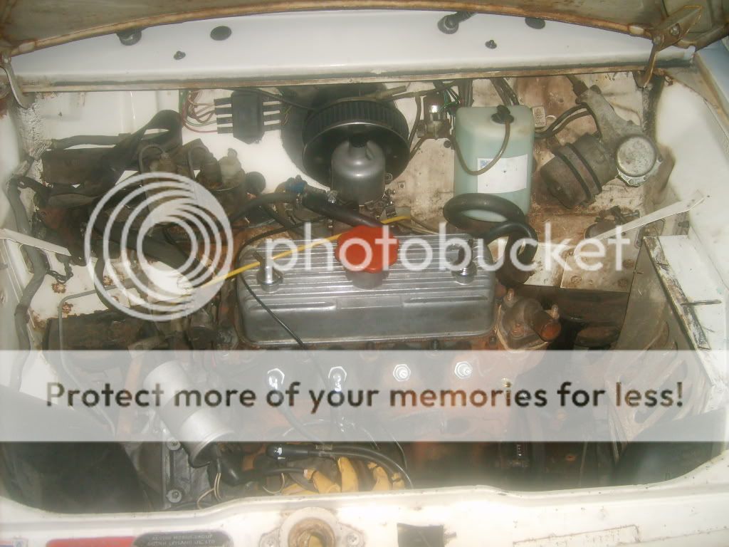

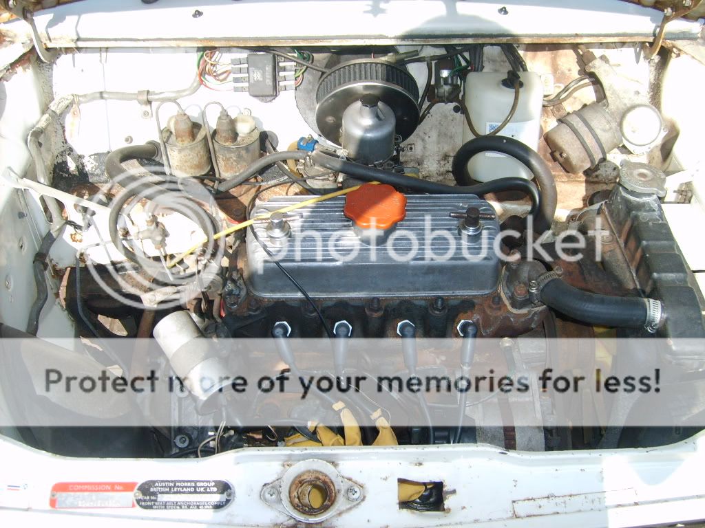

As the exhaust was blowing and that had to be sorted out, i took some pictures of under the bonnet. This how it came, it is surprisingly quite tidy.

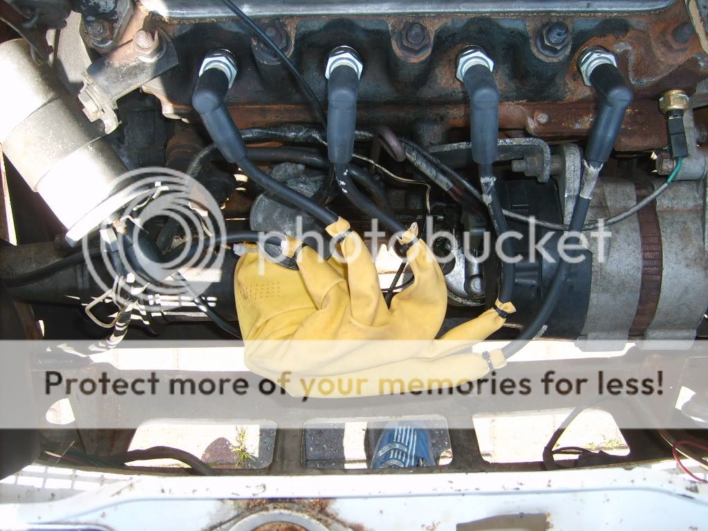

The marigold i put on when before i went to blaise castle, as it wazzed it down, it worked a treat!

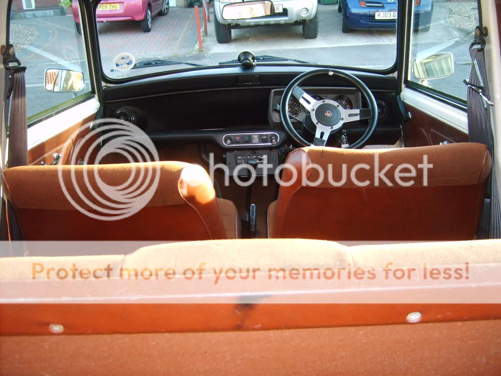

The interior back in, got to love the brown!

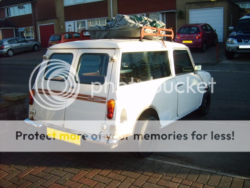

And as it stands at the moment, ready for the MOT.

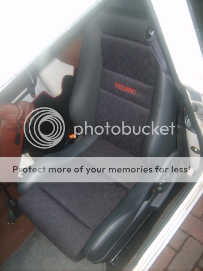

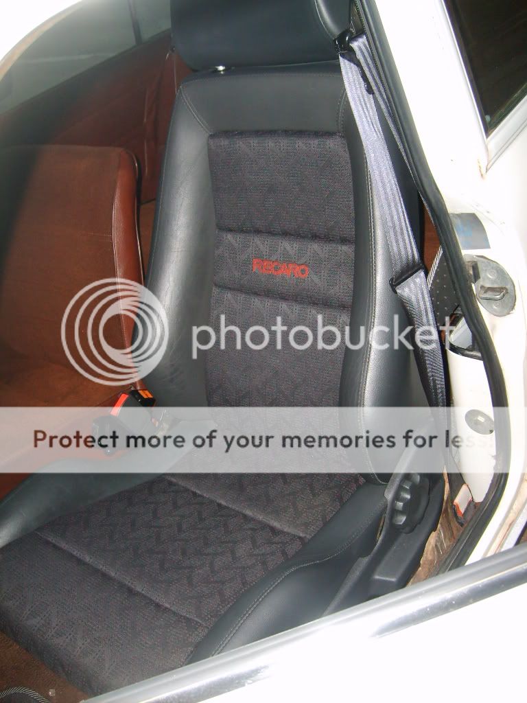

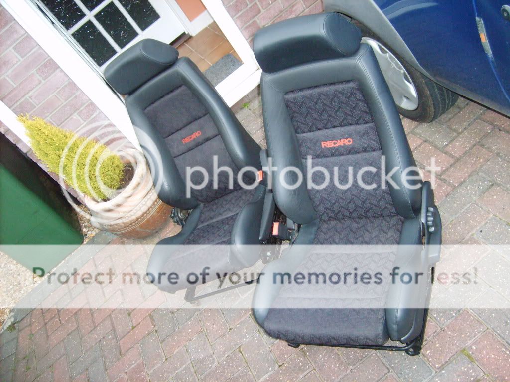

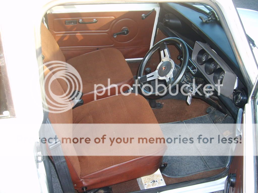

Today i had ago at fitting the recaro seats....
In... ish

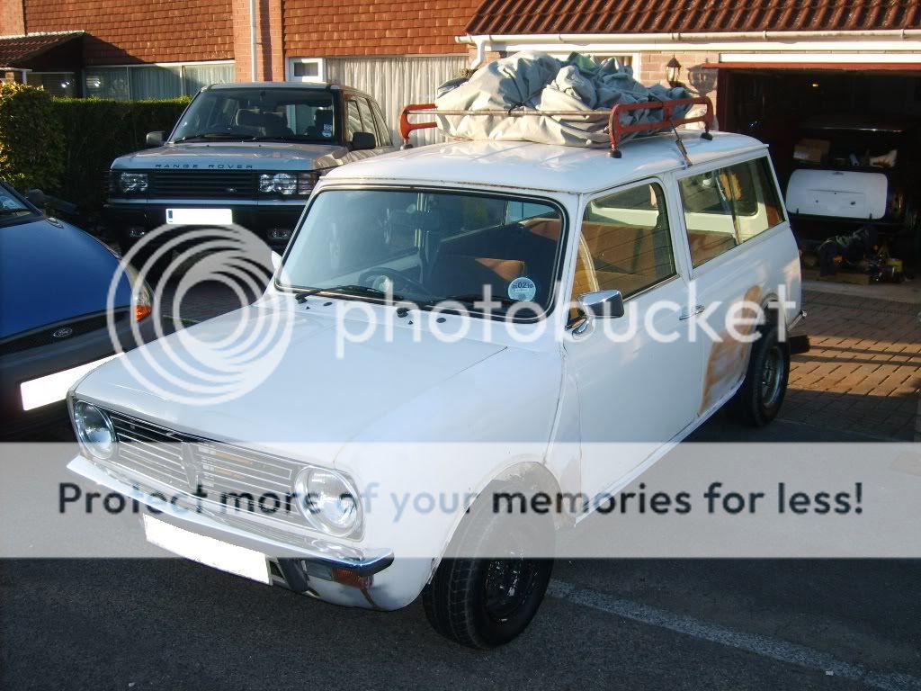

Nice ! I love the roof-rack.
My brother has a estate and ill have to convince him to get a roof-rack.

yeah the roof rack is pretty cool lol. It was
my mums, she used it on her mk1 mini when she first learnt to drive.
It was under a pile of crap in the shed, until i dug it out.

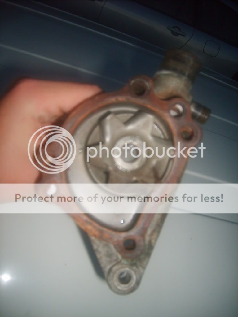

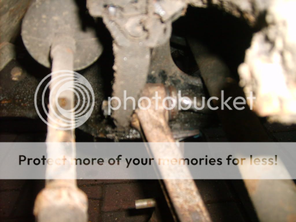

On friday, i took the estate out for a spin, and i noticed when i pulled up, some water on the floor, which i assumed had come out the over flow, as i had just topped it up.
But after further investigation the water pump was leaking, and the bypass hose had a rather large split in it.
So... this is how it stands today.
Water pump looks fairly new be fair, but will be replaced none the less.
So before combe, i need to buzz over to somerford minis, get a water pump, gasket and bypass hose.... bloody niggly jobs!

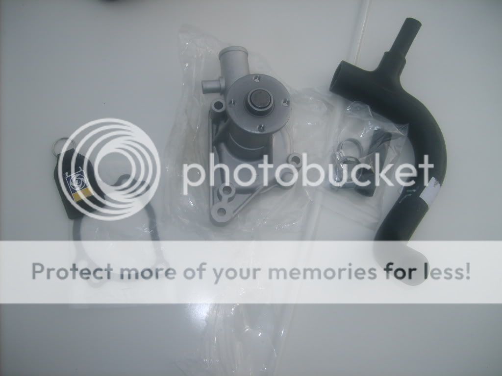

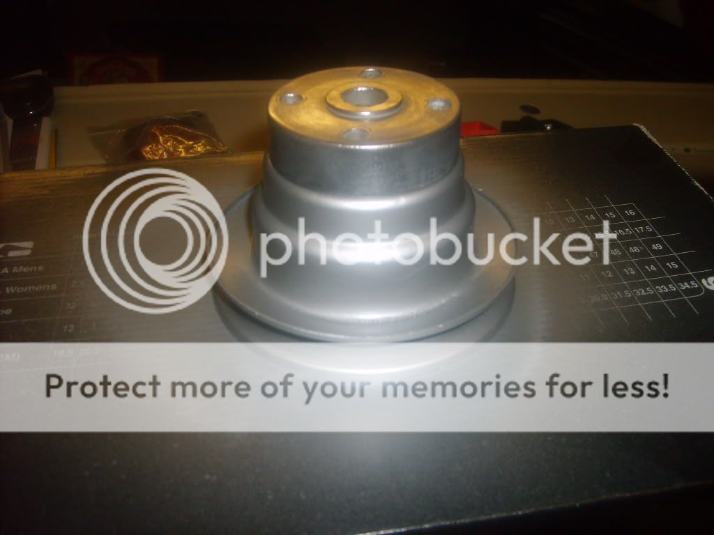

Quick update:
Got the the parts from somerford minis, (got myself a decent key fob aswell) :cool:

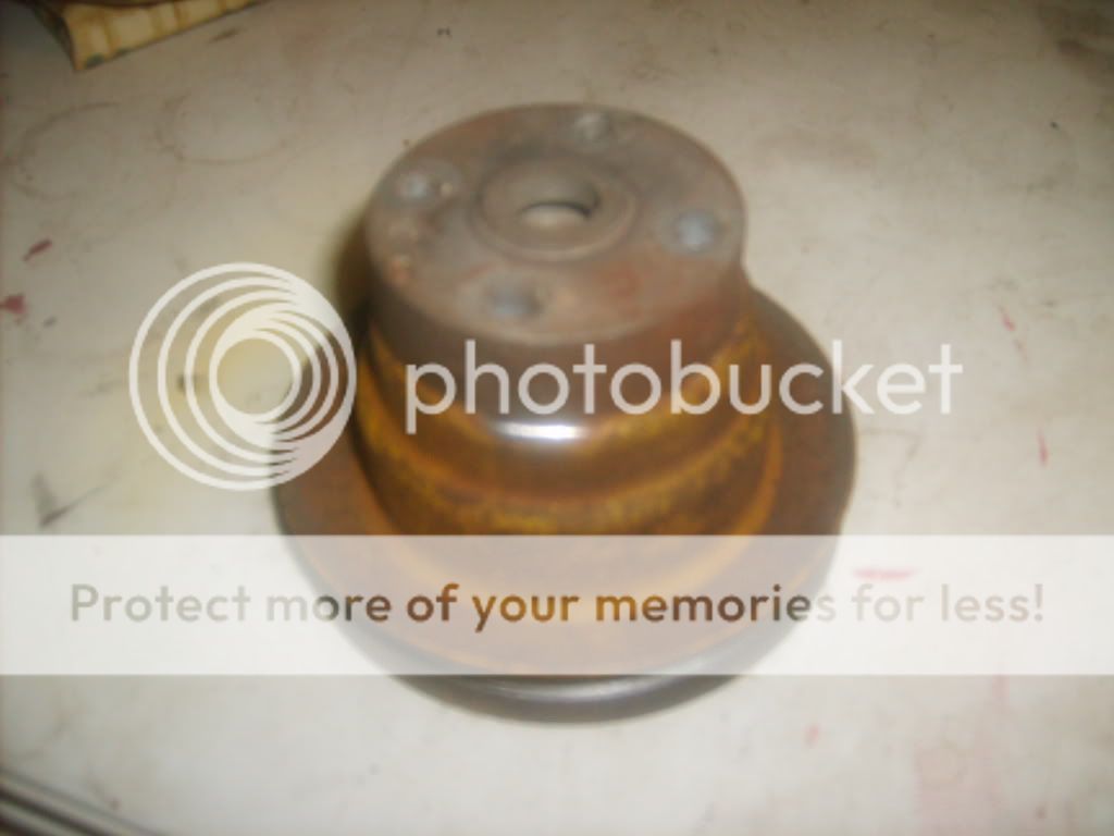

Whilst the pulley was off, i cleaned it up and gave it a lick of paint, did a little cleaning here and there to tart it up.
No pictures of it finished, but its not all that exciting.

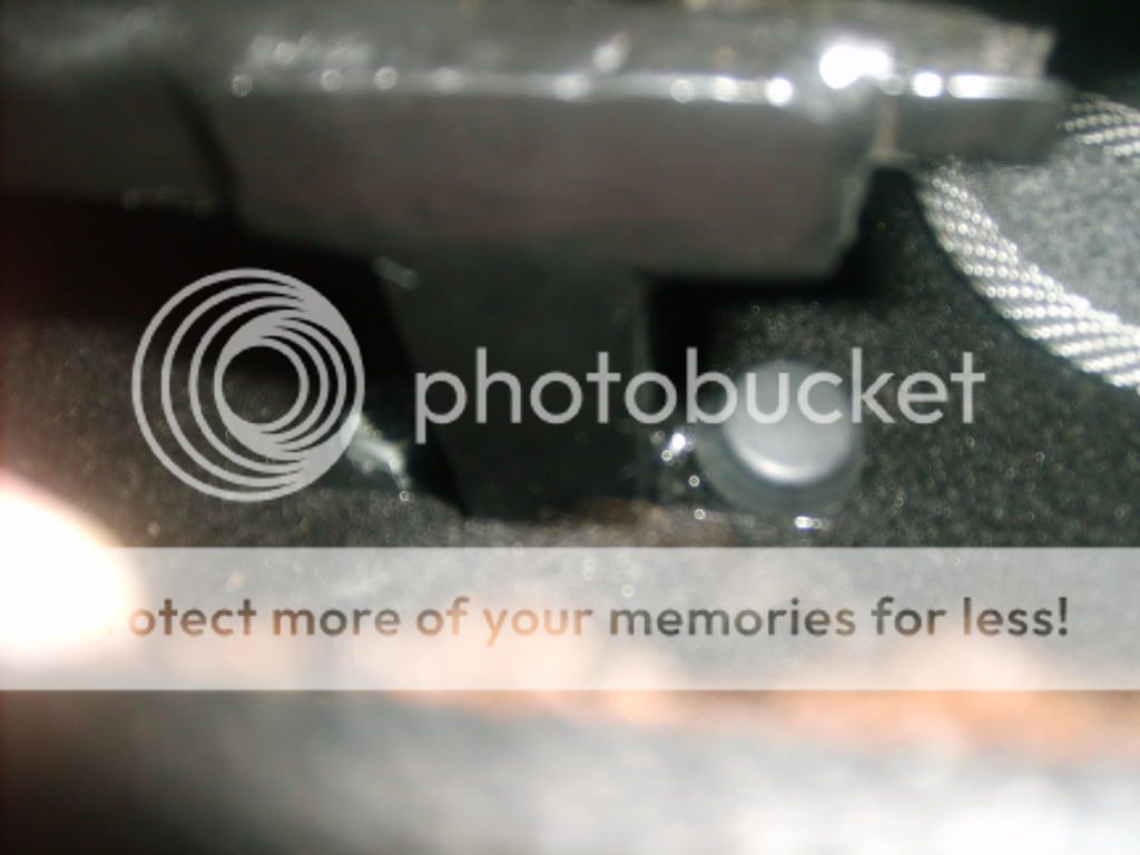

Well its been a while since i last up dated.

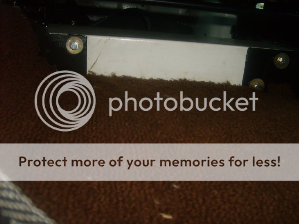

Passenger seat is now in properly. Ran out gas, so cant do the drivers side yet, typical lol.

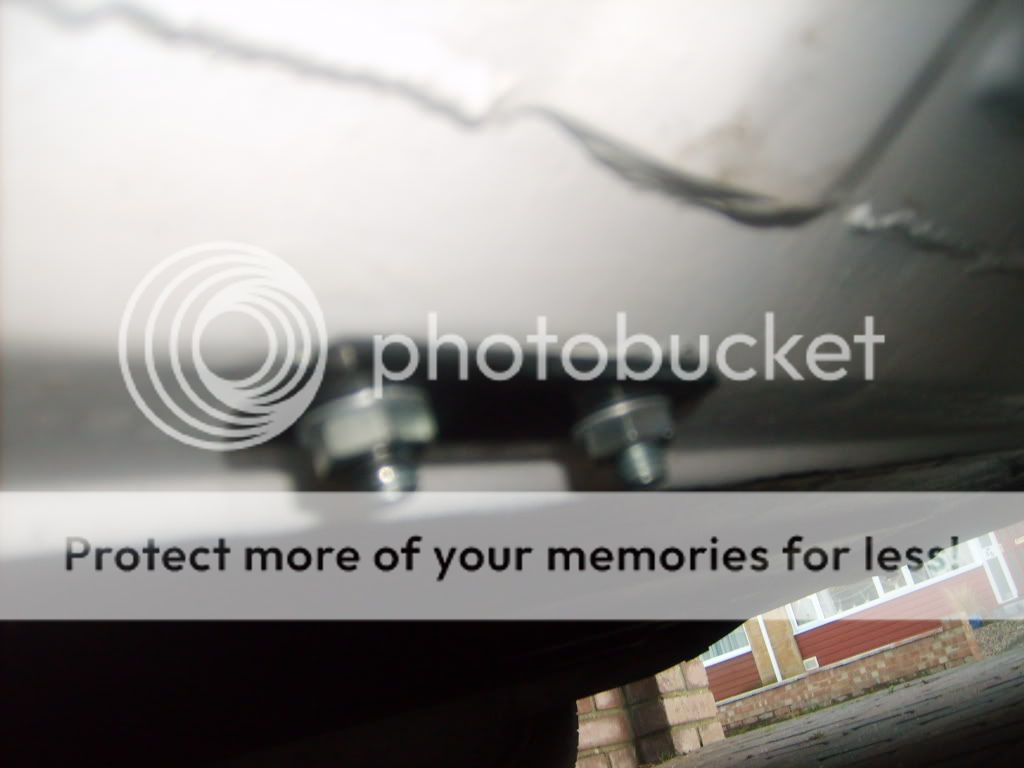

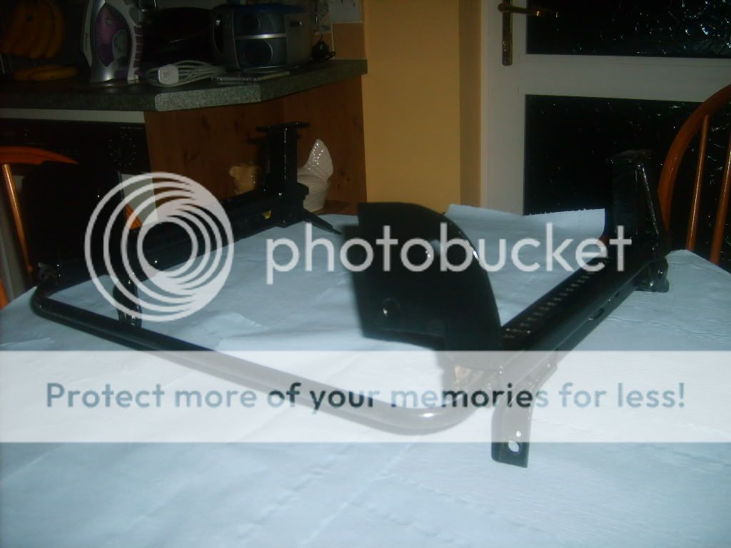

There was a slight miss hap with the fabricator, so i ended up making my own rear brackets.
My dash has been fitted (need to get a head unit) and some other parts were purchased to smarten the outside up a little.

Can you recline the Recaro's once they're installed on the runners - or are they slide only.
I couldn't recline the Metty seats in my 1380 estate - it wasn't really a problem as the rear seat base lifts up to get to the battery but it was a real pain in the arse on the van.

The seats only slide forward which is a little annoying, but if you slide them all the way forward, and lean the backs forward theres enough room to get in and out if needs must.
They're blooming comfortable! Just got to wait for the paint to dry on the drivers side frame and i can fit that one!

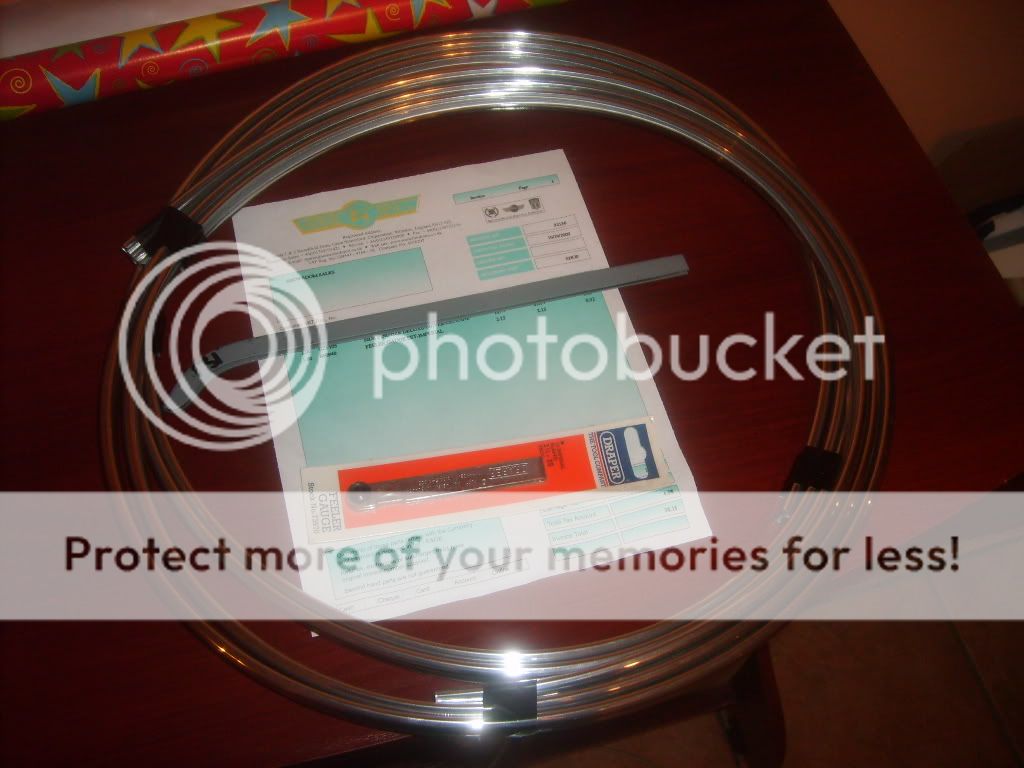

The sill stips are stretched out in the spare room at the moment to try and get them as straight as possible. The the hot water will come out lol.
