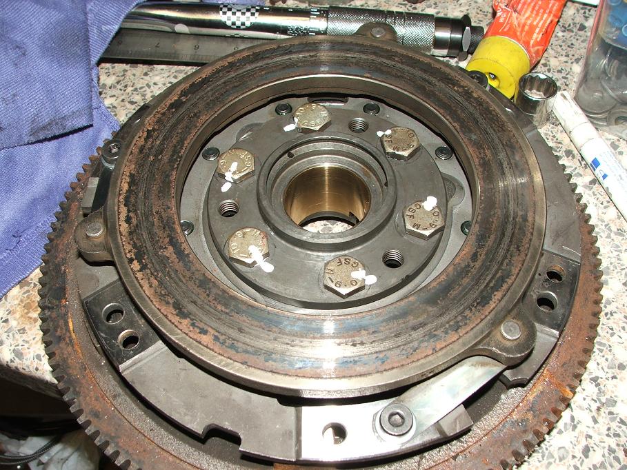

Mine turned up yesterday and I have been busy assembling it, then had to go out.
Anyway, I'll throw up some pics showing how the AP clutch looks.

Piccies of an AP set up. No idea if its going to be too much *oh well*
The pressure plate does need refacing. Going check run out all round and to see if it will balance without the flywheel.
I might also try and see about measuring the throw out force when its built up and compare it with the orange pre verto, which will require a little math too.
Edited by Sprocket on 16th May, 2010.
