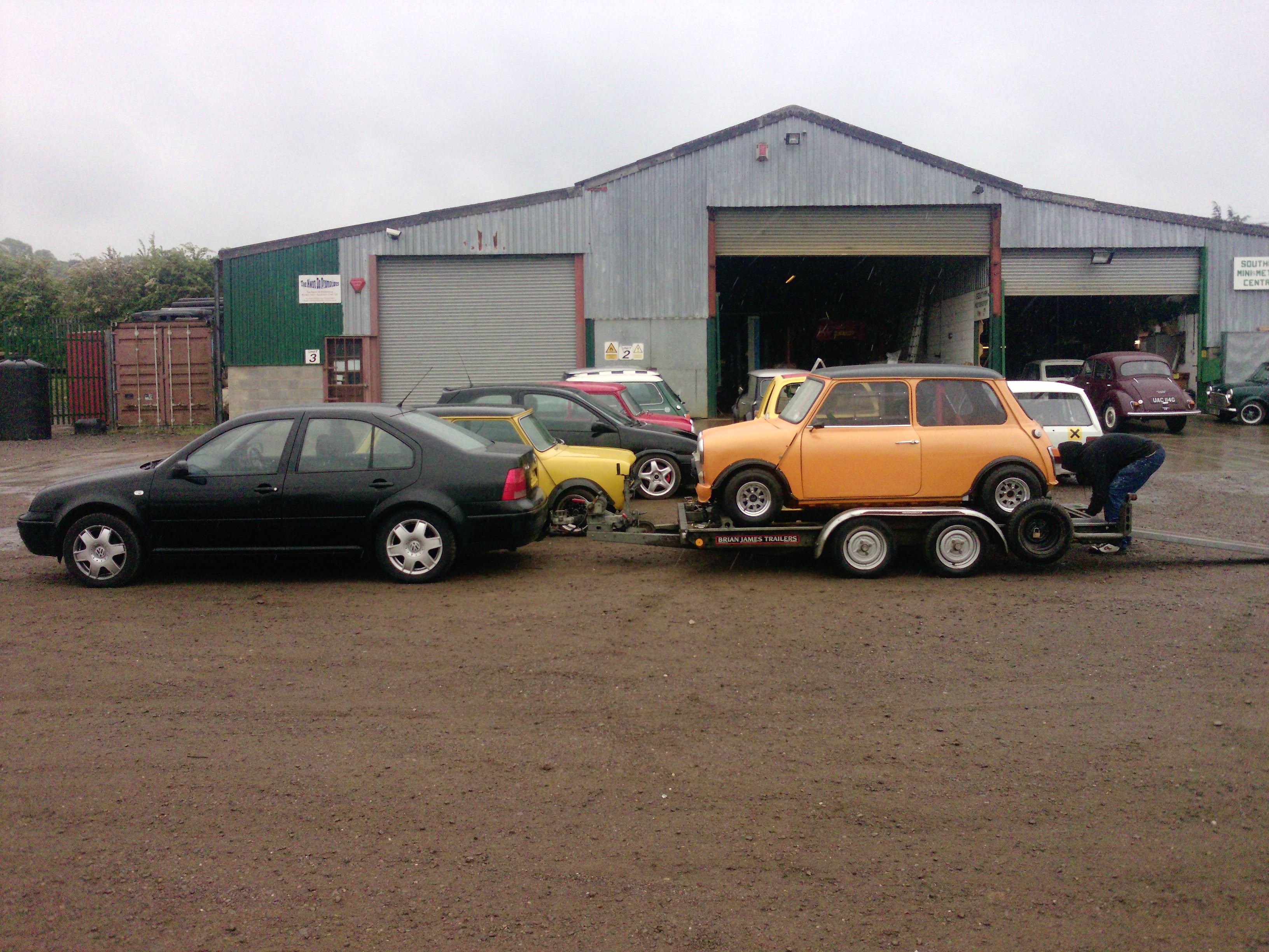

took the mini to start fitting all the dta today. towed with the new motor *happy*
Uploaded with ImageShack.us
tomorrow it gets mapped :)
have to say the med trigger wheel, damper and bracket all fit very well and theres still enough room to change a fan belt
