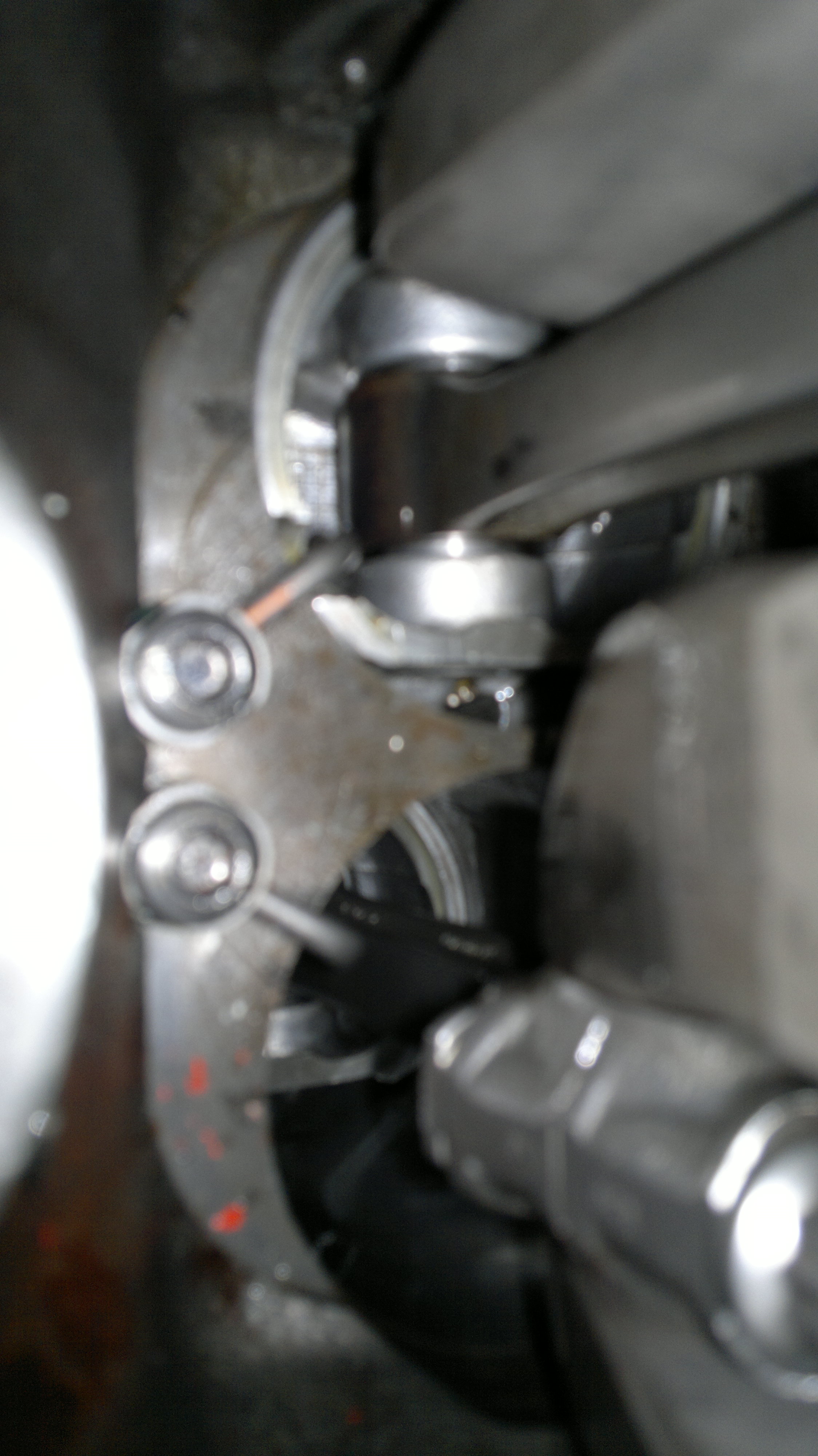

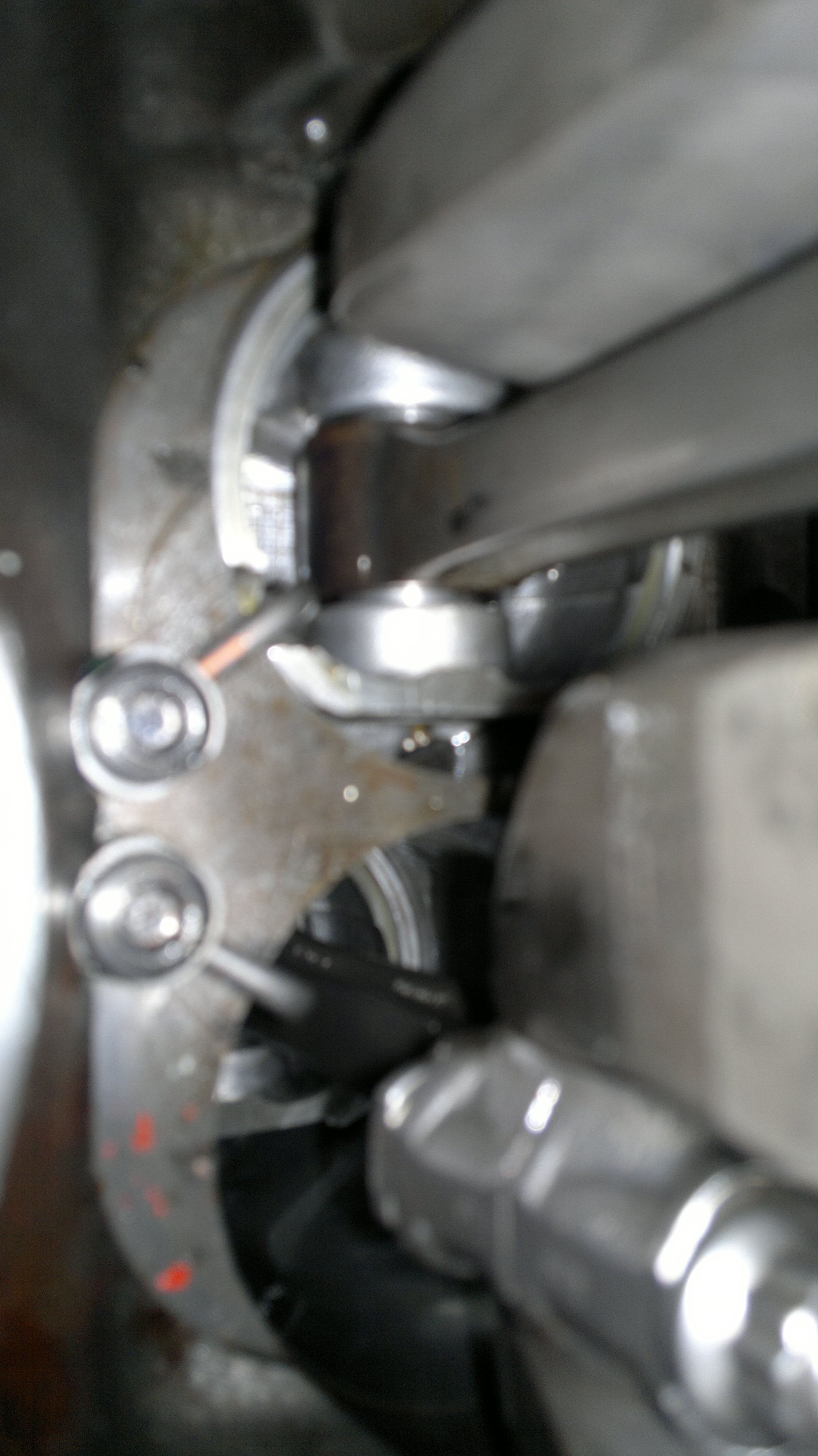

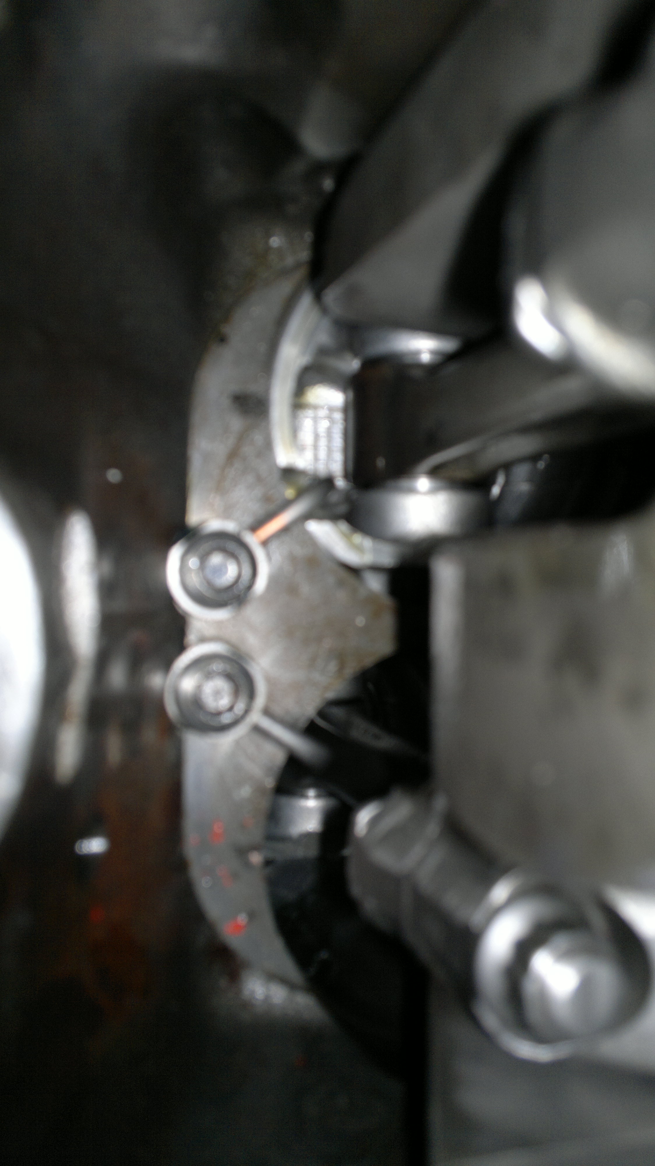

What about nibbling a bit out the web on the back of the block, and having them central on the bore where the step is lowest, then just machine a flat spot in there.
you should be able to nibble a little off the webbing, but the jets cannot be centre of the bore as they will hit the rods. i will put some pics of mine, you may also have to cut a little off the base of the piston to make sure they clear

just some pics i took yesterday

keep at it. did you get some oil jets

So Ive started on the oil squirters, went with M3 grubs plainly because my bolt shop doesnt stock anything smaller. They will have a 0.8mm hole in them to from the jet, anyway, pics.
Holes drilled,
Tapping the holes M3.
I then ground out the oil-ways
Now I just need to organise my mates 90 deg air drill so I can do the oil-fed thrusts.
Never thought about that before. The place for a conventional drill machine is really small.... *tongue*
For what are the threads? Oil squirters at the underside?

Im going to drill a 0.8mm hole in some M3 grub screws, they will then screw into the threaded holes in the block, and act as the "jet" for the oil squirters.

Ahaaaaa, I see now what you did with the squirters. That is clever.
