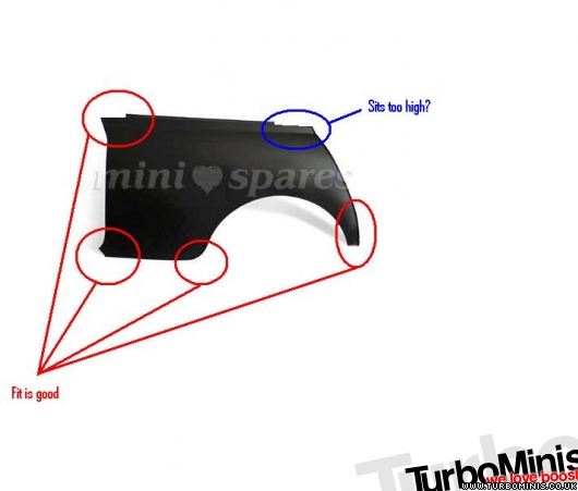

Some pics of where im at.
As you can see from the pic above ^^^ the panel doesn't fit at the top edge where it meets the window.
The only 2 ways I can solve this seem to be either push the arch down or bend the panel out to give more of a curve. Has anyone had a similar problem before.
Edited by matty on 19th Oct, 2010.
It doesnt look to me like the curve of the quarter panel matches the rear panel, it looks a bit flat
Paul - they do look very flat compared to the originals!
Ive had another fettle with it and it seems a bit better. *oh well* Its under a fair amount of tension mind!
Here's the arch location
Here's the panel alignment now...its a bit better, still not perfect though. I don't like to position wher they join..its right on the corner of the swage line.

I understand what you mean about the quarter panel now, I think you'll have to adapt it to fit. Does the lower swage line line up with the rear panel? If it does then at least it shouldn't be too difficult.
If you are using dry suspension I can see no reason to fit the reinforcing brackets other than for historical accuracy. Both Somerford and BMH list them as being fitted from 67 but I have seen pictures of Mk1s with them. As they are related to the hydrolastic suspension I would go with September 64 but it's really up to you whether you want to fit them or not.
The rivits used for the boot board brackets had quite a large head, you can just about see them in the picture I posted. On a 66 Cooper they would have been rivited but as an 850 wouldn't have a boot board I can't see it really matters how you attach them.
Is that a genuine or a pattern quarter panel? I've got that pleasure in the near future...
