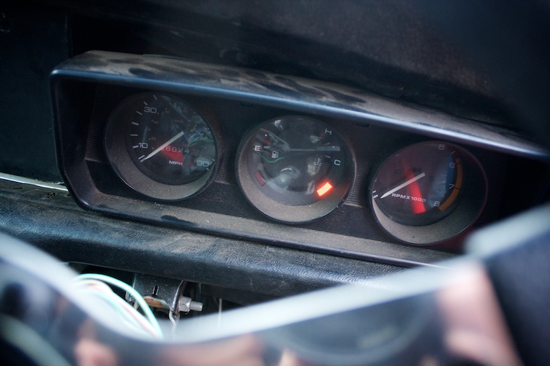

I think i must have knocked a wire in the engine bay tho as the oil warninh light now comes on, but the pressure gauge says 50. Fun!

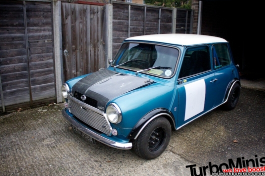

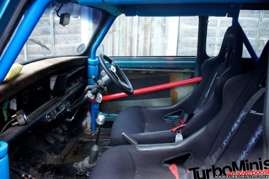

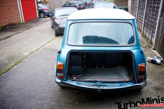

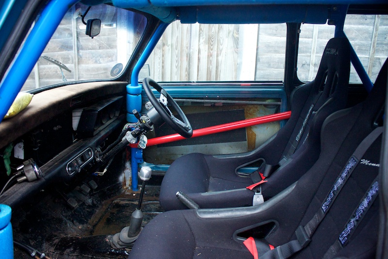

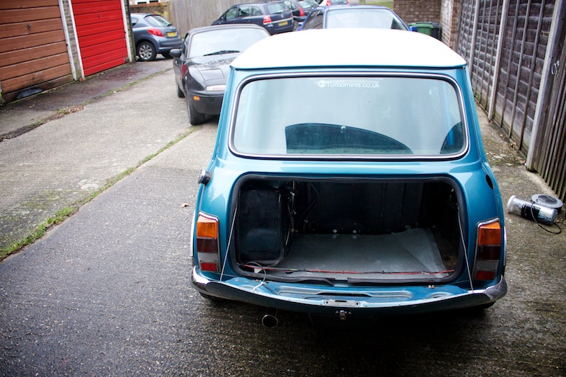

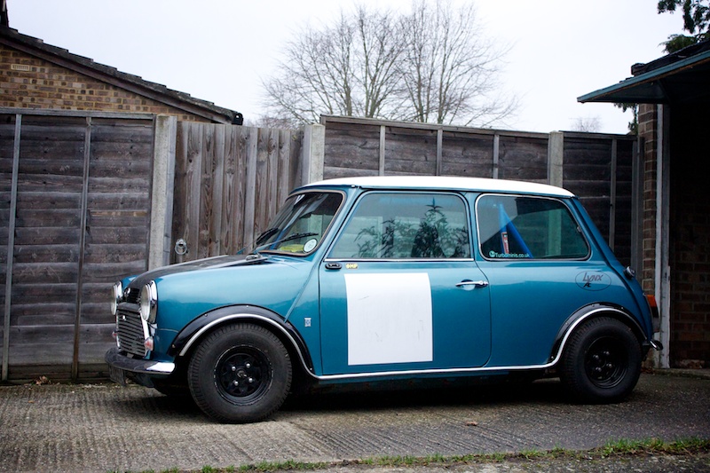

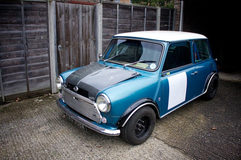

Here's a few pics of the car as it is:

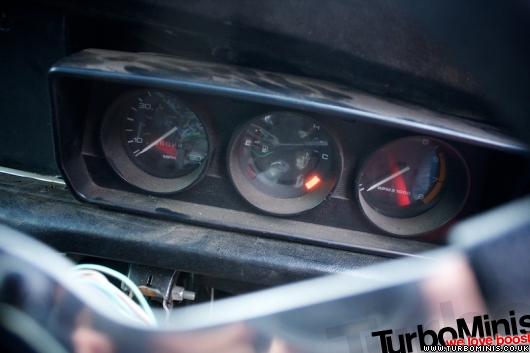

And here's the warning light.. :/
